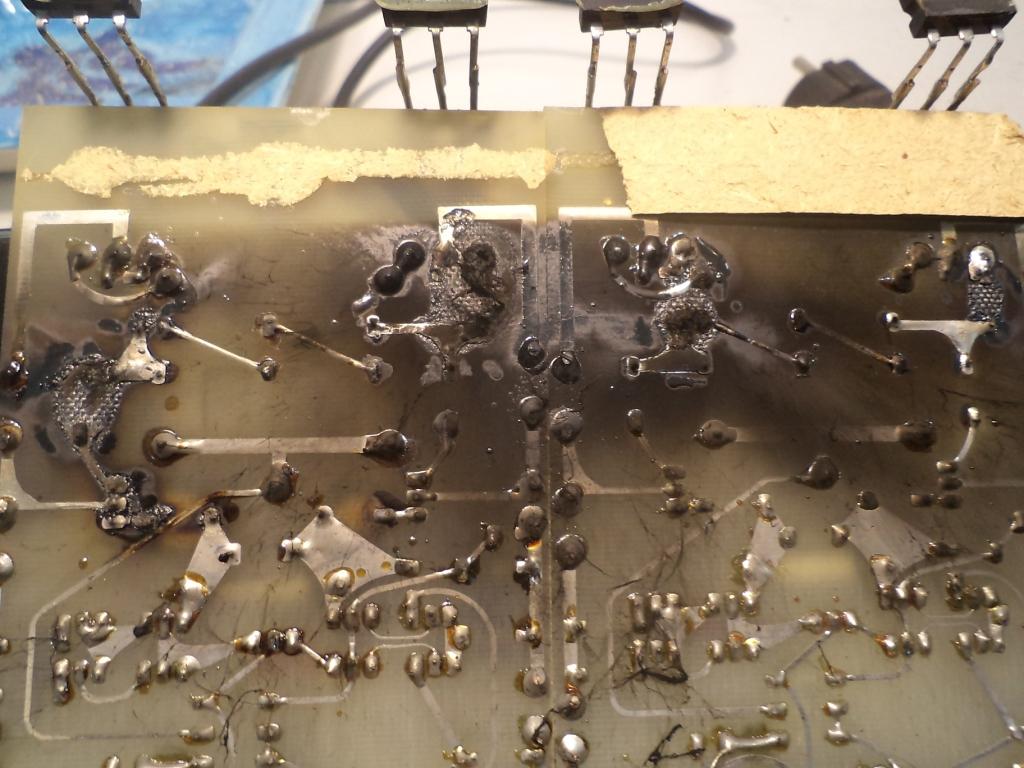

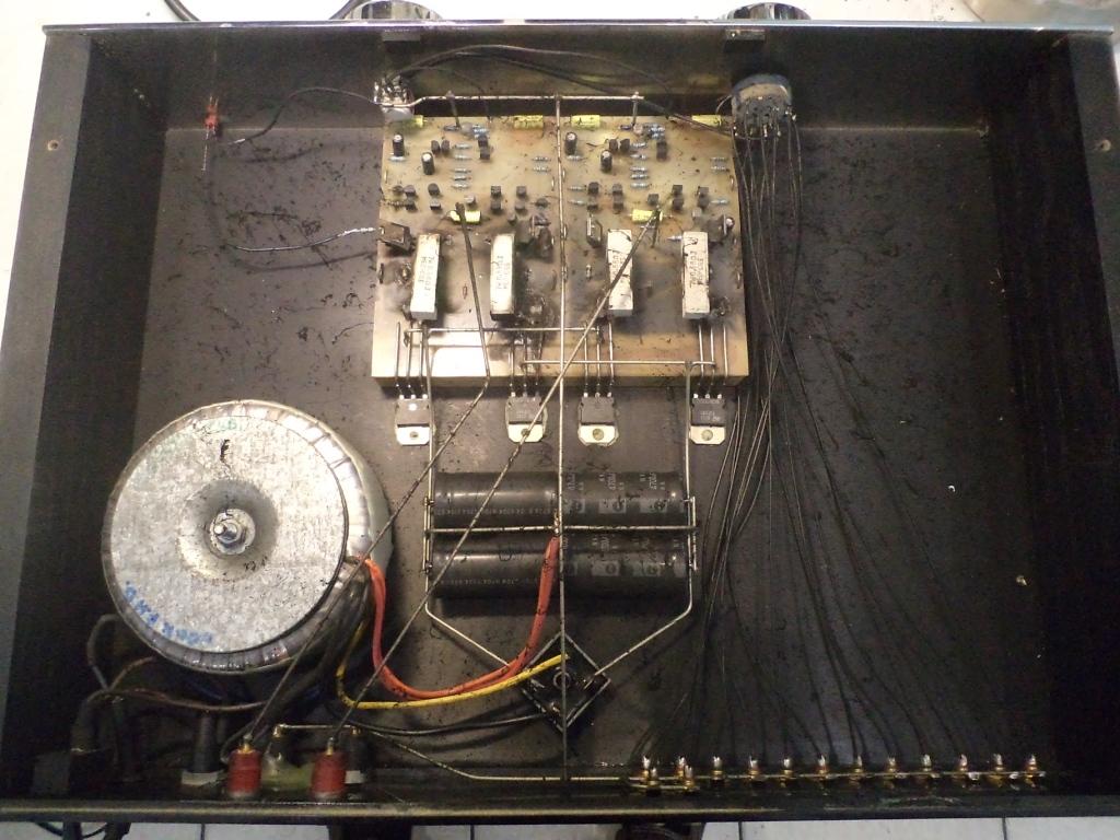

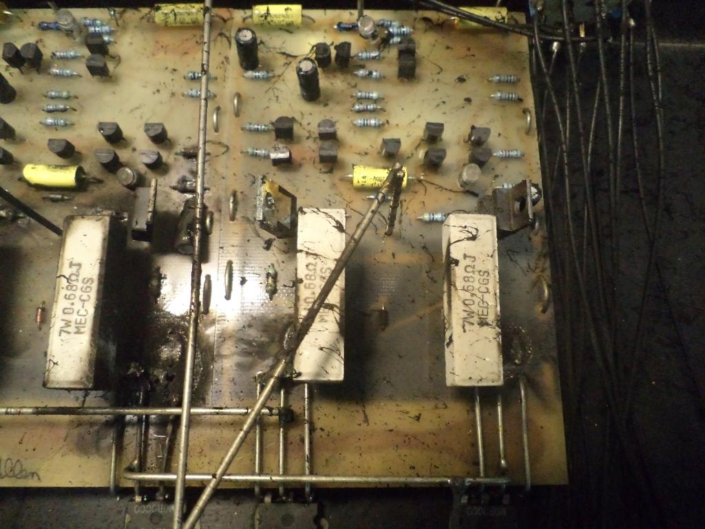

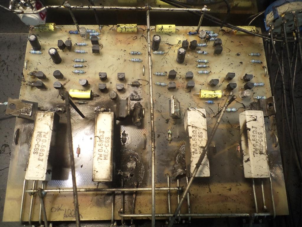

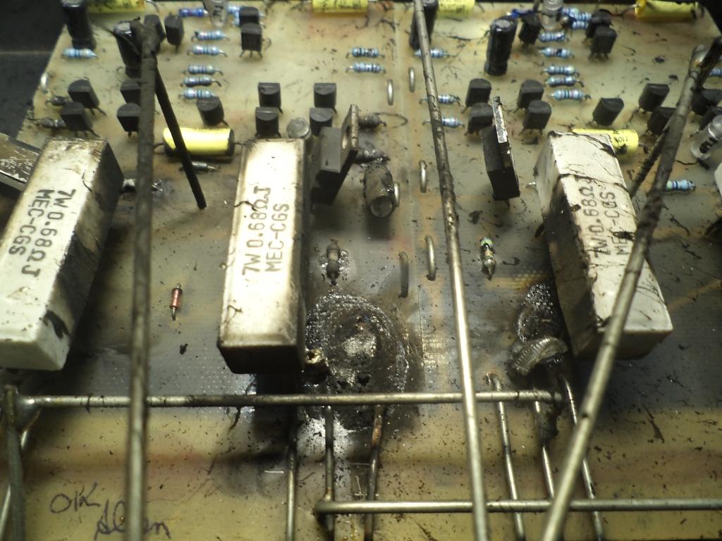

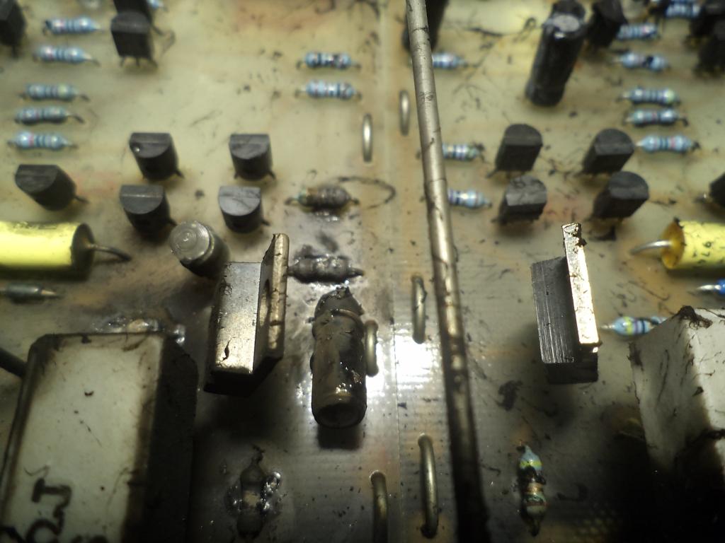

Summer time in Athens
Client got a pair of brand new Harbeth hook them up to NVA amplifier TIP 142-147
Thought that he could keep them on during the day at 0.5W to give the speakers a "burn in "
14 hours later target achieved :
Circuit features a Vbe multiplier located on the PCB though ....

Never reverse engineering in the circuit just what i show on the board schematics are not available Just what i thought i was looking
Th UK angry villager used a fork and a torch to design
one LTP
a current source
A Vas stage with and active opposite
A Vbe multiplier located on the PCB
2 TO92 pre driver
2 TO 220 driver
and OPS that is darlington IE driver and output in the same package
Now how the F**** do you call that ?
EF4 or i lost counting ?

When one Marantz amplifier that sold 50.000 pcs comes in the lab with a faulty LM317 is one thing , When a Musical Fidelity amplifier that sold 1000 pcs brings in the lab 15 amplifiers with toasted SAP 15 OPS then we have an issue .
When most of NVA amplifiers come in the lab as seen in the pictures above then yes then you have a very serious issue ....
