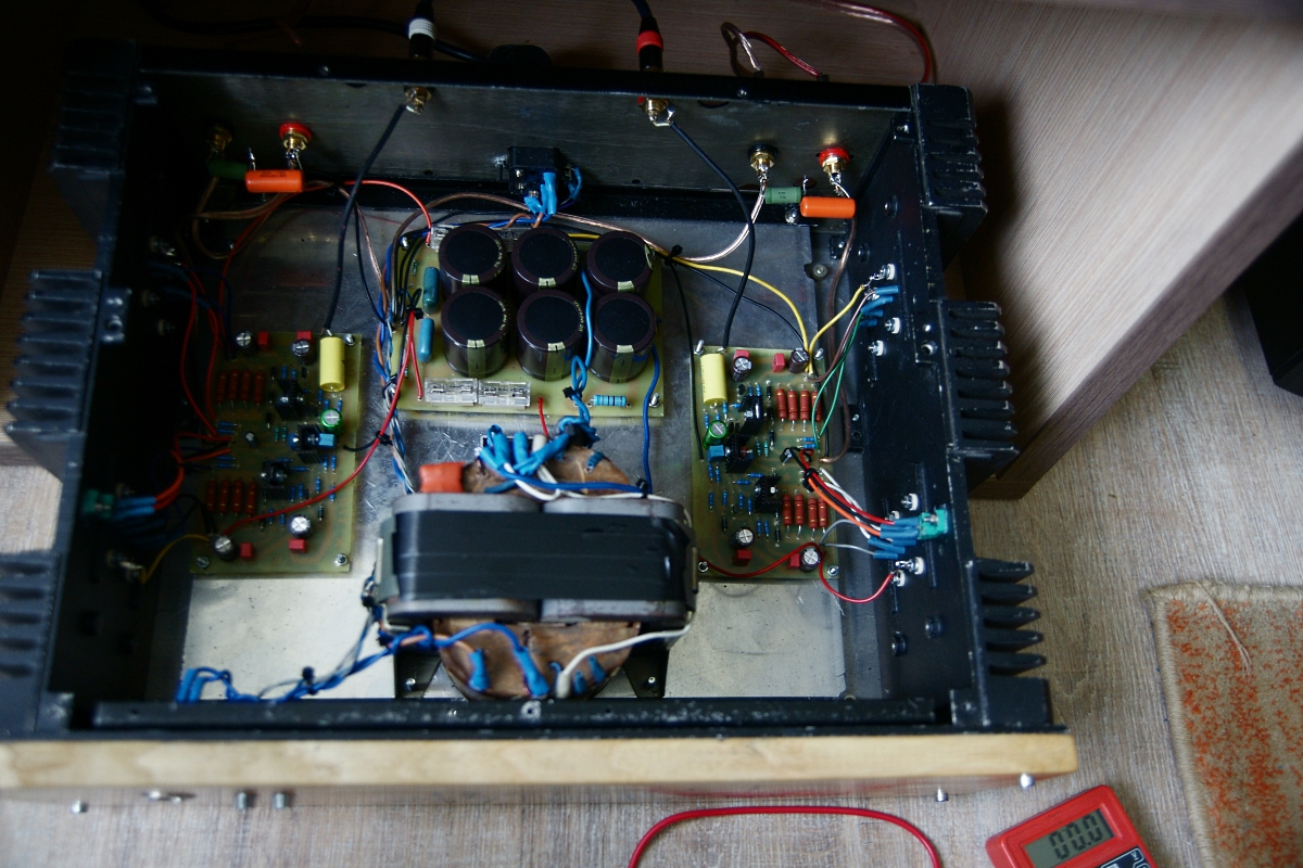

AB100 amplifier was operated continuously 10h by me at moderate volume.I checked parameters now - bias stable compensated from 100mA per transistor to 90 mA. Offset - from 3mV dropped to 1.2mV and 12mV on other channel. (diff pair transistors was matched by hfe) .sounds very good - the low end also impressive.

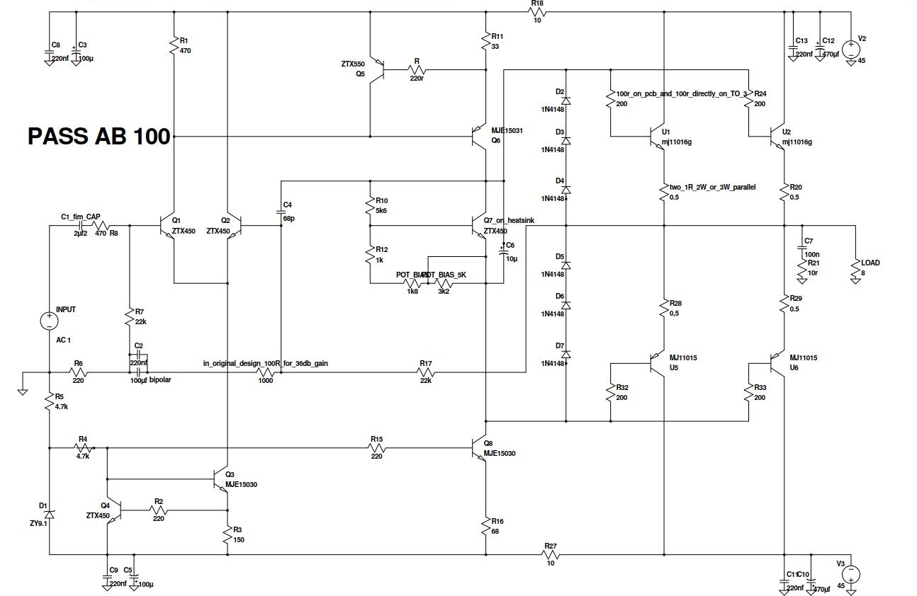

I think its possible to reduce Re to some 0.33R instead of 0,5R .
I matched only the input pair transistors not darlingtons, but they are already pretty close to each other from the store shelf - maybe I'm lucky. (Which I doubt ..)
In between enjoy the schematic ....This is a commercial design existing in the market for a number of years and also features a patch of 150Pf in the upper side Only ! relatively low next to known other schematic .
Thanks - It's (vaguely) a Blameless clone with a cascoded VAS and Darlington OPs. They have gone through some pains to include an elaborate Vbe bias limiter to reduce the possibility of thermal runaway - perhaps the added cost of such a limiter was much lower than the price of discrete non-Darlington outputs + drivers in that era (maybe even today, even with inexpensive C5200/A1943 clones from the likes of ST).
The discrete darlington VAS of 2x BC560 is wasted. They should have used a true Blameless-style emitter follower, with collector going to ground. Perhaps you can do that mod, though the extra open-loop gain may tip it into instability.
In the last few months ab100 has become my everyday amplifier - I like everything, especially the bottom end is very punchy and fast - also sound stage is very good. Stable as a rock even if you lose one supply rail - you will not fire speakers - there will be only small amount of DC at output (instead of chipamps for example).
In addition I installed small heat-sinks fors VA and CCS transistors, maybe they can do without them (approx 0,5W dissipation) -but it's better to be on the safe side.
🙂🙂🙂😀In the last few months ab100 has become my everyday amplifier - I like everything, especially the bottom end is very punchy and fast - also sound stage is very good. Stable as a rock even if you lose one supply rail - you will not fire speakers - there will be only small amount of DC at output (instead of chipamps for example).
... I've added the actual circuit of my amplifier.Of course, a lot of things can be changed according to the taste and possibilities .
I like your simplification of the output stage with the big darlingtons.
Have you built the amp both ways?

As you know, the degeneration for differential input stage can greatly improve linearity, but seems most Papa's design without it(or rare), is there any special reason ?

I performed a quick simulation - with degeneration thd at high F getting worse..
Papa is too cheap to use two extra resistors.
Really, what is the reason for this, I noticed that too?Papa is too cheap to use two extra resistors.
