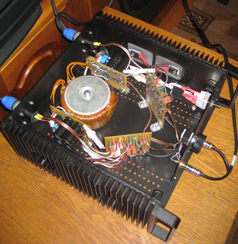

About thermostability, more strictly - about thermoenviroment. If you have looked at a picture with showing the amplifier inside, you, probably, noticed uncommon realization details. Among others (say, frontal input RCA connectors), you can see, I have rejected common practice to mount pcb to heatsink. I'm strongly sure, low-current details (i.e. placed on PCB) must be far from heartsinks. Top and bottom case's plates perforation serv this aim also.
