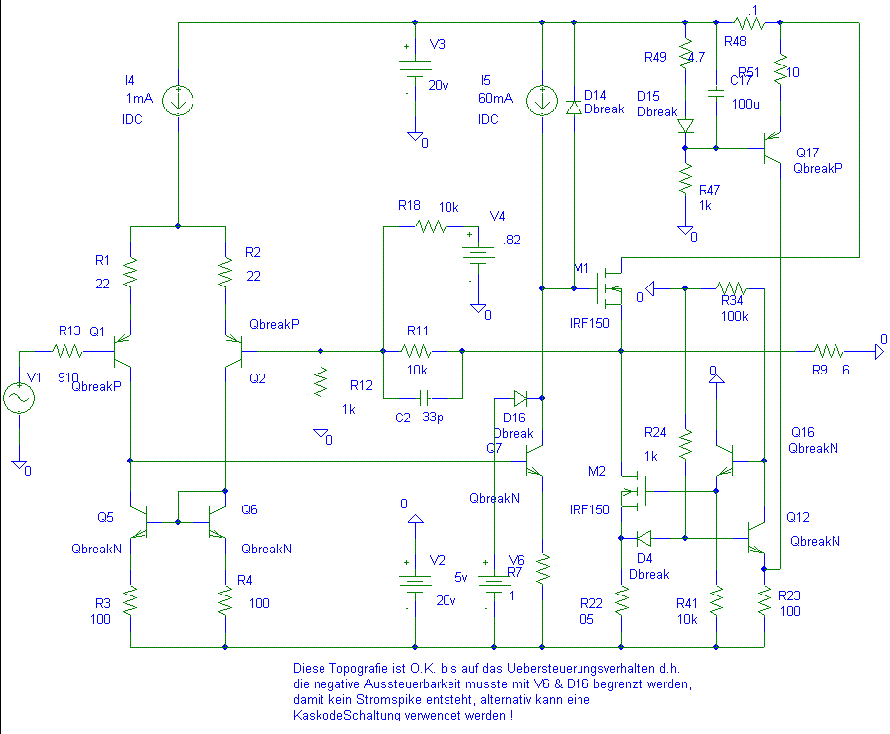

Cascoded JFET is a nice sounding combination. In sch49 X5 is separately cascoded and nicely linearised. Sch49 should have less OLG and less NFB. It might simulate worse, but it should sound better.
In sch55 J1 and X1 are forming a CFP-like arangement which is cascoded by Q1. The big V-MOSFET M2 might not be totally happy with drive from Q1 (I think that X5 in sch 49 does better job).
Anyway, it is easy enough to try both input configurations when you build the amp.

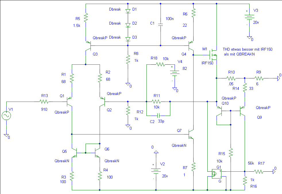

Hi Anli,
A class-AB bipolar amplifier arrangement was published in WW/EW about 12 years ago where the current in one half was sensed such that the other half maintained it at about 100mA; but both halves were driven.
In your circuit only the bottom half is driven, whilst the other voltage senses current and generates current correction. Thus the M1 half cannot react to back-EMF induced load current variation until the voltage sensing NFB loop controls M2. That is two gate capacitance 'filters' in series at high AF within the closed load-damping loop.
It might be worth looking at the output terminal damping characteristic, or simulating with an equivalent loudspeaker load at 10kHz.

Let's see how the jfet "see world". Drain current is defined by 0.67V/R5 for sch49 and 0.67V/R6 for sch55. Drain voltage is -6.2V + 0.67V for sch49 and -6.2V + 0.67V*2 for sch55. You see, "jfet environments" are similar. As for driving M2 - I already soldered two amps with similar mosfet driving and have not noticed any problems - from measuring and ears POVs 🙂 And one of them is non-switching AB: http://gaydenko.com/simple-ab/v41/schematics41.png
At any case - you are right, listening test is needed.
BTW, the only aim of sch49/Q2 is to make better psrr of bottom power rail. In sch55 psrr is more "inherent" 🙂

Graham,
I have tried to load with a load capacitor only (1.3uF at 20KHz) and without load at all. At both cases I have not noticed any artifacts.
You are right, the amp output resistance is slightly different for top and bottom halves. It is clear form the transfer derivation http://gaydenko.com/ab-dynamic/transfer39.png I still have not found simple way to make top and bottom "more equal". OTOH, I have not any information about psychoacoustics results saying we must (or must not) have this or that output resistance behaving. And, on the third 🙂 hand, such output stage topology defines very uniform spectrum behaving at wide range of input levels, which seems to me be important.

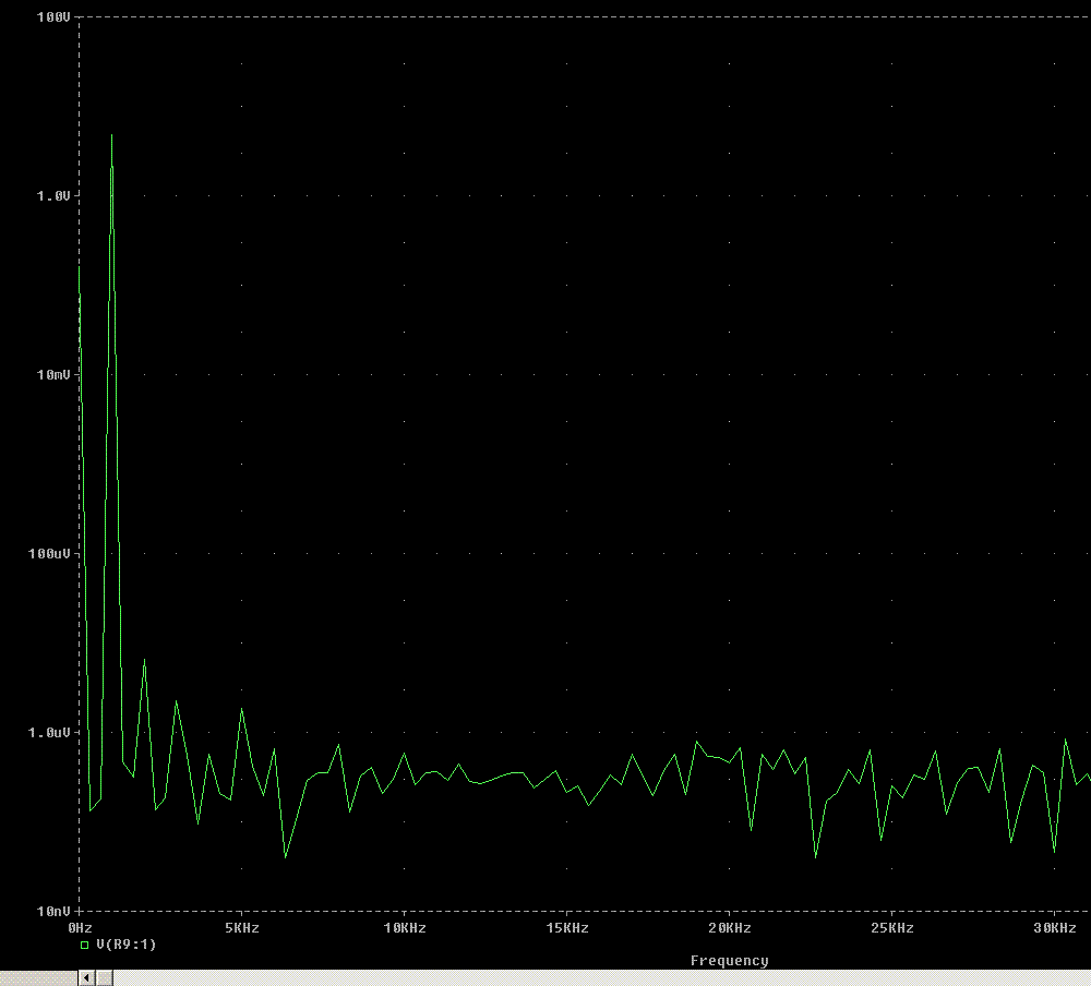

I like those circuits where only one half is driven and the other one is controlled by a current-feedback loop. There was once a suggestion for such a topology in the circuit ideas section of EW+WW. It used OP-AMPS though. I personally don't see a problem with such topologies and I did some simulations as well some time ago. I didn't build it so far however.
Below you can see the output spectrum of it if driven 12 dB below full output. 2nd order is dominant and approx 120 dB below fundamental. It is only a simulation of course and I am aware of its limited validity.

phase_accurate,
Indeed, it is possible to add "full-featured" preamp, use OPAmps, and so on. Output stage itself (more strictly, dynamic load itself), as illustrated here http://gaydenko.com/ab-dynamic/cdcd01.png , is simple and self-contained, and is ready to be used at any topology 🙂 Nevertheless, I'd like to try as simple the main idea realization (whole amp), as possible, but fulfilling demands listed at first post.

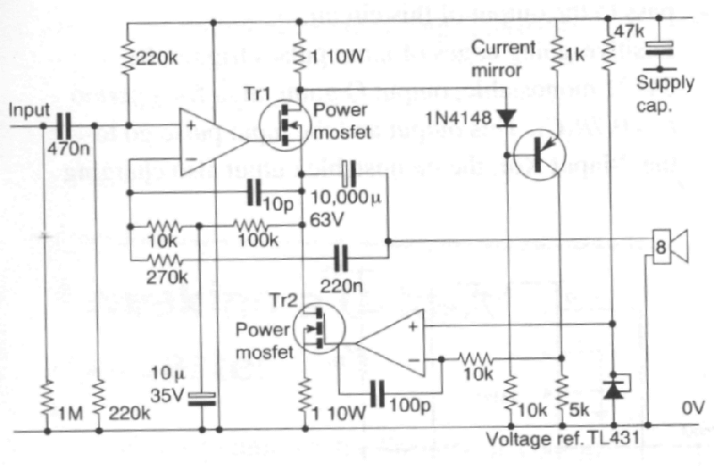

Hi Anli
I am not talking about the preamp section. The circuit used op-amps for the voltage-drive of one of the output devices and one for the underlying current loop. So the potential output voltage range was quite restricted.
Regards
Charles

I also find the whole idea of an output stage where the output devices never turn off very appealing.
I posted my thoughts on a circuit a few years ago, with the intention of running the output stage with a standing 50 - 100mA.
http://www.diyaudio.com/forums/showthread.php?s=&threadid=61120
and more recently seen similar idea on the following web site.
http://www.angelfire.com/ab3/mjramp/amp01.html

Graham Maynard said:... I would consider what happens with reactive loudspeaker load connection
Graham,
How to investigate (yet in sim) the issue except for capacitance load?
Below you can see the first incarnartion that I simulated (also without patent protection).
Because my simulator only supports 10 transistors in total I had to refrain to a dirty little trick. I used the voltage-controlled current-source G1 instead of a 2nd FET. It would not be that difficult however to derive a circuit that uses a FET and some auxiliary circuitry instead.
Bias is set with R16 and R17. The circuitry around Q9 is there to guarantee that there is always the predefined (bias-) current flowing accross both output devices.
The disadvantage is the series resistor at the output (well -sometimes a purely resistive and frequency-independant output impedance might not even be bad at all).
