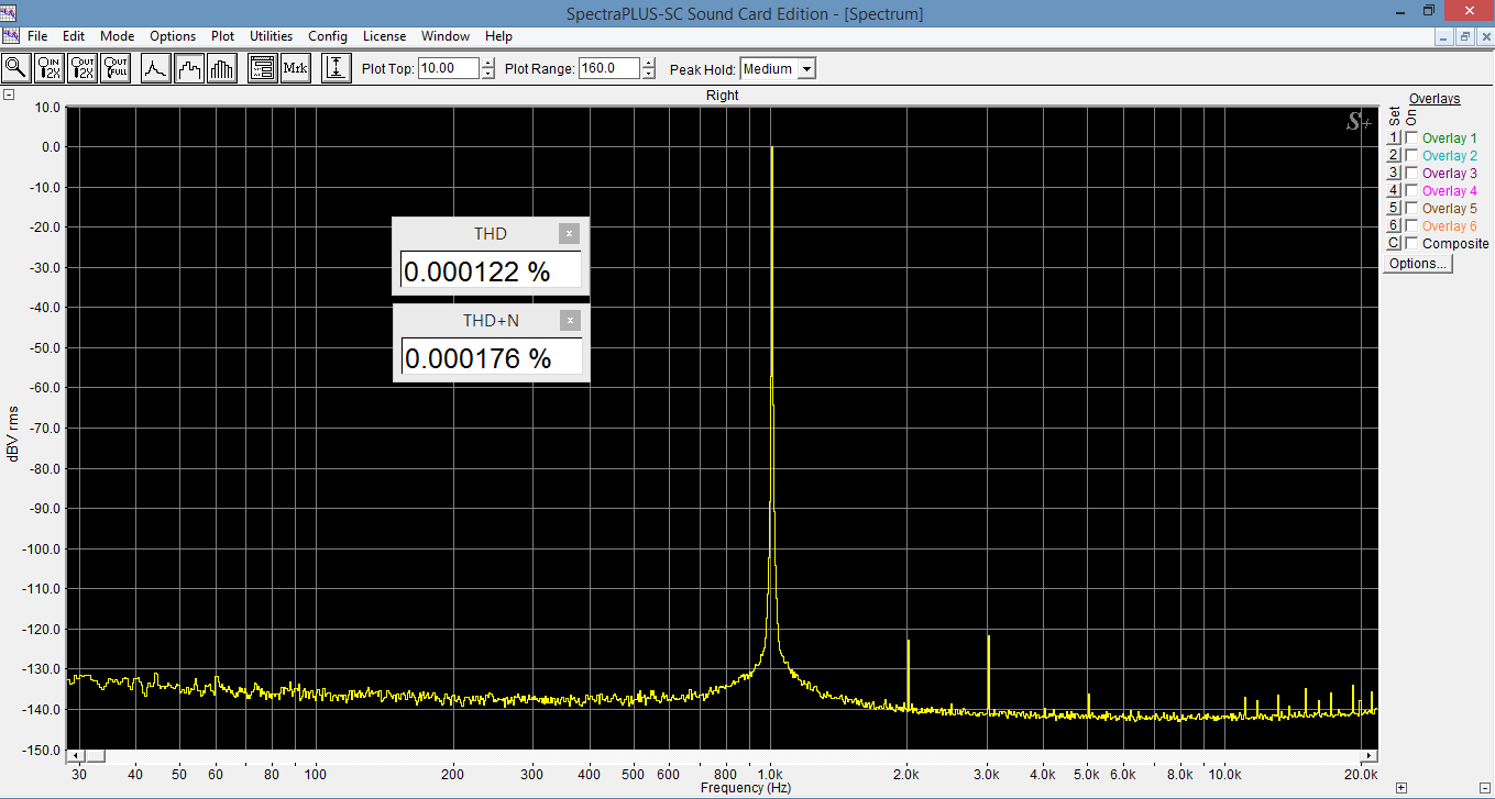

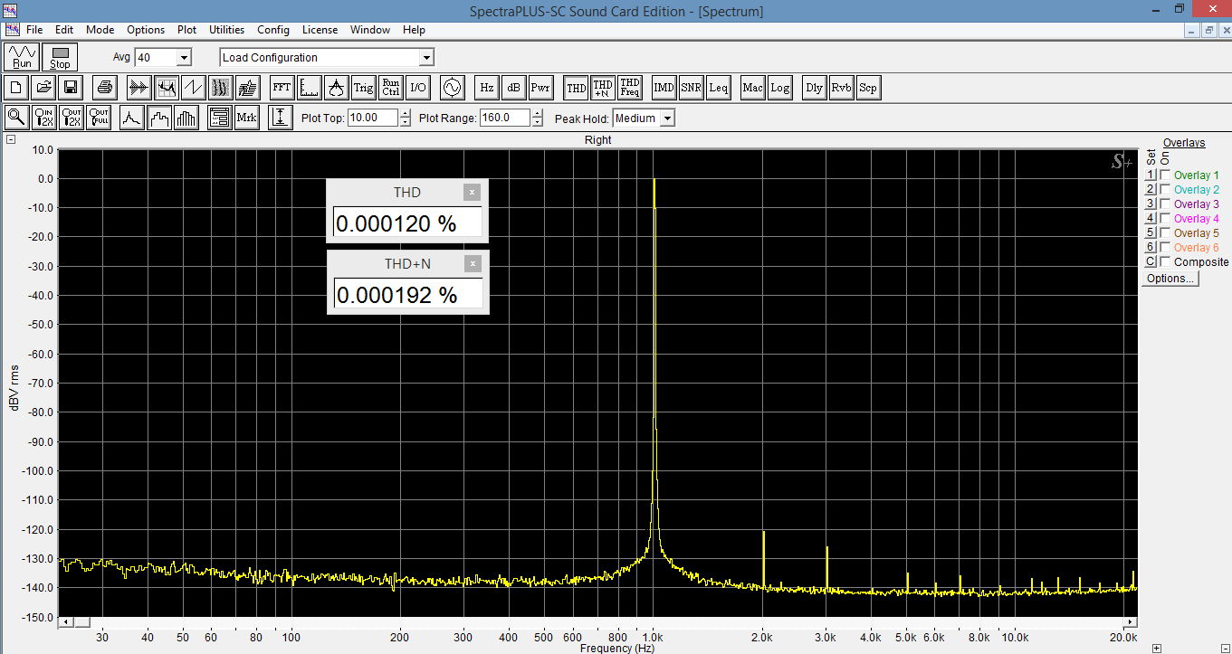

Hey Everyone,
I got around to assembling the new IV_2 board this week for the ADA4898 and testing it on Friday and everything checked out Ok. No oscillations, square waves look great, THD looks great, temperature is about 55C at +/-12V which is within a comfortable range. Unfortunately the solder mask didn't cover the vias underneath the op-amp entirely so I had to use some small thermal pads cut to size to prevent any shorts.
So I moved on to the listening test comparing two Blackbird DACs, one with an IV_1 that uses the LME49990 and the other with the new IV_2 board with the ADA4898. I attached THD plots for both DACs to compare. The first plot is of DAC one with the LME49990 and the second with the ADA4898. As you can see THD for both op-amps is basically the same.
So after listening to both DACs with a variety of different music the LME49990 just overall sounded better than the ADA4898. I wouldn't say it was a significant difference but enough to be noticeable. The sound-stage seemed wider, voices and instruments sounded clearer, just more lively. I'm not sure if the ADA4898 has a break-in period but I'll try listening some more later today.
