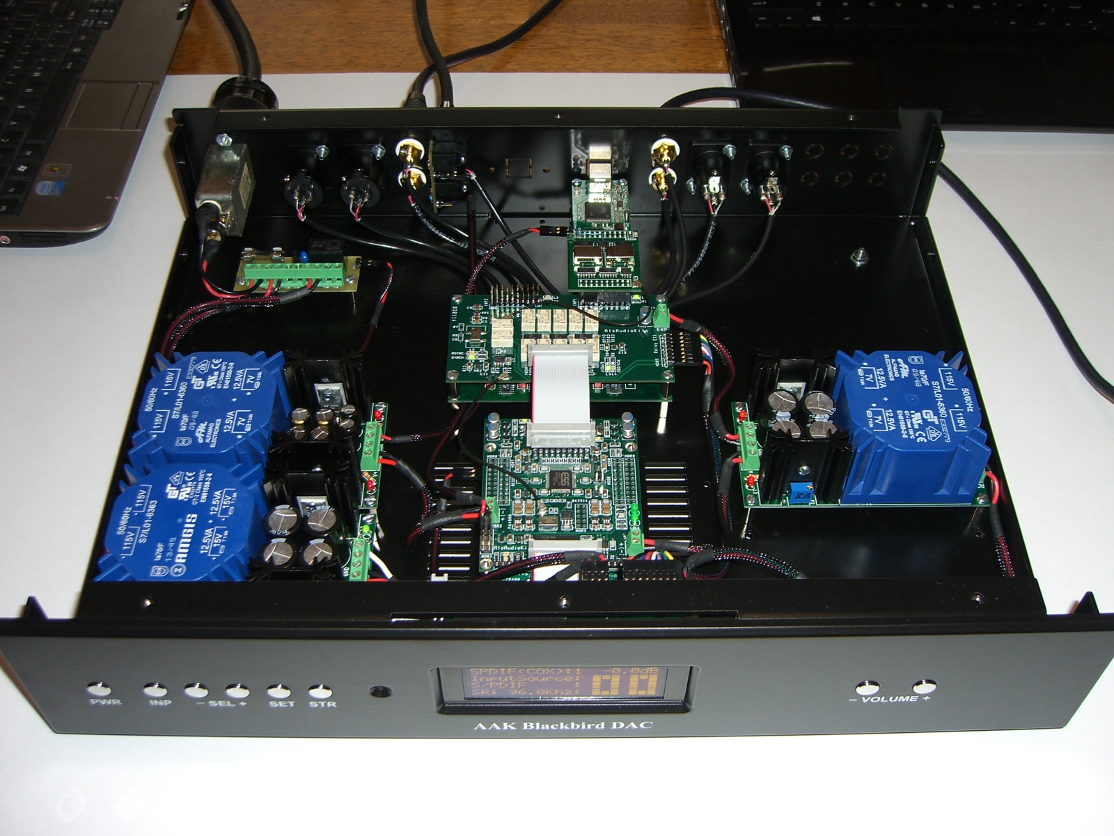

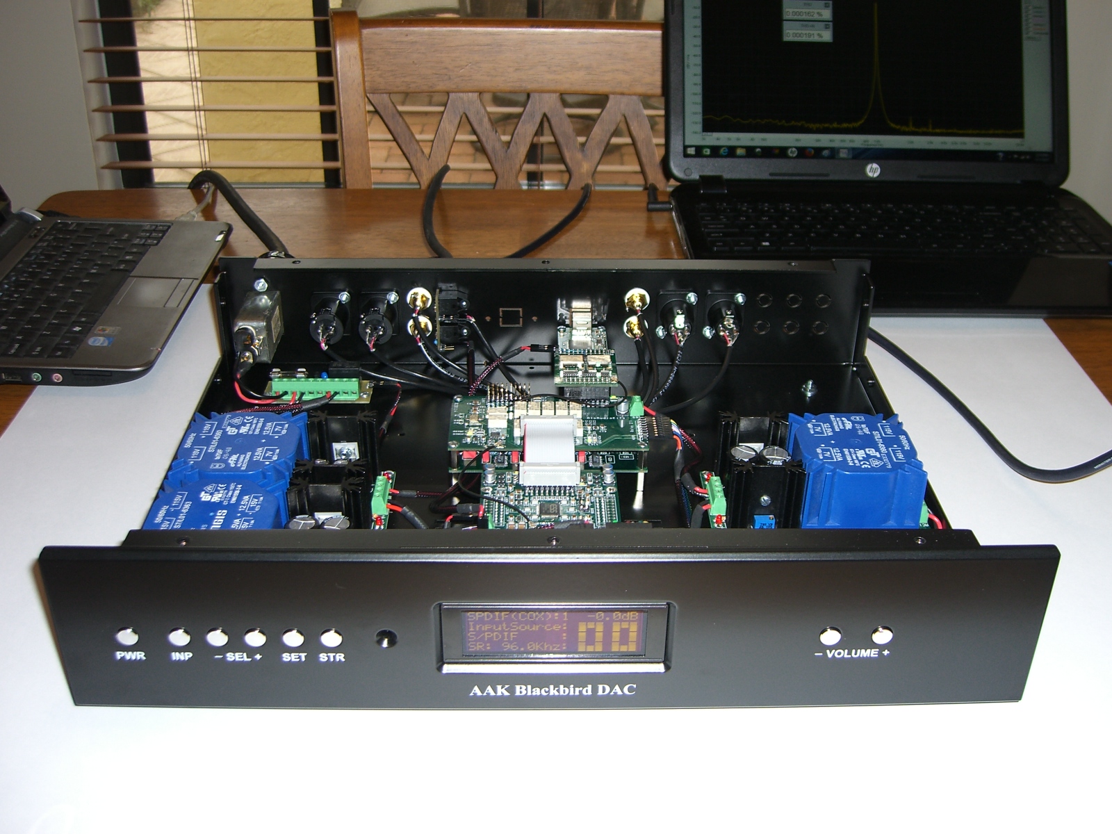

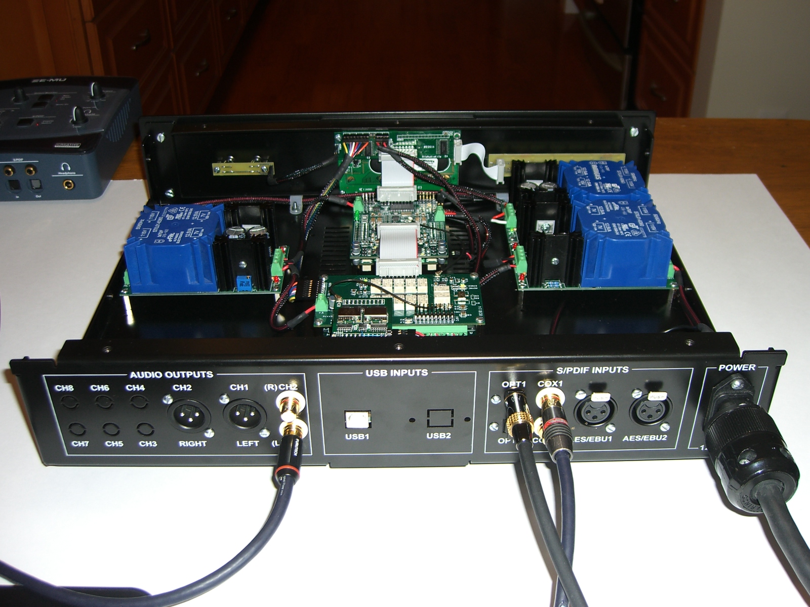

Here are some pics of a my stereo Blackbird ES9018 DAC with everything included.
