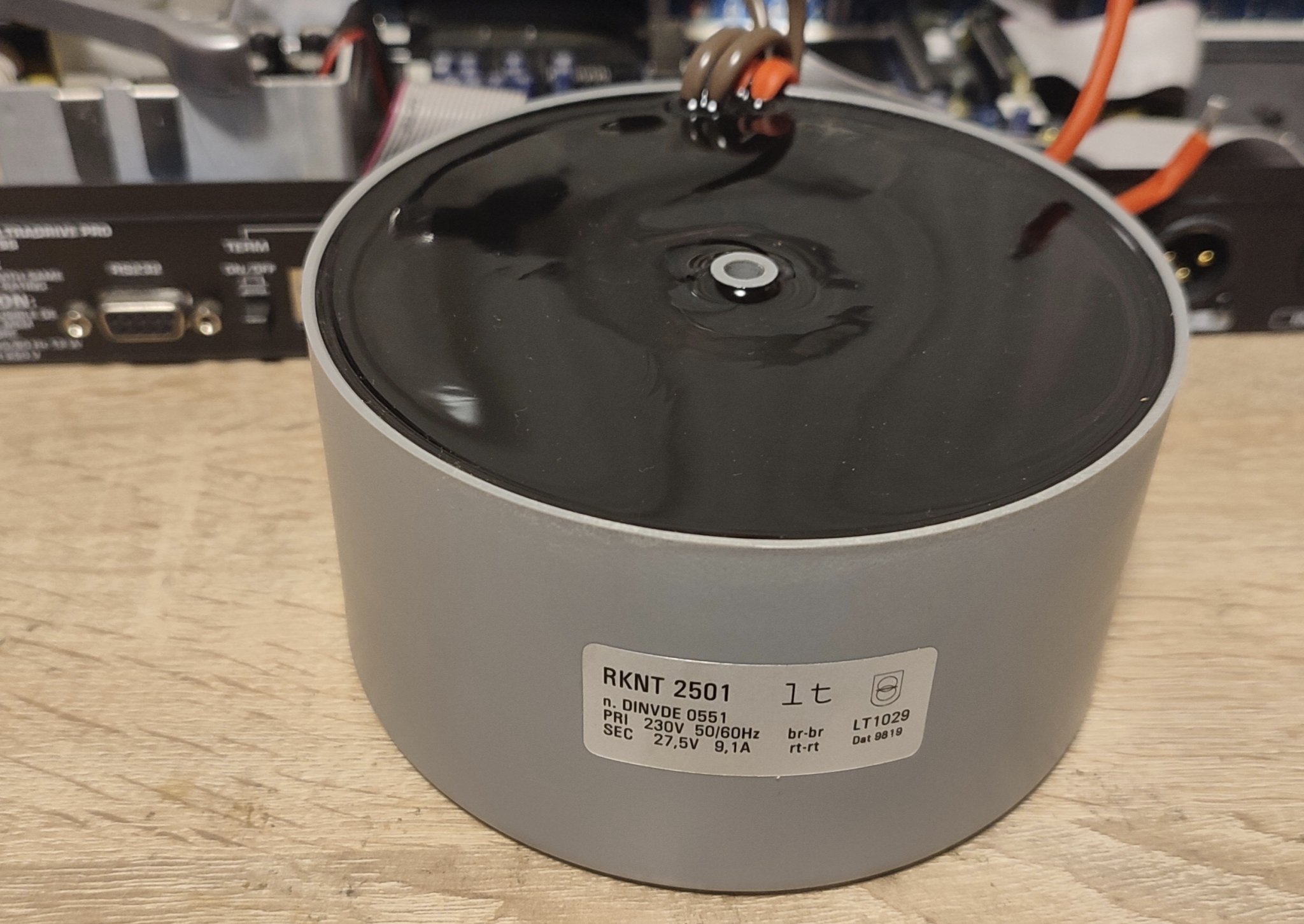

The transformer is good. It’s not clear how many windings there are for 27.5V? The amplifier needs 2 windings of 27.5V, or one 55V with a tap from the middle. For double mono you need either 2 of these, or one with double the power and a bunch of windings. Read at the beginning of the topic, all these issues were resolved there.If you have one winding, then this will not work.

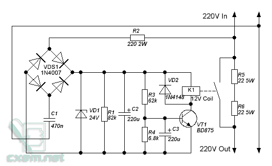

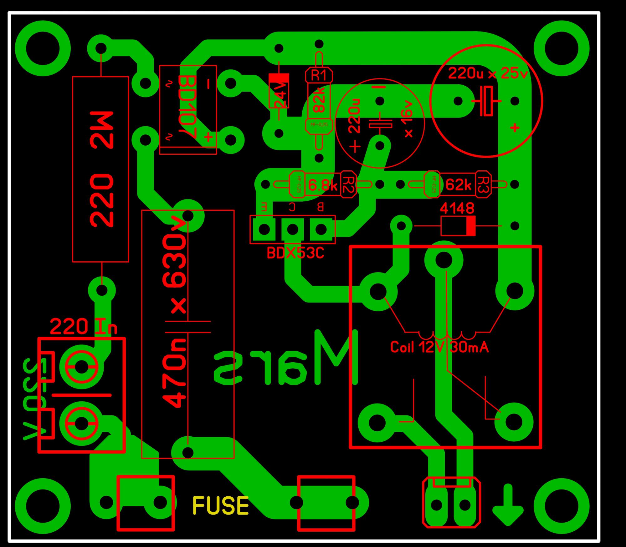

When I remade the A60 without a volume control, the question of soft start also arose, everything was in the kit. I decided not to buy, I have a lot of parts in stock. I did it myself in one evening. It works perfectly, without additional power.
