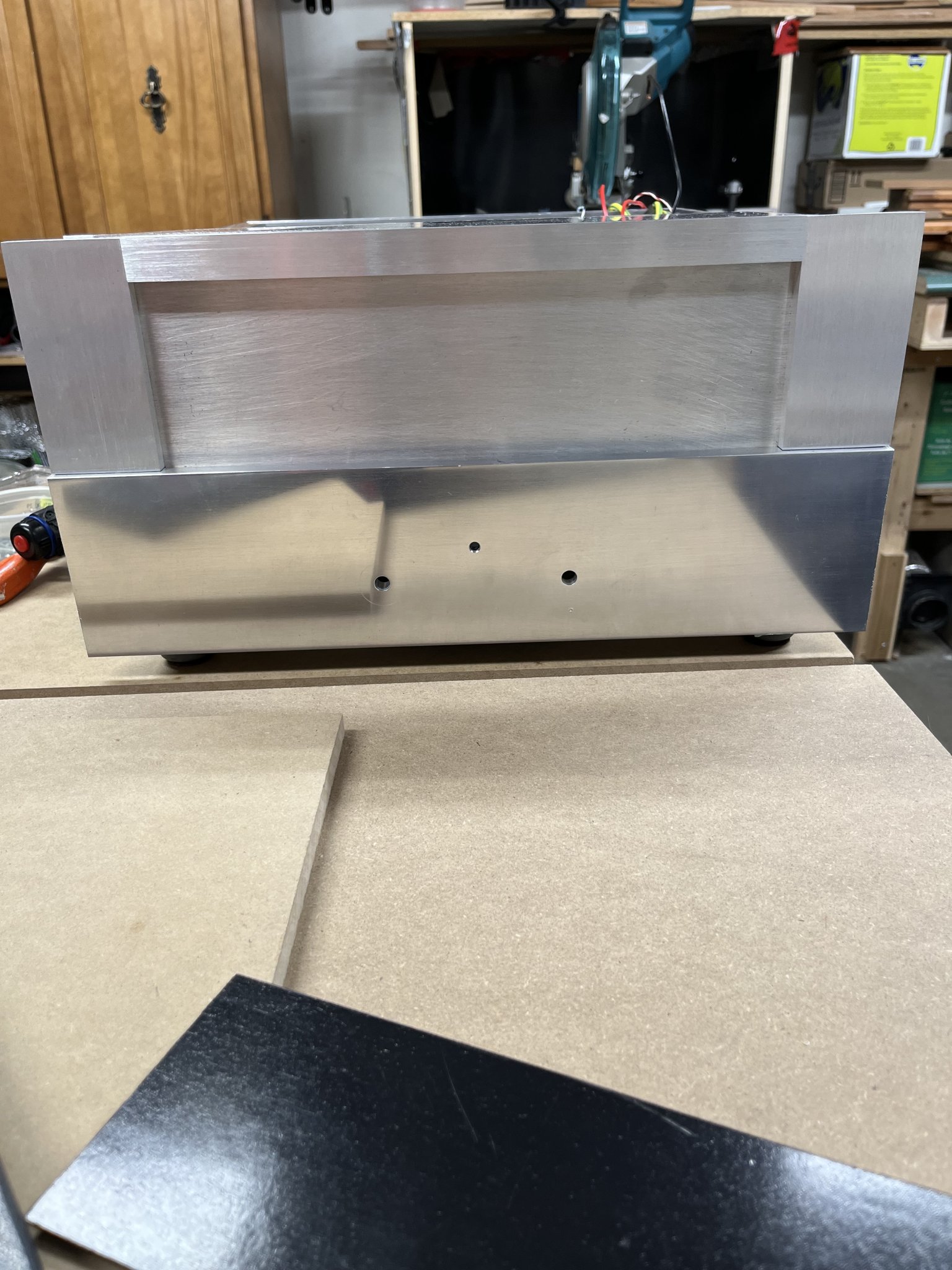

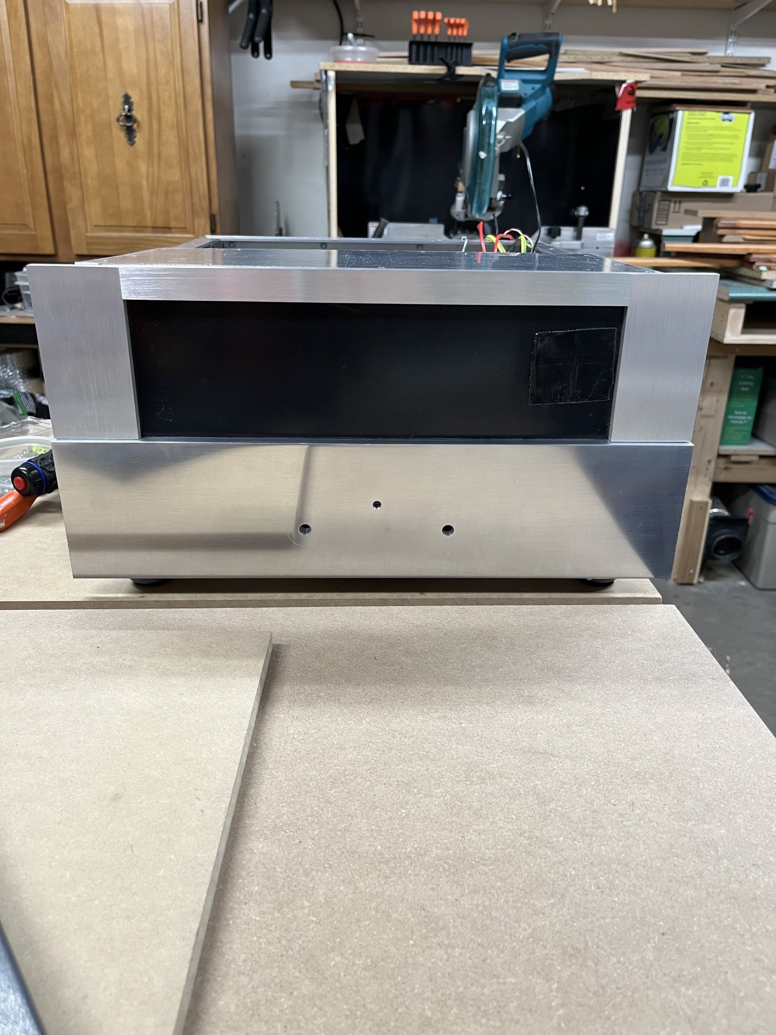

Hi folks. It’s good to see some activity here. i have been working on an A60++ for a while now. I got bogged down on the chassis build. After pricing 6061 at my local metal supplier I decided to build a chassis from bits of aluminum I had on hand. I would like your opinion on the 2 front panel options below. One option is to leave the bare aluminum and have 2 rectangular mounting holes for the meters. The other is to have the area blacked out with the meters installed and an acrylic cover over the entire area. In the photo below I cut out a piece of black plastic to size so I could see what it would look like. This is similar to what Accuphase and Luxman do on their amplifiers. There are pros and cons to both but I like the looks of the blacked out version better. The lower portion of the front panel is a 4 inch wide by 1/2” thick piece of 6061 that I had used in a tube amp I built almost 25 years ago. To replace that piece would be well over 100$ Ca. As scrap it is only worth 5$ so I decided to recycle it for this project. The 2 vertical pieces above and at the ends of the lower plate are about 8mm thick and the top frame piece between the 2 verticals is 10mm so I am going to bevel the edges to get a nicer look. The panel where the meters and indicator lights will mount is 1/8 inch 6061. If anybody has suggestions, comments or advice please let me know your thoughts.

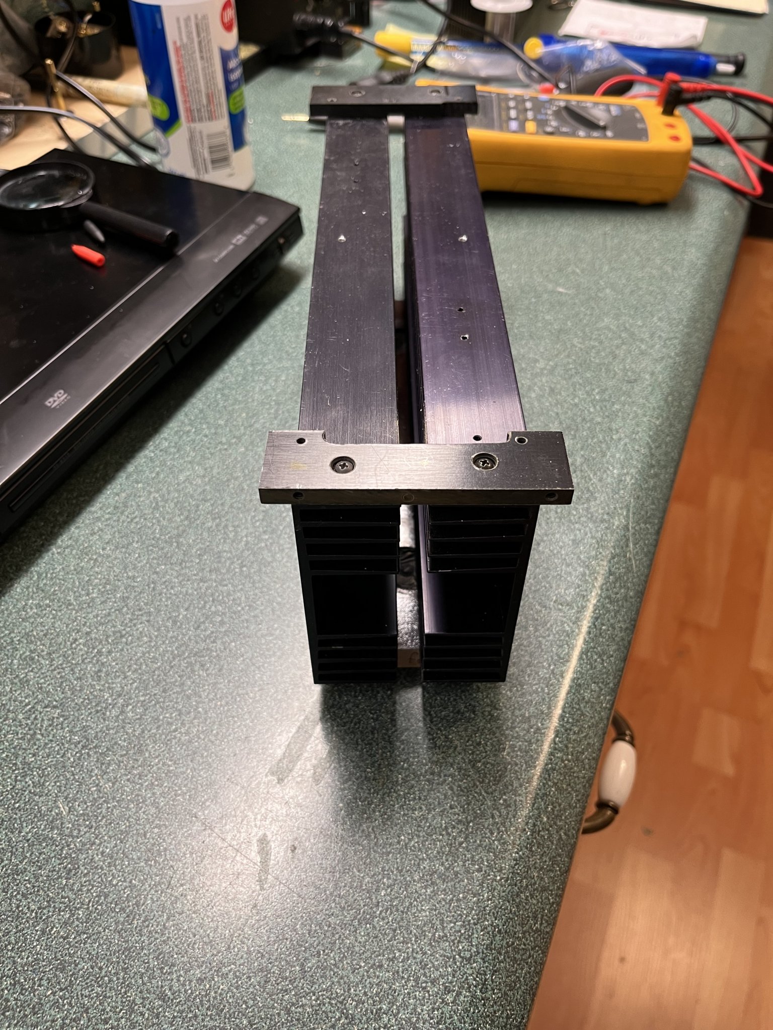

I have a simple question. With the stock feedback resistors of 33 ohms and 1k what is the final gain folks have been getting with this amp? I’m not sure how the current feedback arrangement will impact the gain. It looks like 30 which is also close to 30db. Input sensitivity would be around 1volt. I have a single 35v 800va transformer. I’m going with fan cooling and bias around 100ma/ output trans pair so 800ma total. Supply voltage tested out to about 45-47 volts with a simulated load. I have an NTC surge suppressor setup to limit inrush current and then bypass the NTC.

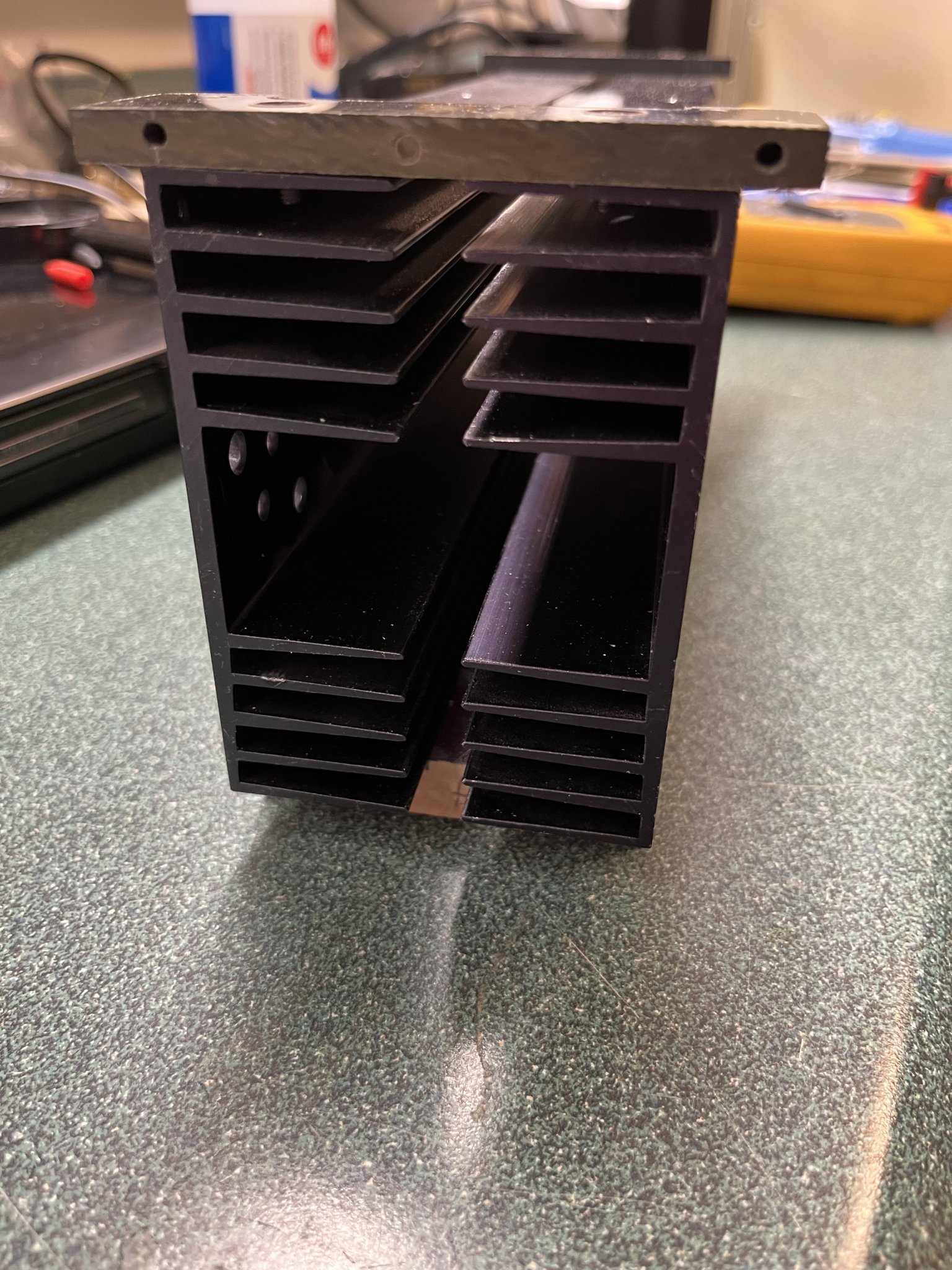

Heatsink arrangement is below. The board mounts on top of the heatsink pair and transistors mount near the top of each heatsink. They are roughly 4 inches high and 12 long. The fan mounts on the front side and the back side of the heatsink is at the rear panel where there is a grill to let hot air exhaust out the back of the amp. Air will be drawn through filters on the bottom of the chassis to the sides near the front. I tested this setup by clamping 8 25 w aluminum power resistors to the heatsinks and using a DC power supply to get 100w of power into them. Temps stayed below 45c even with very low air flow so it should be fine for my planned 80 w/channel or so.

True, but I cannot even temporarily mount the meters at this point. I guess what I am after is opinions on the black background type of meter mounting like used by Accuphase and Luxman for instance, versus the bare meter mounting on the front panel as used by the new Technics and Yamaha amplifiers.It’s still not very clear how it will look with indicators?

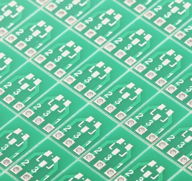

2sc2713 and 2sa1163 i bought at Digikey.Interesting. Where could I buy these SMD transistors?
Also need adapter
2SC2713/2sa1263 is 150-200 mw power dissipation device.

Thanks, I already have adapters. I just have to order from Digikey.2sc2713 and 2sa1163 i bought at Digikey.
