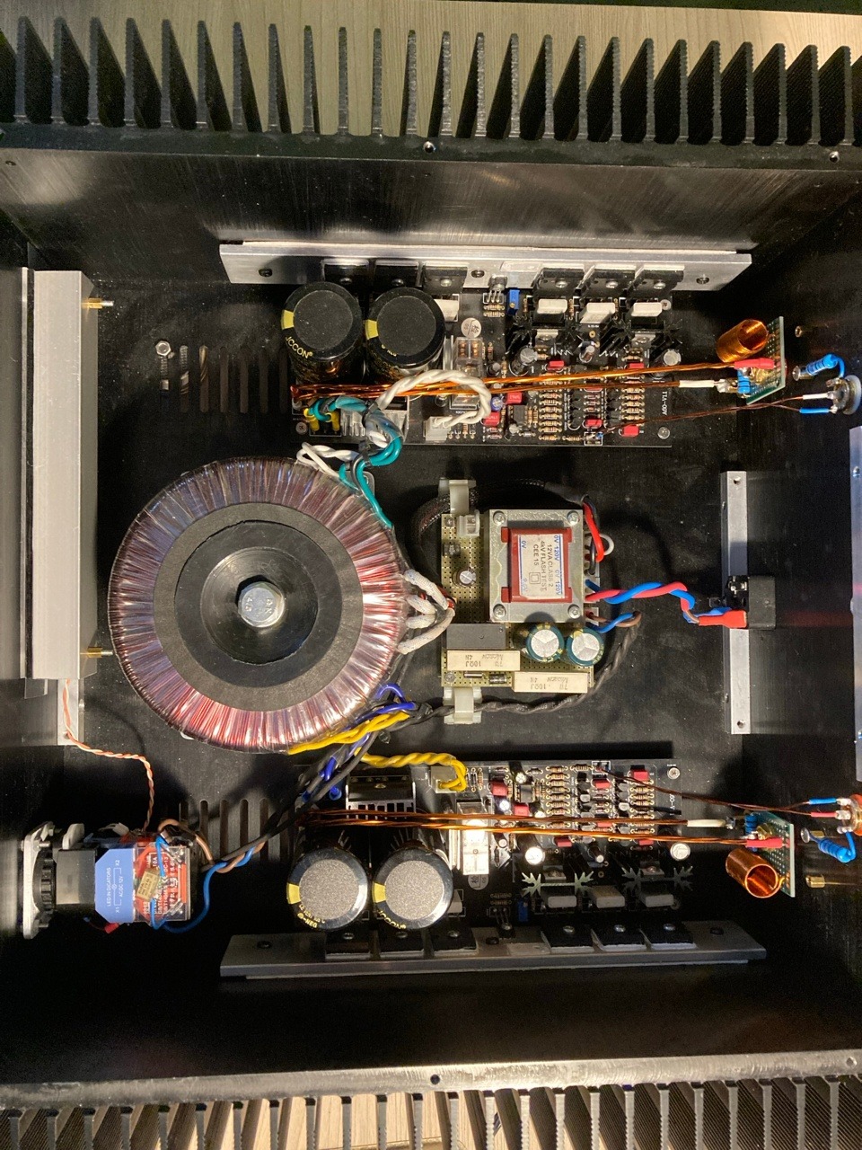

My coils are installed at the output terminals. There are no problems.

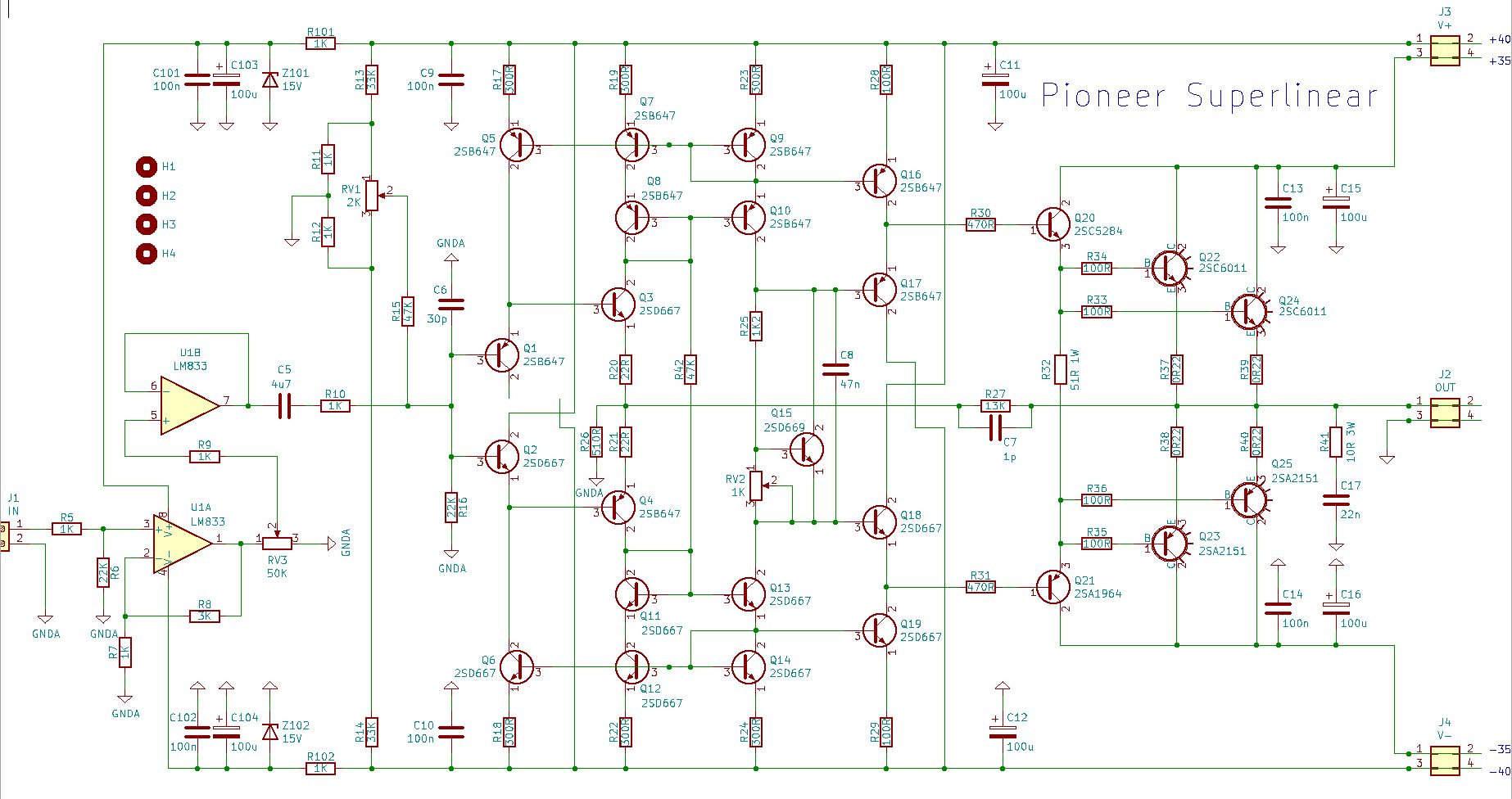

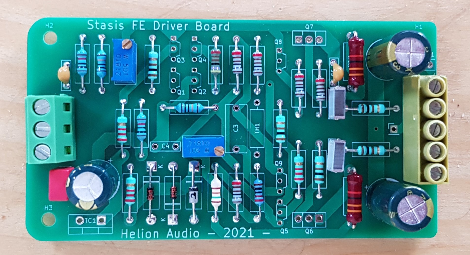

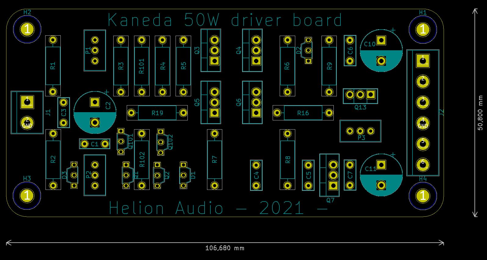

Hi!

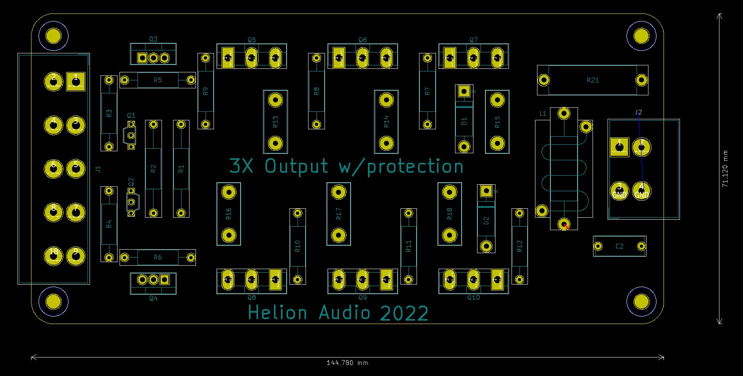

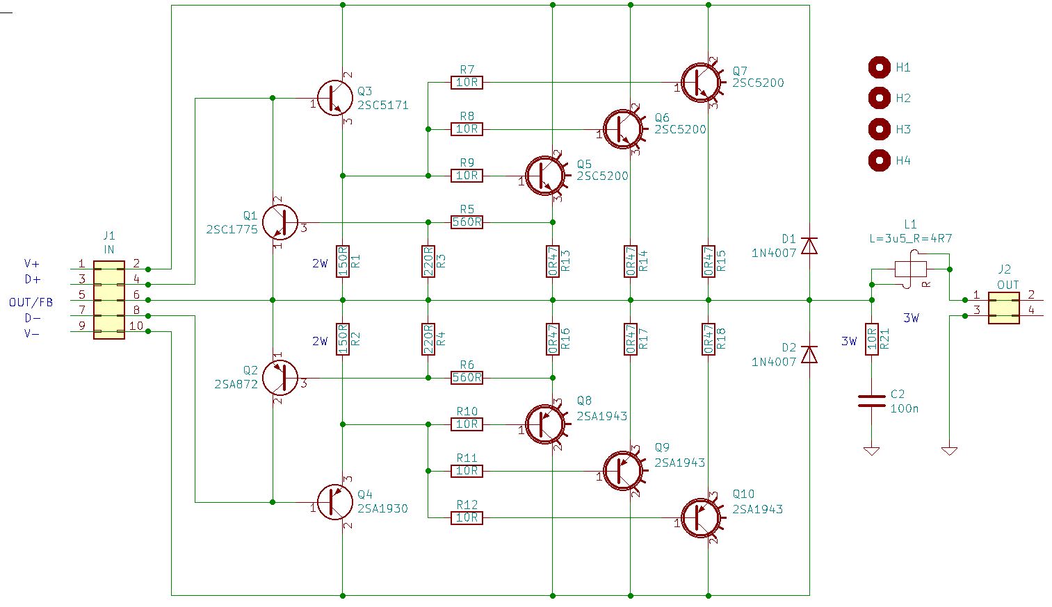

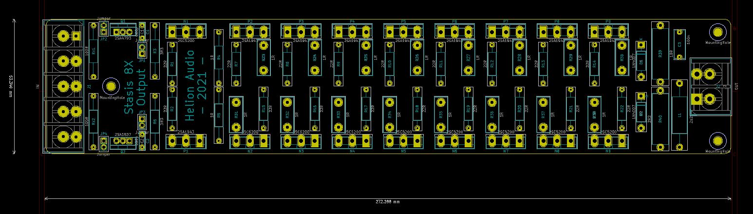

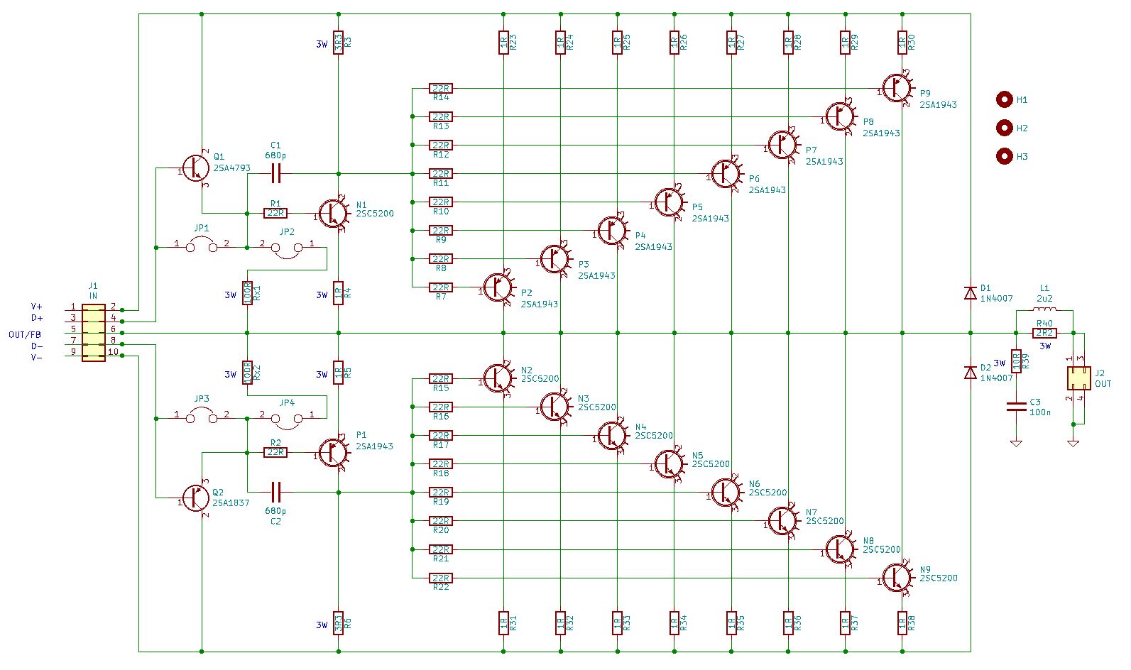

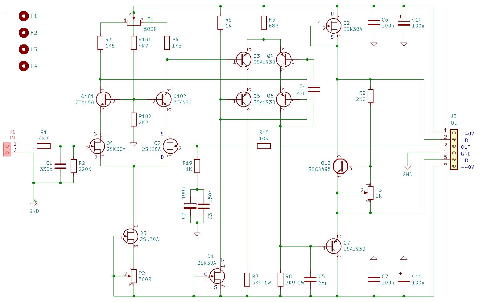

Yes, I have made some PCBs the last few years. So far, only the Pioneer Superliear has benn build (by a friend of mine). We played it a couple of weeks ago, sounde fine, but noe measurements. For myself, I am soon able to test 2 amps, the Kaneda 50W and Passs Stasis FE. These two ar made as driver board, so they need output boards to work.
I still have the A60 waiting to be built, but I am really SLOW! 🙂
Anyway here are pictures of the three amps mentioned:
I have made several verions of output boards. The first I will try with the Kanea is this:
So the Stasis:
PCBs are made with KiCAD and I will happily share files with anyone who wants to use or modify the designs.
Hope this answers your curiosity!
🙂 morten

Hi!
So the Stasis:
🙂 morten

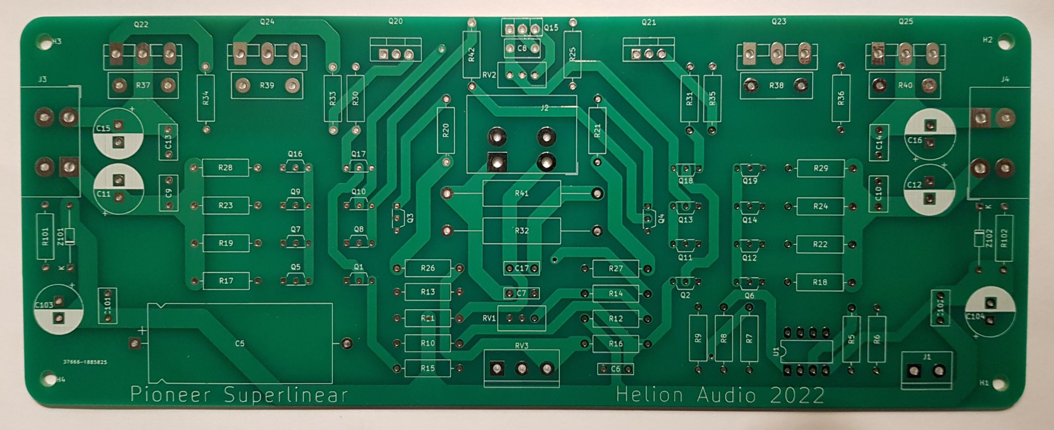

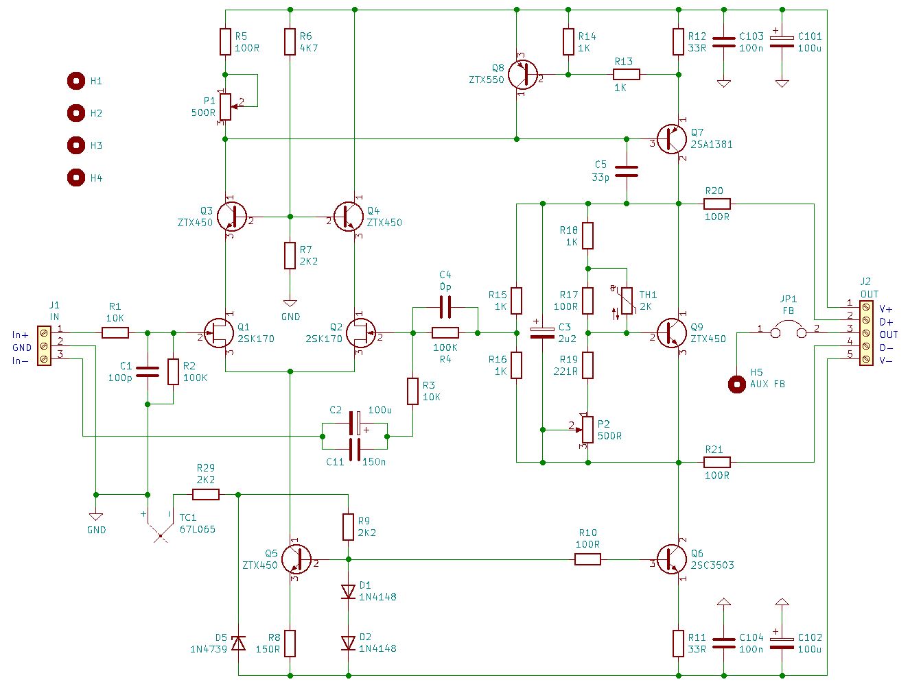

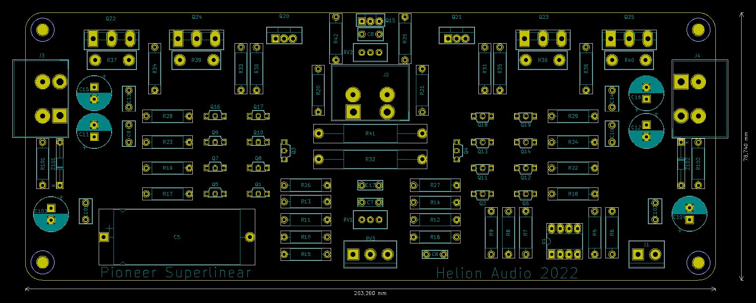

I have made KiKAD schematics for A60 and MA9S2 if you would like to have a go. Se attached files.
As for the FETs, I agree. Only reason for me to try the Kaneda is that I had a few 2SK30A in my drawer. (And the man is a legend too..)
I enclose the Superlinear as well, since it has the PCB included as well as the Gerbers. You may not need all the Gerber files, but with these I did get the boards made!
Here is the Superlinear PCB:
Wish you luck in deciding and building!
m0rten
What Pioneer Superlinear amplifier model is here ?

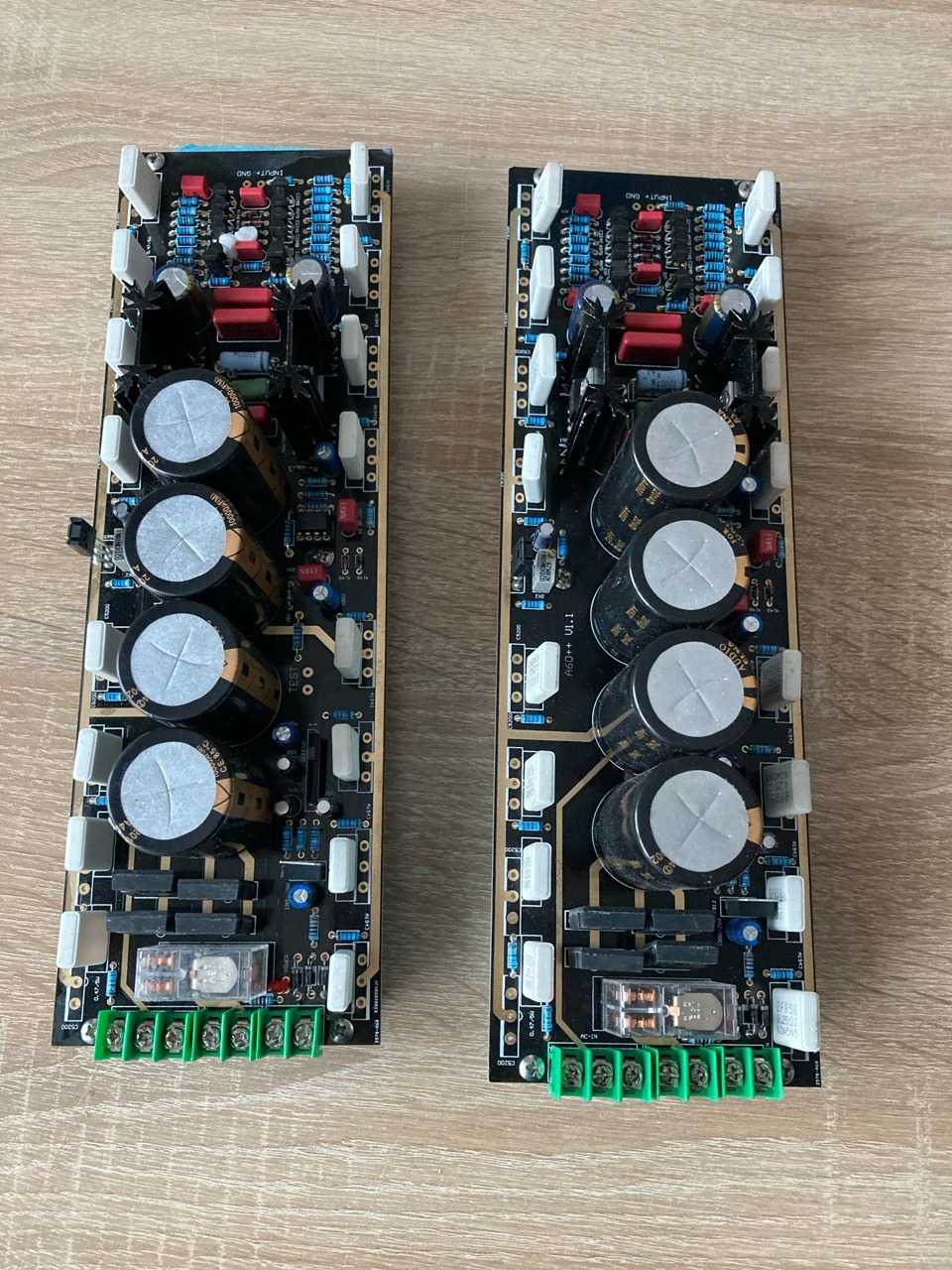

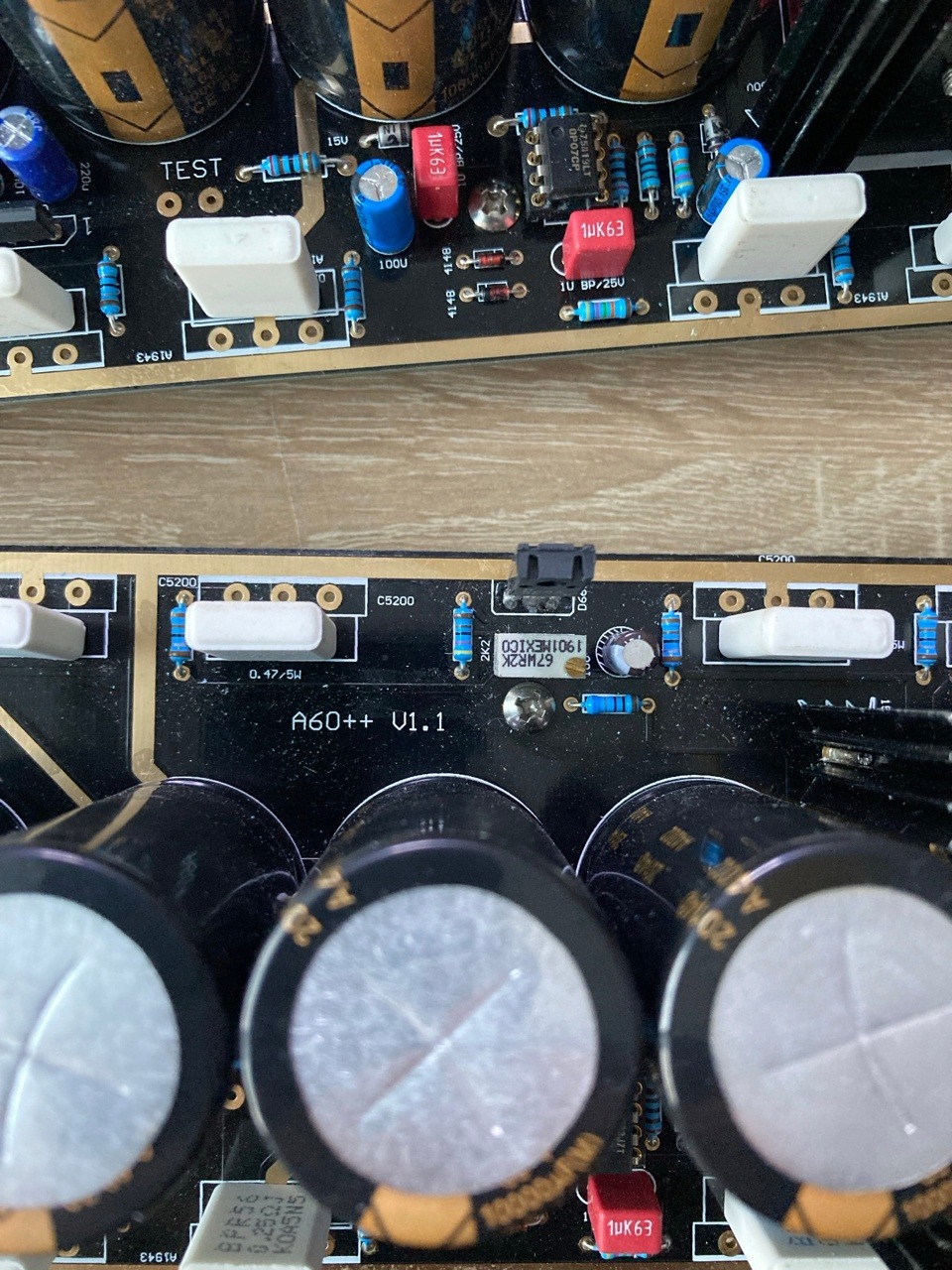

I ordered a kit for self-assembly without capacitors and output transistors. The price was a little more on sale A60. The seller sent everything assembled, with power supply capacitors, but without power transistors. The soldering is good, the equipment is also, version A60++. I need to check everything. I think the seller is from Waileng .

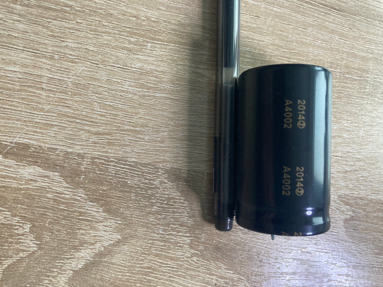

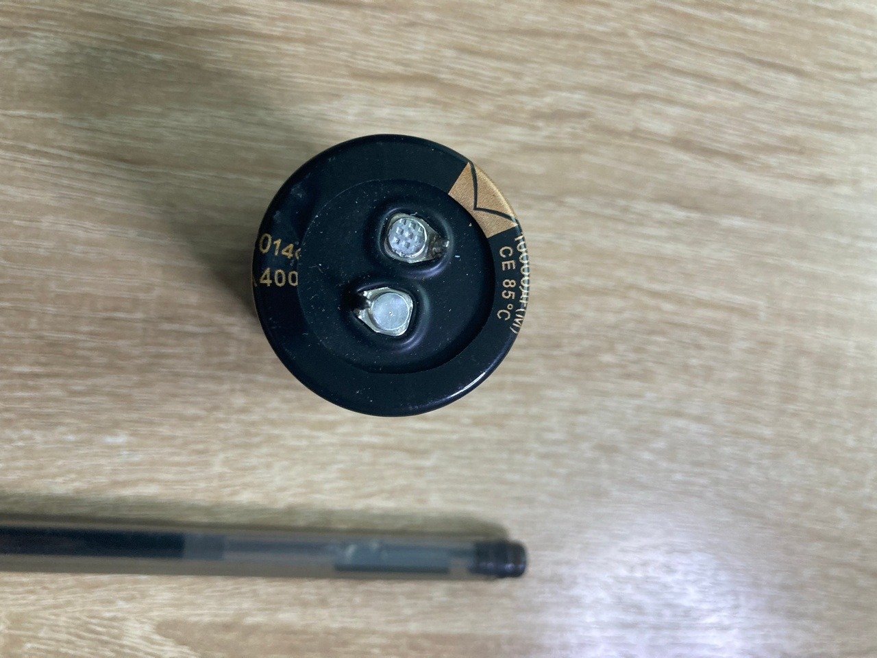

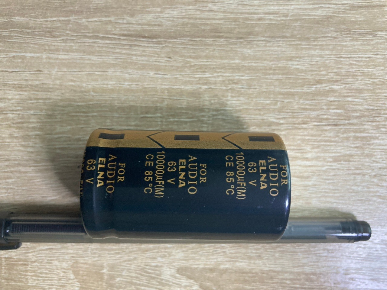

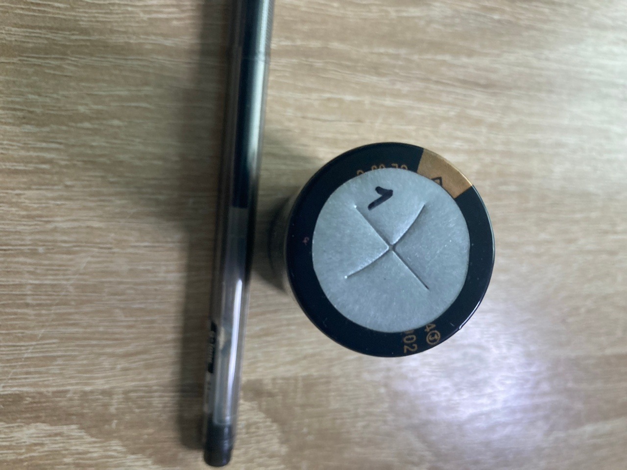

Hello everyone. Has anyone come across this Elna? I found information that after the flood in Thailand the plant was moved to China. This is a replacement for the LAO series. Parameters 9300-9500 uF, esp = 0.02, Vloss = 0.6%, weight = almost 49 grams. Reviews on them good. Will they be enough for the A60+ power supply? Or should I put JCCON 12000 uF?

Paroxod4 - Those caps look like they were manufactured in 2014. So almost 10 years old. The fact that they measure 5 to 7% lower than the label rating of 10kuf could be an indicator of age or also that hey are not true Elnas. They will probably work just fine in an A60 amplifier but you should consider the trouble factor of having to swap them out against the cost of using new parts bought from a reputable source.

The capacitors are new, so they show a lower value, tolerance + -20%. After molding, I think they will be fine. In fact, I haven’t even seen many original ones (there are some in the storage room) that have accurate indicators. Nichikon KG new ones were 6200-6300 microfarads, after working for 1 month in The amplifier became 6850 microfarads. But the Sprague 67000 became 75000 after a week. You probably meant the 1237 microcircuit?
Currently, you can’t buy real original parts from us. And what is an original? Almost nothing is produced in Japan, it’s expensive. There is no sales. 95% of production has been moved to China, where we have to buy. But China is normal, we need to monitor for a long time before purchasing. If the parameters are normal, then why not believe?Where can I buy 8 normal capacitors at a normal price, and not the price of the entire amplifier?
