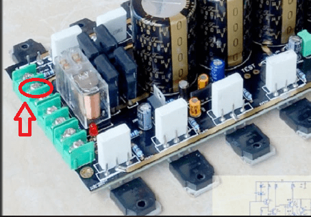

Hi Berlusconi,This post is important. No chit-chat.
A snapshot below shows how to connect individual parts into completely silent amplifier. The amplifier was assembled with longer wires with aim to enable expanded view with every connectio visible. In actual lay-out wires should be as short as possible.
In this particular case I’ve used a single power supply with a single transformer. Yet, the amplifier is as silent as a graveyard in desert at midnight. There are no undesired sounds whatsoever.
Let us start:
1. AC supply goes through a soft-start.
2. output from the soft-start diverges to: A. main transformer and B. a 12V transformer with two separated secondaries.
3. the 12 VAC secondaries are connected with twisted pairs of white wires to the »AC« terminals on the boars. Note, however: polarity is not important even though there is a »GND« label at the »AC« terminal. This is just AC power supply for speaker protection. It is important to have separate secondaries, otherwise a single transformer directly connecting boards will create an ugly hum.
4. Obviously, four outputs from the main transformer are connected to AC inputs of the main power supply.
5. If you have a rectifier bridge installed on board, de-solder it and connect power supply there, instead.
6. Positive rail of the power supply is connected to the + side where a rectifier bridge was built-in.
7. Negative rail of the power supply is connected to the - side where a rectifier bridge was built-in. It is on the side opposite to +.
Now important: grounding.
Make a star on a screw and separate individual connections with metal screws. This assembly must be isolated from the chassis.
8. First, connect the power supply ground to the star and fix it with a screw.
9. Next, connect the »OUT« terminals from the board speaker outputs to the star, with thick wires. Complete this connections with a screw.
10. After that, connect speaker return wires to the star. Again, fix these wires with a screw.
Now, even more important:
11. Connect the RCA grounds with a wire as short as possible. It is desired to have RCA connectors as close to each other as possible. This will eliminate the nastiest ground loop. Important: RCA Connectors must be isolated from the chassis.
12. Now, connect one of RCA grounds with a single wire to the star.
13. Connect RCA inputs to »INP+« terminal of the input terminal at the board.
14. DO NOT connect »GND« of the signal input to anything. Return path for the signal »ground« is already provided at the star. This is essential part of everything.
Note: Separation of individual connections with screws at the star ensures that currents flow in the direction of the most intense currents. Note that the signal ground is the most vulnerable and is placed at the end to guard it from intensive currents.
15. To further improve the sound, you may install a 1K resistor at the signal input of the board between »GND« and »IN+« terminals.
That's all.
Thank you for details explaination of how to do grounding with this.
A few question:
1. The steps here are for when you externalize the power supply unit from the PCB (hence step 5,6,7), and have a dedicated power supply ground to connect to the star point (step 8). If there is no external power supply, and the transformer is connected directly to the PCB as of this board version (https://vi.aliexpress.com/item/1005001670632239.html?gatewayAdapt=glo2vnm), where do i find the power ground to connect to star point? Can i directly connect transformer ground (second terminal from the right in the input section of pcb) to star point?
2. Why mustn't we connect GND of signal input to anything? according to hifisonix article (https://hifisonix.com/wp-content/uploads/2021/04/Dual-Mono-Wiring.pdf), he still use two wire cable for input signal throughout to the PCB. What he did different is connect the input ground to chassis via a capacitor (i actually don't understand that part of him as well. if you can explain).
3. At step 15, you said install a 1K resistor between GND and IN+. Do you mean shorting GND and IN+ with a resistor? why would that improve the sound? why don't we connect signal ground directly from RCA to GND on PCB?
Hope you can understand my English. Looking forward to your reply. I have this board prebuilt given for me as present from my colleague but suffer from noise/hum so i'm trying to learn to improve it.
Thank you.

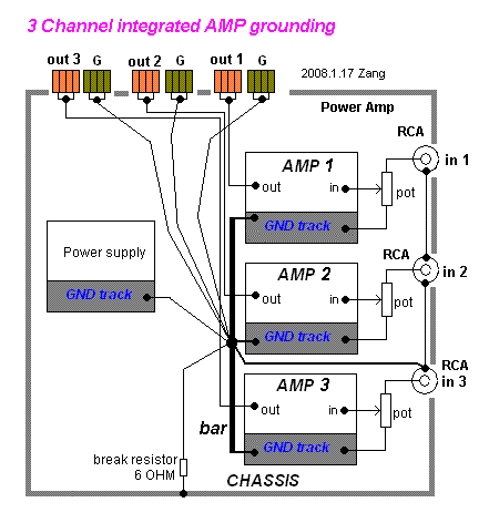

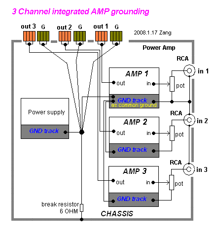

Hi anhhct,
1.
First, please go to thread "understanding star grounding"and read just posts #1, #2, #4 and #7 by member digi01. He brilliantly addressed the problem of grounding in a concise and clear manner. You don't have to read anything else there. Another useful source can be found elsewhere in an article "A Complete Guide to Design and Build a HIFI LM3886 amplifier" by by Scott Campbell, section "Designing the Ground Layout".
Now, look at the diagram (author: digi01) below from the thread "understanding star grounding".
It is possible to mathematically prove that in a multi-channel audio amplifiers all "return paths" must be connected at just a single point to avoid interference among individual channels.
Note that RCA connectors are connected together and then connect to the star point. This provides return paths for all inputs without violating the rule of a single connection.

1.

Thank you for the explaination and recommendation of the two resources.
I've gone through them and get a bit of hang about grounding. Even though it's still unclear to me how star grounding can be mathematically proven to reduce noise, proving it is not really neccessary, as it's a standard used by many.
What i'm still struggling to figure out, is where would be the main power GND, to wire to the star point? Since i don't have an external PSU, the PSU is onboard with the amp module. And i will have two of them. Should i connect the two GND post on the main input station (circled in picture bellow) to the star? That position is for connecting the transformer GND wire into the module, and it is before any capacitor or rectifier. If i use it as the point from which I wire to the star, is it the correct way to have power GND and signal GND together?
