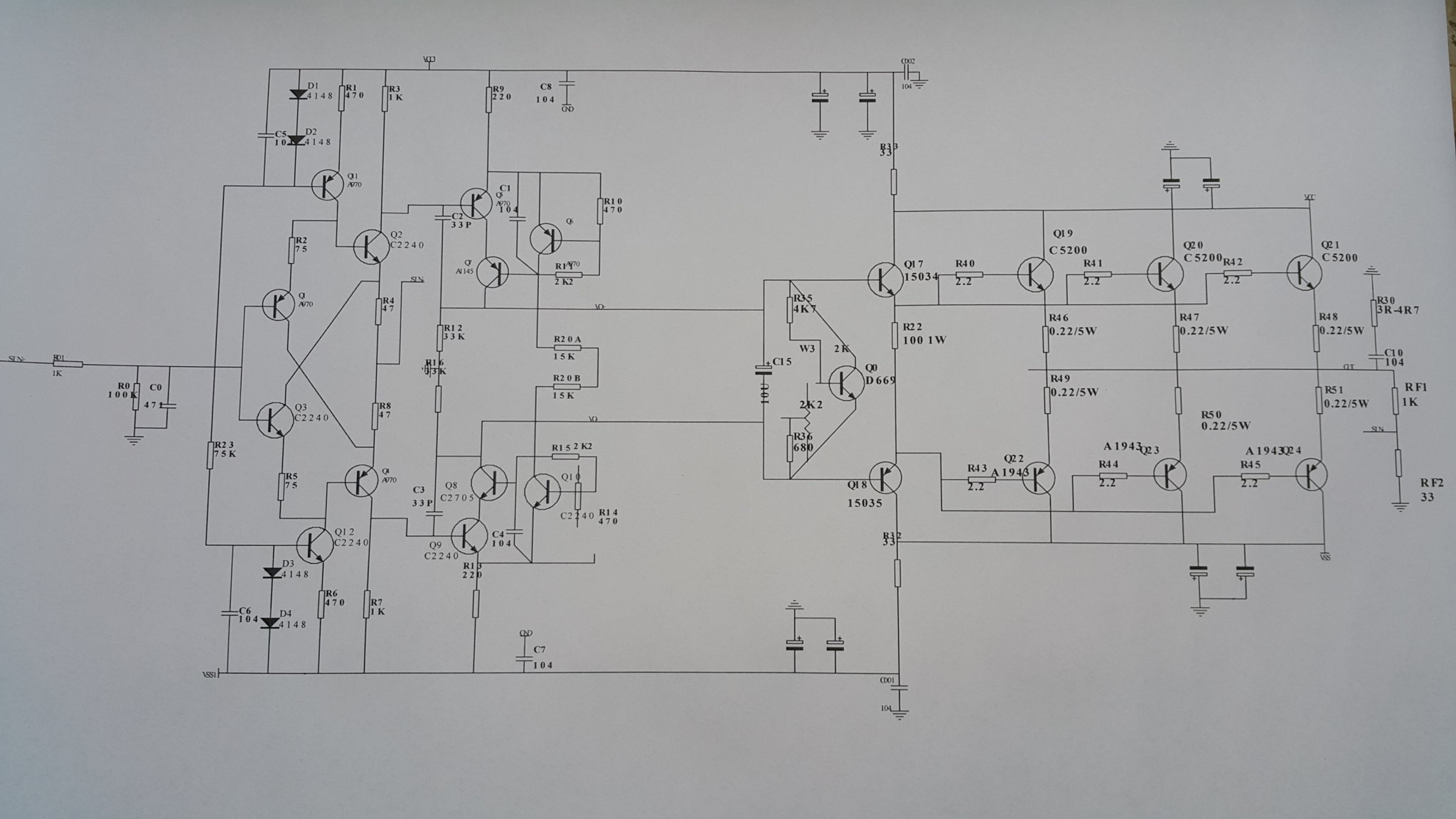

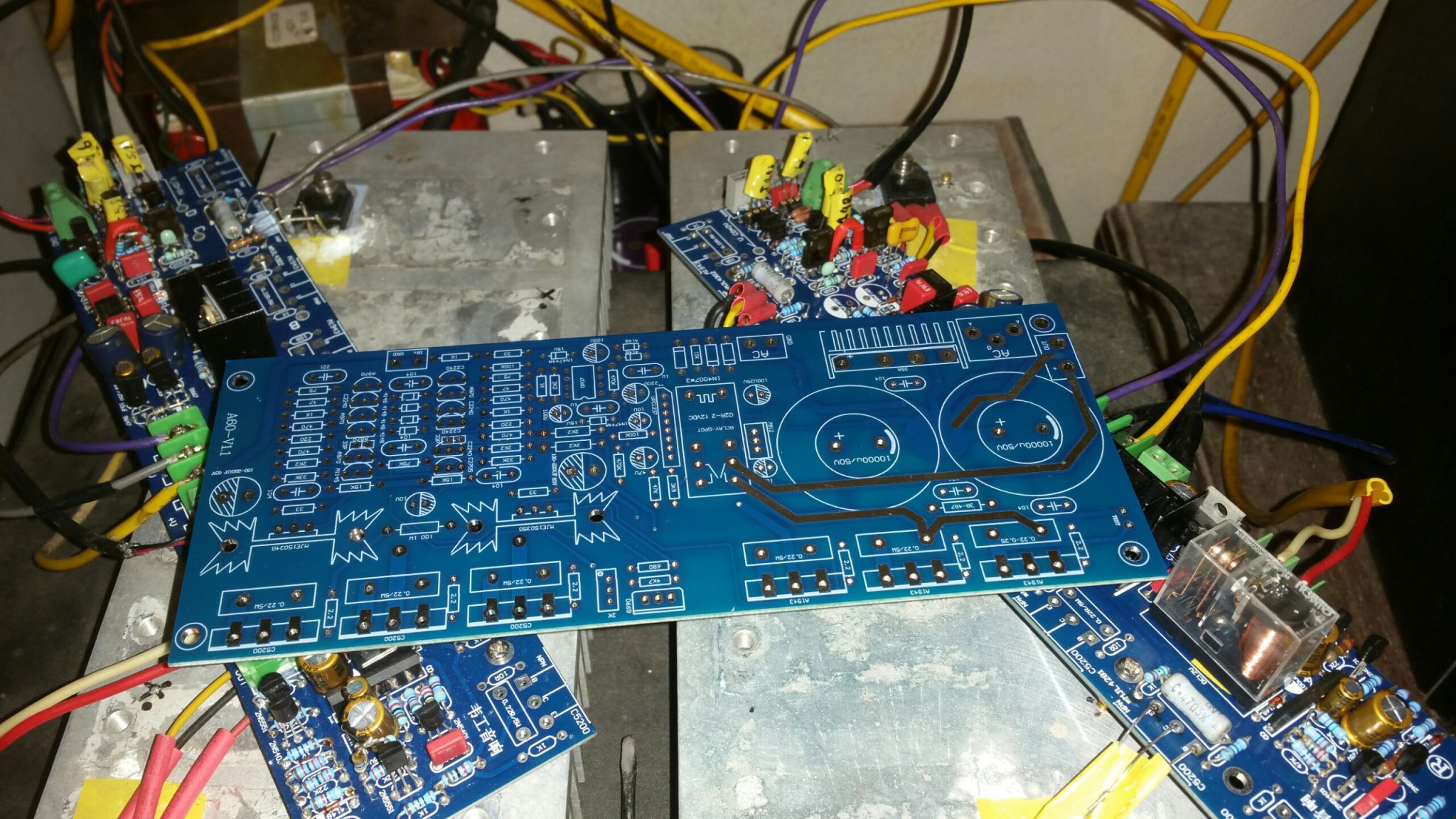

Dear Berlusconi! i have bought pcb from china, and am about to build A60. I have read many of your articles about this. There are a few issues I hope you can help me with:
1. Do you use A970/C2240 rank BL or GR? I don't have A970/C2240 so I use A992/C1845, does it affect the sound much?
2. the transistors need to be matched in pairs according to the schematic?
3. Can 47R resistor be replaced by 51R?
(Because I don't know English, I should use Google translate, if there are any mistakes, please forgive me). Thank you!
Welcome aboard Danghunglshb 😎
Don't worry, your English is flawless - we understand each other. Just look around the world how many variants of English exist but it is important that it serves the purpose of enabling communication.
For this project I use CDIL TCSA970GR/TCSC2240GR (made in India) and I was able to achieve low THD+N values. It is rational to conclude that they produce adequate semiconductors from practical point of view. Some people believe unfounded gossip/prejudices, I believe in measurements.
I have also tried with OnSemi KSC/KSA "close" equivalent semiconductors but in this particular case, CDIL was adequate, according to measurements.
All SA970GR measured hfe about 300, uniformly, with slight deviations.
The most of SC2240 had hfe 288 with few exceptions up to 335.
Interestingly, I was able to match transistors reasonably close although "complementary" transistors are often complementary just by name. But I believe that this amplifier isn't sensitive to slight mismatch. I have also several "finished" boards from China and I don't think they were wasting time with matching. Yet these boards measure well and sound fine. So I believe that some strict matching is not so important.
I am not sure about the possibility of replacing 47R resistor with 51R. I dont think that would have some noticeable impact.
Please, do not hesitate to ask in future. I would like to be helpful.

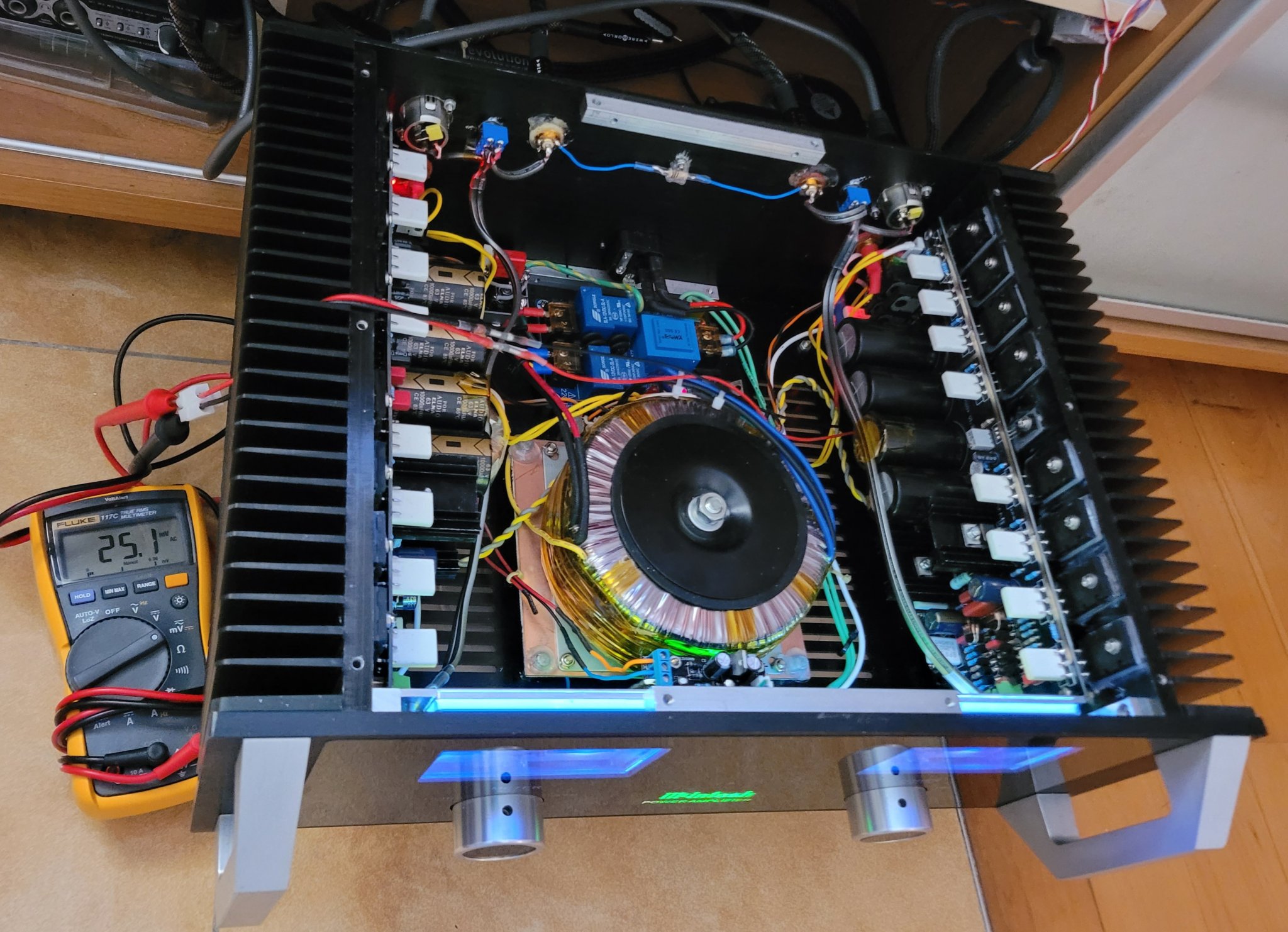

Hi garfieldso,
Firstly, welcome on board.
I have tried all possible settings from 20 to 60 mV. The increase from 20 to 30 mV has more pronounced impact both on THD and sound quality. On the other hand increase from 50 to 60 mV has just a marginal contribution at the cost of signifficant temperature rise. So the sweet spot is somewhere from 30 to 40 mV.
However, it all depends on your heat sinks. As usually I use 0.3 K/W radiators and I was able to safely adjust the quiescent current whilst observing temperatures on all individual output devices.
Therefore my advice is to first burn-in your amplifier over a week or so at lower levels. After that period you may start to gradually increase the quiescent current while observing temperature. Turning in the counterclock direction increses the QC. Stop at 45° to 50° or even earlier if it results in good sound quality but never let temperature rise to higher values. Note that after the increase of the QC temperature will rise but the actual QC value will decrease and then stabilize at some lower value.
In short: Don't push too hard.
Good luck
PS: Meanwhile I have improved my THD measuring rig and will make more measurements somewhere in Januarry and will get back with more data. However note that this amplifier doesn't have infinitesimally small THD but contribution of the dominant 2nd harmonic makes its sound so convincingly good. It simply sounds right to my ears.

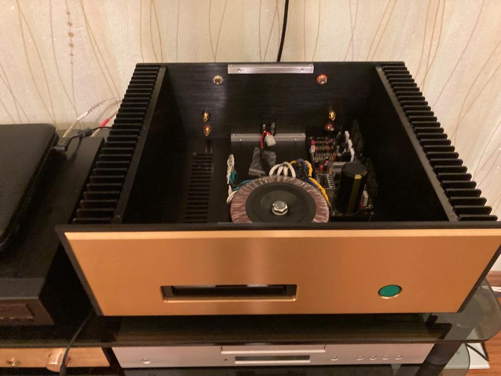

Hi Berlusconi,
Thank you so much for your detailed explaination, very useful. I am using an old chassis to fit in the board, however the length of case is marginal to fit in, and the heatsink fins is around 2 inches thichness. Therefore the heat dissipation may not be sufficiently for higher quiescent current upto 50~60mV. I will follow your instruction to burn in a week and observe the temperature level, I started up at 25mV.
  • Thank You
Reactions: Berlusconi

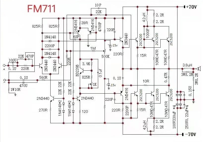

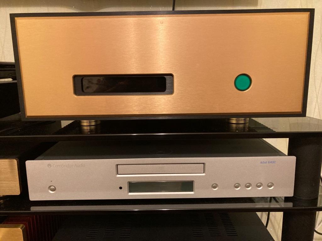

I wanted to switch to the FM Acoustics 411(711) project, but after looking at the diagrams and following the advice of smart guys, I have not decided yet. I thought about inserting the A60 into this beautiful case, which I like in terms of sound. What will my dear GURU say? The schemes are not much different. Does it make sense to do 411 (711)?
