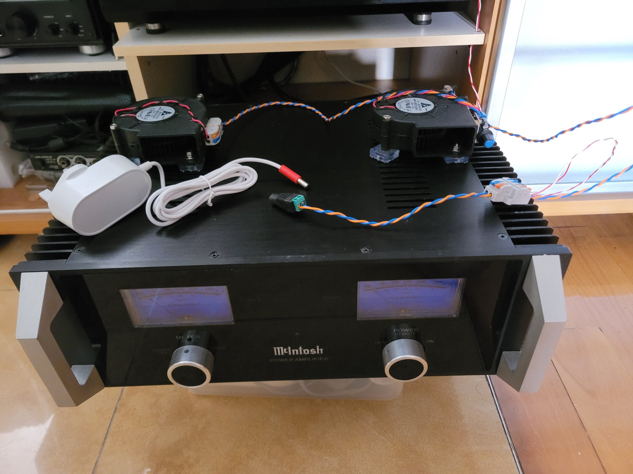

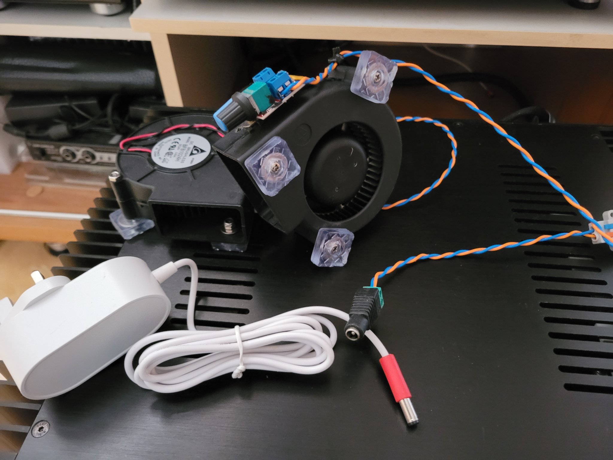

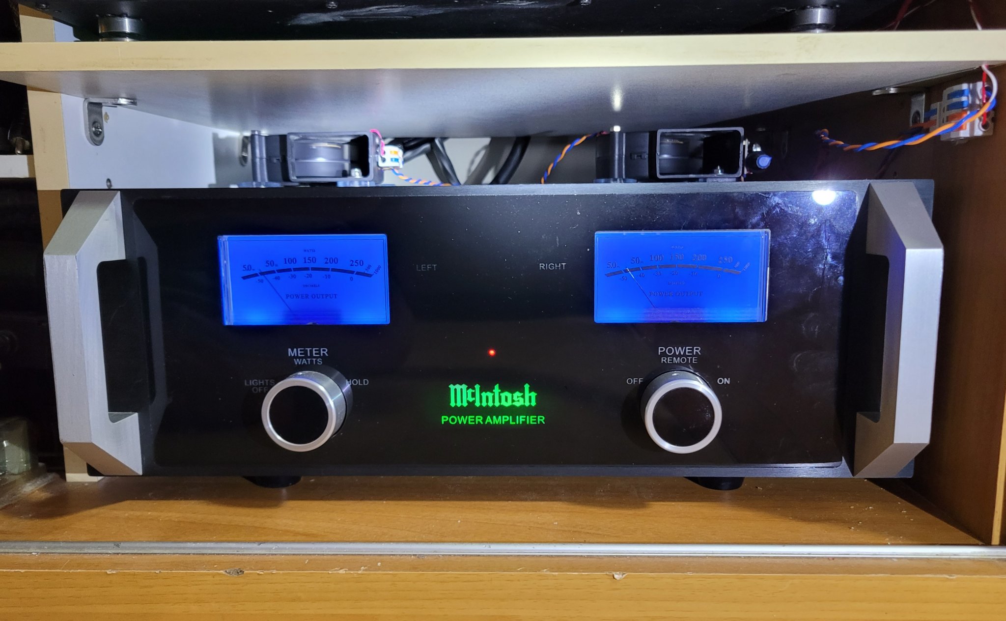

Due to my cabinet space is too crowded for better heat ventilation. I have made 2 24Vdc centrifugal fans (by using an external dc adaptor), just freely placed on top of poweramp near by the both heatsinks, for the use to extract the hot air and blow out to the front horizontally.
Stop. Don't need any fans. Your radiators will handle the cooling. My 300x70x50 worked fine, if not overestimated by more than 20mV. The Macintosh has normal radiators, they are enough for class A.
My fan purchased it for me in a completed set poweramp, however the circuit board damaged accidentally, thus I have to purchase another amp kit set to DIY and fit in the case. Therefore I have no idea where the case purchased from.Skinte link to purchase Macintosh.
Thanks for your advicesStop. Don't need any fans. Your radiators will handle the cooling. My 300x70x50 worked fine, if not overestimated by more than 20mV. The Macintosh has normal radiators, they are enough for class A.

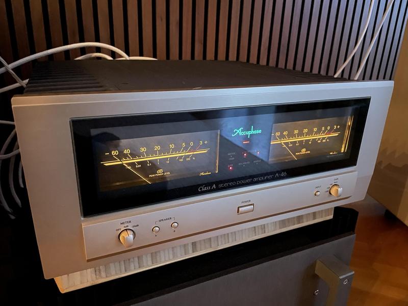

Anyway, I was so impressed that I bought an original, in my case an Accuphase A-46. I had high expectations as you can understand! If the clone delivers on this level, what would the original give?
Well, it looks like a million dollars, I have to admit that!
But in sound comparisons it sounds slow, veiled and mushy in lack of better words.
So my stick to the clone is my recommendation 😊
My A60 is singing and amazes me every time I listen to it. Probably the “fastest” amp I’ve heard. Also notorious to eliminate hum from. Took some Lundahls to tame it.
Can you compare the A60 clone with the A-46? There is a lot of talk on the forums about the slowness of all Accupfaces, I think this is a matter of taste. Clone A60 is faster than Dartzeel, on my acoustics with a sensitivity of 91db.
In chronical order, building the clone, buying an A-46, listen, selling the A-46, keeping the clone!😁
I think Accuphase wants to build a tank, with nice looks and undestuctable. But at the cost of sound quality. I don’t have any other explanation.
