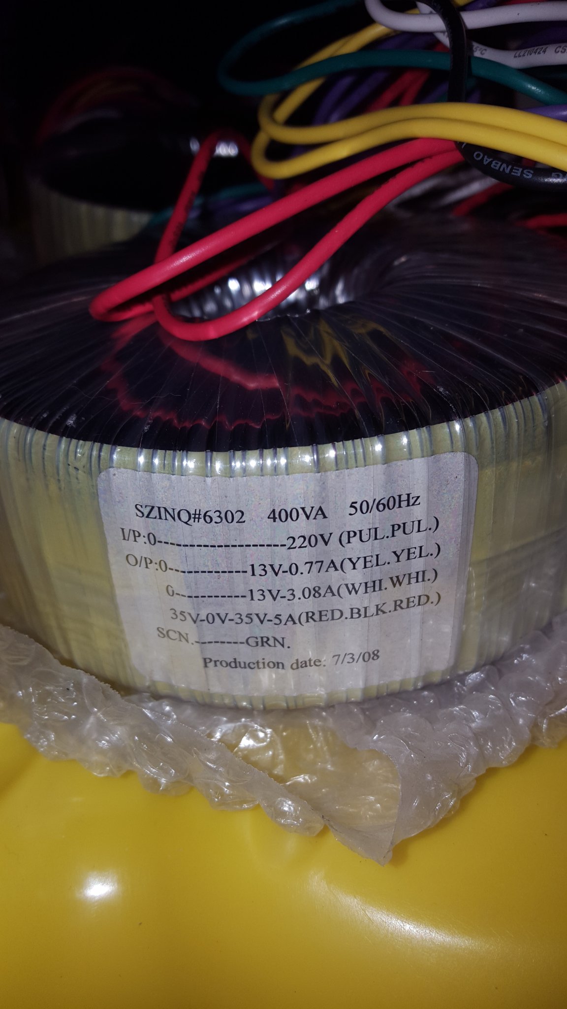

Here is some info on the toroidal:

And your transformer has everything you need.
Just ask if you need help. And don't hurry, it is so easy to make mistakes.

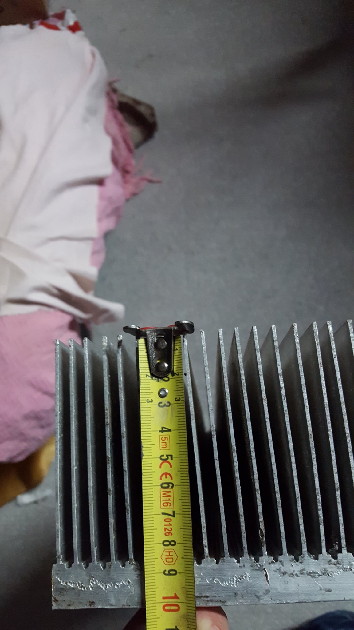

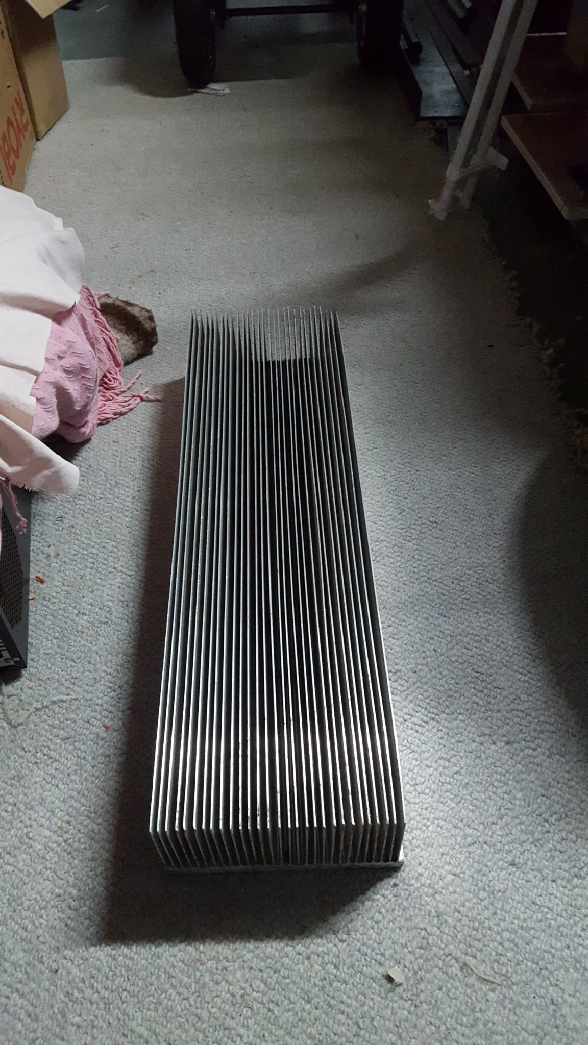

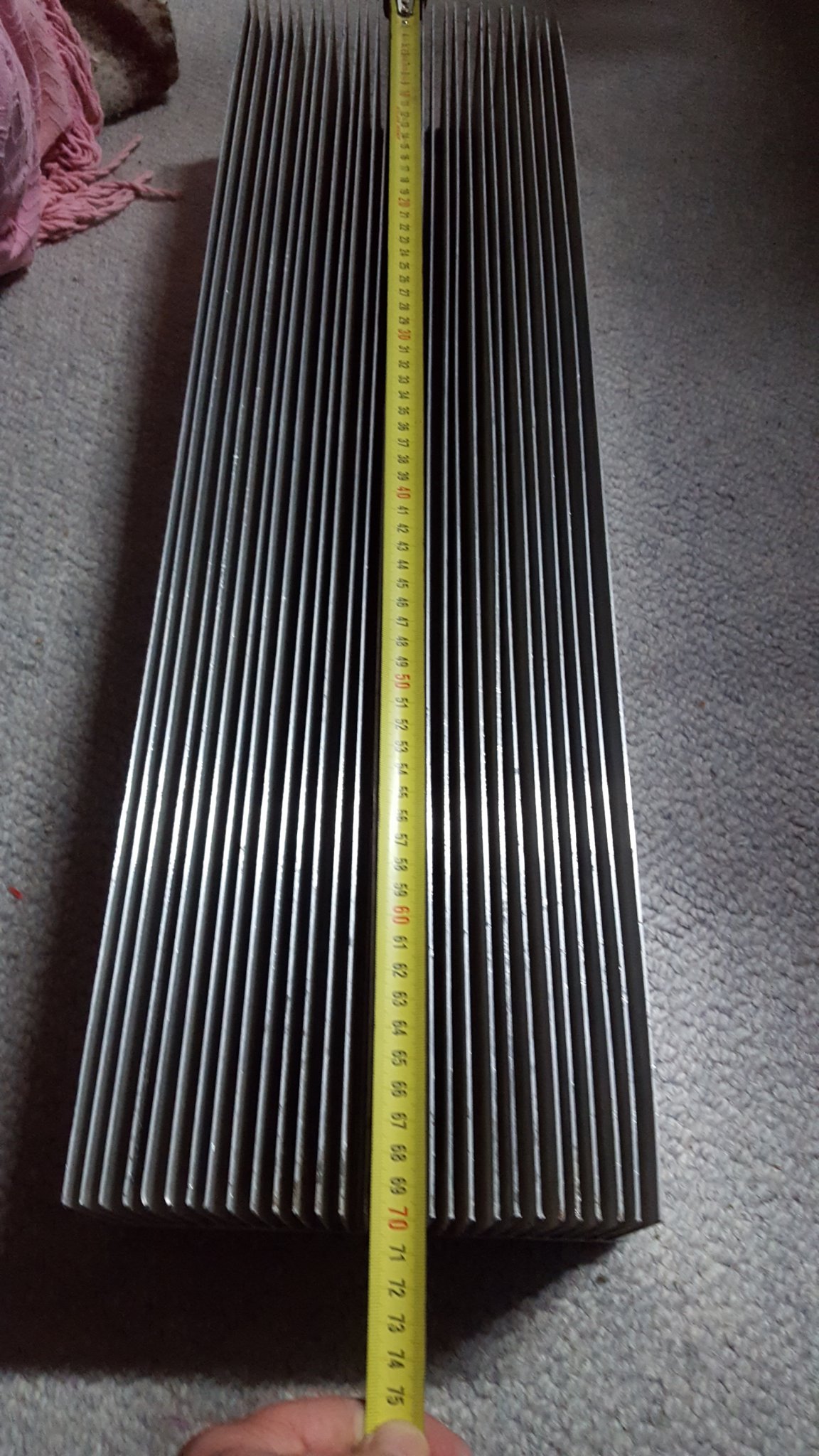

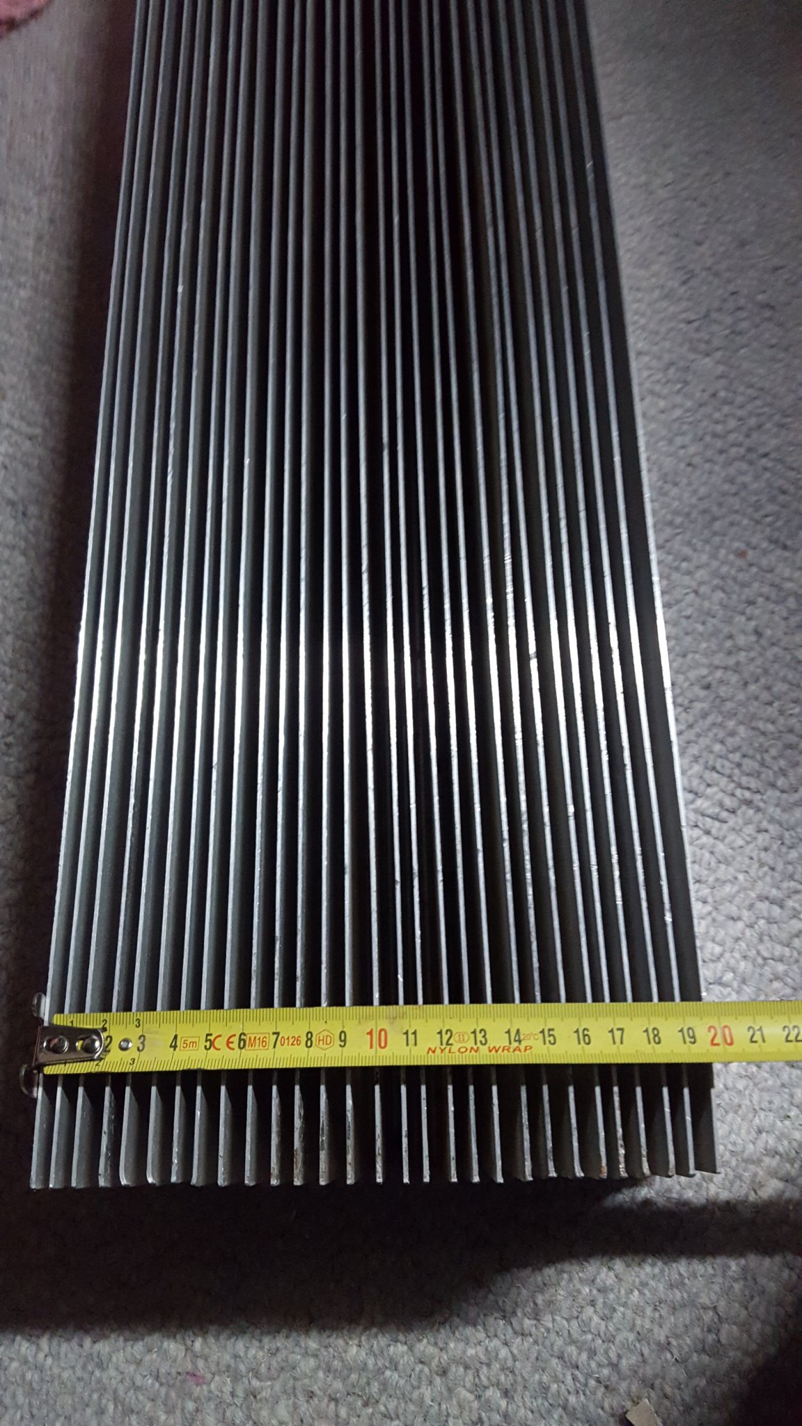

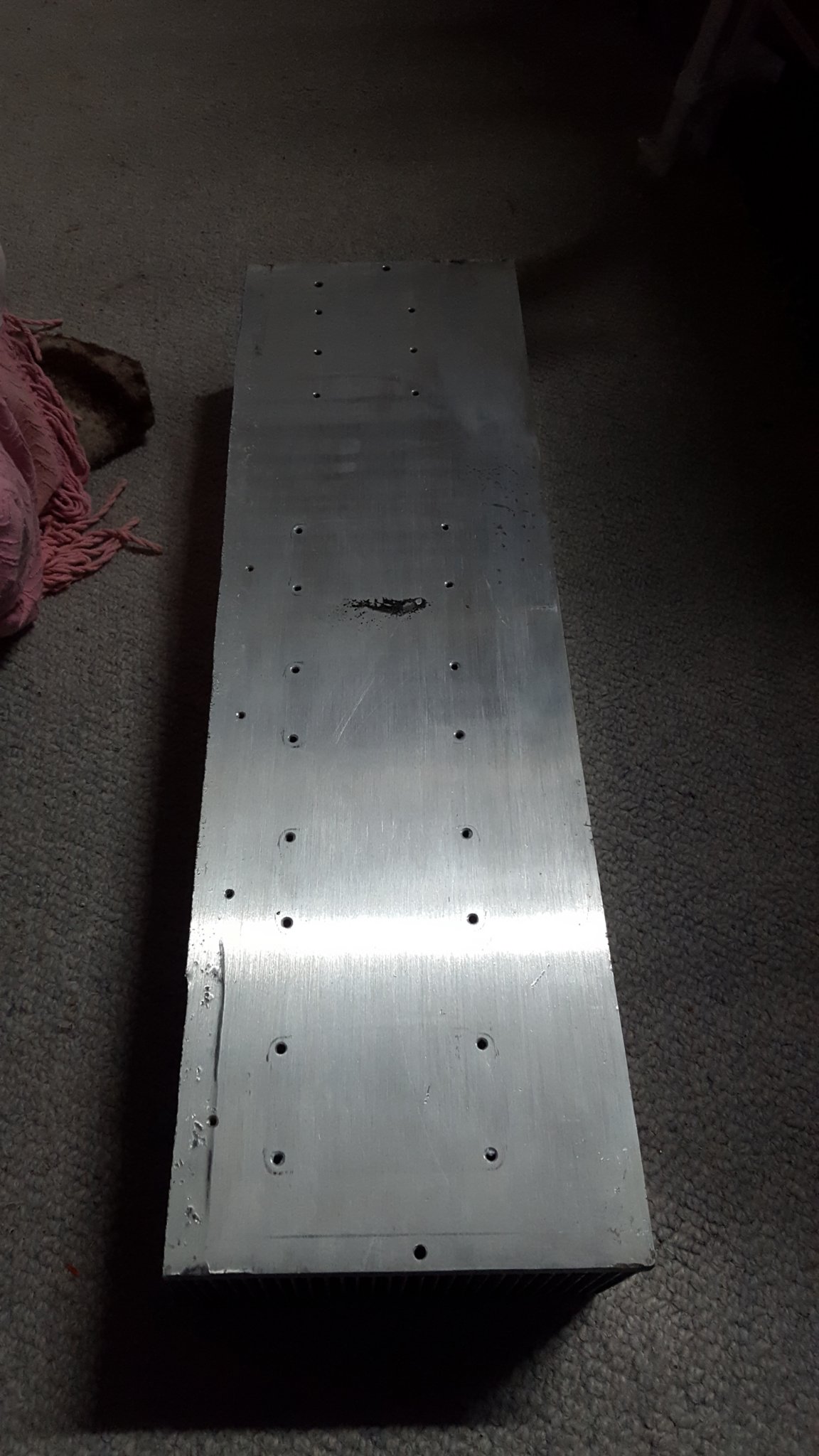

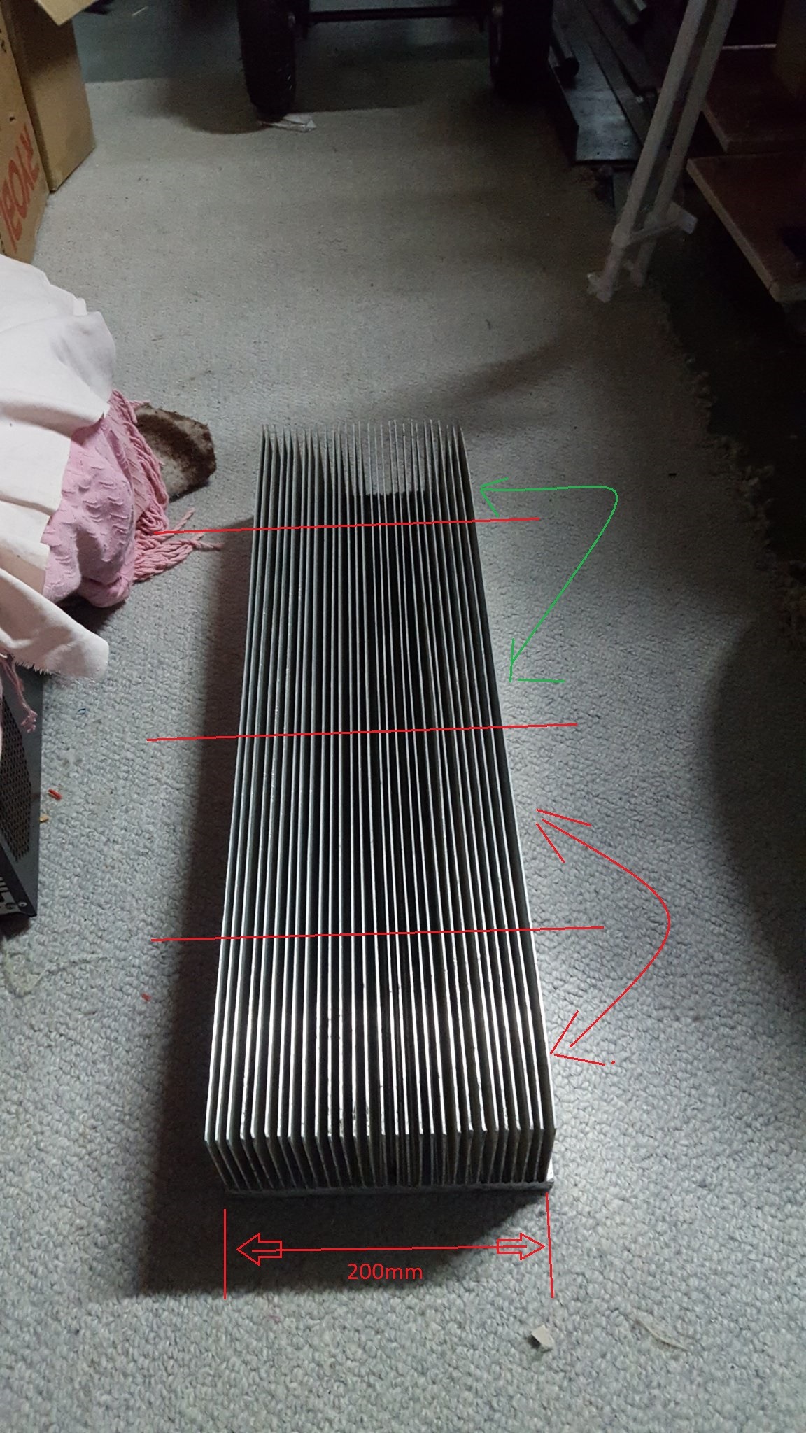

Picked up the heatsink over the weekend. Need to clean it nicely and cut it and take for milling machine work. Will cut it in 4 pieces and use 2 pieces per side with the fins vertical.
Hello.
This is a radiator for forced cooling, i.e. You still need to install a fan. if you want to use it as a convection (
without fan), then to calculate the cooling area you need to increase by the square root of 2, and preferably located outside the amplifier housing
Hello.
Thanks. The combination size of the heat sing will be 400mm long x 175mm high and fin size with mounting thickness 100mm. The soft start controllers that I order comes with a temp safety shutdown. I will check how the operating temp is when the amp is up and running and will make a call if I need to add fans.
Sorry, I don't understand the wiring diagram very well - will the ribs be horizontal or will it be 2 sections of 200mm but the ribs are vertical?
I would count on a temperature of no more than 40 degrees Celsius, while the temperature of the crystal will be any higher.
it will be like you mention it here. I will be cutting the heatsink in 4 pieces. 2 pieces will be then connected on each to make one long heat sink about 400mm long then with the ribs vertical then.

Such a massive heat sink can keep the amplifier cool even at much higher quiescent currents and produce even more clean, undistorted power. And, for me, large heat sinks look cool indicating the reasoning 'because I can'. With 'just' 0.31 K/W I can extract 20W of pure sound, which is much more than enough with highly sensitive 97dB speakers. At loud passages it really doesn't matter if the amplifier goes into AB.
