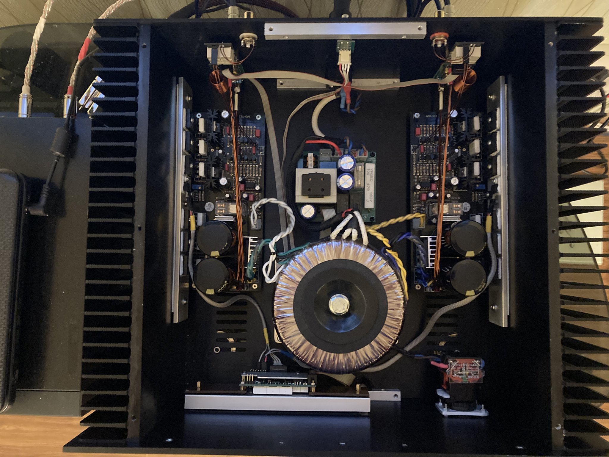

I have also used preassembled A60+ without the power transistors and power supply capacitors which I have chosen and added. Results were fine. It is the best option if you don't want to solder complete board.
I did so because there is always possibility that the most expensive parts are substituted with fakes or re-branded lower quality components. This is not the case just with Chinese products. Just open any commercial amplifier and find out that there was a great deal of cost-saving solutions. That's economy, not engineering.
Therefore, to find out the truth, I also have used smaller a60 with less output transistor to use exclusively chosen components. The results were similar if not the same.
Note also that there were (are) complete A60+ amplifiers that received excellent review. Look here!
So, all in all, A60 boards aren't so risky investment. Just advice: buy yourself power transistors and power supply capacitors to eliminate the risks.

Here is today's photo (not the last, there will also be a small power supply with a transformer to illuminate the button and the inscription on the display), this is A60, it has everything on its boards. We have already discussed it in detail here, try to read, and then we will help if there are questions.🙂
