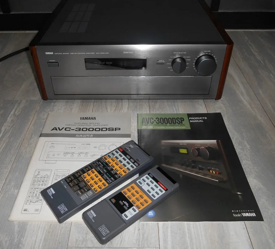

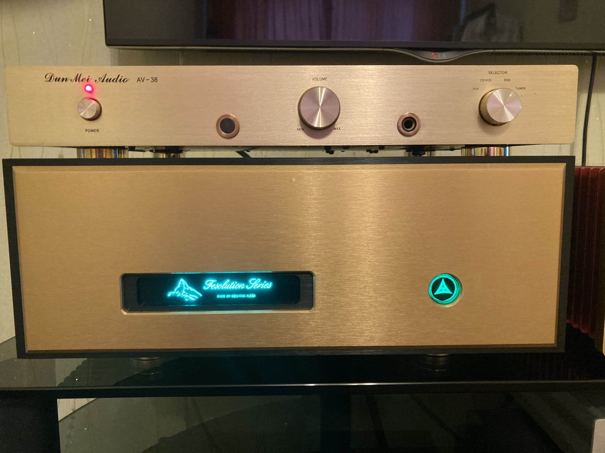

I also compared my Chinese preamplifier (I posted a photo) and the preamplifier of the NAD C352 integrated amplifier. I was disappointed with the result (my bright and little bass). Now this is coming to me:

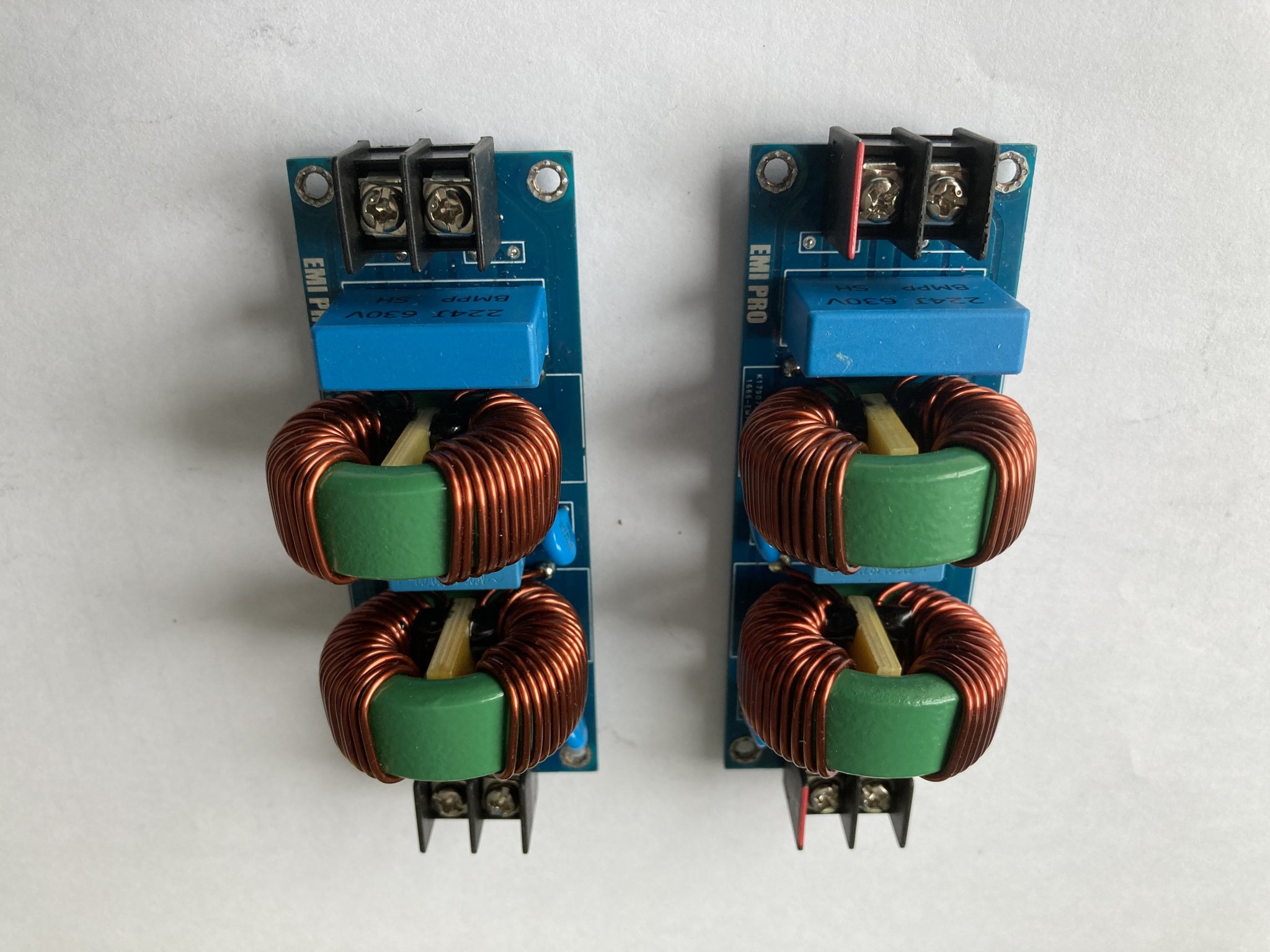

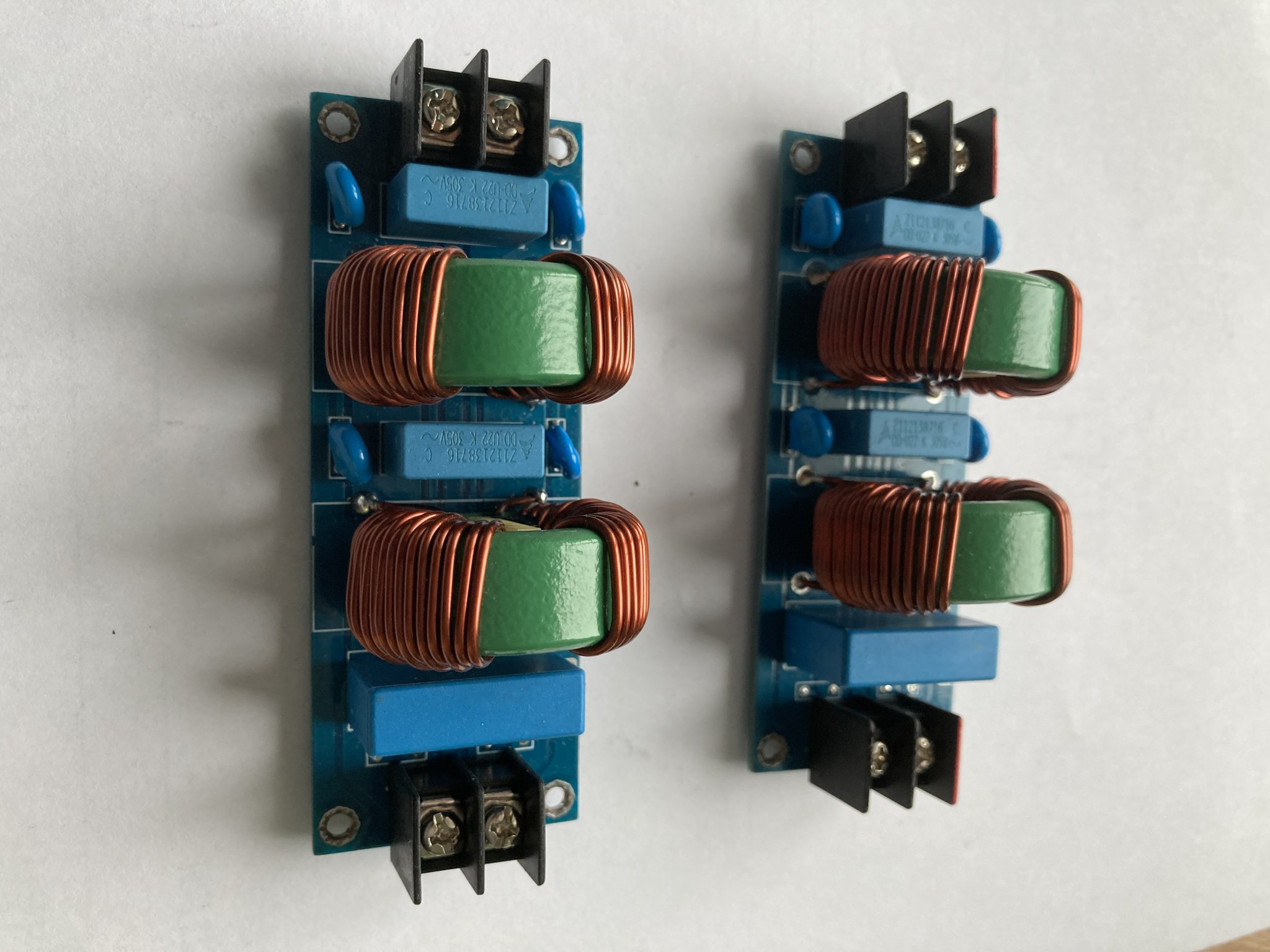

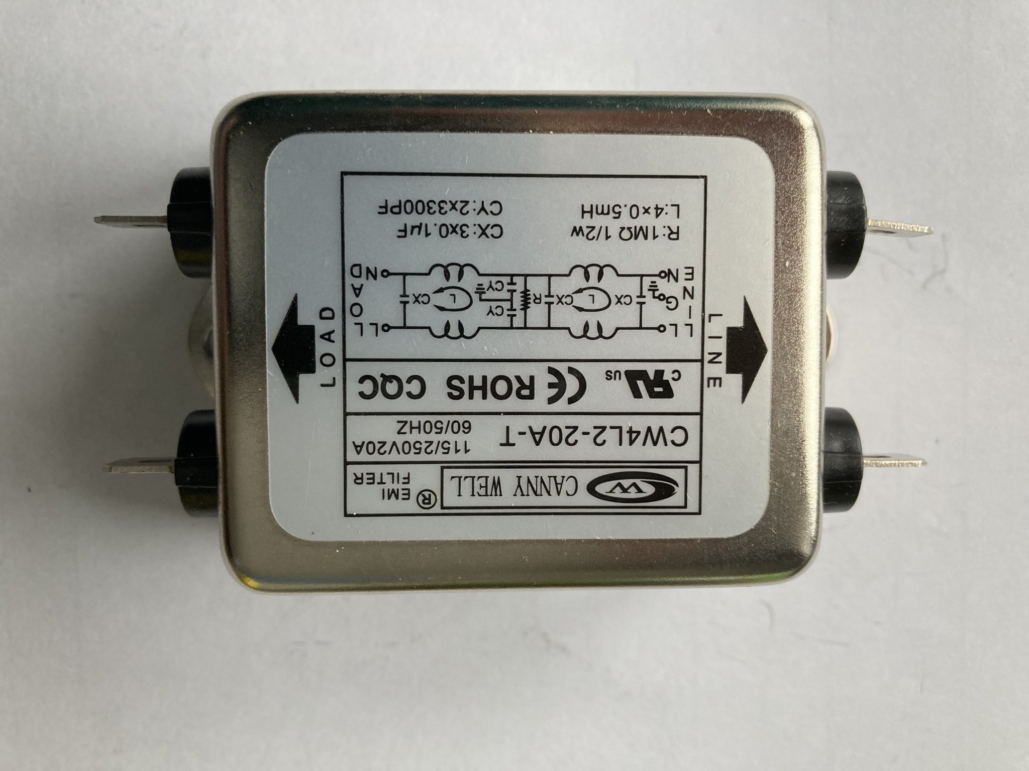

Hi all. There were small questions to which I would like to hear an answer from a respected public. How much does the quiescent current in A60 and A60 + affect the quality of music? I mean the optimal limit is between 30-60mV. Will there be a difference if, say, radiators allow you to set 50mV, or can you stop at 30-35mV? And how do network filters affect amplifiers? There are different opinions on the forums and no one can really explain whether they are needed or not. For a source or a DAC, it's understandable, the manufacturers put it, but in our case?🤔

You once said that you use a stabilized amplifier power supply. Could you clarify if you stabilized all the power (including the power of the 5200/1943 transistors) or only the circuits for driving them on 970/2240? And yes, by the way, the replacement of the Chinese preamplifier with the Yamaha AVC 3000DSP met all expectations!
I have tested up to 60 mV and, in my humble opinion, 30 mV is fine. More quiescent current just increases temperature without notable difference in sound quality.

And yes, good preamp provides better sound quality. Your Yamaha did the trick. 👍

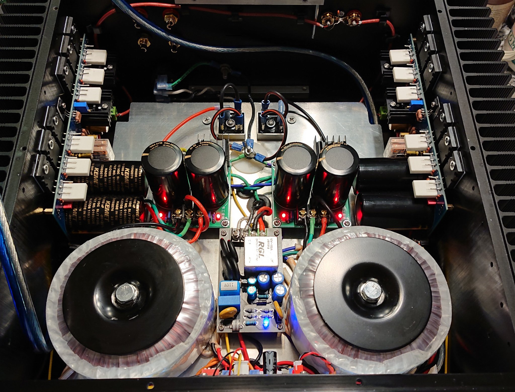

It’s a little unclear why a remote power supply is needed, since everything is organized on the board, even the delay in connecting acoustics without clicks. By the way, I removed the additional capacitors, it didn’t affect the sound, there are already 44,000 microfarads per channel. On loud music with an offset of 30-31mV, the temperature of the transistor 669 is 47.4 degrees. I left the temperature protection at 60 degrees. Later, I think I will raise it to 35mV.

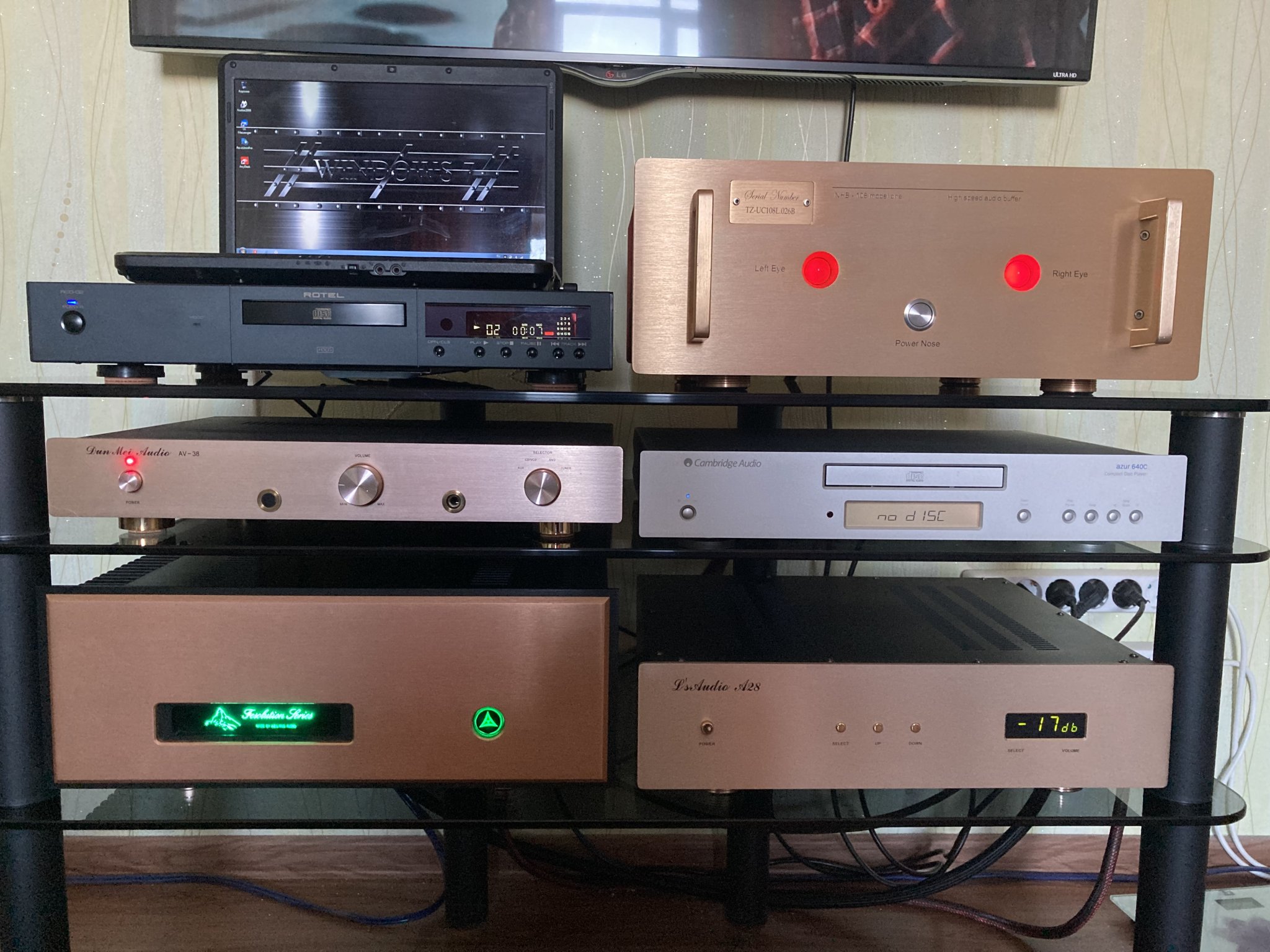

I drove today a little specially at a low volume with a preamplifier. What is interesting is the same soft beautiful bass and gentle high-mid frequencies. There is no timbre block and other tricks. Even from the budget Rotel-02 it plays beautifully.👍😉
