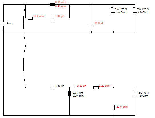

A series filter might be a fun idea here, and sometimes it can all play nicely.
It's not hard to do a 2.5 way aka TMM, or an MTM.
The series filter below plays nicely in either configuration. You can just move the 0.5 woofer about. It doesn't even need component changes. The parallel MTM filter looks easy enough too. All a bit driver dependant, of course. High woofer Le makes for problems which usually need shunt resistance to damp.
You can also do a three way with two identical or similar woofers. A resistive pad (which corrects rising impedance) in front of the midrange can make this easy. But padding down a bass woofer is not straightforward. I'd be looking at the two woofers to decide which one does which job best.

Hmm, so it's the other way around, the 0.5 is more sensitive. Compensation should be taken sparingly as it is imperfect to begin with - here you'll be overshooting the mark without due care.
Many would say don't use resistors or resonance impedance correction on woofers because it's wasteful of power, expensive and a generally untidy solution at best. I tend to feel it is OK to do if you have a good reason...?
I can see a way out of this if you allow the higher sensitivity to abound below approximately 100Hz, shelving the 0.5 a little through the compensation region and dropping off again above that. Depending where the step is this might be calling for a compound shelving system.
I agree with Steve, it isn't simple anymore. But in situations like this you might be surprised what you can hear and what you can't, what does work and what doesn't even though it either makes sense or not.

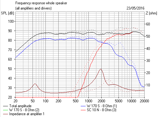

Thanks, tbh this is a project revising a existing tmm design as following:
With hp l=0.375 mh, lp l=0.483 mh.
Tweeter is audax tw025 m0
woofers are audax at170g0
Now i am not happy with the sound and thinking to upgrade one of thne woofes to hivi f6 and put the other to a real 0.5 leg.

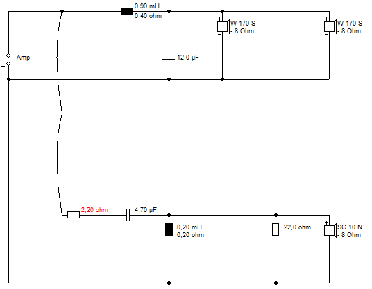

I was doing some fiddling around with some options this afternoon. I was slightly disturbed that the series filters hit the tweeter level quite hard. This is because the always need a resistor in the shunt for good impedance. Definitely 4dB loss. It's marginal whether it'll work.
I don't see any case for changing the Audax woofers here, though I can't even find a frequency response for the audax at170g0. What is it made of, cone-wise?
I don't see any case for the 2.5 circuits either. This isn't the issue IMO.

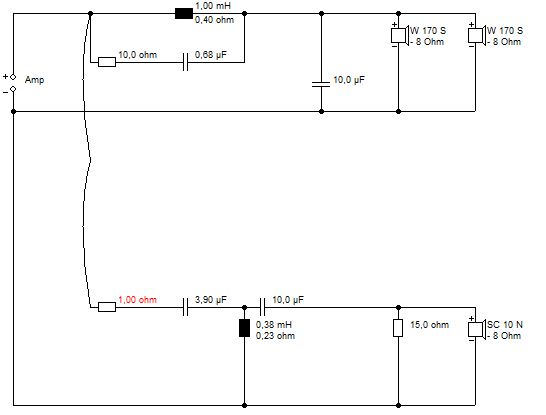

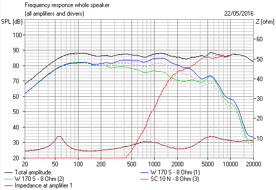

So I looked at what we could do to tidy up the parallel circuit. There's two ways to do a 5-6kHz notch, useful with 6" bass. The series filters look quite tidy too, but don't really look much better. A 22R across the tweeter must be good too for the highish Fs resonance. BTW, if your value of coil is 0.91 mH, I'd use a 1mH. Gotta be easier to find.
It's up to you whether that is doing the right things tonally.

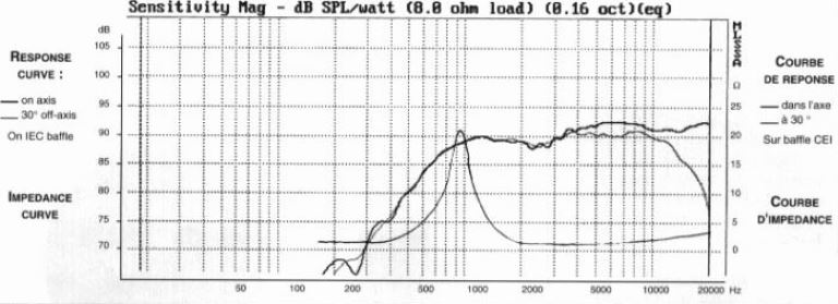

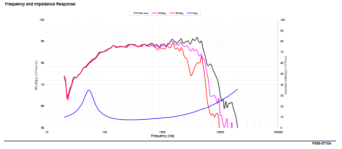

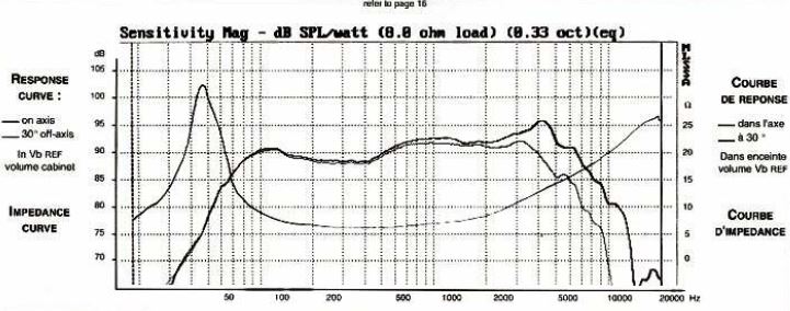

I dug up the woofer eventually. It's similar to the shielded paper Audax AT 170 M0 apparently. Low inductance LE 0.22mH though the curve is talking to me of 1.2mH, DCR around 6 ohms, Qts around 0.69 so big closed box I suppose.
http://www.cadaudio.dk/audaxunits.htm
Bit of a bump there at 4kHz.

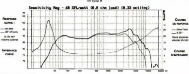

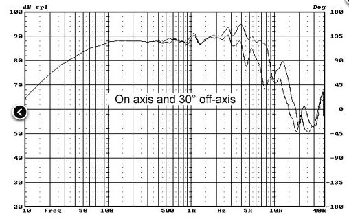

Which one is better?
Audax AT 170 M0 or G0, Qts 0.68:
HiVi F6, Qts 0.35:
Both a bit peaky at 4kHz, best having a notch around 6kHz IMO.

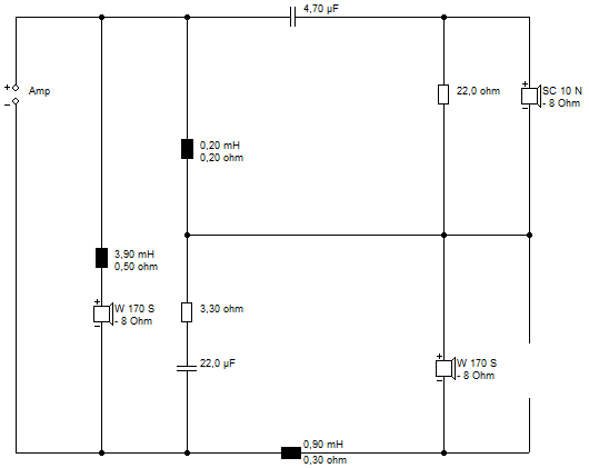

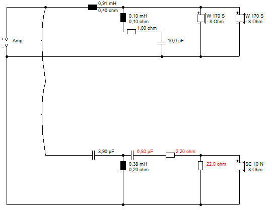

The reflex, if properly tuned is best left alone with the Audax driver. We might just hope for the best with the HiVi F6 in the closed box.
Just on general 6" bass principles I might be looking at the circuit below. Very wild guess, TBH, but recycles some components. 1mH and 10uF is right for 4 ohm load as a stock crossover. The 6kHz notch is just a good thing to do, IMO.
In a way, what you do depends on your assessment of the sound.
