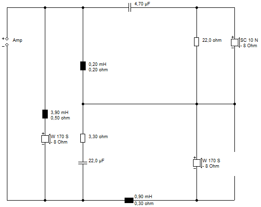

A two way 2nd order series crossover design
Thank you steve.
i see you suggest two different woofers in pair? How about the sensitivity mismatch then?
And also, will the 15ohms across the tweeter bring down its sensitivity too?

TBH, Jing, you are presenting a very difficult scenario here. You are drip-feeding us with your apparently unsatisfactory speakers. I don't know what is wrong with them, having never heard them. :rolleyes:
I have heard some goodish MTM designs:
This Scanspeak/Ribbon one works at most levels, IMO. It certainly sounded good to me, albeit the very bottom end was taken care of by 15" wall built sub-woofers.
The 15R shunt on the tweeter must be a good thing, and mainly affects impedance.
Mixing woofers is a thoroughly bad idea IMO. But you might get it to work. All experimental. :cool:

Sorry steve, i am not trying to confuse people but just asking what the best solution is here assuming all drivers are sourced already.
Your reply is very helpful. I dont believe it a good idea to mix different woofers in tmm either.
I might stick to the orginal plan, trying to make a good 2 way with the tweeter and f6, then add the .5 leg using at170g0.

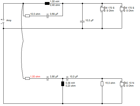

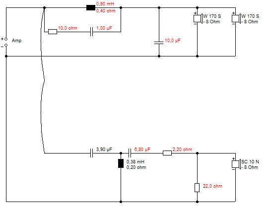

Simplest is always best with audio projects. You want to avoid too much woodwork. We've looked at all the filters here. I thought the series filter, either MTM or 2.5 configured, was better than your current one.
550895d1463941324-two-way-2nd-order-series-crossover-design-tmm-versus-mtm-circuit.png
But the 6kHz notch idea is very doable too:
551071d1464049473-two-way-2nd-order-series-crossover-design-j-modified-parallel-circuit-jing.png
None of these values are written in stone. Model it yourself.
Thanks steve, i will try both. As to the parts, PE in the us still is the best and fastest.
Perhaps i should order a bunch of assorted caps and resistor from them, and wind some inductors of my own. [emoji1]
