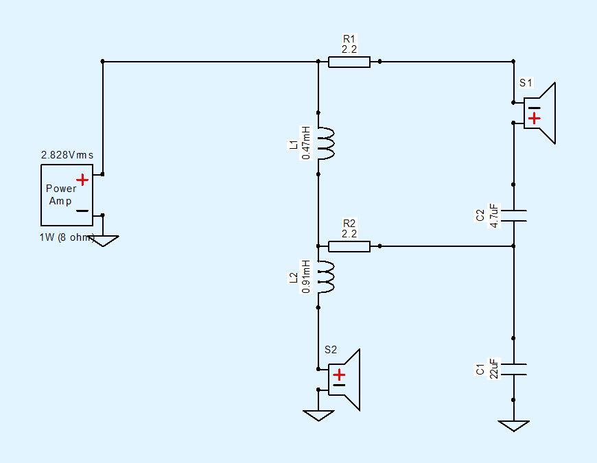

As a newbie here, I am currently designing a two way series crossover.

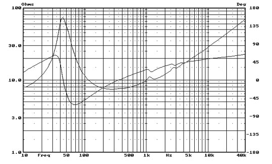

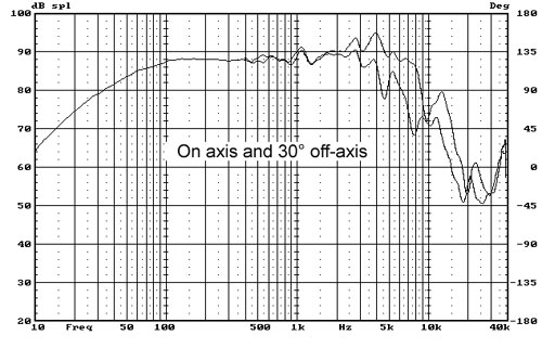

I am using HIVI F6 as woofer and TW025m1 as tweeter, the graphes of which show, best and recommend cross over is around 2-2.2K, a bit below the tweeters and perfectly fit F6.
In this case, I believe a 2nd order would be good, therefore I have come up with an idea like this, which a modified version of LCAudio:
This is from a fine tuning using Xsim with initial numbers from online calculators, which is for parallel only but as said parallel and series has the same math. (I am yet to find a sxo calculator.)
The impedances used here are from actual SPLtracing, which, at 2200hz, are 12.9ohms and 8.1ohms for F6 and TW025M1. (I am not a fan of Zobel, because I think it is approximate anyway.)

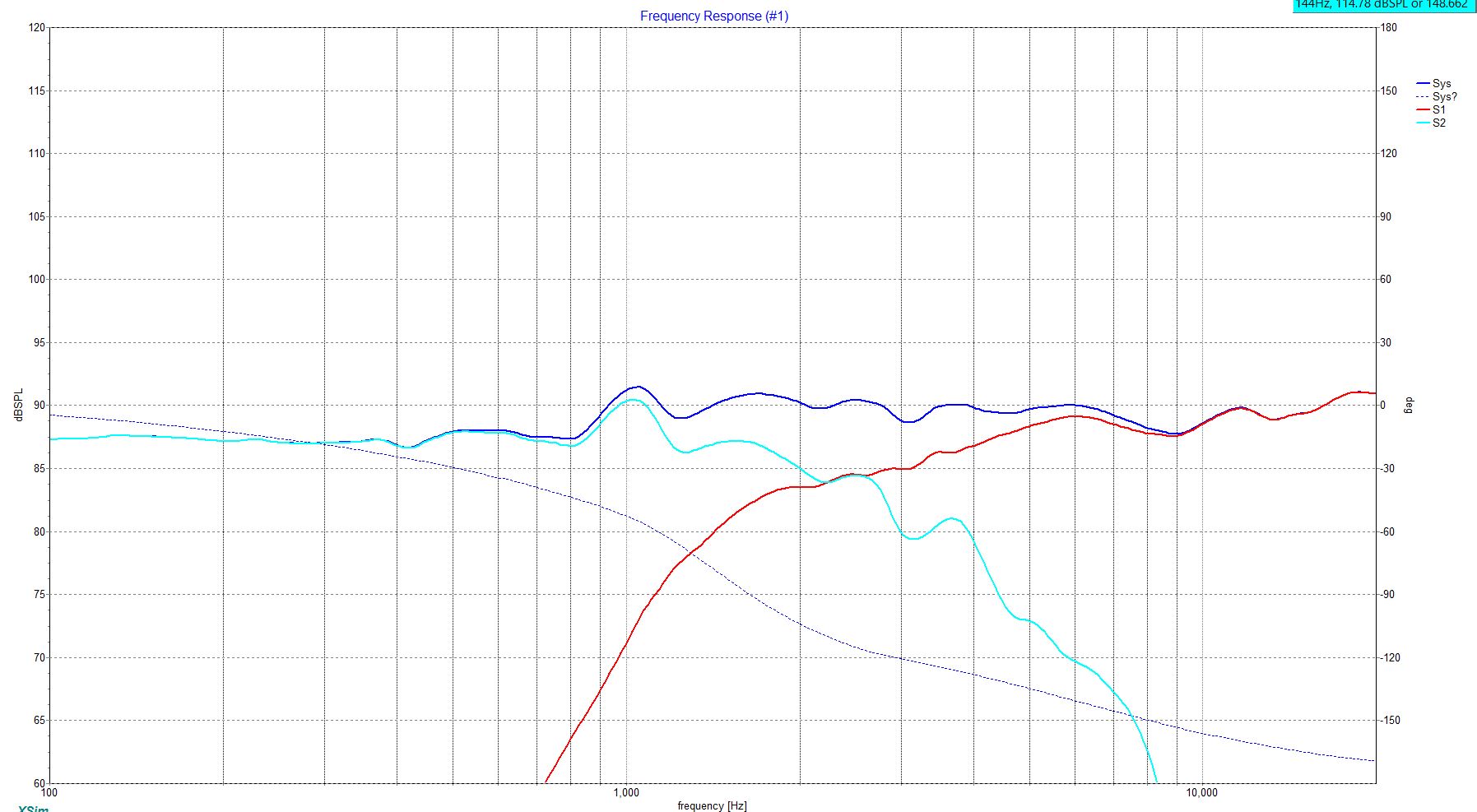

The simulate result is as following, I believe I have got a very close 2nd order.
My question is, is this really going to be like this in reality?

Hi Jing,
XSim is nearly 100% accurate when measurements were taken from drivers in cabinets.
Otherwise, taking SPL traces is just approximate, especially since you don't have any acoustic distances.
If this is a 2 way, estimate about 1.2 to 1.4" distance. Tune the woofer and set the distance to that, then revisit your crossover. This will give you a better indicator of your complexities.
Zobels are wonderful things, but the online calculators may not be. As important as the frequency effects of Zobel's are the phase shifts that may help you align the drivers. I often bump the cap or resistor to finish tuning that. Zobels can be very useful, don't become snobby about circuits. Sometimes you need them and sometimes you don't, that's all. I usually just use XSim's impedance chart to create an accurate Zobel. Connect the woofer by itself, and adjust the C and R values until the impedance plot after the resonance peak is flat. That's where to start.

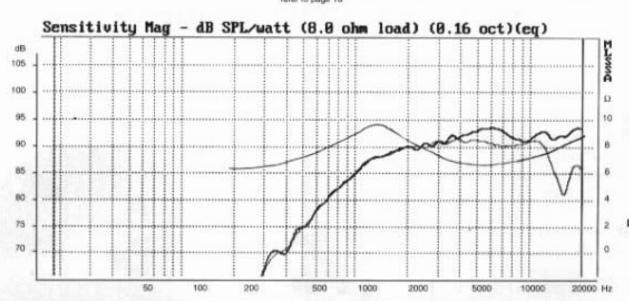

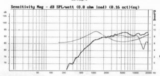

Sorry Erik, I am not quite sure about your reply. SPLtrace is to trace the curve measured by manufacture, and it can be very close if plotted with patience.
Often see people use DC resistance and a Zobel to do the same job but I doubt how much more accurate that can be.
When you talk about distance, do you mean I need measure the frequency response from a distance?

Jing,
SPL charts provided by manufacturers are often just a part of their advertising. They won't have told you how the drivers are measured, or whether there has been any smoothing applied to the chart.
Regarding "Often see people use DC resistance and a Zobel to do the same job but I doubt how much more accurate that can be" - I have absolutely no idea what you are talking about. I am fairly sure that very few people will try to design a crossover based on the DC resistance of a driver, and I'm fairly sure (unless you are a mystic) that designing a Zobel (to do what?) based on DC resistance is an impossible exercise.

I would trust the accuracy of xsim to be as good as the information you feed it.
Thanks for the reply.
At the moment, I only have SPLtraced FR at hand, so far will trust it until I got something better.
Just say, assume this FR is correct, would this design be OK?

Designing a crossover using a response measurement from each driver is not the last word in crossover design but it is a fair step in the right direction, and a big one as far as the learning curve is concerned.
Also as far as the speaker design is concerned, a crossover can compensate for, but not fix, most errors.
Read here until the 4th image (and look at the images) and judge by yourself if the effect of diffraction/baffle step (it is the same effect) can be ignored and only cured by a 0.5 way approach: https://trueaudio.com/st_diff1.htmI will eventually to add another .5 way for the baffle step compensation.
I would simulate the effect of the baffle, add the proper phase (I suspect you don't have phase data in your frd and zma), and then design an appropriate crossover. Without simulation first you are essentially shooting in the dark.
Audax doesn't recommend a 4KHz crossover point, it merely says what power handling you can expect with it with a 2nd order electrical filter. If you want to use that tweeter, mate it with an easy 5.25" mid-woofer (for example a Peerless 830656 or a SS Discovery 15W) and cross over at around 3KHz. OTOH if you want to use your 6" driver, mate it with a robust tweeter and cross over at 2KHz or better under.
Another thing to add, is that what is important in a crossover is the acoustic slope and not the electrical slope. In my experience it is pretty easy to achieve good LR4 acoustic slopes (4th order LR), with a 2nd order electrical on the woofer and 3rd order electrical on the tweeter. See here for an example and please read the crossover section: Zaph|Audio - 4" Bargain Mini

I have heard that series xo can have a reasonable flat curve with much
tolerance of the components, whereas a parallel xo does the opposite.
Therefore, series is my choice.
That is true for 1st order series *, but exactly the opposite for 2nd order.
The point is whether the final x/o component is in parallel or series with
the drivers. Parallel is what you want, and is true for odd order series,
and true for even order parallel.
Therefore for 2nd order electrical you choose parallel.
And read up on diffraction / baffle step effects, your ignoring them.
rgds, sreten.
