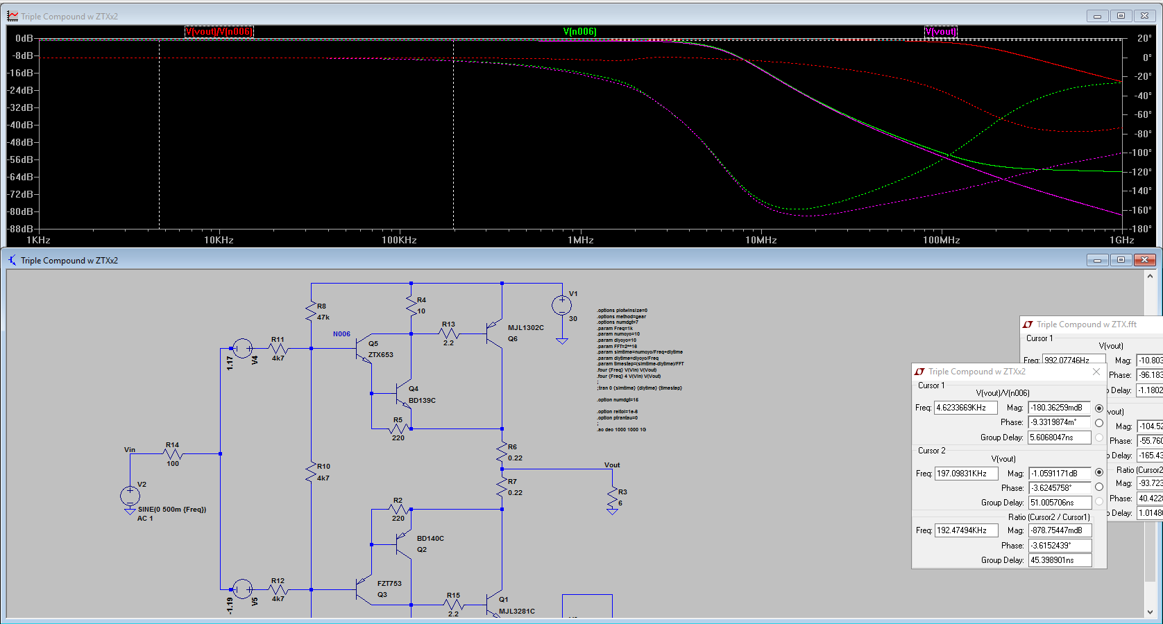

Hi!Interim circuit with ZTX pre drivers - reasonably balanced and with nice rolloff.

The peaking has come down here. It's very dependent on quiescent which I have kept around 100mA, but which changes with the components.

Do think it is highly fluctuating? I was working on the idea that 10R and the Vbe of the power transistor made up a current source and that was the problem with the earlier circuit with 47R that Calvin showed was going into cutoff. Someone also mentioned that a similar arrangement was on the Quad 303 and was quicker at mirroring the temperature and making sure that there was enough current. It's a nice idea.
I haven't seen any gain in there so far and the output is about 1dB down from the signal, but I'll have another look. I know there is a CFP arrangement with gain but the reports are that the distortion rises.
The Miller capacitance is what I'm trading of in fiddling around at the moment. I've got the bandwidth out to 5MHz (and have seen 7MHz, but that's hardly outstanding given the 30 or 40MHz components. Every time I try a more modern transistor as one of the drivers it reverts to peaking. The 653/753 is fine but it's interesting that a 5551 won't work, nor 3503/3601s.

There is no hump in the frequency response with the ZTX drivers if you look further down the page. Are you using Cordell models or not? I don't think there is a Cordell model for the ZTX653/753.
As for distortion you haven't given any reason to say that this will be worse than an ordinary triple. I have shown you that the first component of distortion is 93.7dB down and you haven't answered that. The model for that is posted above.

I looked at this again and I very nearly missed something, which is that there is some feedback here that I really hadn't foreseen. (Yes, I was warned there might be. 🙂 ) I was planning on doing something about this input biasing arrangement but hadn't thought it important but it really does need to have a better Vout/Vin.
This is what happens in this circuit at n006, which is marked and is the base of the top pre-driver. We already have most of the rolloff defined at that point. I had initially glanced and thought that was just the ZTX defining it at the beginning, but no. That's the base. And not much else happens to the output until you get a decade further out.
So, from this, one can't see internal gain; though if there's a high impedance above a CE you can see how it would be happening. The input needs to be redone with a nice low impedance and then we might get a proper look at what is happening in the output stage by itself.
Here's the asc and the graph just for the record.

OK. Looking at the last point, consider that the collector of a transistor will be reverse biased in relation to the base giving rise to a capacitance within the diffusion - a form of opposites polarising rather than attracting. The capacitance developed is a function of the area of the transistor junction which is constant and inversely proportionate to the square root of the voltage applied to the collector.
The voltage drop across the 10 ohm resistor load shared by Q4 and Q5 will be more when more current is drawn when the collector to base capacitance will increase. I believe ZTX653/753 have the relatively high collector to base capacitance the alternatives tried may lack.
The voltage gain of a transistor is Gm multiplied by the load in k. ohms where as the Gm is roughly 40 mS per m.a. of collector current. The load will be that of the collector resistor and that presented by following stages.
I will leave you to reflect on the impact of reducing the original value of 47 ohms. I think it is worth taking a second look at the Crimson circuit in post 34 and possibly the Mission Cyrus 1 output triple.
Regarding biasing and cut off a strategy used in Darlington power devices is to incorporate a resistor from the base input of the first transistor to the base of the second - Q5 and Q4 in the circuit discussed. The small bypass current via a resistor of 4k ohm might help help recovery/ mitigate against cut off.

I think I see what you are getting at and the two routes out of the pre-driver's emitter are going to vary the current through it, with the load very possibly varying with just one transistor between it and the loudspeaker's impedance. It's a hornet's nest. And one of the things I was hoping for is that it would present a nice high impedance to a VAS so that the gain wasn't modulated by the loudspeaker impedance curve. You are ahead of me on what's going on here but it is now nearly 4am (which probably calls for some Paul Simon, just to ease my brain). The input definitely needs redoing to see this at work but it might be worth presenting it with a real loudspeaker load to see if that really does turn up as a multiple at the input.
