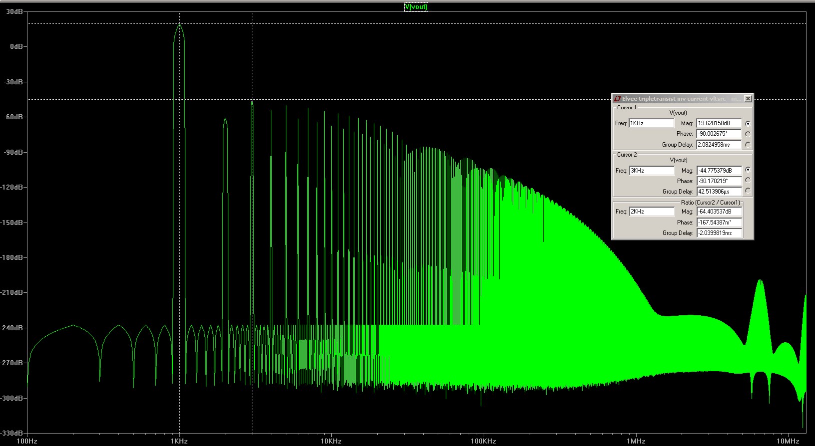

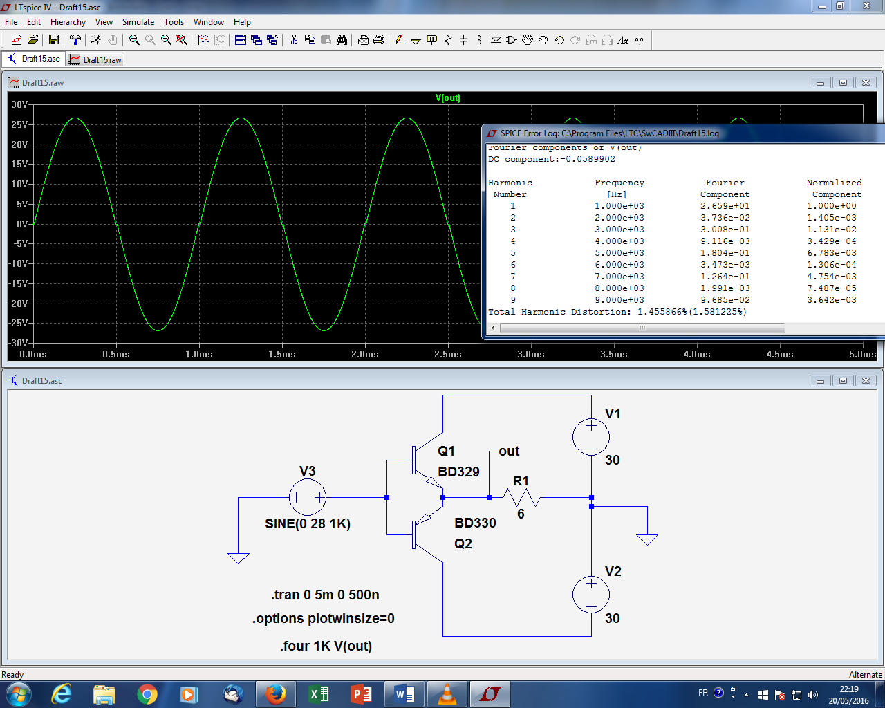

I see in this model a 2.5% distortion. It is very much. To reduce the resulting distortion to less than 1 ppm, the required total feedback depth of 70 dB. It is unclear, what a bad conventional three-stage emitter-follower, which under the same conditions can make only 0,02...0,03% distortion, and for the same resulting distortion need feedback depth of 30 dB.fft was correct,
I tried my favourite transconductance amp made of those tripples with gnfb, for small signals it is working good enough with ~400mA idle and 32mV offset, voltage sources are instead of the caps. For larger signals this amp needs more class A to work without major distortion.
Anyway the potential exists but how to use it is next thing...
How do you get to 2.5%? 60dB down 1/1000th. I'm not adding them all up but I'd still see it as hard to make 2.5%.
THD was 0,0297% at given sch

In your model supply voltage 2 x 30 volts. It follows that: the power output, undistorted limit of supply voltage reaches 52 W at the amplitude of the output voltage of 25 volts.To see the linearity of the amplifier at the limit of the linear operation zone, the original model was modified to achieve such power output, and was set to the appropriate input voltage. When the output voltage is 25 volts and output power 52 watt THD = 2.5%. Anyone who would do the same, get the same result.
I don't catch the logic of this reasoning (and I am neutral regarding the issue of triple CFP or darlington, or whatever), but it is wrong: with 30V rails, it is simply impossible to arrive at 2.5% distortion for the followers alone, irrespective of their flavor. Even if you deliberately sabotage them, like omitting a spreader, it will be difficultIn your model supply voltage 2 x 30 volts. It follows that: the p ..../.... er output, and was set to the appropriate input voltage. When the output voltage is 25 volts and output power 52 watt THD = 2.5%. Anyone who would do the same, get the same result.
I didn't either. I know they changed a little between sims but the largest component was about 60dB down so - am I wrong? - that is 0.1%. It's one thousandth of the initial signal, is it not? The other peak could only double that at best and, though I can't see from where I am typing here, we were mostly looking at 20 odd dB down on that, so a twentieth or a tenth again at worst. 0.25% might be reasonable but not 2.5%. It's still not ideal.

Hi!I didn't either. I know they changed a little between sims but the largest component was about 60dB down so - am I wrong? - that is 0.1%. It's one thousandth of the initial signal, is it not? The other peak could only double that at best and, though I can't see from where I am typing here, we were mostly looking at 20 odd dB down on that, so a twentieth or a tenth again at worst. 0.25% might be reasonable but not 2.5%. It's still not ideal.
Thank you, I have the models from Cordell, even plus 🙂. Rechecked several times. The same: 2.5 per cent. Here, look.
The difference with the discussed model of the single-stage push-pull follower with no bias in that there is applied the emitter follower. That is, a cascade with 100% local negative feedback. In the discussed example, the output stage performs the function of amplifier current and voltage, i.e., the NFB can not be 100%, but only 20%, judging by the increased voltage of about 5. In addition, the amplification voltage distort the signal much stronger than the followers, and especially - with CE.

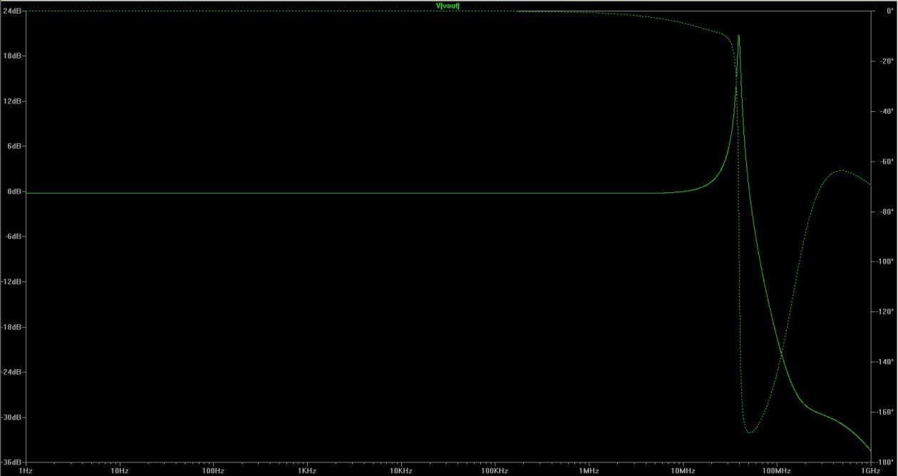

But I did compare frequency response and phase of a triple EF with a CFP + EF, similar to Elvee's, and was a little disappointed in the CFP+EF.
The poor performance of the versions with a Common Emitter as the first transistor is explicable as feed-forward thru the base-emitter capacitance.
This can cause non-minimum phase behavior, visible in the red trace.

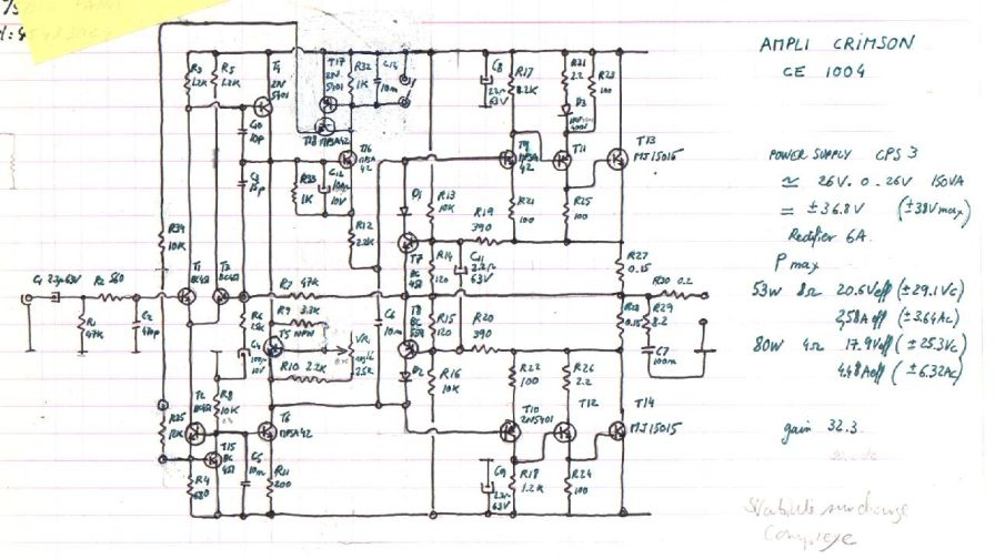

I didn't get as far as doing any significant analysis but I did look into who else had used compound triples. One interesting one was Crimson Electrik, whose amps are well regarded, and they used the sandwiched CFP. There were some interesting comments from bepowell (who is on here and who designed them) about having a fast enough main transistor. He also used resistor values closer to what I had in mind and, on the opening transistor, a little bit of rolloff. I haven't looked into how significant that was, or whether it's just a stability tweak.
The output of these things seems to be the geometric mean of the the transistors so the little ones would be working quite hard in practice.
Another place CFPs were used is in the Linn LK100 and Klout. These seem to be very bandwidth limited being >1dB down at 20kHz and still drooping at 12kHz. One of the contributors amusingly described it as "state of the ark". One interesting thing was the Klout using 3xZTX653s in parallel as the driver, connected together by three 12 ohm resistors. Whether this counts as opening the loop I haven't looked into but it would be nice to have that quality and speed of transistor in there. In a similar vein I also want to look at treating the main compound pair as a single and then paralleling them up, driven by the opening transistor.
Like you I wouldn't dream of doing a Class A. I have an A370 here and it's capable of keeping the front room at a very nice temperature with no central heating. I don't know of there being any objections to CFP aside from those that Doug Self has already investigated and there are some advantages. I still can't see how this other fellow is getting 2.5% distortion but I'll put it together in an ordinary push pull and see what happens.

I hope the schematics for the Crimson have uploaded
here it is.
First glance that seems to be the Darlington out which Philips are saying has lower distortion but which seems for us to model with a huge peak (well we can look into that. I have to nip out for an hour or so but this needs more examination to see if the circuits are in fact the same. I couldn't see anything different right away but in each of the four or five that I have seen, they have all been drawn differently - and none of them the way that I would. 🙂 I'll read the whole patent if it's all available on Google. Thanks for that.

Similarly, B. Powell seems nice and helpful but the Crimson also shows it's period with a sort of quasi-complementary output.

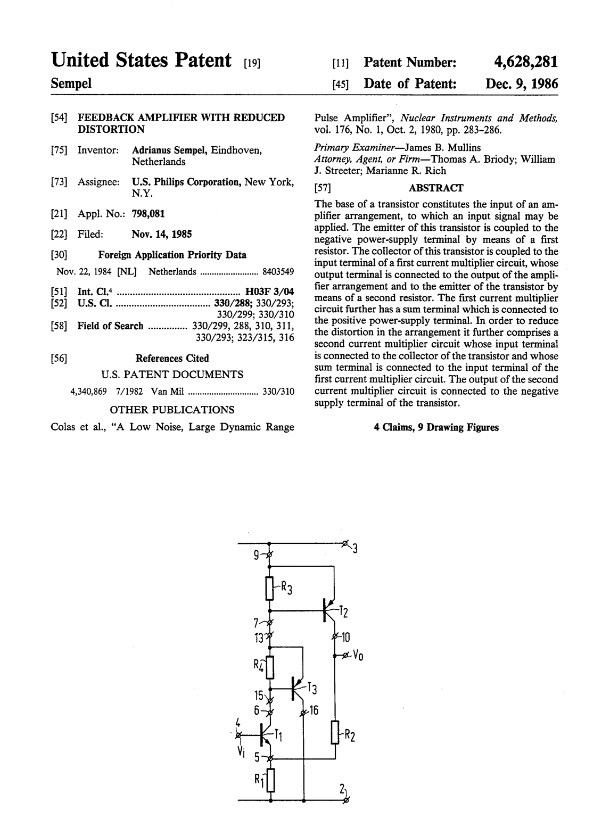

ya . see what you mean T3 should be an n channel. then it would be a compound CFP.
I had a quick look at the patent last night and it seems that figures 6, 7 and 8 are the ones they are claiming for. It gets very complicated with the patent language and I reckon I'd need a full clear hour to be sure of what they after really doing.
In the circuit above we are getting something of a current source with the Vbe drop of T3 going across that resistor, though that will change with the voltage at its base. On the patent there seems to be some sort of bootstrapping going on with a capacitor going around it. I really would need to draw these out by hand to see what's really going on. And without an explanation I bet I won't be sure even then!
I got the full patent with just a search with the patent number and I think it was Freepatentsonline that was at the top and did give me the whole thing. Sometimes they make it difficult to get at the drawings. I may have a chance to have another look at it tonight but that won't be a good concentrated session so any pointers as to what is going on would definitely help.
Edit PS. Incidentally I saw this one as effectively a speeded up driver, with T3 just making T1 better behaved.

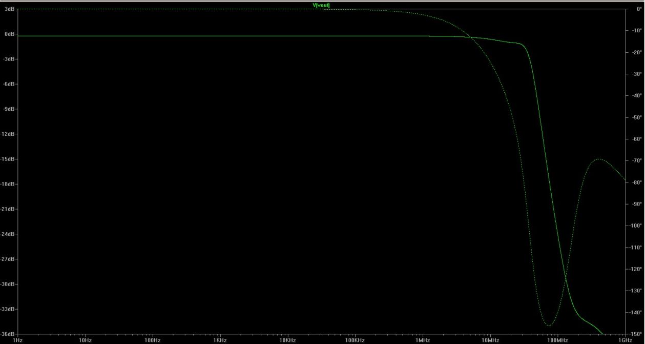

just attached a own sim, based on the schematic of #19.
First I used same models but switched to other transistors I´d prefer in a power output stage.
2nd pic shows the amplitude response ithout compensation caps, the 3rd pic with comp. caps.
The caps values depend on the chosen transistors and might become larger or may be omitted with alltogether with differnet types.
But obviously it doesn´t require much effort to tame the amplitude response.

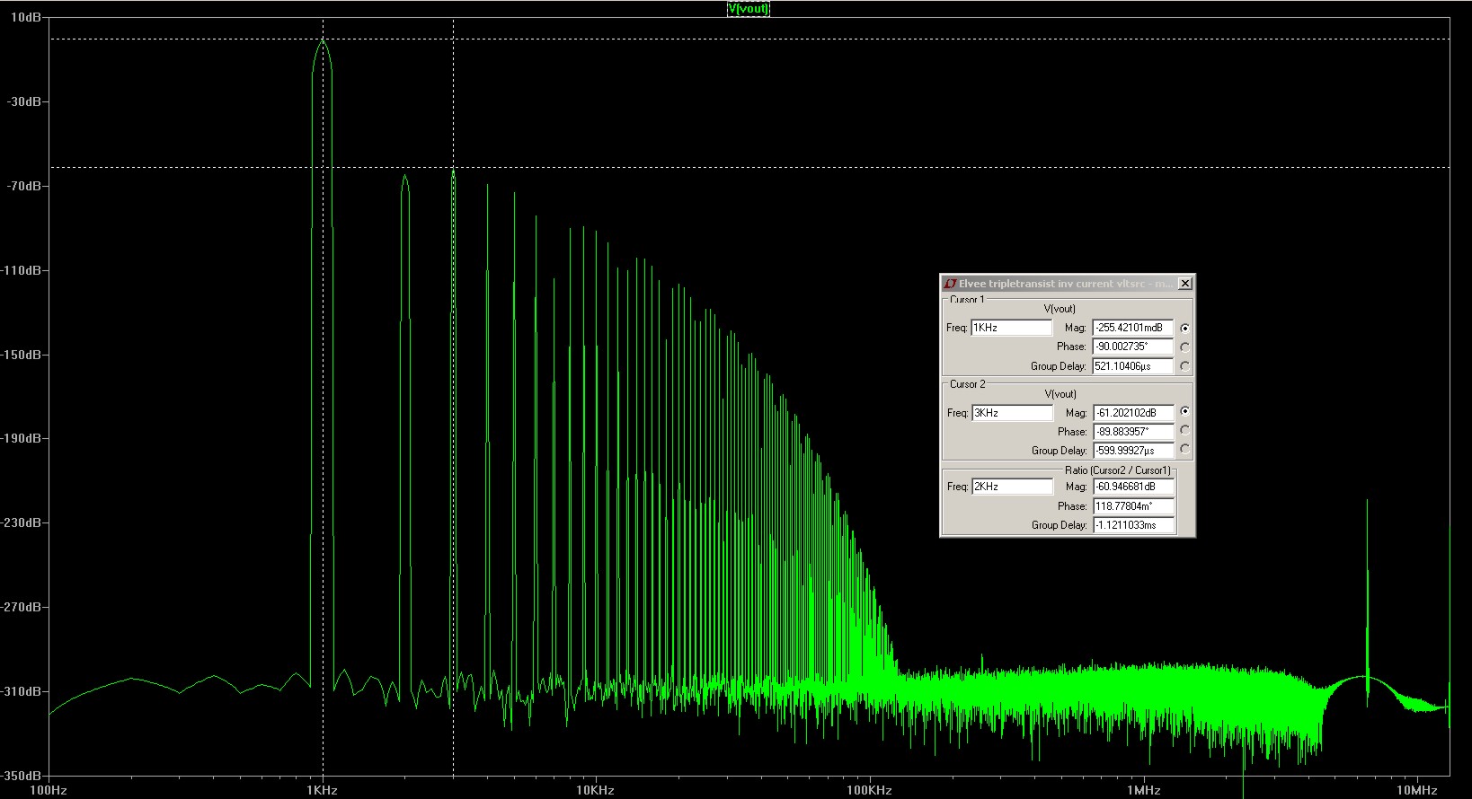

Pics 4 to 6 show the THD @1kHz with 100mVrms, 1Vrms and 10Vrms input voltage.
It seems that as soon as he output transistors approach class-A limit and the stage slides into class-AB that the higher harmonics shoot up.
That comes a bit disappointing to me as I had expected better from my experience with simple 2-stage CFPs.
