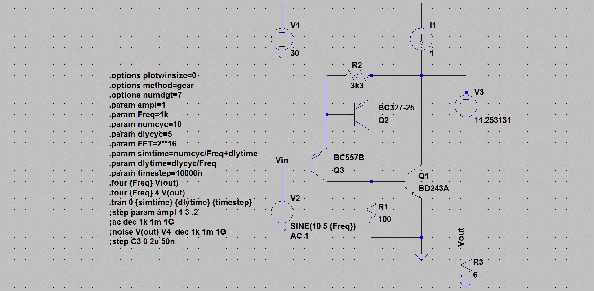

Has anyone used, or looked at a Darlington as a main part of a CFP output stage? So that would be three transistors; one cascading into the other and a CFP wrapped around it?
I am a very big fan of CFPs in general and have used them in high power regulators. They seem to lighten up the clumsiness of big power transistors and the local feedback really appeals to me.
The two applications I would be looking at are as plain output sections in either and amplifier or a voltage regulator - though probably the regulator first. Though I know that Douglas Self abhors packaged Darlingtons (and I do take his point) but there is a huge temptation to use one of those high current packages where you have a Darlington with two power devices in the same box (preferably not TO-3). Does anyone have any idea what might be a suitable choice?
The other possibility was to CFP a CFP, meaning that you take a compound pair, treat it as an NPN, and then wrap another transistor around it, but put it on the other side of 0V. This would get you extra local feedback and get rid of PN junctions between your rails and the signal.
I'm sure any of these could be made to work but the question is whether you are going to run into a wall of practicality and oscillation.
Also, if anyone knows of a package with two plain devices in it, in parallel, could they please let me know. I think I have looked and looked but I just can't find them.
One final thing is that I can't seem to get any definitive information on output impedance differences between various output stages. Ideally I am after a flat impedance which can be modeled as a pure R+L and which doesn't change much under load. The Hfes of the Darlingtons I have looked at seem very humped and tend to only get going around 5A, which is not what we are used to in some of the nicer power transistors today. Not affecting the load resistance of the VAS is something I regard as critical and it would tempt me to use a MOSFET as the pickup driver, but that perhaps rather kills the idea I have in mind.

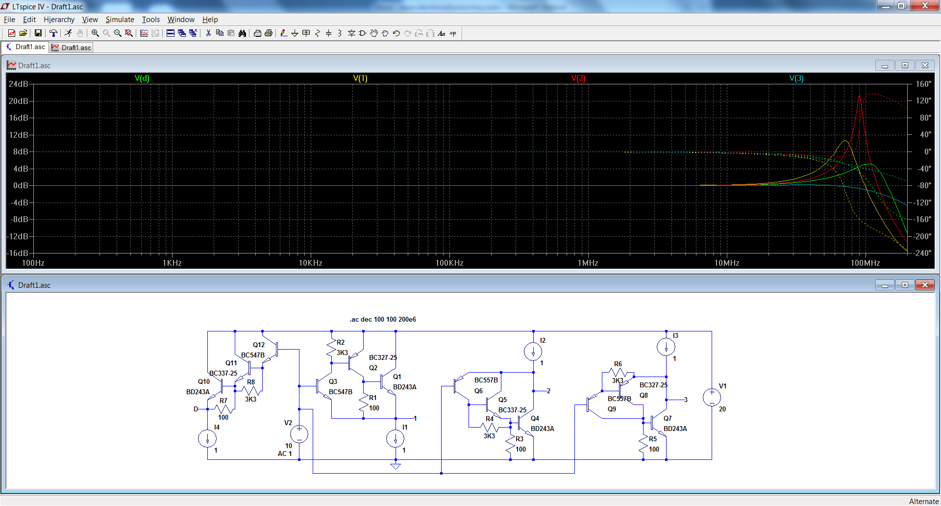

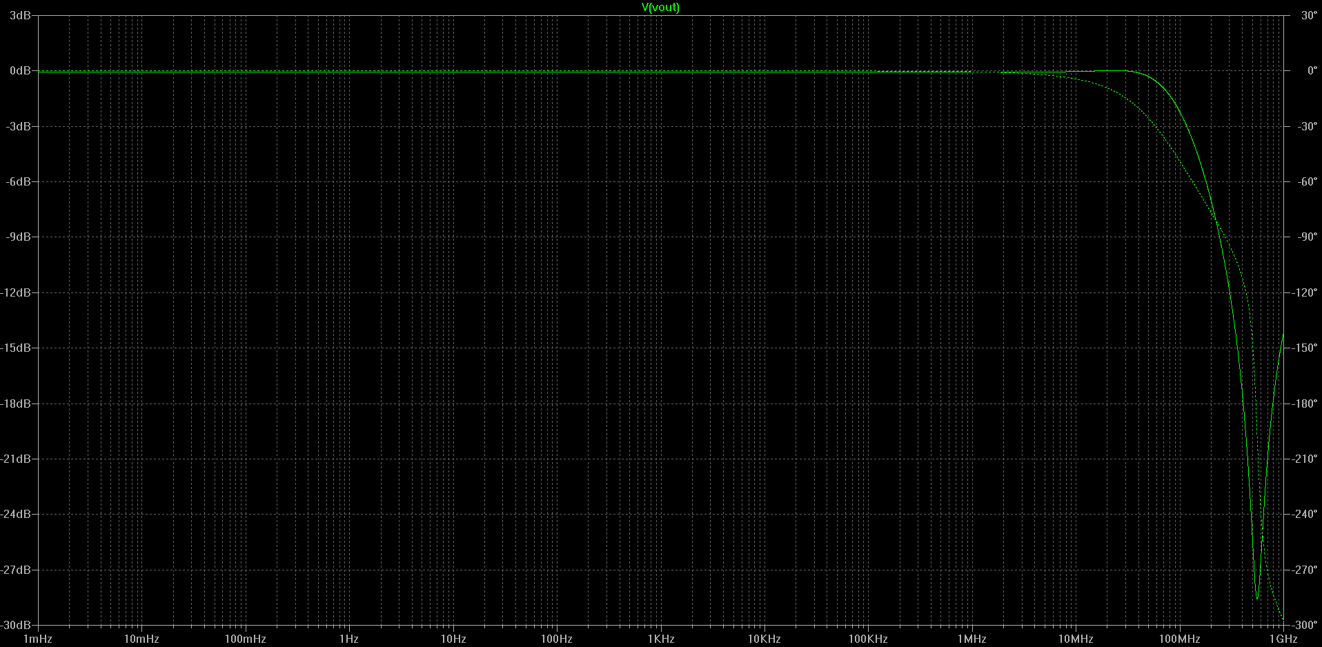

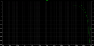

Here is a quick, informal test of the various options.
The triple, plain darlington is also shown for reference.
The devices are realistic, typical of such an application, and the DC bias current is 1A.
Some surprises: the pure D is not the one showing the least peaking (green trace).
The darlington-input variant is the winner (cyan trace), and unexpectedly the worst offender is not the full-sandwiched CFP (yellow), but the darlington-out one (red)
Offered for what it's worth: in order to draw definitive and general conclusions, a full analysis and discussion would be required....

That's brilliant Elvee. That cyan trace (of the one circuit I hadn't thought of) is almost anomalously good. What I'm taking from this is that it may be acting as a high beta device as the wrap around. I'll test this myself and see if a single device with a changed BF does the same thing.
We also seem to have lost some capacitors on that one, with only 80 deg of shift at 200MHz. Does it go to 180 or 270 further up? It would be very neat if we have managed to lose one.
Something is very wrong with that darlington-out red trace. The phase seems to go the wrong way. Nothing comes to mind as to why that would be, but it's off the cards now. I like the look of the cyan trace and the topology is such that it seems to be inviting another power transistor in parallel.

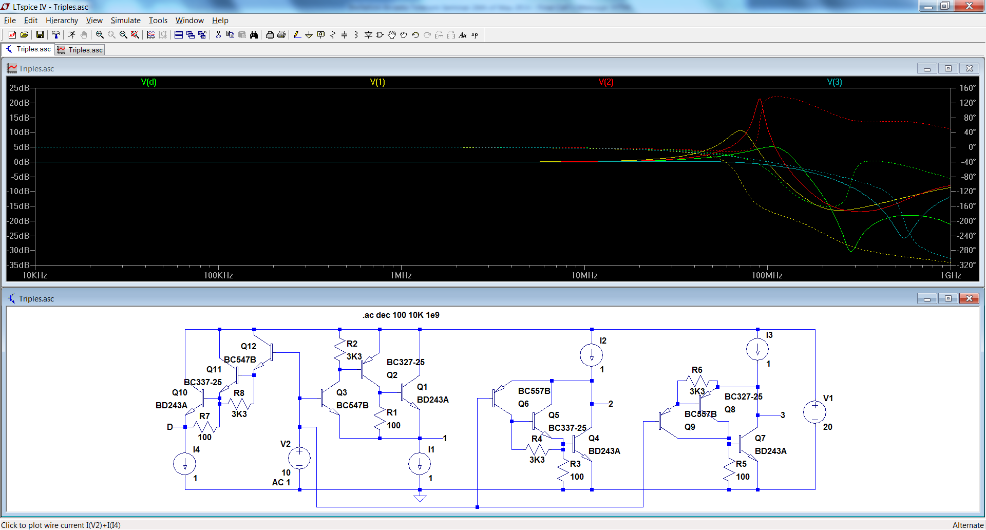

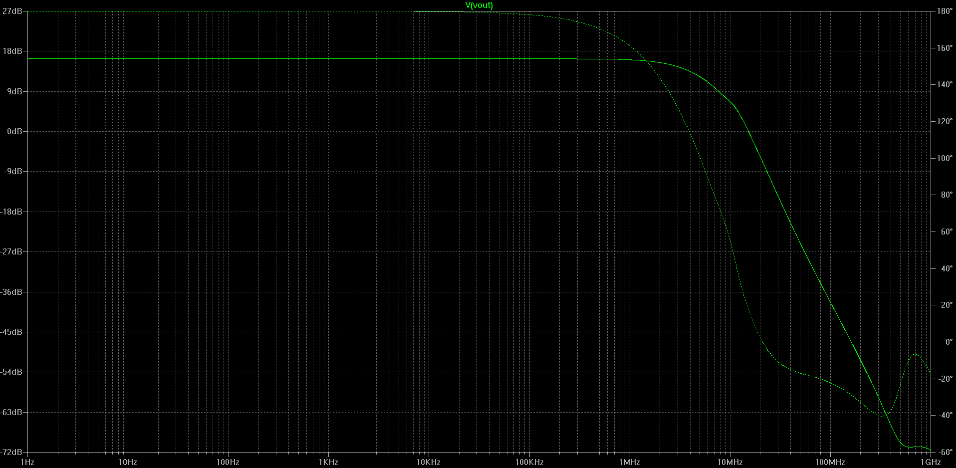

Yes, and it remains well-behaved at higher frequencies, see below
Here is my interpretation: the small-signal, high(er) bandwidth darlington-in closes the loop around the slower output device, but since the transconductance is relatively low, the resulting composite is well-behaved
The darlington-out configuration definitely seems problematic: it already shows in the pure darlington version, and becomes truly catastrophic in the CFP-in topology.
Something I find hard to explain is that the sandwiched version looks better; even the phase looks more consistent; there must be some subtle compensation mechanisms at play there

Those rolloffs are too good to be true, of course, Padamiecki. But they are way better than the alternatives. As you say it definitely has potential. It's a very nice, soft, almost maximally flat second order for the most part. It does seem to speed up a bit later but only for the zero. That would seem to imply that we have managed to lose one of the capacitances, presumably by them being in series. Whether that works in real life is probably another question.
I wonder if there are some NPN vs PNP issues here too. We'd need to fake some parameters to keep them the same. I haven't done this simulation yet. I went to find a model for BD243 and 244 and then got carried away in something else. And they're not in my standard.bjt which has been blitzed by an update, losing all the Cordell and ztx models. So it all looked like a bit of work editing it again. (Yes I know that's not the ideal way to do it. 🙂 )
It is quite pleasing that the sandwiched CFP seems to work, because that's the one I thought might go off the scale. There was someone that Doug Self talked about in one of his more recent books doing a 3 transistor compound and there were some good reasons for it. I know that one of them for CFPs in general is that you can reduce the value of Re but I think this one had even more going for it? Any ideas what that was, anyone?

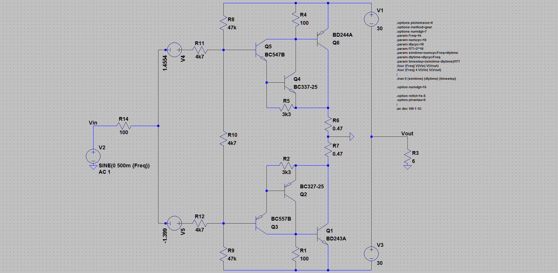

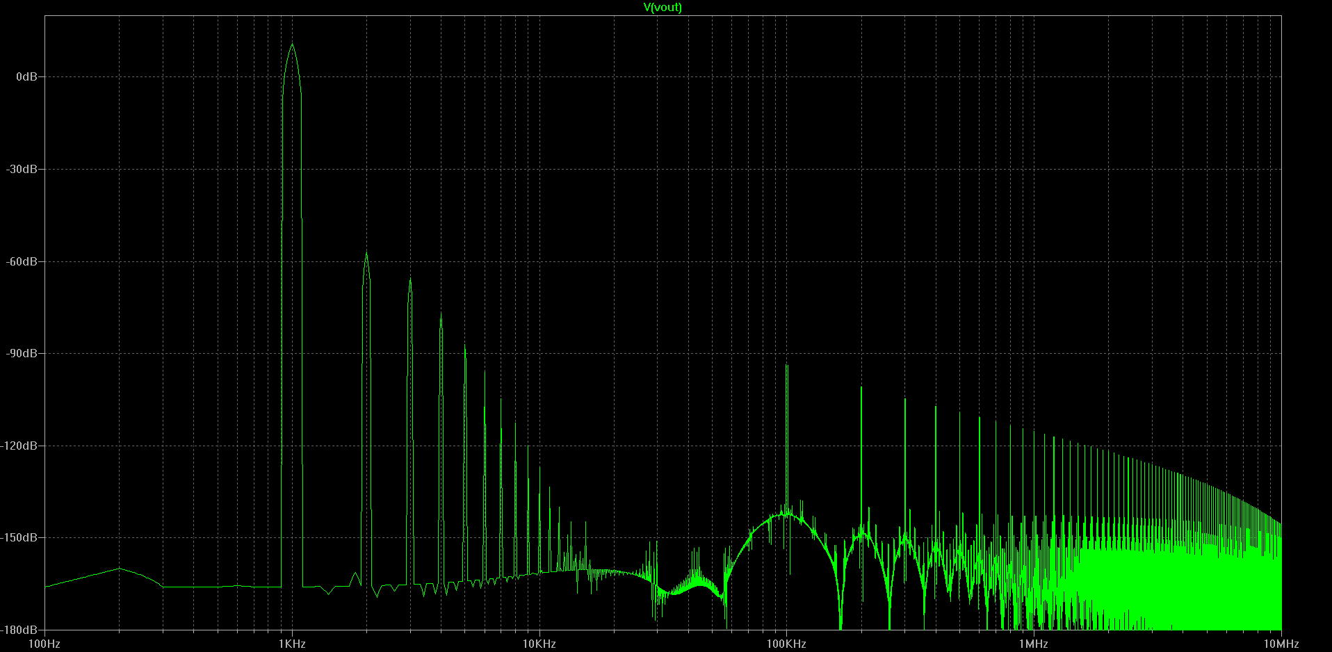

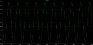

PS. Padameicki, are those harmonics correct? 60dB down in Class A for 2nd might sound very nice but doesn't seem an ideal starting point. Obviously it will get better with feedback but it doesn't look like the starting point for a four zero THD amplifier. (I should say that I've never simulated distortion on a Class A amp so don't actually know if this is good or bad.)

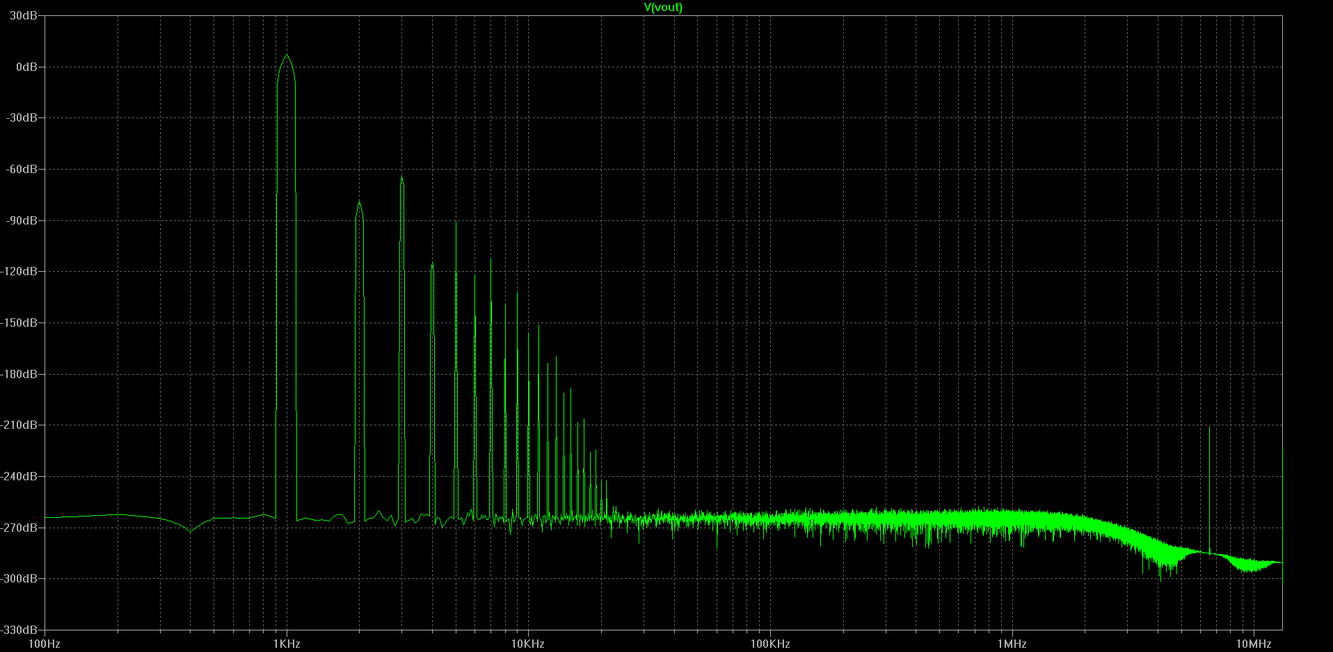

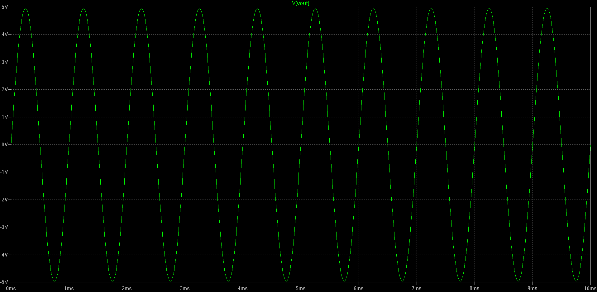

fft was correct,

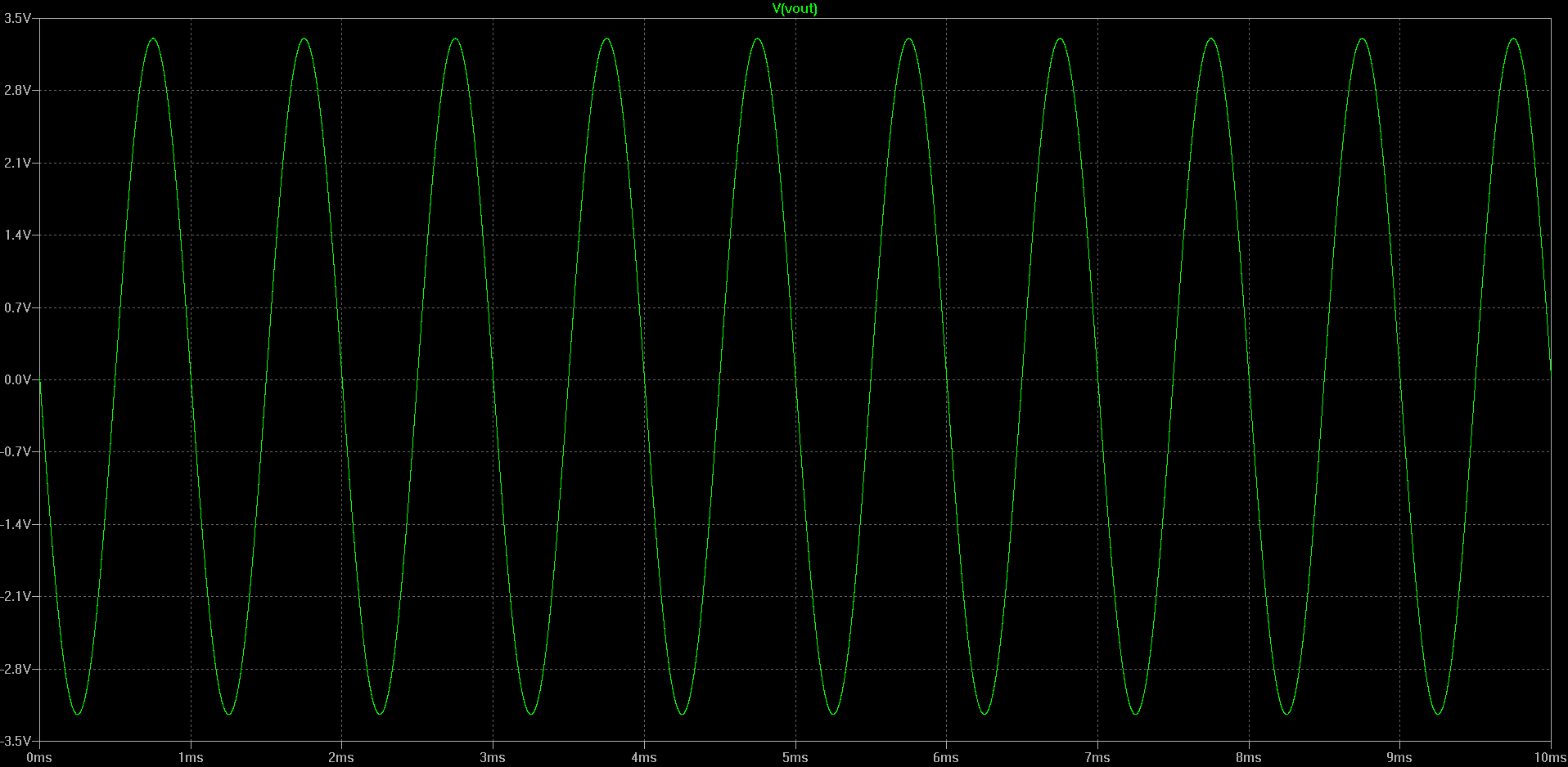

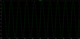

I tried my favourite transconductance amp made of those tripples with gnfb, for small signals it is working good enough with ~400mA idle and 32mV offset, voltage sources are instead of the caps. For larger signals this amp needs more class A to work without major distortion.
Anyway the potential exists but how to use it is next thing...
That's an interesting way of doing it. Thanks for uploading the .asc. I have got a model for the BD234/244 from OnSemi but it occurs to me that it won't necessarily be the same as the one you have. Nor does the one I've found agree with the Bourns datasheet. 🙂
A couple of things crossed my mind here. First, it will be interesting to see what it does with some big and lumbering power transistors. Will it really get them to move faster? You see I doubt this. The only thing that could be happening if there were signal at 25MHz is that it would all be coming from the drivers. The other thing was that we could try a Baxandall diode. Switch off is a problem with CFPs and that could help. Also, varying the value of the 100R, which again is there to help with switch off but is going to limit the current. On my regulator (which didn't have to worry about switch off) I started with 27R there and I think ended up with half that. That was into a ZTX653 with a TIP36C as the power transistor.
This switch off would be a good reason to do this in Class AB. I also want to look at the output impedance of the two halves and see how they match up. We could then just drop whatever DC we want onto the signal to use either half.
