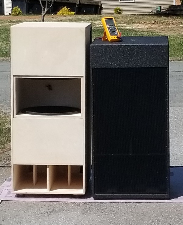

It's outside dimensions are 48H x 21.75W x 31.5 D.
Oh, and it sits on recessed corner caster wheels, and front bumpers that raise it 1.5". We get lots of sudden rainstorms...no more need for 2x4's underneath.

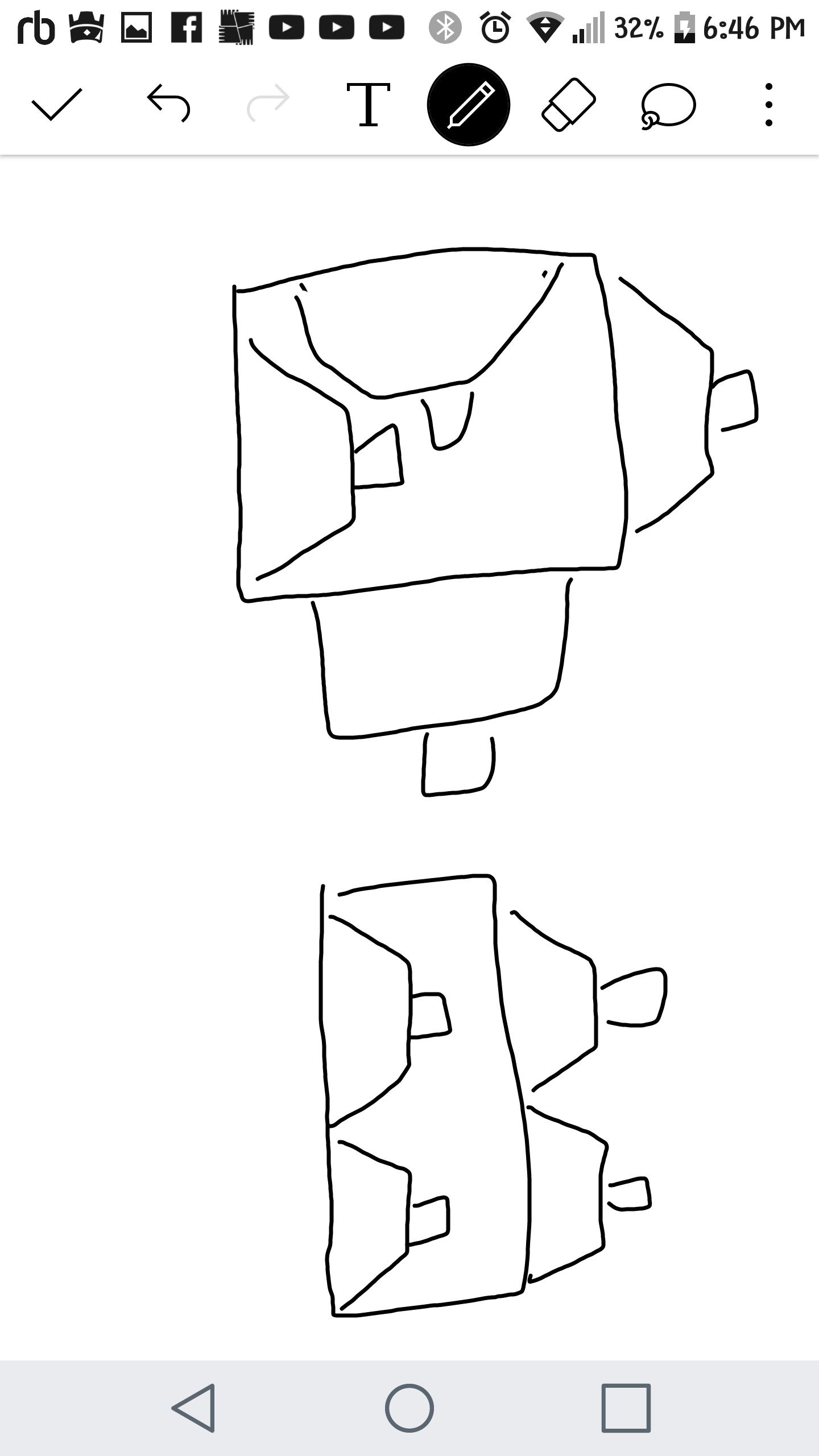

Looking at the attached pict, which one would you call larger?

2)My best net calculation gives right at 300L. It's outside dimensions are 48H x 21.75W x 31.5 D.

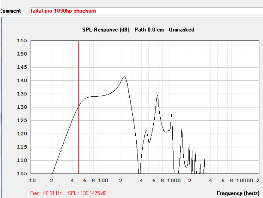

1) Easiest way to see the result of the plenum resonance is to eliminate the BR resonant system, use a large sealed box with no LF peak for the sim.
2) In post #769 you wrote "The OS is a little smaller, which is always better." Can't tell wich is larger without knowing the depth, but now that you have given dimensions, and redacted, we know the answer ;^).
3) Since your box response has a much lower Fb, it's obvious that the port shape and placement has altered it from the sim. Slotted ports tune lower than a circular (simmed) port. You'd have to play around with Hornresp port size and volume until it matches your measurement.
4)Look at the Hornresp schematic and determine which dimension you are looking at.
5) See # 1, the dip is relative to a peaked bottom.
6) Easy to confirm if you are not dealing with a rising response around Fb.

In terms of cone sag, the lower plenum depicting vertically mounted drivers would be better.Which plenum would be better?
In terms of reduced plenum volume vs overall cabinet volume, the arrangements would be driver shape dependent.

2)A more narrow plenum will result in a higher frequency, more narrow upper band peak than a wider plenum, which will have less output in the 100 Hz region in your simulations. "Main output" is an ambiguous term- the plenum increases upper band output, which may or may not be in the desired pass band, and the trade off of plenum volume to cabinet volume should also be considered.
That said, the narrow plenum idea was in response to your desire to have vertical cone mounting to avoid cone sag in a narrow, tall enclosure-the plenum volume does not have to be reduced in such an arrangement if the upper gain is more important than the lower gain lost from a smaller Vb.
3)In your sim, the BR port "pipe resonance" has more output level than the LF output. The port resonance is likely not as predominant when measured as the simulation would indicate. When speaker "Output1" and port "Output 2" are combined with a smaller plenum, the upper peak is likely to appear larger than what it actually would be "as built".

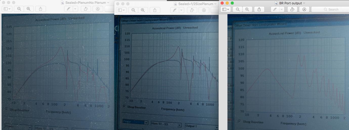

A few sims below, forgot how to do "screen saves" on the PC, so crap quality, but they prove I did something ;^).
Art
Oh no, you didn't just take photos of your computer's screen, LOL!
ALT-PRINTSCREEN will capture a copy of whatever window you've selected with your mouse. If you've got Onedrive installed and enabled, it can automatically save a PNG image of the capture as well.

1)Notice that the rather large plenum needed for push pull 18" results in almost +4dB gain at 100 Hz as opposed to a simple push-pullas can be seen in the first screen shot in post #786.I'm still confused.

7)See item 1. Re-read post #786. Look at the crap screen prints again, the fuzzy pictures contains the information that you seem to overlook.
Note that a standard BR upper response in the 100 Hz region is the same as sealed, but the addition of a plenum changes the upper response.

An acoustic band pass will equally reduce even or odd order harmonics that happen to "fall in the hole".
That said, sorry if I gave the impression that the acoustic band pass "suck outs" from the plenum slot would greatly reduce distortion generated in the usual <100 Hz "sub" range.
From the limited distortion testing of PPSL I have seen, can't say the slot is a big deal, at least not with decent drivers, other than the increased upper sensitivity it provides.
In the simulation example below, the acoustic band pass dip extends from around 300 to 600 Hz.
Maximum excursion occurs around 50 Hz, and maximum distortion will also be generated from around that 1/3 octave range.
The plenum dip would only reduce 6th order and up from that range. Decent drivers don't have much distortion past third order, though there are plenty of PPSL using less than decent drivers being used much higher than 100 Hz..
