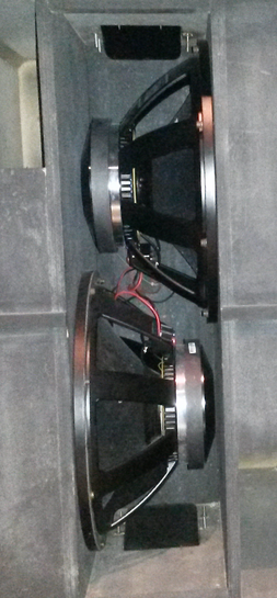

2)There is no reason the drivers have to share a plenum. The drivers could be vertically arranged, each with an individual plenum made by the side wall and it's baffle.
A vertical arrangement could be made even thinner than your present "too skinny" (for the Golden Ratio😉 )cabinet.
3)I don't see any Xlim spec for the BMS18N862, but assuming it's like others of it's general appearance, Xlim would be around double Xmax, about 38mm.
The surround could extend about 18mm past the 3/4" baffle at Xlim, so that would be the absolute minimum. I think 38 mm would be plenty.
Easy enough to test by jamming some scrap between your drivers.

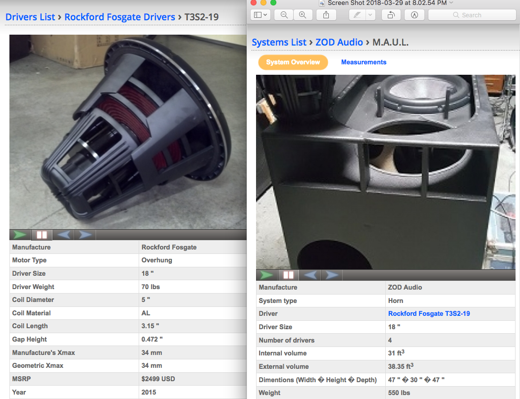

As an example of a huge excursion driver (34mmm Xmax!) with very little space in a plenum, look at Josh Ricci's M.A.U.L with the installation cover removed. The inner driver does not have much more distance to the wall than Xlim from what it appears, and the quad cabinet comes in with very low distortion.

2) do you think staggering would provide close to the same vibration reduction, as directly opposed?
3 & 4) perfect, thx
1) Each doubling of cabinets brings efficiency up 3 dB.
That said, if I owned Orbit Shifters, I wouldn't be messing around with the BMS 2x18" ;^).
2) Close, but not quite. There would be some diagonal torsion force due to the offset, but that force would be very slight compared to two drivers jack-hammering forward and back.
With the thin Neo magnet structure of your BMS drivers, you should be able to get the spacing tighter than the example below:

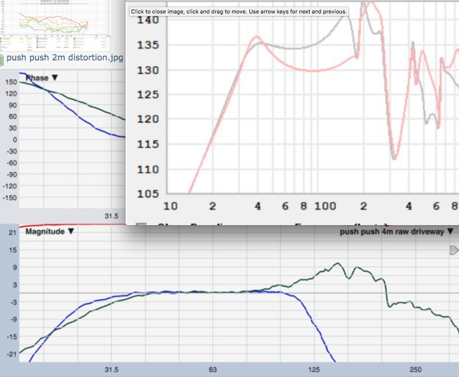

So today, I put my push-push side by side with an Orbit Shifter, as a bit of a final test.
Art, I have to say, it's a pretty easy decision... the BMS push-push(PP) wins for me....
They both have the same sensitivity, when x-over and peak flattening are in place.
They both take the same power....same 3 kW, 4 ohm, amp requirement. Maybe the PP can take a little more power, program is 6000w.
The OS uses only one driver...advantage OS.
They both weigh about the same. Maybe the OS is 10-15lb lighter, not sure. No real difference in handling.
The OS is a little smaller, which is always better.
The PP has substantially smoother raw mag and phase response.
The PP goes lower.
The clincher, the PP simply sounds cleaner, more detailed.

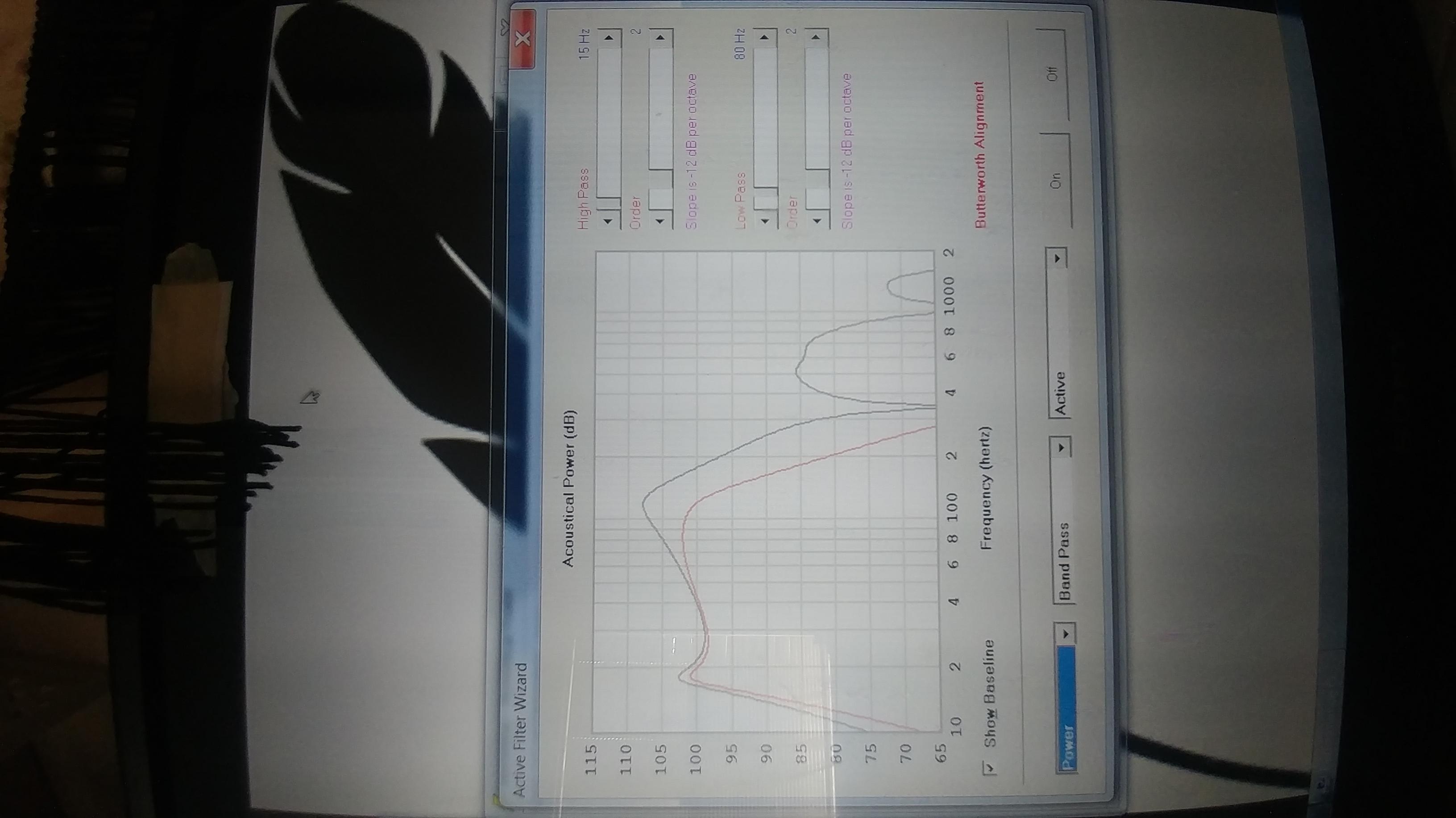

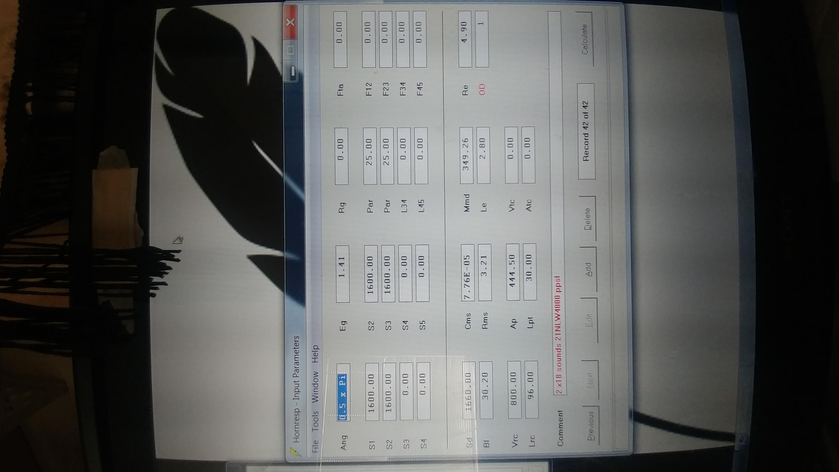

These are the inputs and outputs for a pair of 18 sounds 21MLW4000 subs in a PPSL I sussed out.
Can it be this simple and have that good a bandwidth?
Am I missing something?
It's a monster of a box but I've got the room and the drivers are inexpensive on Amazon.
I put in a highpass to control excursion below tuning. Lowpass will be per taste in place at 12db/oct.
Your input screen shows "OD" (Offset Driver) with only one driver, PP requires two, so you are missing something ;^).Am I missing something?

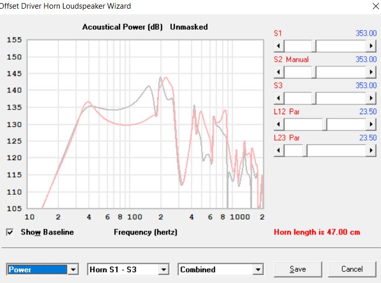

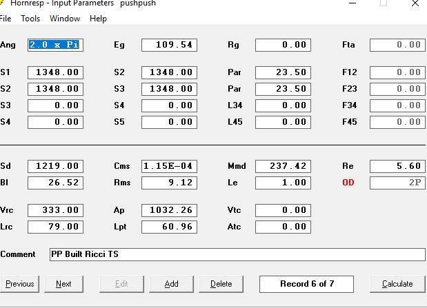

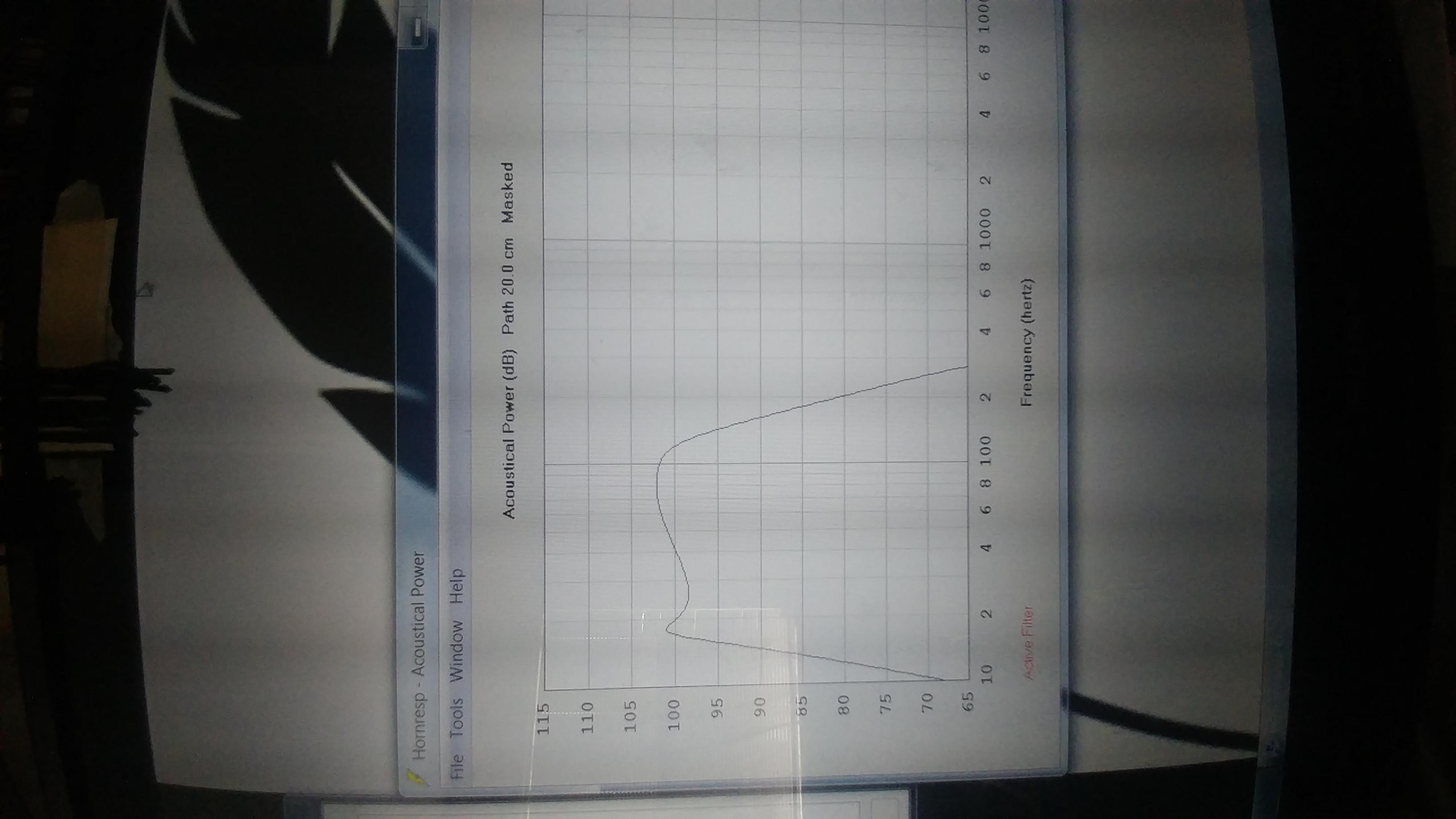

Hey guys, I've been trying to model the box I built with the drivers turned vertical, firing into a narrower plenum.
The existing plenum is 11 inches wide.
I'm hoping to use a plenum about 3" wide, in some fashion like Art has been showing me...
I've been using the model Brian helped me with earlier, that matches my box's measurements fairly well. It's input page, with 11 inch wide plenum is below.
And then, just changing plenum size to around 3 inches with the Loudspeaker Wizard, follows next.
The magnitude of the dip in response centered around 100Hz seems to almost linearly follow the amount of reduction in plenum width from 11".
What am I doing wrong? Thanks guys...

Is your 2x18 only 333 liters net? That's only about 12 cubic feet, and you said the 2x18" is larger than the Orbit Shifter cabinet, which is 18.75 cubic feet exterior volume.Hey guys, I've been trying to model the box I built with the drivers turned vertical, firing into a narrower plenum.
The measured response of your box shows the upper peak around 12 dB higher than at Fb, so for starters, your sim model response is not matching your measurements well at all regarding Fb and general response shape.
Being off by around 10Hz makes a "high Q" LF peak at the 40Hz Fb instead of the gradual roll off with the 30Hz Fb (IIRC) your actual box has.
The peak at 40 Hz makes what appears to be a "dip" in response around 100 Hz because the smaller plenum gain is centered higher and is only half as wide (higher Q). The thinner plenum width also eliminates the dip in the center of the larger plenum's gain range. That dip can be seen in both the measured and simulated response.
The narrow peak and dip amplitudes will be less in actual measurements than Hornresp simulations, but should occur at the same frequencies.
