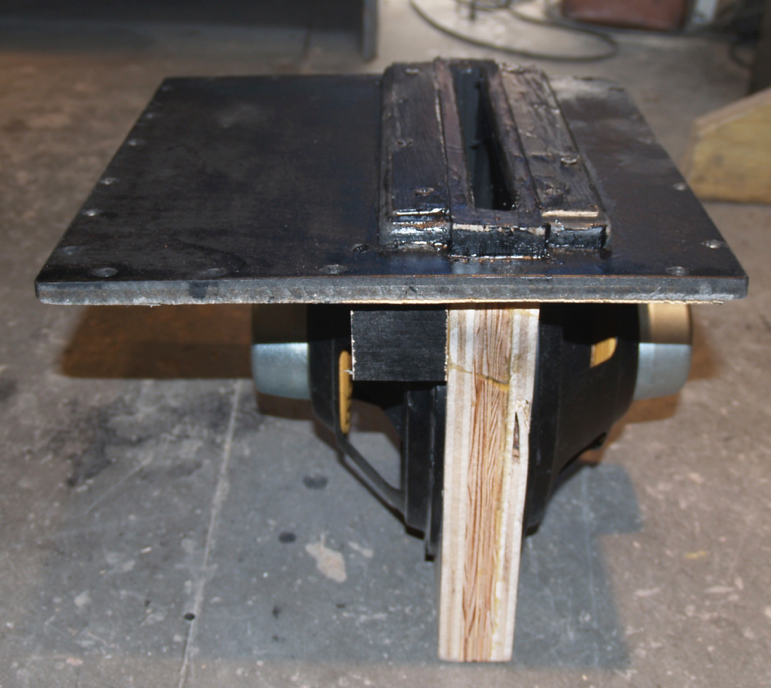

As a reality check, I've used a plenum exterior exit in a push-push design with a 14/1 Sd/exit ratio, and that ratio is exceeded in many Synergy/Unity type designs with no cone problems.

Perhaps the photo below will help explain- the push-push plenum exit dimension is only 3/4" x 10.25". This dimension caused no audible "chuffing" or cone problems. This arrangement allowed replacement of a single 12" driver with 2x10" with no cabinet modifications.
If one of the speaker baffles was 3/4 inch (.75") from a cabinet interior side wall, three times the area would be open and the output of one driver rather than two would go through that area.
The distance from the baffle to the cabinet side could be reduced to 1/6th of .75", just .125" and have the same air velocity.
Art

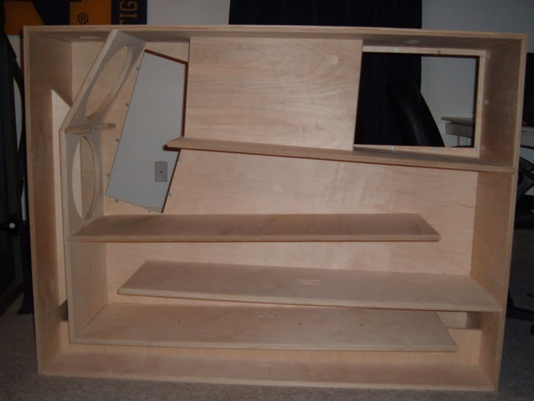

1)Doesn't the nature of a TH sort of negate the need for a slot, since it also minimize odd-order harmonics? (Or do I have that wrong?)
2)If that's correct, then it would be much simpler to simply make two TH subs, with one reverse-mounted and out of phase, then just group them.
You might have to make them slightly larger internally, so that the external dimensions were the same, but it would still be much easier than a true PPSL with horn loading, no?
1) TH don't "minimize odd-order harmonics".
2) You are mistakenly using "phase" for "polarity" (they are not interchangeable terms), but a "reverse-mounted" TH is not as easy to build as a standard TH, which has the driver's magnet in the mouth of the horn. The throat normally would be too shallow to fit a magnet assembly, so standoffs would be required to make the area of the throat chamber (ATC) equal to a driver mounted with the cone side to the throat.
Push-pull TH are generally built as in the photo below, with the magnet facing left in the upper "stub", the magnet facing right in the lower horn throat entrance.

1) Push-pull TH are generally built as in the photo below, with the magnet facing left in the upper "stub", the magnet facing right in the lower horn throat entrance.
