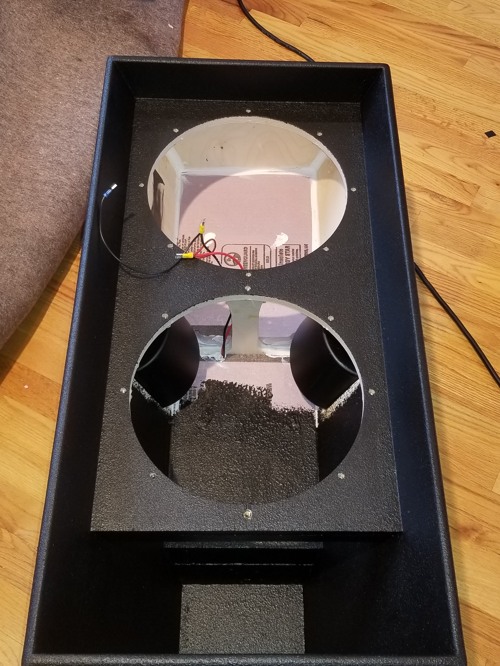

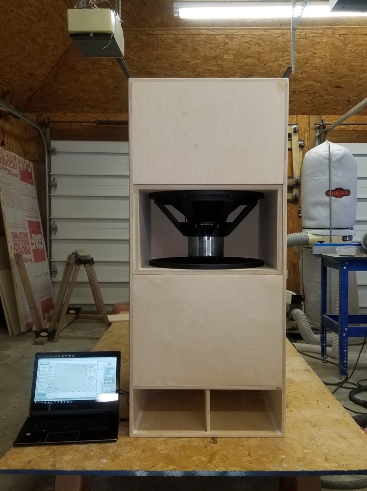

bms 18n862, 340L, 49" x 21.75" x 31.5" D
120 sq in port, 24" deep.
Port is still adjustable..awaiting outdoor ground plane measurement...
Stoked !
Thx to all, especially djk, for this thread, this build...
Stoked !

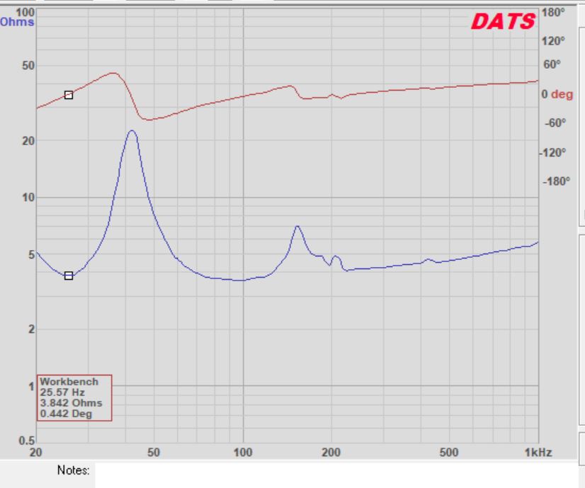

How does that measured impedance compare to the sim?
Both DATS and Hornresp can export impedance data to ZMA files, and these can be imported into REW for comparison purposes.

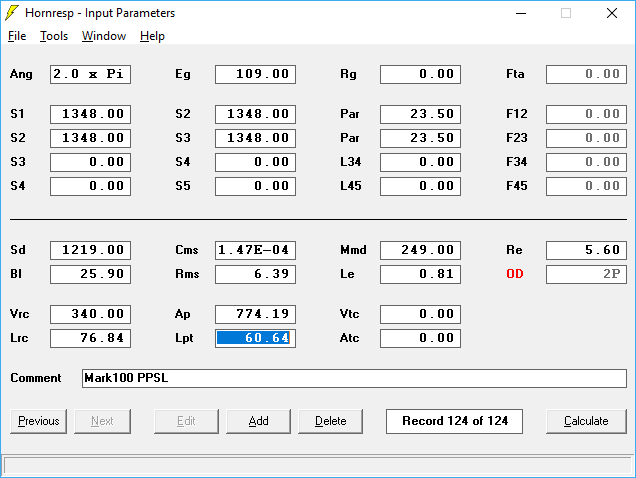

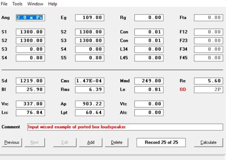

My DATS impedance minimum is a little lower that hornResp 30Hz.
But I have no idea if I modeled right....input screen is below...
Any observations/corrections , good or bad , appreciated...
The phase is 0 degrees at around 30 Hz, so it looks like target Fb was achieved. What's happening between 100 Hz and 200 Hz though suggests that your model isn't complete (looks like the effect of the plenum needs to be included in the model). What's the depth of the plenum and how far from the closed end are the center of the drivers located?
Another thing is that your minimum impedance is significantly higher than the Hornresp sim. Do you have any stuffing in the box? If not, I suggest recalibrating the DATS.
Getting Fb close was about all I was shooting for, beyond matching the volume and port size I used very happily on single BR's with the same drivers.
The box doesn't have any stuffing. The plenum is 11" high, about as short as I could make it. Depth is 18.5" Width 19. Pretty much as small as I could make them.....
I recalibrated DATS...same results. DCR looks spot on, just for checking..
So yeah, something with the plenum interaction I guess...I really can't stress enough the that OD entry I put in hornResp is purely my non-understanding monkey-saw-it-somewhere, attempt at going beyond a BR model...
I don't want to get too concerned trying matching sims to measurements....mainly because I found three sets of TS for the driver,... BMS, data-bass, and voice coil, and they all differed enough that I'm like 'what the heck is the value in dissecting sims past a certain smell test point'
But I would like to learn how to model the plenum....I know it has a LP effect but that's about it..

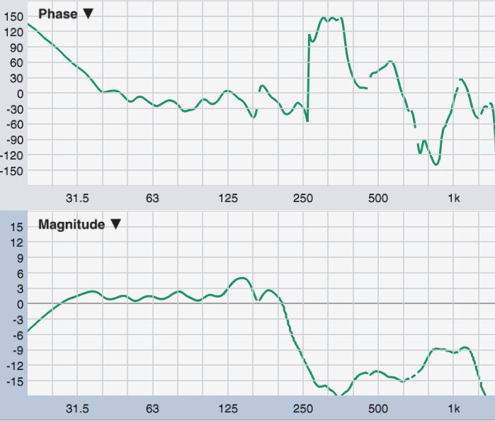

Ok, I just took a mic-on-floor, in-room raw measurement just to get an idea of what plenum does as far as a LPF...wow, does alot IMO.
Can't wait to make some legit outdoor groundplane measurements..

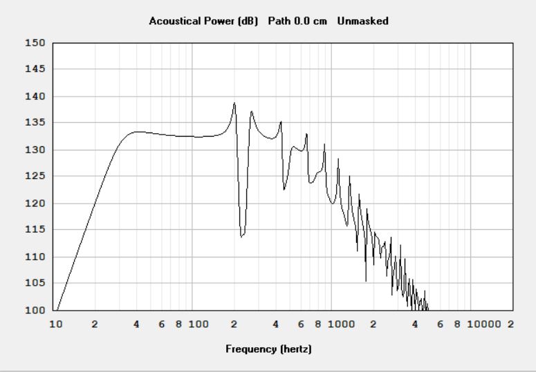

The attached pic should be a closer match to what you built...

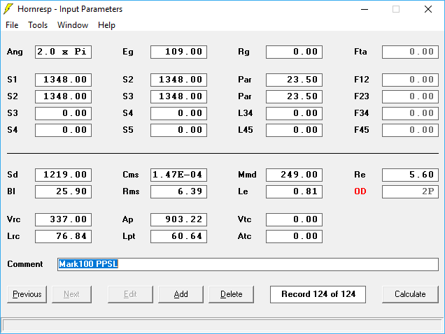

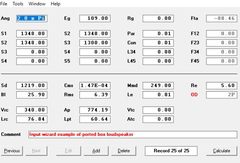

Thank you Brian, your inputs page looks closer....rolling off steeply at 200Hz as in my quick and nasty measurement.
My measurement pretty much stays down in response after 200Hz to 400Hz anyway, where the sim doesn't ????
Oh, my apologies ...the input page I posted was in contemplation of raising the port an inch....below is an accurate input as far as the cabinet as is, as a dual BR, with your plenum corrections..

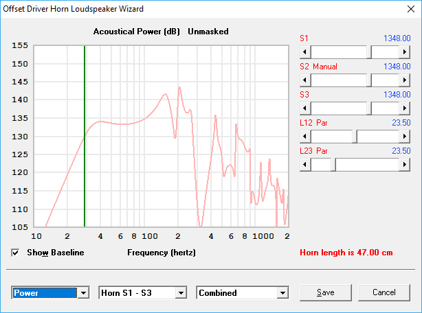

Nope, the plenum isn't described properly in that sim. The length of the S1-S2 and S2-S3 segments is incorrect. See corrected version below.
Above 200~300 Hz, the response is much more influenced by the driver's FR, so the Hornresp sim is more inaccurate in that range.

BTW , 774 cm^2 of vent area seems a bit... small for two 18" drivers like those in a box aimed at PA duty, though it does help to keep box size down, I guess. When I designed my POC6, I designed an MLTL with vent area = 2/3rd Sd for a 12" driver with 5mm Xmax, and I was still seeing 1~2dB of vent compression around the vent resonance frequency.

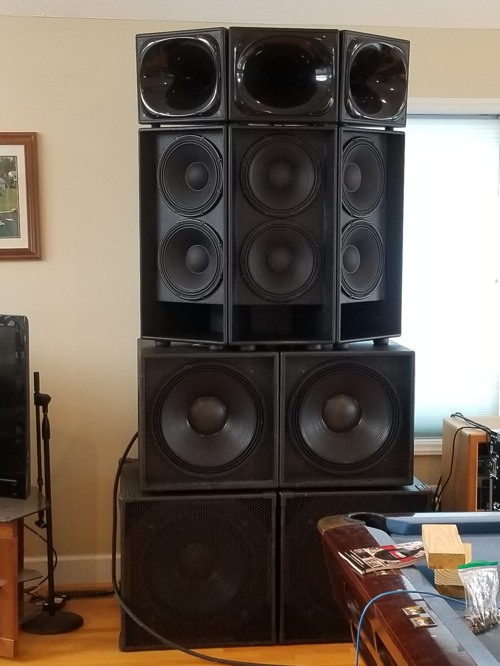

I don't really understand transmission lines, but a couple of guys who looked at some mid boxes i recently built say they are of that ilk.
Pls note the increasing stepped depth from top driver down to the vent. Would you call that a TL ?
Those are the boxes I need to figure out subs for.
The drivers for the PPSL came out of the sealed 18's.
The PPSL will be able to directly compare to the vented 18's,
using the same drivers with very similar BR volume/port design.
So far freq response looks near identical between the PPSL and the vented 18's.. they do sound a wee bit different though...more to determine...

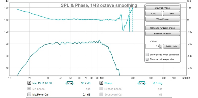

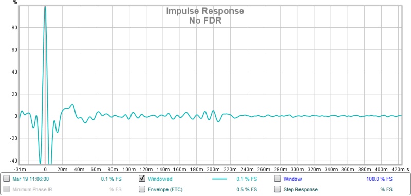

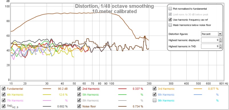

Had a chance to get a basic outdoor ground plane measurement today on the PPSL I've posted.
The port shelf is just screwed in place for response verification, and it started to audibly flap around the 30 Hz neighborhood, when I raised levels to 120dB, so I didn't crank it any.
Add 20dB to the traces, as measurements were taken at 10 meters.
So about 110dB @ 1m for these plots......
Processing includes high-pass @25 Hz Bu4, and low-pass @ 120 Hz LR16.
Default 1/48th smoothing, and no FDW on any.
Happy camper so far !

Sealed box looks like it should be 1.84'^3 before drivers and slot.
Slot opening looks like it should be ~6"x12" wide (1/2 total SD, 76"^2) and I guess about 12" deep. How do you install a 9" deep sub in a 6" opening? 😕 I was going to leave the plenum square as I am not looking for higher extension.
The plate amp I have is 800 watts at 8 ohms (plan was to wire drivers out of phase in series) and use a 6db gain at 30hz (amp has 5 point variable PEQ) to get an F3 of around 27 hz (my hope was the PPSL design would lower the F3). I have an Omnimic and REW to hopefully EQ it correctly.
Thoughts on this plan? Do I have the basics correct for a PPSL sub? Or am I out to lunch?
My goal was the most sub in the smallest space.
Plan B is to build a M&K clone...
Thank you,
David, London, Canada
Creative Sound Solutions | High End Speakers and Speaker Kits
Hi David,
width and depth obviously have to accommodate the diameter of the driver, plus a little wiggle room. Looking at your driver with its 12 9/32 diameter, I'd call that a minimum of about 12 3/4 x 12 3/4.
Height has to be the height of the driver, plus the thickness of the driver's mounting flange, plus a little wiggle room to be able to slide the inverted driver into place.....
so 8 3/4 driver H, plus 11/16 flange, plus 1/4 wiggle...
... about 8 31/32 minimum height IMO...
make sense? best, Mark
