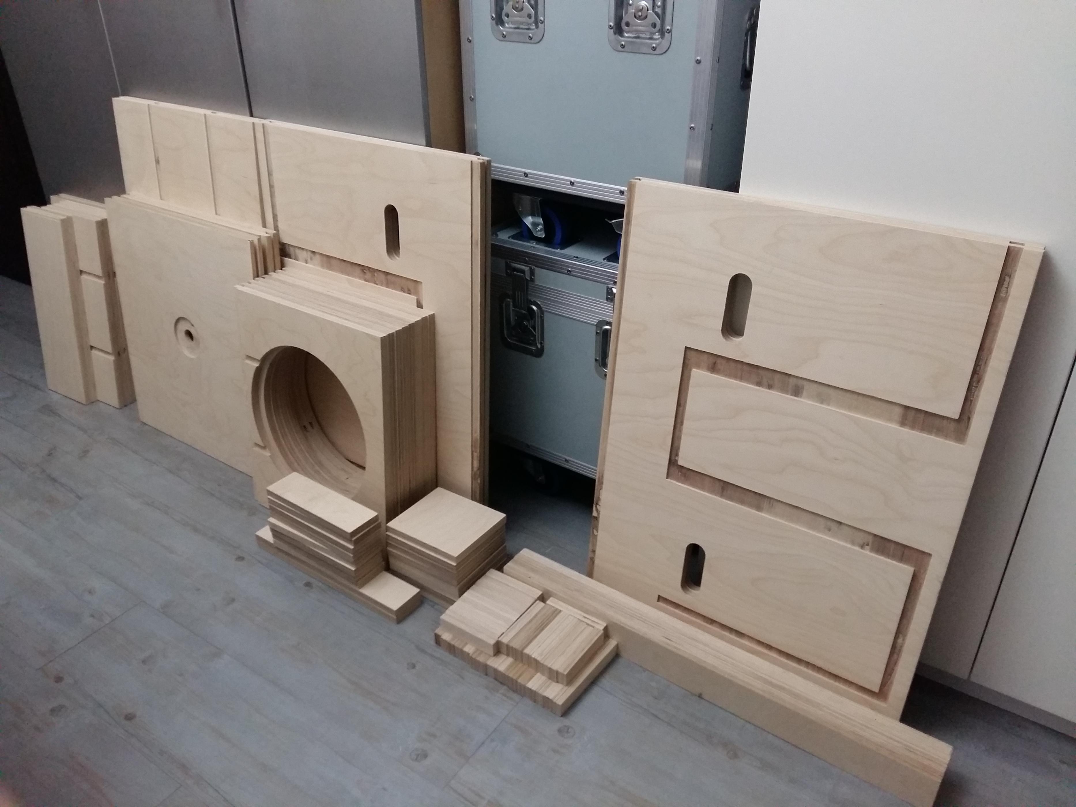

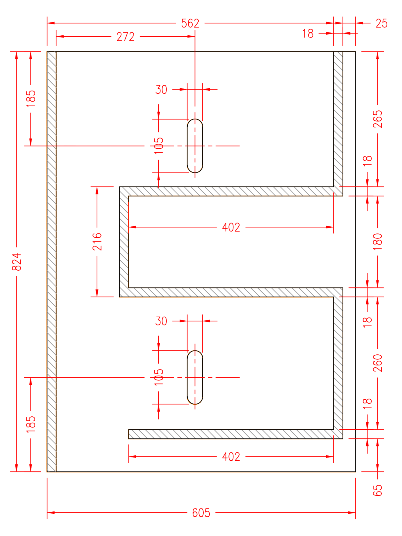

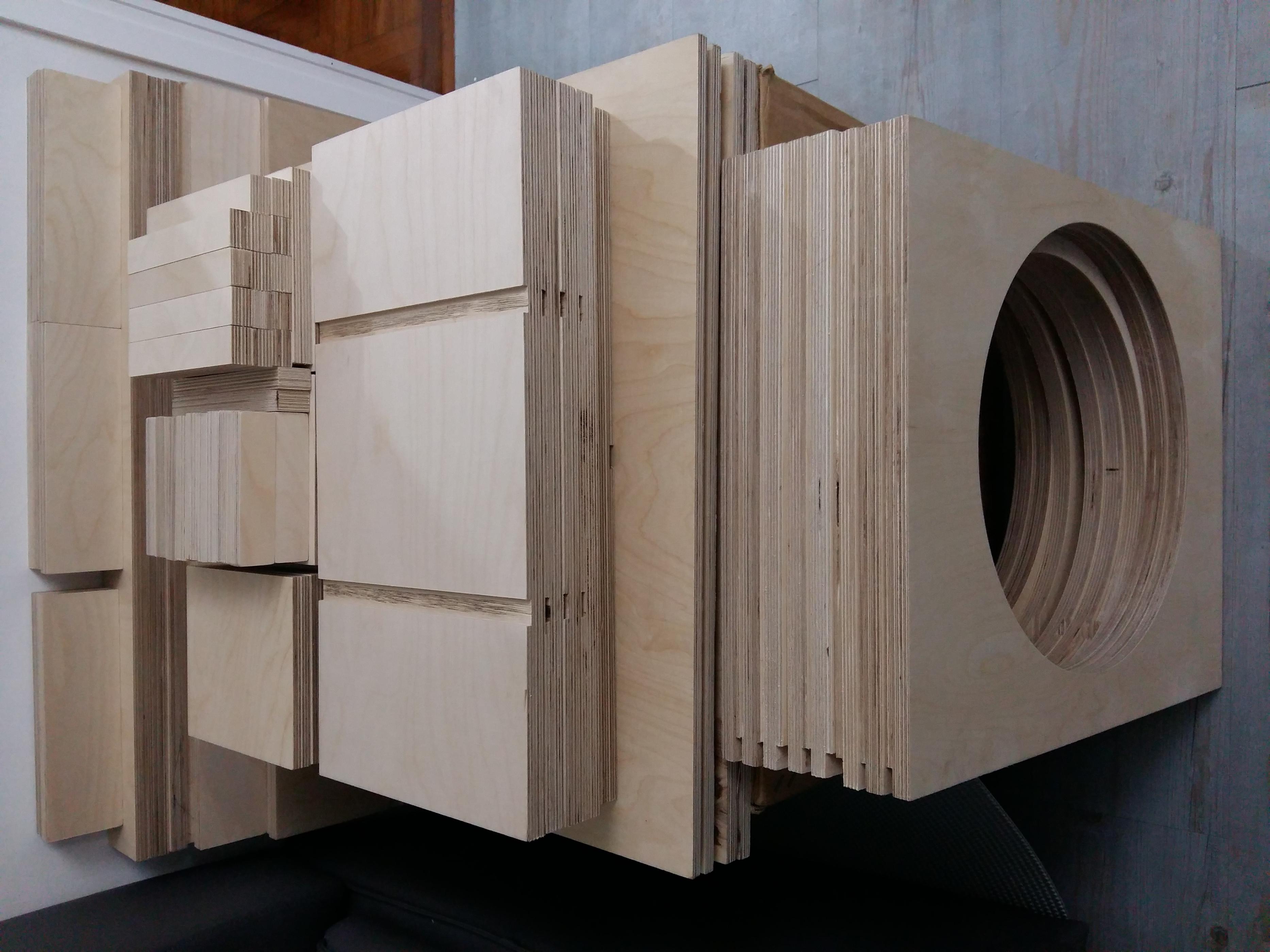

I decided to go with the PD.1550 specs you've provided rather than the Fane as I have 2 ready, but might hurt my pocket later on if I decided to expand to 4 cabinets.
I attached the link for the cabinet, if you have free time, please check the specs for any corrections.
External dimension L33 1/2" X H 21 5/8" X 23 5/8" (approx.) as it was drawn in metrics 85cm X 55cm x 60cm.
I will be using 18mm/13ply Russian Baltic Birch and will be built fully rebated.
[images removed]
Plus, I enclosed another 15" PPSL driver candidate, somehow similar with the OEM 15629 and Kappa Pro 15. maybe you can also provide the best cabinet dimension for this driver (15FH500).
FaitalPRO | LF Loudspeakers | 15FH500
Djk,
Will (2) Two PPSL 2X15" cabinets perfectly match (2) Two Sls920 per side outdoors?
Thanks.

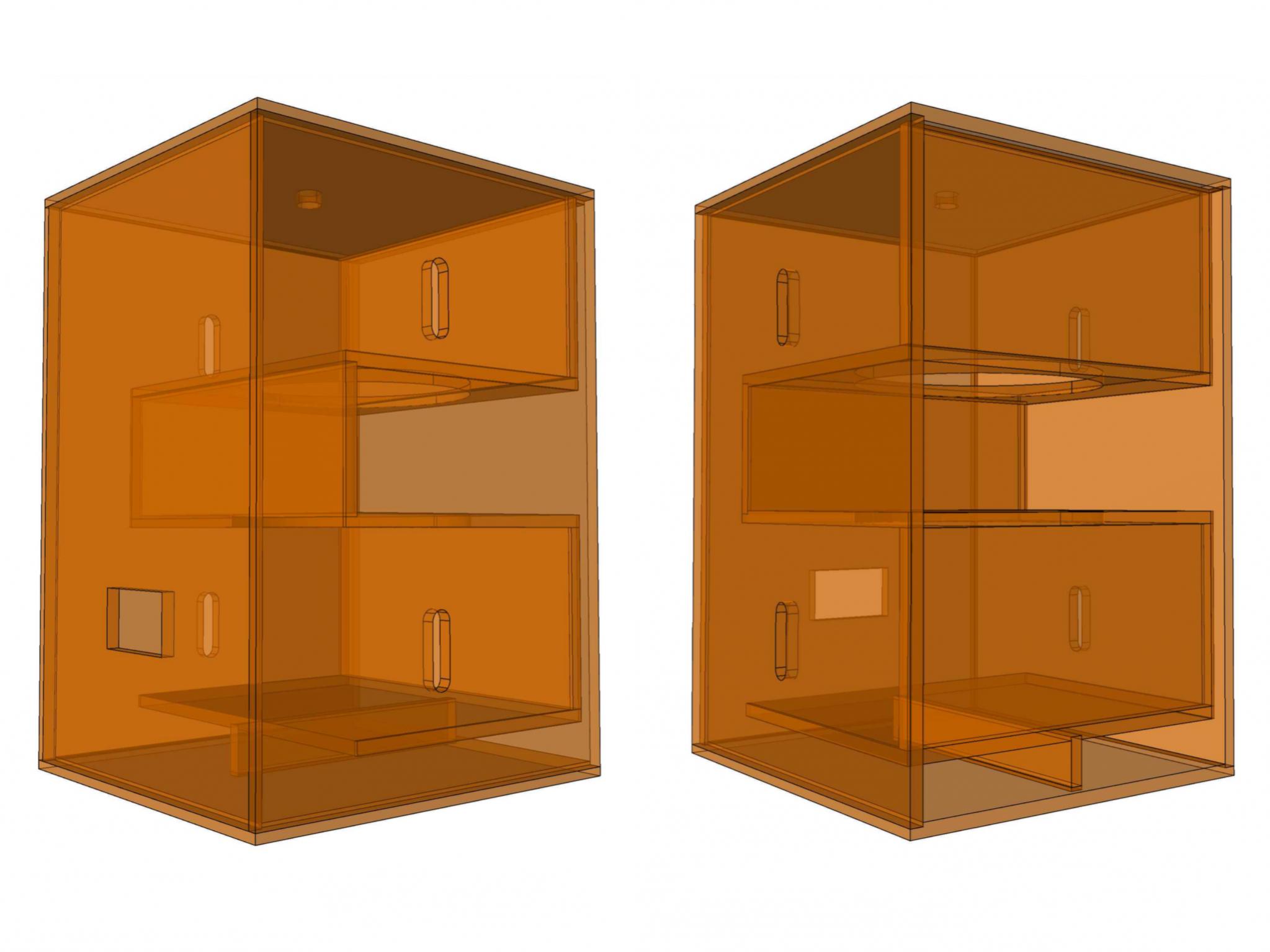

Here's the PPSL 2 x 15" (for PD.1550)
- bracing wil be as described by Djk and wil have pocket handles.
- will utilise the PPSL upright for singles, sls920 pole mounted on top.
- external dimension H 550mm x W 850mm x D 605mm.
Thinking of building it in double baffles to add strength,
Any suggestions and comments will be appreciated.
Thanks.
