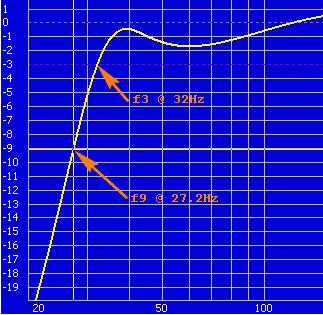

Just for eg, i simmed the Fane COLOSSUS PRIME 15XS
FS 36.3 Hz
Qts 0.310
Vas 149.70 Litres
as follows
Box int vol = 150L - fb = 36.3Hz - Parametric EQ = +3dB @ 30Hz with Q = 2 - f3 = 32Hz - f9 = 27.2Hz
attachment.php
Agreed though, that usually low Qts = less low bass.
I'll take a stab.
6th order is where you put a driver in a ported box, tune to the f9, then run a high pass filter with a q of 2 at the tuning frequency. The filter does 2 things, it gives a 6db boost at tuning and acts as a subsonic filter below that. A qts around .32, you can tune to fs and box area smaller than a typical 4th order with qts .4 (usualy equal to vas).
Djk explains it better
https://www.audioasylum.com/messages/hug/127065/low-qts
thanks , that shed some light on my question re 6th order and helps me sim my drivers in winisd .
Any driver.
Ppsl can be ported, sealed, tl, or even linkwitz transform eq it flat to 8hz.
6th order is just another way to do a ported.
It works well for qts under say .35 because it gives you a small box, you use drivers with usually higher sensitivity, but you need 6db of boost at tuning. Otherwise, a qts .35 would have less low bass ported and especially sealed than a driver with qts .4, but a qts .4 ideally wants a ported box as big as its vas (big).
