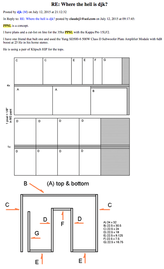

I am designing my first complete speaker system using 4 10" woofers, 2 3" full range and 2 2.5" full range for each side of stereo. Should I use PPSL for the woofers if I cross at 500 hz or just PP without the narrow slot? The woofers are a wide range that do well up to 500 but only have 4 mm xmax so are not subwoofers.
*Impedance: 8 ohms*Frequency range: 34-3,000 Hz *Fs: 33 Hz *SPL: 93.15 dB 1W/1m *Qts: 0.47 I would appreciate any help.
No, please do not use ppsl up to 500Hz. PPSL is best used for bass.

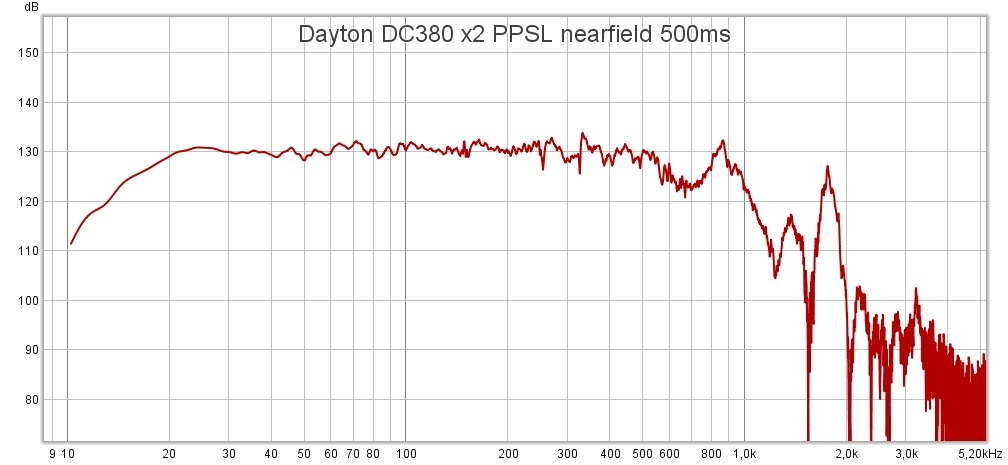

I think I have found a solution for my 18's. If I run PPSL... slot width is no issue, is what I gathered?
There will be an increase in upper bass caused by the plenum (slot), followed by a drop in response, a deep cancellation that won't respond well to EQ, limiting the upper response, not an "issue" unless you plan to cross over in that range.
See #823 for a bit more info.

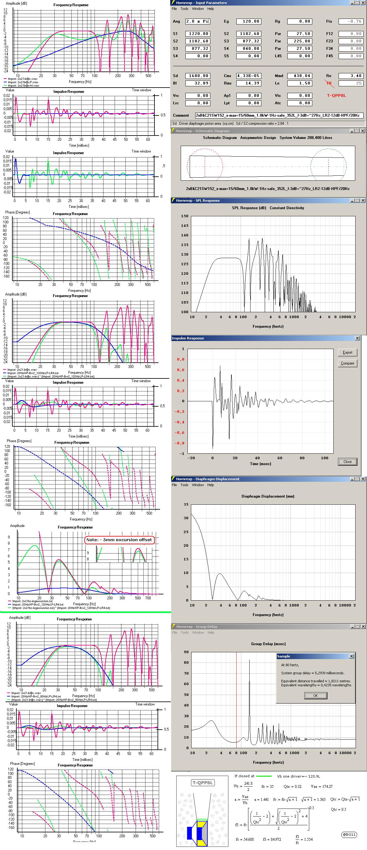

Are you modelling this in horn resp? How?
Post #823 was an actual measurement, though it can be modeled in Hornresp. Posts 779 and later have posted sim input screens and discussion in this thread.
The model is of a bass/reflex and horn, the "horn" being the slot/plenum.
Using ATC and separate horn sections, even the cross sectional volumes the drivers occupy (or don't) in the plenum can be accounted for.

He simply added the volume the speaker plenum slot occupies to a standard BR cabinet
This is really interesting actually. It always seems so complicated but when you explain it like a BR its not that complex.
Thank you both. Still a relative beginner trying to wade my way through an ocean of text on the internet.
Just a clarifying question on this technique. are you saying that you can include the plenum volume as if it was inside the BR chamber, and then model it as a normal dual BR in something like hornresp or WinISD?
The plenum volume reduces the BR chamber volume.
In WinISD you don't include the plenum (or bass reflex port, or driver) volume in the BR chamber volume.
With Hornresp, you can model the effect the plenum has on the upper response.
Post 779 has an example of the plenum (and a "too high" Fb)...
As Norman pointed out, most of DJK's PPSL designs were for PA, where a 35Hz Fb (box tuning) was a good compromise between low frequency response and efficiency.

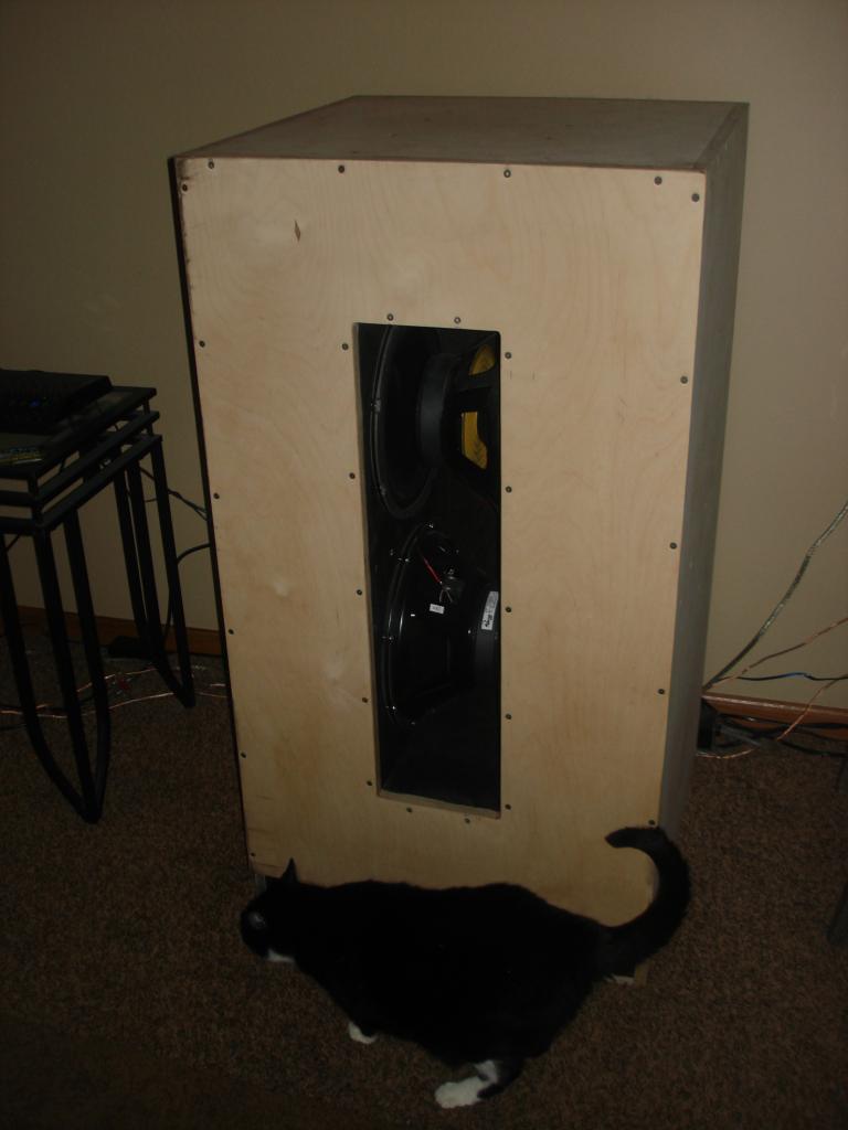

This is my prototype, it is sealed. There will be a top and bottom baffle, and damping material in slot, one day.
