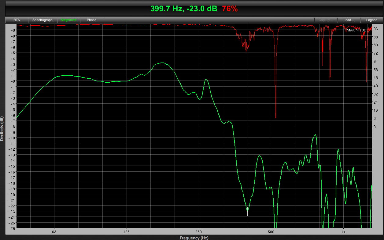

Forgive me if this question has been answered before. I have tried to read the entire thread but may have missed it. How high in frequency can you run a PPSL? Is it only useful as a subwoofer, or can it be used as a woofer below a midrange? Also, does the size of the baffle opening matter? Does it need to be "tuned" for different woofers?
1)How high in frequency can you run a PPSL?
2)Is it only useful as a subwoofer, or can it be used as a woofer below a midrange?
3)Also, does the size of the baffle opening matter?
4)Does it need to be "tuned" for different woofers?
1)Depending on the size of the plenum (slot) 300 Hz would be near the upper limit for 15" drivers.
2) Depends on the drivers, and what you consider "midrange".
3) Yes. A few examples of simulated frequency response can be seen in posts #779 and #796 using 18" and 15" drivers. In all cases, there will be an increase in upper bass caused by the plenum, followed by a drop in response, a deep cancellation that won't respond well to EQ, limiting the upper response.
4)Optimum Fb (box tuning) is driver dependent, optimum plenum size is generally as small as possible for the drivers chosen. The upper "horn gain" of the plenum must be weighed against the reduction of cabinet volume it uses, which reduces the LF output.

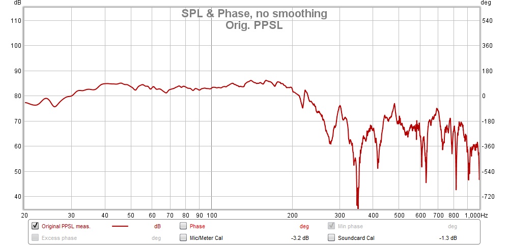

The example below is an actual outdoor measurement of a 2x15" PPSL, the upper response peaks between 160-200Hz, followed by a 23dB dip at 400 Hz, and rough response above.

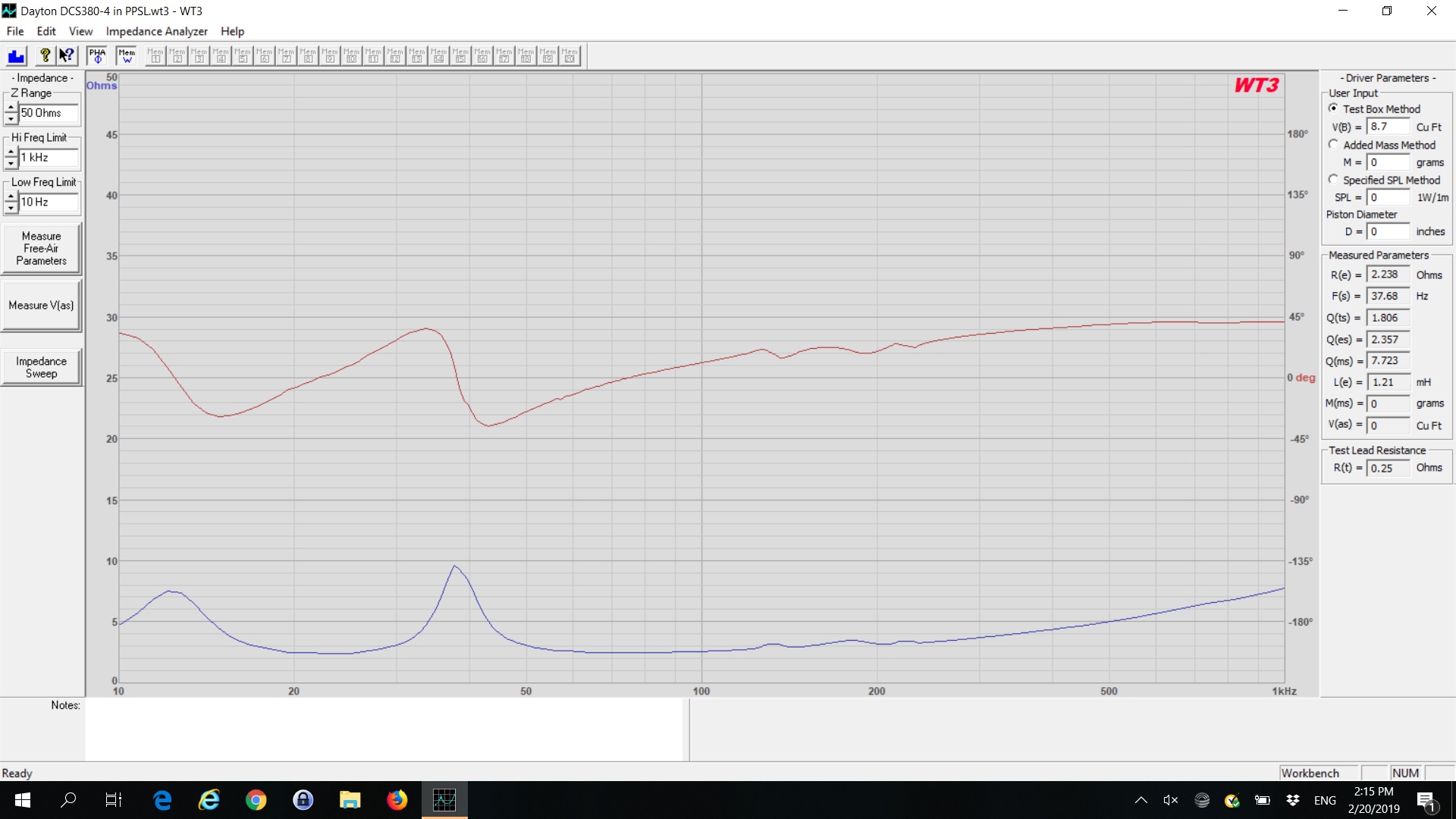

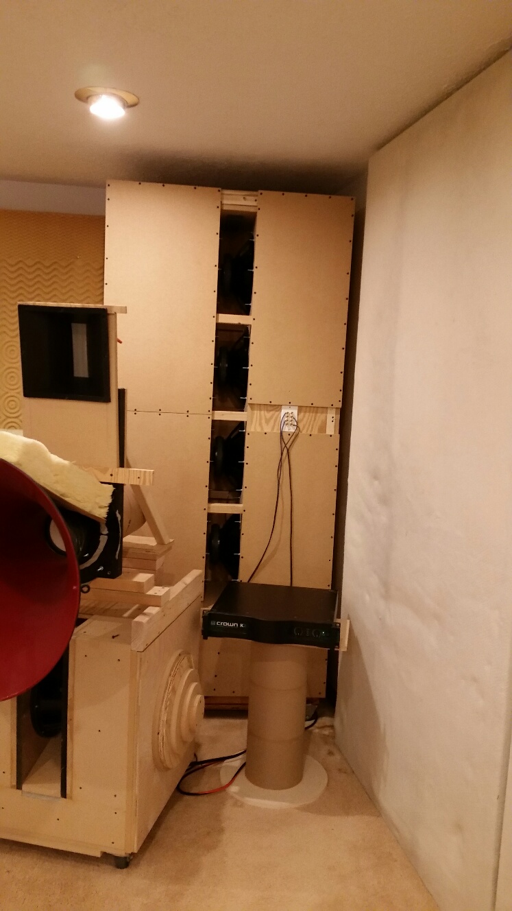

Time to bring this topic back to life. I just built a prototype of the PPSL. Initial results are positive, but I am only getting a very limited frequency response. I need to get in the neighborhood of 350-400hz in order to use this with a set of Oris horns. I selected the Dayton 380-4 15" drivers. Box is tuned to 25hz. 8.7cu. ft. ported box.
Any help would be appreciated.

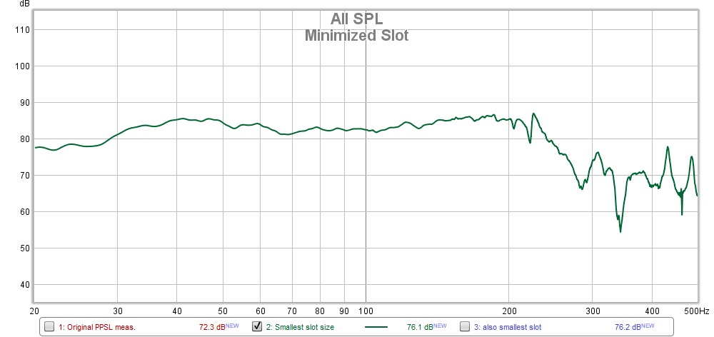

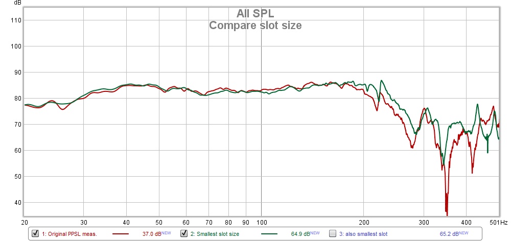

Minimized slot size as much as I could while still being able to load drivers through the slot. Clearly it does make upper frequency improvements. Will need to keep working on this.
I think that the PPSL is a subwoofer design. It definitely wasn't designed to handle midrange duty. That you're getting up to 200 Hz from it is actually excellent. Trying to cross it over higher is likely to be as successful as trying to cross another subwoofer system over that high. It might end up sounding pretty bad anyway.

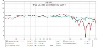

Prototype Summary
Summary:
In case anyone stumbles on this thread in the future....

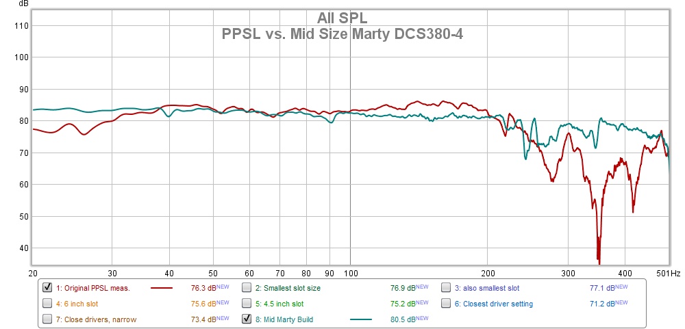

I continued my experiments by creating a wooden ring that I could slide under one driver so as to get the drivers as close as possible and leaving enough room for Xmax displacement. Sweeps on that configuration yielded absolutely no improvement in the upper frequency range. I also tried various slot opening sizes. Clearly, this PPSL design is not usable much above 200hz with the Dayton DCS380-4. The driver is advertised as 20hz-500hz.

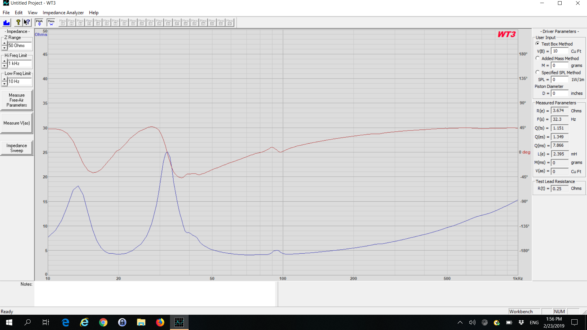

Since I had so much success with my Full Size Marty builds, I though I would convert my test box into a single driver, vented, box. Roughly 10 cu. ft. with the vent I had made should give me a 20hz tuning and plenty of range betwen 20hz and 400hz. The glue wasn't even dry when I ran the attached sweep and this leads me to try a more conventional approach for this project. I'm calling this box a Mid Marty since it approximates the volume of the Mid sized Marty.
I will let the glue dry today and will hook it up to my system to listen to actual music using the new prototype from 20hz-350hz or so. I realize this is a very inexpensive driver and may not fill the 'quality' standard, but it will give me an idea of what can be done. I am considering using the Dayton RSS390HF-4, which more than twice the price, but should be a more capable driver for this purpose.

That driver has an EBP of 48, so it would like to see a sealed enclosure. You can model it the same way as a conventional system, but you might experience some shift in the driver's parameters, once mounted in the plenum, due to the added load. 10-12% decrease in Fs, and a corresponding rise in Qts.
With your two 15's, it will be a very large box, even with a sealed enclosure, as you have to account for the plenum volume in the overall design. You can easily ended up with a volume approaching/or/exceeding 12 cubic feet.
