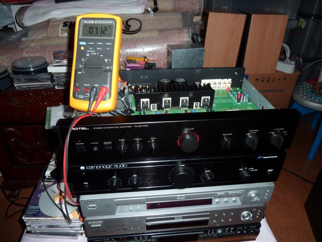

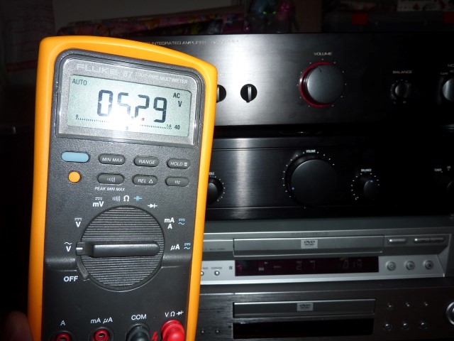

Did you set the level with a dynamic track to the max volume you usually listen to and then measured the 220 Hz track?
If not, then your results are not comparable to the rest an you don't know how much voltage you really need.
Maybe you;ll find out that you need more then your amps can provide, or that you need much less then 5 volts.
EDIT: This came out wrong. I mean no disrespect. I really admire your test setup. I'd love to be able to test all my amps that way.
Just try that easy test and you might be surprised. 🙂
Actualy I haven't, but I did it now, for the sake of science. 😀
Half volume (12 o'clock) in Rotel RA-931, and I only got that far once, measured a little over 7v.
Volume at 11 o'clock, that's more the maximum volume for me, measured a little more than 5v.
I understand your worries, but I'll explain how I can extrapolate the results from my previous measurements, to infer the results asked here.
First we're asked to listen some usual music at high volume... that's just for us to know how far we'll turn the volume up. (I know that for experience already: 11...12 o'clock, maximum).
Then we're asked to measure a sinusoidal (I believe, or it should be) 220Hz signal, and that's just for any regular multimeter be able to measure the voltage correctly, since the regular multimeter has a limited bandwidth and go no much further than that, and the signal has to be sinusoidal, because the regular multimeter can only deal correctly with that kind of signal (if it has no True RMS converter at the input of the meter).
There's no such limitations in the audio field if you use an oscilloscope (most go at least up to 20MHz), and usually specifications in audio equipment are stated for 1KHz measurements, and that's more the frequency I use to make simple measurements in audio.
Multimeter as Fluke87 have a 20KHz bandwidth, and its True RMS.
Anyway. I understand now what you are trying to tell me, and appreciate that you bring that to my attention, because I actually hadn't done the test as they were asked. 🙄
Now it's done 😉... so 5v to 7v
