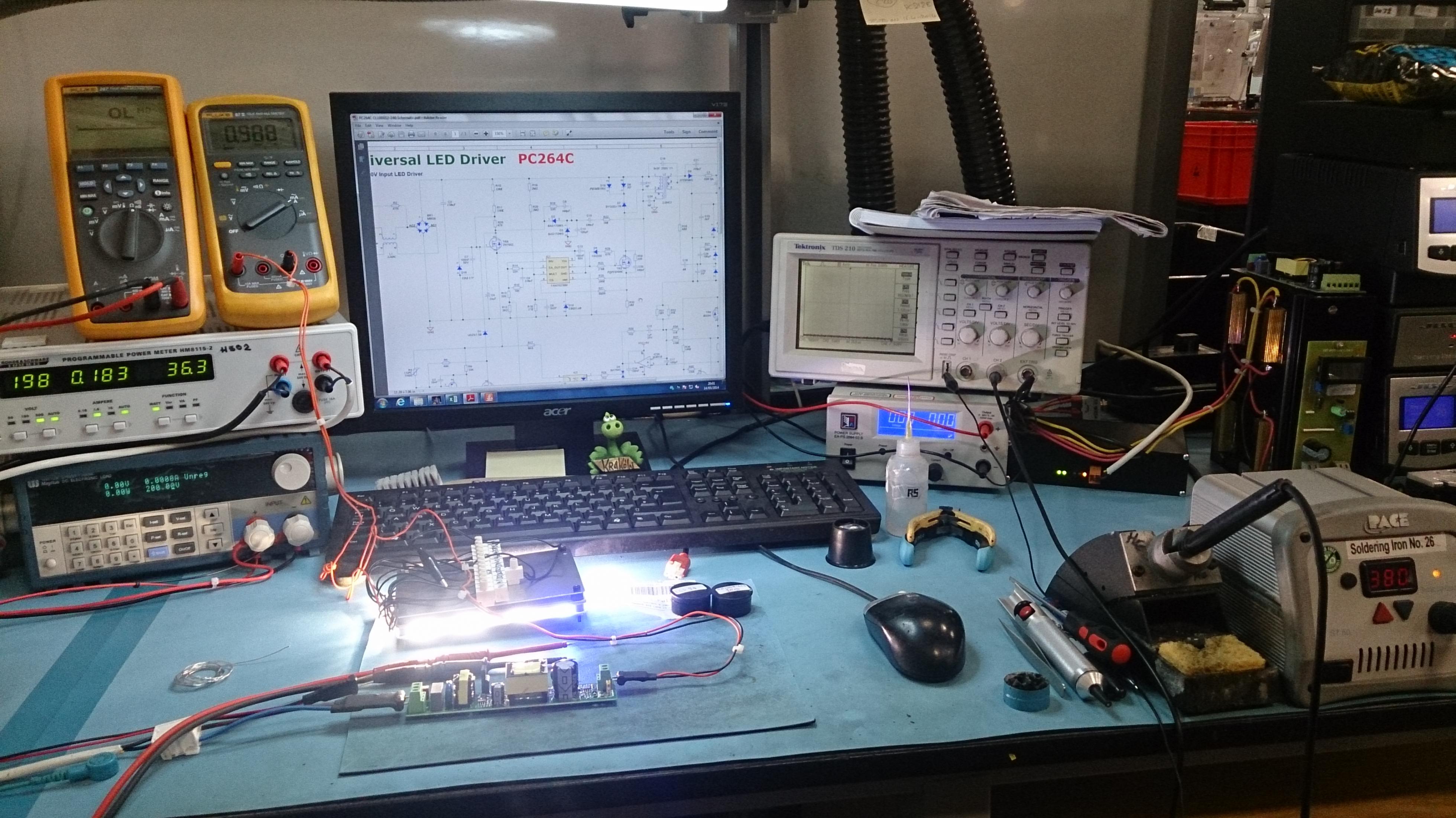

To quote myself again so I don't look too stupid.
In work if I am checking performance/efficiency I have a power meter, Electronic DC load, and a normal DC load hooked upto a DMM from this I can check or do the number crunching and know if something is within designed parameters. But they are fixed outputs.
How do you do this for a variable output? (I still class myself as learning btw, even though I have the certs and have worked in various fields for around 8 years, knowledge is power).
Below is the setup I use at work and can determine from this if output is correct.
- A Test. How much Voltage (power) do your speakers need?
