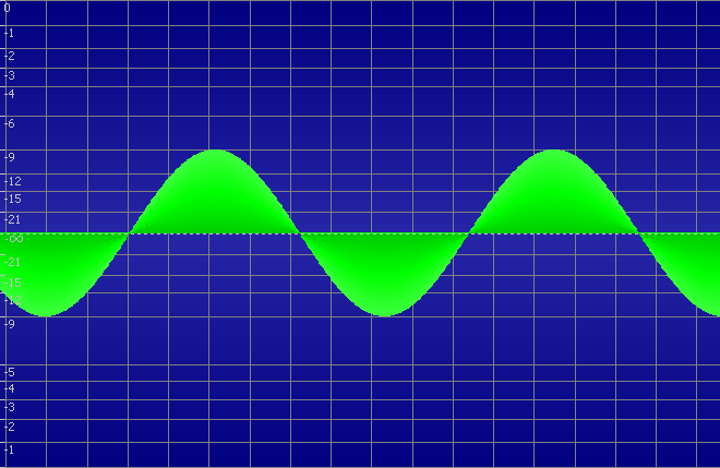

Pictures may help
Below you will see the same 120Hz sine wave at its maximum value with peaks at 0dB
And also you see it at the level supplied at the top of this thread, with peaks at -9dB
Don't forget! The sine wave's RMS value is 3dB below peak. Thus the full scale waveform has an RMS value of -3dB FS and the second one an RMS value of -12dB FS.
Got it?
Since 12dB is approximately 4X, you can take the voltage you measure from the test tone and multiply it by 4. That will be the peak voltage your amp supplies at that volume setting. The maximum RMS voltage will be 9dB higher, or 2.82 x higher.
