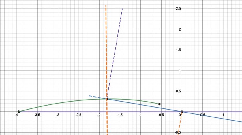

A tangential tracking pivoting tonearm #16
It is more useful to determine the stylus skating torque with respect the horizontal pivot, rather than the skating force at the headshell. It is this torque that needs to be countered by the antiskating counter torque.
I considered it interesting to derive the skating torque formula for this geometry, as it is not clear if there is any departure from the known results for other tonearm geometries. I ask for your indulgence for what follows.
A nice formula appears for this geometry, that the skating torque is proportional to the radial distance multipled by the stylus friction force. This is as far as we can go, because the stylus friction force depends on a number of variables such as:

It is clear that antiskate has to be a big compromise and the requirement will be different for each disc and cartridge. Perfect antiskating counter torque is an unattainable goal. Nevertheless I believe it is worthwhile to find a good approximation.
The attached diagrams can provide a justification for the skating torque formula mentioned above for those concerned with proof. The principles are as follows:
1. Assuming a frictionless cam guide at the tonearm rear, the force reaction is always normal to the rear path.
2. The normal reaction has a component along the tonearm determined by the acute angle beta between the normal and the tonearm. This component along the tonearm is exactly countered by the frictional drag by the stylus
3. The normal reaction has a component orthogonal to the tonearm which produces a torque about the horizontal pivot exactly counter to the stylus skating torque.
The diagrams show the geometry for the stylus at the mid-point radius. The right angled triangle mostly in the 3rd quadrant has side in the direction of the normal reaction, the normal to the tonearm, the tonearm rear. The angle at the pivot is 90 degrees, the angle between the tonearm rear and the normal is beta. The side opposite beta has the same length as the radius at the stylus. A straightforward trigonometric argument together with the principles 1-3 will lead to the conclusion. I don’t want the maths to be a distraction. I am certain there are many who will find the conclusion reasonable based on experience, geometric intuition etc.

Can you show the maths please? All you have to do is add counter torque to the fixed horizontal pivot and skating goes poof. (Zero product property).

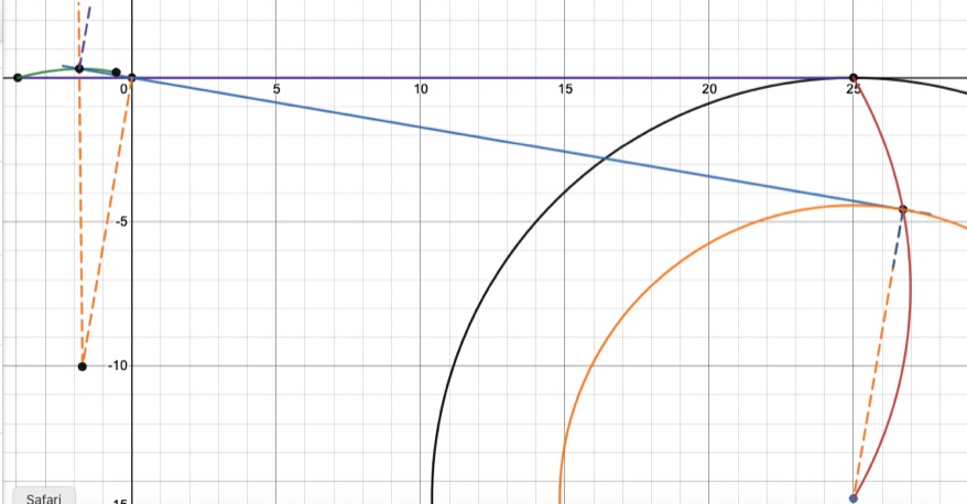

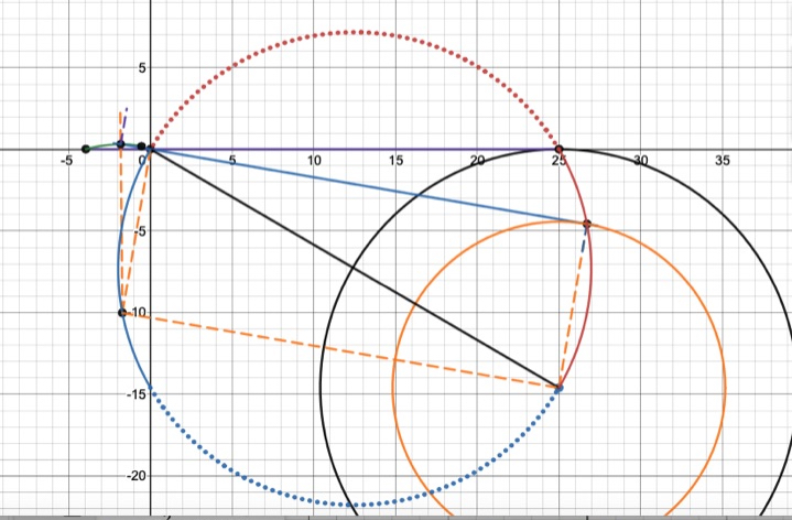

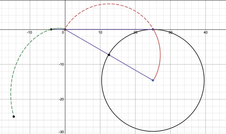

A tangential tracking pivoting tonearm #17
I have previously commented that the tonearm can be described purely geometrically, and here I am making the geometric construction explicit.
In my next post, I will explain my description of the skating torque, as requested by 2wice. The comments below refer to the attached diagram.
1. Draw LP circle radius 14.605 cm (outer groove) and mark the centre.
2. Draw a horizontal tangent from the top towards the left, sufficiently long (not crucial yet)
3. Mark off with a compass, from the circle tangent point, a distance along the tangent the chosen effective length of the tonearm at the outer groove position.(stylus to pivot)
4. Draw a line from this pivot point to the circle centre. This line is the Thales circle diameter. Its length is the total tonearm length, from stylus to rear end.
5. Bisect the line above and using the bisection as a centre and draw the (Thales) circle joining LP circle centre and the pivot point (#3).This gives the stylus path (red) for tangential tracking.
6. With a straight edge of exactly the length from #4, place one end on the LP centre (#1), the other end on the pivot point (#3). Then keeping one end on the Thales circle, move the other other end such that the straight edge continues to pass through the pivot point #3.
7. As the stylus end follows the Thales circle from LP centre to the outer groove, the rear end travels a path (green) until the tonearm position is tangential to the outer groove.
8. The tonearm operates with the rear following the path from #7. The stylus then must follow the tangential path from outer groove to LP centre.

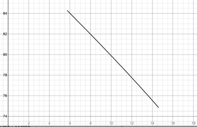

A tangential tracking pivoting tonearm #18
As requested by 2wice, here is the mathematics describing the skating torque equation for this configuration. I assume a frictionless bearings. Building friction into a model is always a crapshoot IMO. I choose to avoid, or at least postpone, bearing friction considerations until I at least understand the idealised model. The stylus/groove friction is the only external force considered and the model describes the system at an equilibrium where the stylus follows tangentially a locked circular groove on a disc rotating at a constant RPM.
Looking at the diagram 1, the dotted lines at the stylus end of the tonearm represent the frictional drag force F, tangentially to the groove, and the inward skating force S.
At the tonearm rear, for modelling purposes the rear end path can be considered as a smooth wire (frictionless) followed by a threaded bead or small hoop, attached to the tonearm. The rear path/tonearm reaction force, is orthogonal to the path for zero friction. This orthogonal reaction N (orange) has a component along the tone arm (blue), and a component orthogonal to the tonearm (mauve).

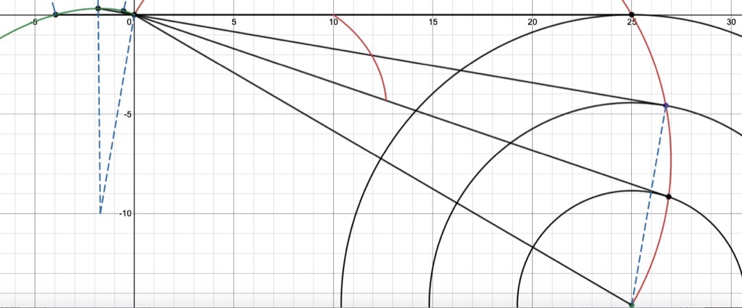

At an equilibrium, the forces along the tonearm must balance out. Similarly the torques about the horizontal pivot must balance. Call the angle between the normal force reaction and the tone arm, beta. Then the component along the tone arm (blue) must equal and oppose the frictional drag force F.
N cos(beta) = F
The component orthogonal to the tonearm is
N sin(beta) = F sin(beta)/cos(beta) = F tan(beta).
This force component orthogonal to the tonearm, produces a torque of magnitude
T = F tan(beta)(rho)
where rho is the distance from the tonearm end to the pivot.
At equilibrium, this torque is countered by the skating torque S, at the stylus. Hence
S= T= F tan(beta)(rho). Since F depends on many unknown parameters, all we can say is
S/F = (rho) tan(beta).
Now it gets interesting! (but only if you like mathematics). The stylus path coordinates, can be expressed in terms of a parameter, the radial distance r from the disc centre. Likewise for the end path coordinates. Also the end path distance from the pivot (rho) can be expressed in terms of r. This will determine beta and hence tan(beta) in terms of r, the stylus radial distance from the LP centre. After all the dust has settled it turns out that
S/F = (rho) tan(beta) = r
This can be verified geometrically in Diagram 2, by observing the right angled triangle in the 2nd and 3rd quadrants with vertices the origin, the tonearm rear, the intersection of the straight lines in the 3rd quadrant, has beta for one interior angle with adjacent side rho and opposite side r, hence tan(beta) = r/rho or (rho) tan(beta) = r, as claimed.

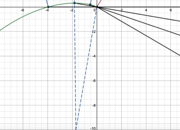

Also Diagram 3 shows the variation in the angle beta between the outer and inner grooves. It indicates that the rear reaction force is primarily orthogonal to the tonearm, the skating force. The reaction component opposing the friction drag is minor by comparison.

A tangential tracking pivoting tonearm #19
My post #17 described the geometric viewpoint of the proposed tangentially tracking tonearm and #18 gave a mathematical justification for the result describing the skating torque.
After some reflection, I discovered that the rear reaction calculation too is part of the Thales circle ecology and the geometric viewpoint even determines the normal vector at the tonearm rear path. This is not too surprising, since the rear path is determined by the Thales stylus path. It is pleasing how it all falls into place. Ahh, the beauty of mathematics. The rear reaction vector is determined by the lower Thales semicircle.

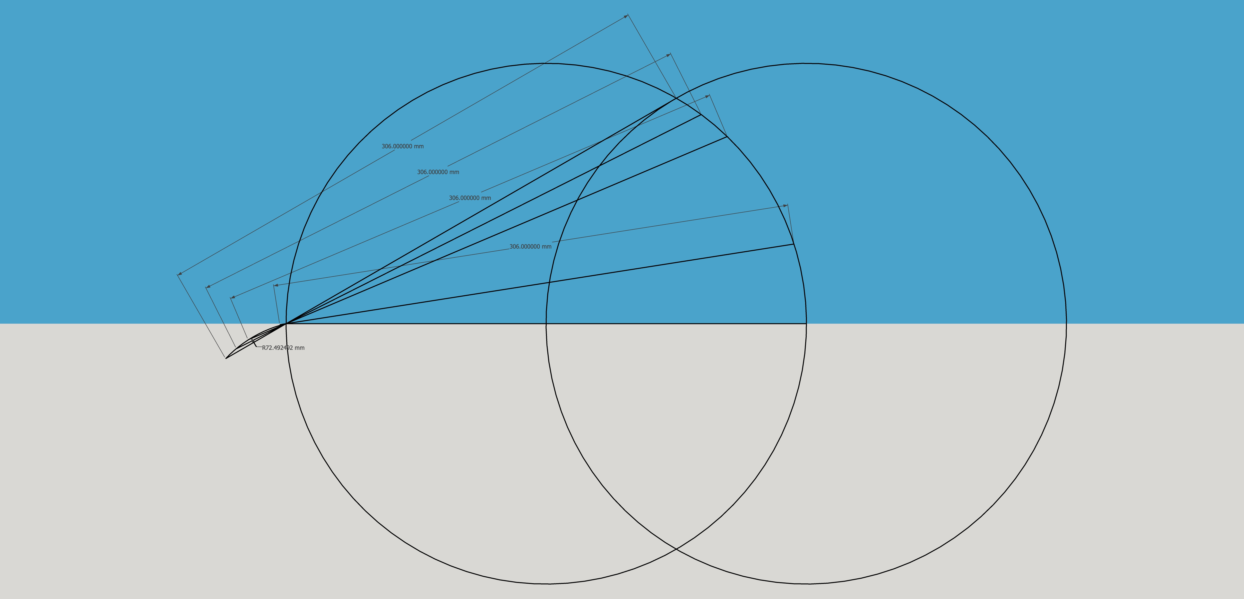

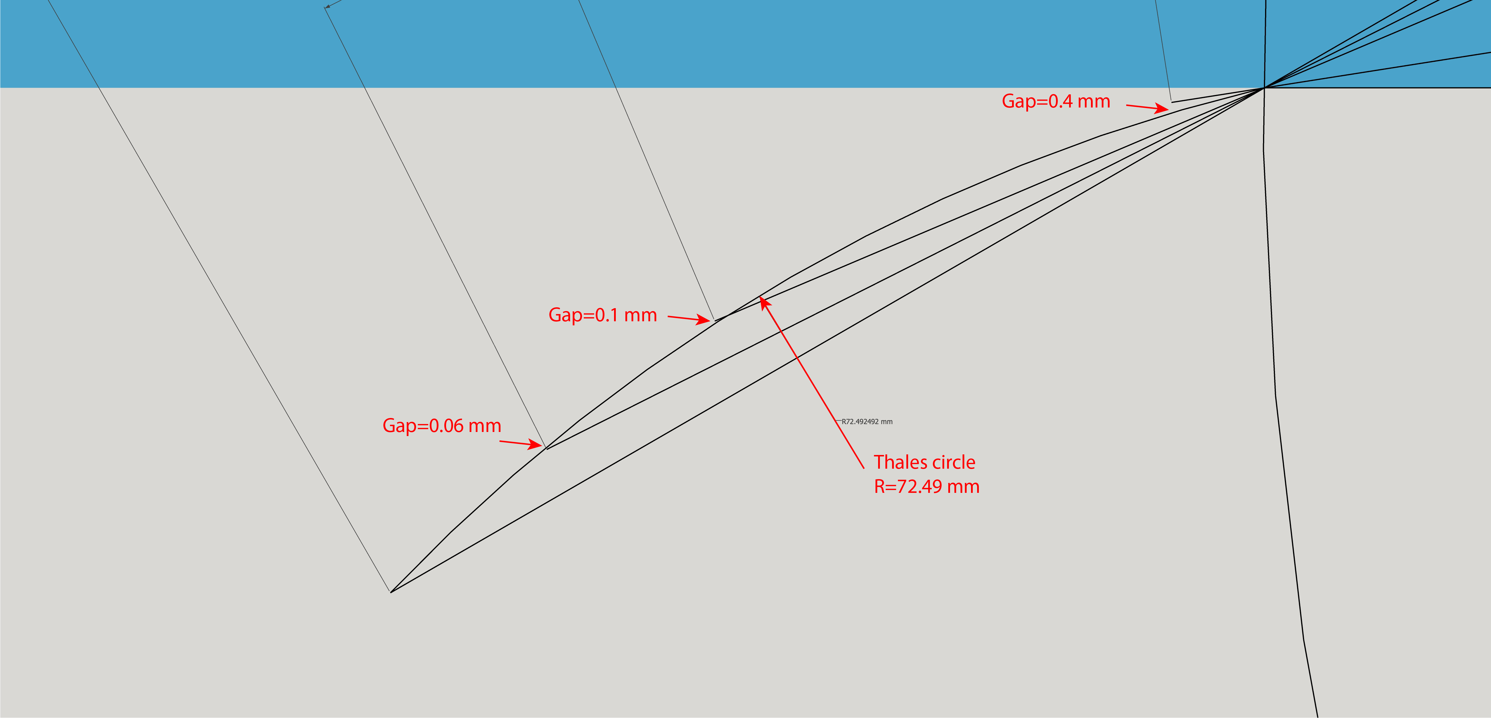

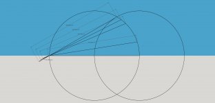

I was really inspired by your work and decided to do some further investigation. I did a diagram based on yours. It was done in Sketchup. I found that your following statement may need slightly modified.
You may see from the diagram. There are some gaps from the path of the Thales circle. But in reality, the gaps may be neglectable since these tiny gaps may convert very small tracking errors.
Please correct me if my methodology is incorrect.
Jim
