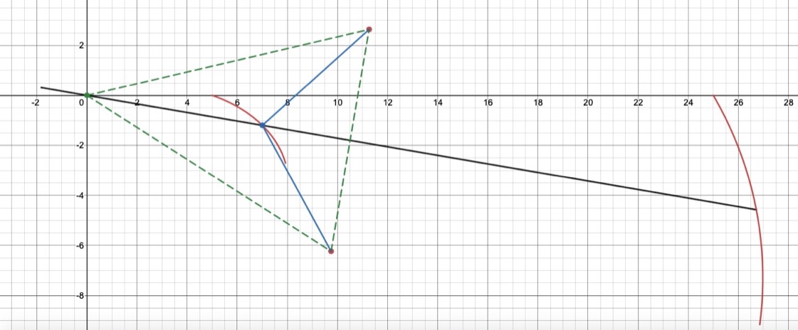

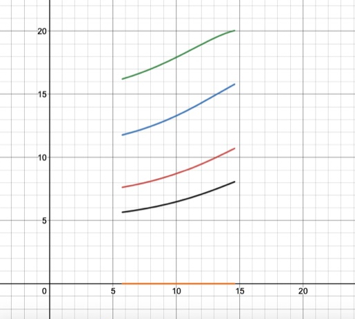

A tangential tracking pivoting tonearm #14
I did some simulations of the variation of the moment (torque about the horizontal pivot) of the magnetic antiskate force for various strut angles.
The strut is located 20 cm from the stylus end and is 10 cm in length (the first diagram is not to scale with these values).
The angles with the tonearm rear direction are 2π/3, 3π/4, 5π/6, 7π/8, π radians or 120, 135, 150, 157.5, 180 degrees.
The last case has the magnets coinciding on the tonearm tube, as a test of the mathematical model. On two grounds this should provide zero antiskating torque which it does. The two superimposed anti-phase magnets should have cancelling magnetic fields as well as the magnets are in line with the tonearm horizontal pivot, hence produce zero moment. The downwards vertical order of plots on the diagram follows the increasing values of the strut angle.
The plots show that the antiskate decreases in magnitude as the strut angle with the tonearm rear increases. That is, with increased distance between the antiskate magnets and the fixed magnet at the pivot. Unfortunately if the angle of the strut decreases below aproximately 2π/3, the antiskate force across the disc groove is not monotonic, and so will not be able to follow the stylus skating moment profile with any accuracy. Hints of the turning point are beginning to appear in the 120 plot.
These are preliminary investigations, to investigate whether the trends are realistic for providing a reasonable degree of frictionless antiskate. There remains a whole lot of optimisation to find a combination of parameters that provide a more linear antiskate profile that matches closely the stylus skating force.

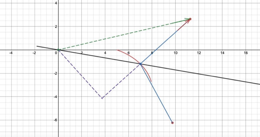

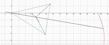

A tangential tracking pivoting tonearm #15
The diagram below shows how the magnetic antiskate is supposed to work.
The two magnetic dipoles (bar magnets) are fixed to the struts in anti-phase.
The bar magnet at the origin is free to rotate aligned with the tonearm but fixed in lateral position.
It would be fixed to the lower non-sliding bearing component that allows horizontal rotation. (In a conventional tonearm it would be attached to the bearing yoke)
Shown is the effect of the outer magnet. The repulsive force has a component (red arrow) along the strut direction.
The moment (counterclockwise torque) about the bearing pivot is determined by the perpendicular distance to the origin.
At the strut connection with the tonearm, there will be a force component in the direction of the tonearm in the elongation direction.
Now the other magnet will have the mirror image vector diagram. The composite counterclockwise torque will double and the force components along the tonearm direction will cancel.
