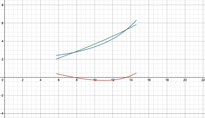

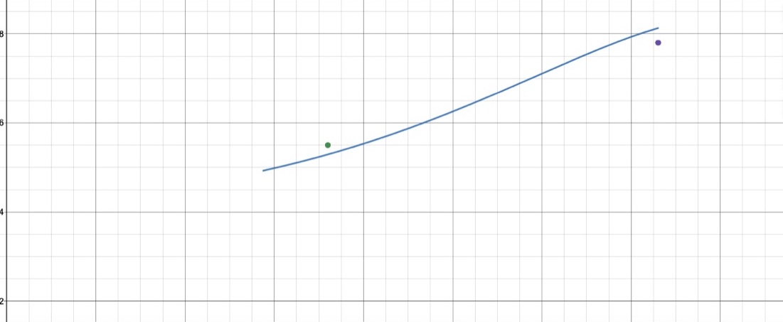

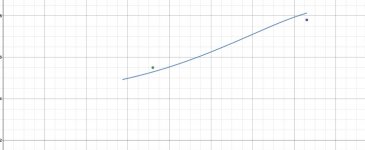

I have modelled the magnetic field produced at the anti skate magnets due to the interaction with the magnet fixed at the tonearm pivot but rotating in alignment with the tonearm.
The force variation with distance along the axis of a bar magnet follows a fourth power law. The distance is shown by the dotted green lines in Diagram 1. This distance increases as the tonearm follows the tangential path from outer to inner groove. Each anti skate magnet attached to the orthogonal strut, is subject to a force directed in line with the pivot but reversed because the magnet polarities are reversed on the strut. The magnitude of the forces are identical and the resultant force vector is orthogonal to the tonearm in the outward direction. The absolute magnitude of this antiskating force depends on the strength of the magnets, and location determined by the position along the tonearm and distance from the tonearm. It is the profile of the antiskating force that is important. The absolute magnitude can be varied by using different strength magnets or a different number of identical magnets.
The calculations show that the magnetic antiskating force for this tonearm decreases monotonically from the outer to the inner groove. Given that the model of the stylus skating force similarly decrease towards the centre but then increases slightly towards the inner groove, the magnetic anti skate cannot be accurate very close to the inner groove. For this reason, I have adjusted the available parameters to closely match the skating-anti skating forces between the outer groove and where the skating force has a minimum. The 2 parameters locating the anti-skate magnets are adjusted to best fit the skate-anti skate profiles at the ends of the interval. For this tonearm length, a good fit occurs for the antiskate magnets positioned 1 cm from the pivot and 9 cm orthogonally from the tonearm. This is shown in Diagram 2. I am very pleased with the fit, especially since most LPs recorded grooves stop well short of the inner groove.
There is another parameter that is adjustable. The tonearm original effective length of 25 cm is chosen rather arbitrarily, but mainly to compare with a similar length standard pivoted tonearm. There are arguments both for and against a shorter original effective length. It will also be capable of tangential tracking and slightly more compact. It turns out that shorter arms require a longer extension. It can be seen from the earlier posts that a 15 cm arm needs approximately 6 cm extension compared to the approximately 4 cm of the 25 cm tonearm. This puts the rear further from the pivot at the outer groove and has implications for the effective horizontal inertia. I have not crunched the numbers yet to see if there is a sweet spot for tonearm length.

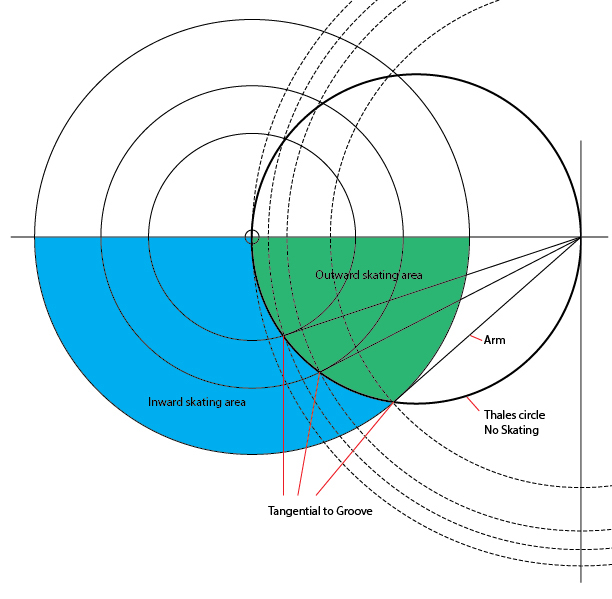

First I don’t see why I can’t move the mounting position.
Because that would create a new Thales circle with it's own tangency point. It makes no sense comparing tangency from two Thales circles.
I changed effective length not the mounting position. The results were exactly the same. Both of the arms in my tests and in Wally Tool’s had off-set angles. Both my arm and Wally Tool’s arm didn’t skate exactly on the Thales circle. But the line through the cartridge doesn’t intersect the pivot and it will fail the string test, too, since the arms had off set angles.
When you changed the effective length, you created a new vector with a new tangency point and the arm will skate to that point.
Let’s imagine an arm which is based on Birch geometry and its effective length does change. The path of the stylus is exactly the same as the Thales circle. The arm won’t skate although it doesn’t meet Conrad’s condition and fails the string test.
If there is a fixed horizontal pivot at A of a Thales circle, then sure it won't skate, but that meets Conrad's condition because the pivot lies at the origin of the effective length vector. That is not the case with the arm geometry presented here.
1, The mounting position has to be moved to create underhang. As long as overhang exists, the arm that meets Conrad’s condition or pass string test will skate inward or outward. It doesn’t matter.
2, It doesn’t matter how many Thales circles were created. An arm doesn’t skate. This arm doesn’t meet Conrad’s condition and doesn’t pass string test. This is all I care for now.
Yes. But how about same arm moves to other areas? The arm will skate for sure. Please see attached diagram again. This is obviously another proof that both Conrad’s condition and the string test can be used for judging wether or not an arm skates.
Although I am following your thinking now, my original post was not what you were talking about. However it doesn’t matter either. In any cases, Conrad’s condition and the string test can be used for judging wether or not an arm skates.

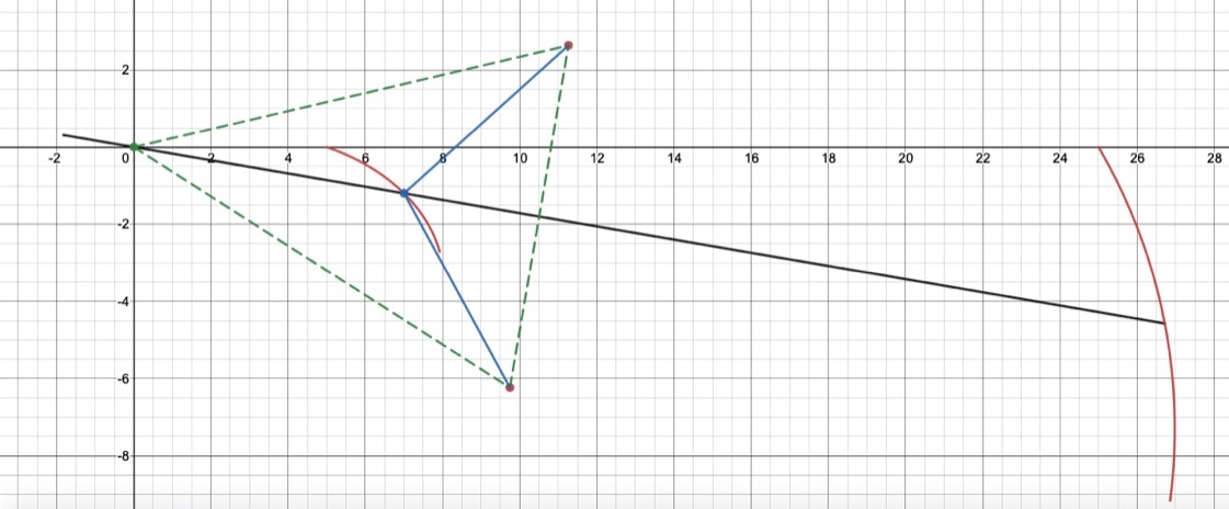

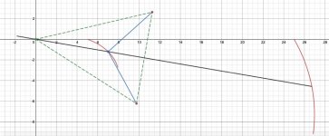

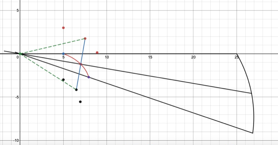

The anti-skating magnet struts do not need to be orthogonal to the tonearm, provided they are symmetrical. Then the resultant force vector will be orthogonal to the tonearm.
The magnet strut angle provides an extra geometric parameter that can be adjusted to closer match the magnetic antiskate force to the skating sidethrust.
Diagram 1 illustrates the geometry. In a numerical example, Diagram 2 shows a matched profile between sideforce (green) and anti-skating force (blue) and the error (red). The parameters are chosen to be initial effective length 25 cm, strut location on tonearm 20 cm from stylus, strut length 10 cm, strut angle to the tonearm rear 128.7 degrees. This selection is not claimed to be optimal, just one possibility. In practice the situation remains unclear. There is a trade off between keeping the magnet position close to the pivot to maximise the magnetic force, or maximising the distance of the orthogonal force vector from the pivot to maximise the torque leverage length.
To match the skating force requires sufficient magnetic strength, which raises the question of is the magnet strength achievable, and will it interfere with the internal workings of the cartridge?

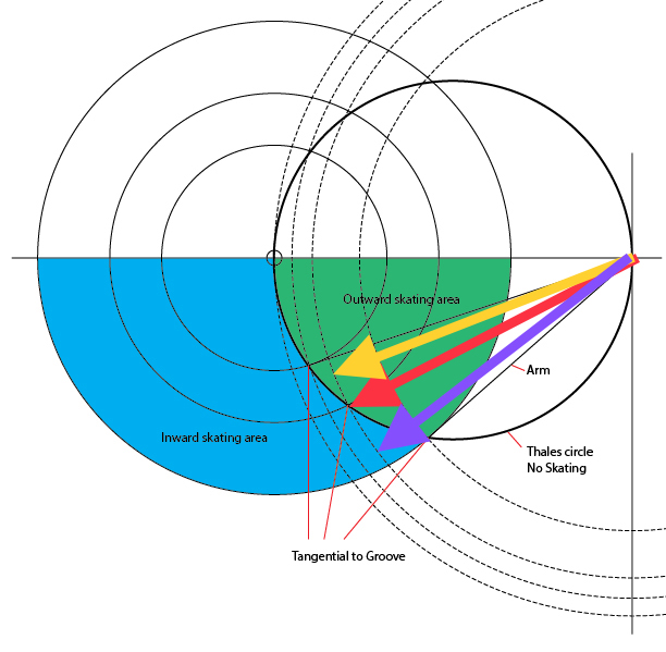

Here is a digram.
The red arrow line represents an arm with no off set and has underhang. It means that the arm meets Conrad’s condition and passes string test. The arm is on the Thales circle. The arm doesn’t skate.
Now the same arm moves to different positions. Both yellow and purple arrow lines represent the arm at different positions. The arm will skate because the same arm is no longer on the Thales circle.
L’s assume the arm is longer than red arrow line and the tip of the arm falls into blue area. So overhang exists. The arm will skate. This is why I said all arms skate in blue area.

Bon: the magnetic field strength follows an inverse square law with distance.
You are correct for a monopole but bar magnets are dipoles and the field strength follows an inverse fourth power law with distance.
. But the skating force is approximately linear along the disc radius. How do you intend to match them?
The inverse fourth power law is for the direct magnetic attraction/repulsion. The actual body force variation with radial distance on the tonearm, is affected by the geometry and trigonometric ratios involving the relative positions of the attachment points. I am still working on the degree of linearisation possible by optimising the parameter choice.
At the moment the magnetic antiskating force is decreasing from outer to inner groove. I don't expect a perfect antiskate but at least very good and frictionless too!!
