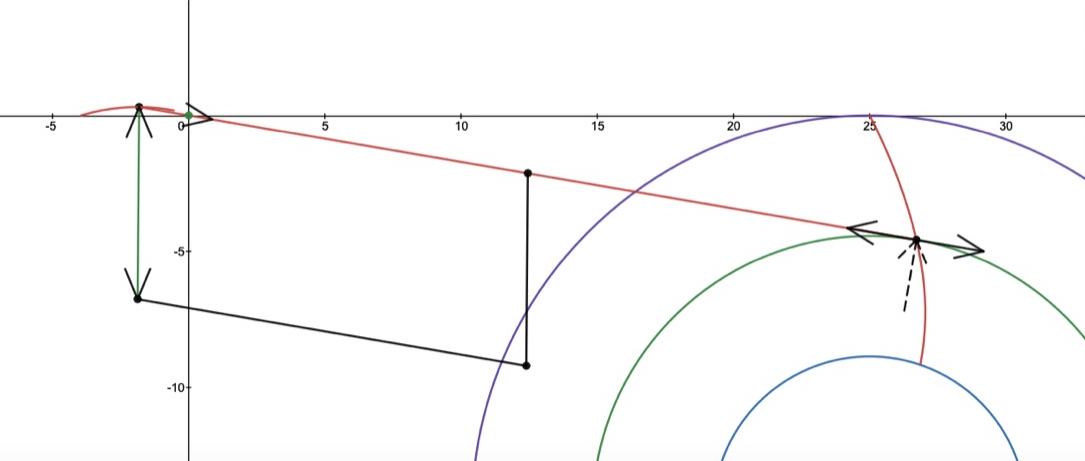

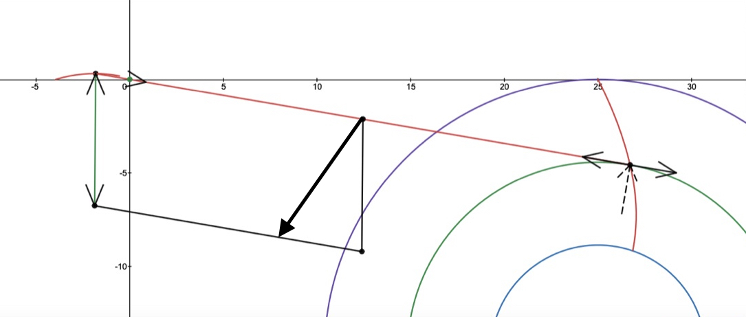

Thanks to everyone who tried to put me straight with this design. The tonearm is tangential tracking but there will be sideforce.
I made a relevant observation early on but did not follow through on the consequences.
Assume the stylus tracking tangentially in a circular locked groove.
If the stylus does not move, the linear forces and torques must balance.
Assuming frictionless bearings, resolving forces along the tonearm, the stylus frictional drag on the tonearm must be balanced by the component in the tonearm direction of the reaction at the rear pivot.
This means the rear strut must be in compression. Then the component at 90 degrees must impart a clockwise torque about the stationary frictionless pivot at the origin.
This torque can only be balanced by a counter torque at the stylus. The groove must be pushing on the stylus at 90 degrees to the cantilever. There is sidethrust.
I now see where the complexity arises in other tangential tracking pivoting designs.
Friction is not the only force at play here. If you do a force analysis of the tonearm at equilibrium, there will be a stylus frictional force in the forward tonearm direction. Assume that the sliding pivot is frictionless, for the sake of demonstration, as are the rear strut pivots. There will be a reaction force at the rear tonearm pivot, with a component directed towards the rear (the strut will be in compression).
There will also be a reaction component at right angles to the tonearm rear. This will be in opposition to the horizontal reaction force at the frictionless sliding pivot.
I should have taken more attention to my own observation

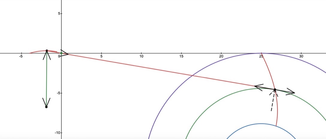

Where to now?
Not totally ready to give up yet.
The geometry does give tangential tracking and the obvious measure to counter antiskating force is to provide a counter torque. My goal is a passive solution, so I will investigate an articulated tonearm strut connecting in front of the sliding pivot. I have added the linkage to my previous diagram. For purely reasons of aesthetics and simpler analysis, the new strut is attached to the tonearm mid point, to form a parallelogram. This reduces the number of variables substantially compared to an arbitrary linkage arrangement.
Firstly I intend to model and analyse the skating force for the original configuration, to have an idea of the varying nature of the sideforce. Then I will investigate the effect of the antiskating linkage. Even with the simplifying parallelogram arrangement, there are a number of parameters that can be adjusted to see if there is any possibility of (close to) perfect antiskate or a "sweet spot". The adjustable parameters include the tonearm original effective length and the subsequent attachment point for the linkage.
My original intention was to investigate whether tangential tracking can be achieved by a passive tonearm which does not resemble a Rube Goldberg machine. It is now looking increasingly unlikely. However, I am up for the challenge to see how close I can get, even if only as a concept. The increasing number of low-friction dependent linkage points is an obvious issue.
I did own 2 Garrard Zero 100 turntables for a short time in around 1970. They were purchased new, and at the time I was very excited with my first one. I was in college at the time and had a very modest system. Why did I have 2? Well the first one had such bad rumble I thought it must be faulty. I bought a second one, which was just as bad. A fancy tonearm could not compensate for typical cheap idler drive system.

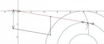

Bon,
The added arm is a good idea, but it will need to be pivoted something like the arrow added to your drawing in order to accommodate the arm movement across the record and the resulting side forces. It needs to be able to collapse forward.
One way to solve the Eff Length, Eff Mass, VTF problem would be to split two functions. Pivot a rail from the horizontal bearing that will carry the linear slider and mount the vertical bearings and the rest of the arm on the slider, either above or below. The new stub you added can be used to keep the vertical bearing housing vertical.
Unfortunately, bearings, mass and complication are added.
You and 2wice have come at PLT design from highly mathematical directions and, from a couple of his recent posts over at Angling For 90 degrees, he has developed a working design. I hope your attempt is successful, too.

Bon,

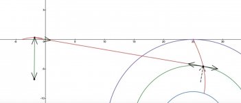

Thanks for the encouragement Doug.
I had come to all the same conclusions as you. The sidethrust cancelling strut needs to always have a forward component along the tonearm as well as the outward component for sidethrust cancelling. Aesthetics should not come into consideration until the full picture is known.
I intend to present all of my results in such a way that others can check them if they choose. First task is to model the side thrust for the uncorrected tonearm.
Then analyse the effect of an articulated strut with arbitrary lengths and location on the tonearm. A many variable optimisation may reveal appropriate set of parameters. That's the program anyway.
