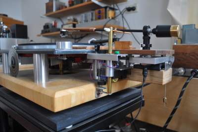

A tangential tracking pivoting tonearm #6

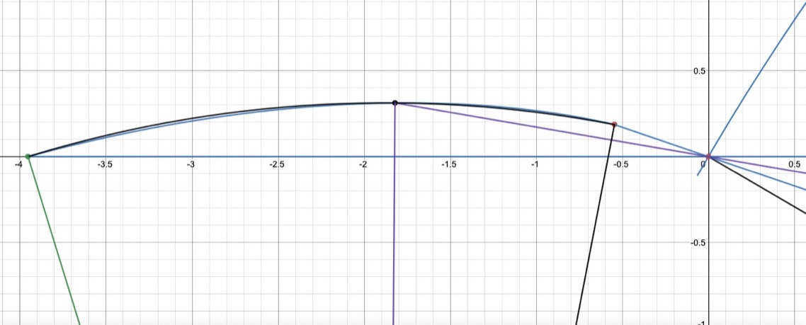

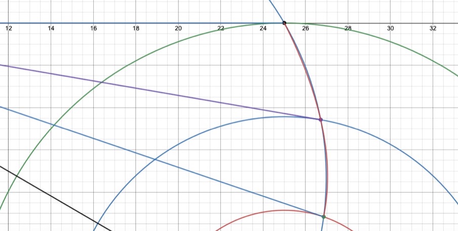

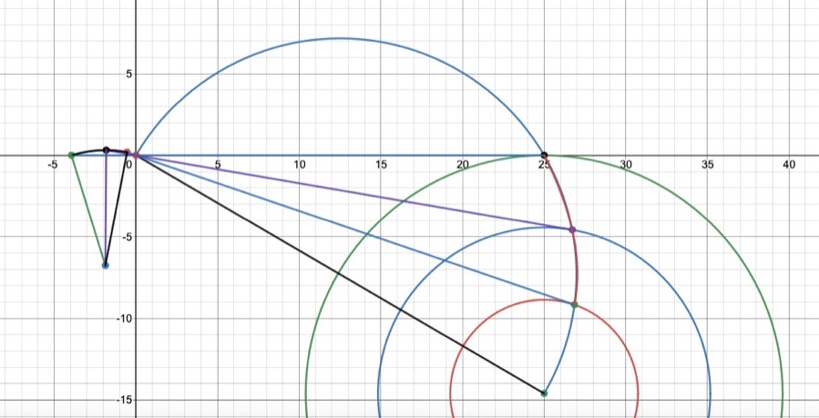

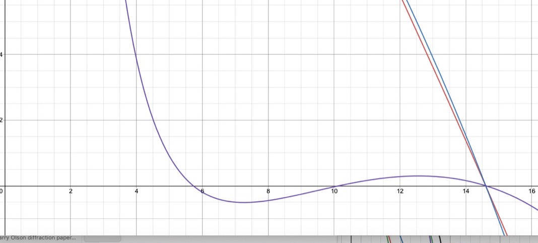

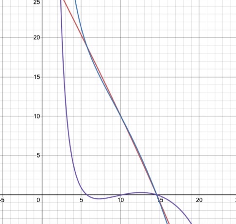

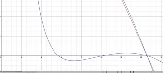

Here is the data for tonearm nominal effective length 25 cm at the outer groove. The maximum tracking error is 0.5 degrees and is less than 0.3 degrees for 70% of the grooved area. The maximum extension of the tonearm is 3.38 cm, which will mean a much smaller increase in stylus downforce with tonearm extension. I would doubt that any cartridge manufacturer has a guaranteed cantilever alignment to better than 0.3 degrees. Therefore in principle, the theoretical lateral tracking error is effectively state of the art.
As always, implementation is the key.
The tonearm will experience no side thrust and hence will require no anti skating device.

Hi Ralf. I beg to differ.
In the attached video link, the turntable is started with the tonearm on the tangential path (roller axis pointing directly at the centre spindle)
There is no sideways movement. Because of the play in the pivots it is possible to lift the tonearm and move it slightly off the tangential path. To the rear of the tangential path (opposite to the direction of rotation), the tonearm experiences an outward skating force. Placed ahead of the tangential path (the direction of rotation), the tonearm experiences an inward skating force.The tonearm moves until it re-establishes a tangential position. Of course with a stylus in a groove it would just apply side thrust to the groove.
The direction of the skating forces are easily felt through the fingers when re-positioning the tonearm in each case.
It clearly shows that the skating force can be outward, inward or zero. The tangential path is a zero side force configuration. Of course the circular rear strut only provides a very good approximation to true tangential tracking, and the side force will be zero only at the three reference radii. Elsewhere in the playing area, the side force generated is small enough to be considered negligible.

Hi Jim.
We agree exactly. I demonstrate this repeatedly in the video of post #25. The main difference with the tangential tracking sliding pivot tonearm is that the sidethrust attempts to re-establish tangency when placed in an overhang or underhand position. In a real groove where the stylus is constrained, the tonearm will get longer or shorter. Because of the very small difference between the perfect tangential path and the rear strut induced path, the difference in arm length will be negligible.
The performance with seriously off centre or eccentric discs, will be unknown until a prototype is built and teated.

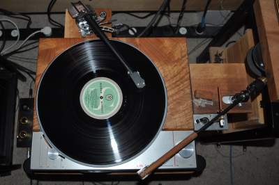

Hi diyrayk.This test will be coming up.
In the latest and future videos, I will be using the 25 cm version of the working model. It will be more typical of what I will be aiming for in a prototype.
When I ran the numbers, I maintained a higher precision, instead of rounding. The results came out spot on with the theoretical modelling.
In the video, I replaced the rubber mat with a carbon fibre/stainless steel mat that has a surface more consistent with vinyl (minus the grooves).
The roller is intentionally jammed with a blob of blu-tack. It does not rotate. The sound of it sliding is very obvious.
Contrary to recent assertions, it makes no difference to the (non) skating behaviour of the tonearm. With the tonearm in a tangential orientation, it remains fixed since the friction forces, reaction forces, tonearm are aligned. Any prototype tonearm has no freedom to deviate from (near) tangential tracking and is expected to perform identically.

Hi diyrayk.
I responded to your comments by re-doing the videos to address your concern that a rolling contact invalidates the results. I showed that the skating behaviour is the same (post #37)
Here are some observations on the arguments you presented:
Firstly a rolling frictional contact is not minimising the forward propulsive drag on the tonearm. Rolling frictional drag is precisely what allows your car to propel itself forward. The same is true for all wheeled vehicles. Without this rolling friction you are skating on ice, going nowhere. Whether the the car tyre is moving and the road stationary or the car tyre is stationary and the road is moving (like on a dyno, analogous to the roller and platter), the frictional forces are the same. There is no obfuscating of forces in my original videos.
Secondly, the self aligning behaviour is shown to be intrinsic to the tangential configuration. Slight mis-alignment of the front end will cause underhang or overhang and the resulting non-zero sideforce will move the tonearm inwards or outwards until tangency is re-established.
