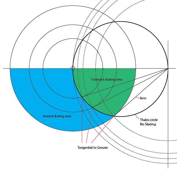

From my observation two things need to be established before no skating force occurred in a passive tonearm:
1) the stylus & cantilever obviously have to be in tangent with the radius.
2) the stylus & cantilever and pivot point have to form a straight line, hence the evidence of the "string test."
When these two things are established, no skating force exist, given a perfectly centric record or a blank groove disc. Any geometry deviate from those two conditions, skating force will emerge, including overhang & underhang and offset headshell angle. Just because a conventional tonearm with offset headshell achieves tangency at two points, it can still skate at those two points because the pivot point is not in line with the cantilever. That's my understanding of it.

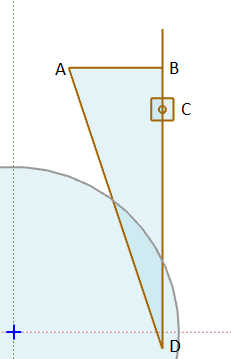

Perhaps lets clear up some terms.
A = Horizontal Pivot
B = Pivot, another horizontal?
C = Linear Bearing (Currently 3DOF, linear, rotation & vertical pivot)
D = Stylus tip
AD is your effective length and this will determine your tangency.
Because AB cannot rotate around A (currently), BD is what is determining the tangency in the video because of the extra effective horizontal pivot at B. I'm going to assume this is not the intended purpose if C is strict 3DOF and AB is allowed to rotate.
AD is longer than A-->spindle, so there is no zero skate condition anywhere for the arm in this form.
Please clarify if my assumptions are incorrect.

Hi 2wice.
Hi. I am sorry my description is unclear.

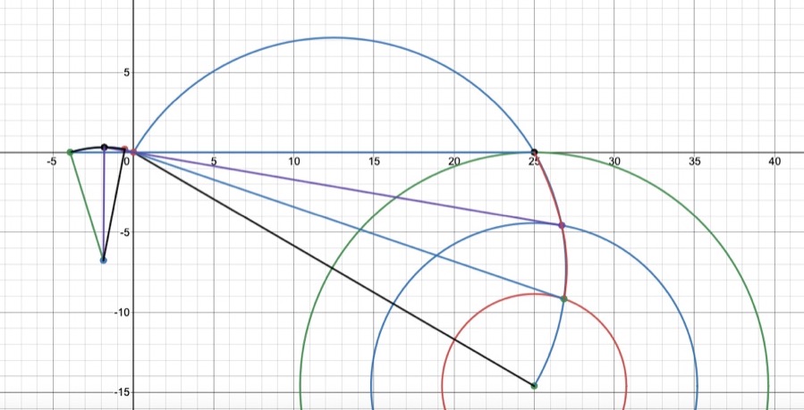

I will use the diagrams in my post #21.
Diagram 1, in the 4th quadrant is the fixed location of a horizontal bearing.
A strut with a determined length is connected here with a frictionless bearing.
The other end of the strut is connected to the rear end of the tonearm by another frictionless horizontal bearing fixed to the tonearm rear.
With the stylus in the outer groove, the strut (green) joins the tonearm (blue) on the horizontal axis at a point left of the origin.

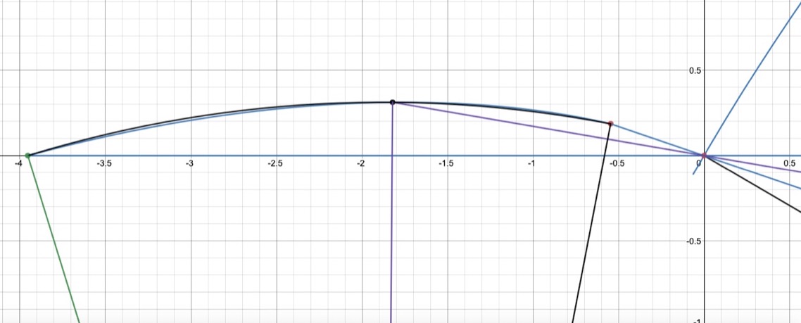

Fixed at the origin is the sliding, vertical and horizontal bearing. The tonearm will pass through this point under all positions.
Starting at the outer groove, the stylus at (25,0) will follow the tangential path as it is pulled by stylus-groove friction with disc rotation.
The tonearm sliding through the bearing at the origin, has a rear path lying in the 3rd quadrant.
The three (green, purple, black) radial lines in the 4th quadrant indicate the position of the rear strut with the stylus in the outer groove, central groove, inner groove.
In each position of the stylus on the tangential (red) path the tonearm passes through the vertical/horizontal bearing location at the origin. The distance from the origin to the stylus is the effective length and is constantly changing (increasing for perfectly circular, centred discs, but sometimes decreasing for non-centred discs).
Diagram 2, blows up the rear stub region and for the 3 reference radii (outer, centre, inner grooves) shows the tonearm rear horizontal pivot location and connection to the tonearm, which passes through the horizontal/vertical bearing at the origin.
Diagram 3, shows the blown up stylus end under the same configuration. The stylus is always tangential to the groove with tonearm pivot location fixed at the origin.
The tonearm effective length is increasing and tracking is always tangential.
It may help to consider rotating the rear end strut clockwise about the 4th quadrant pivot and observing how the tonearm slides through the origin.
The actual perfect tangential rear end and corresponding stylus (Thales) paths are blue and red. The circular strut approximation are respectively black and blue.
The two sets of paths are virtually indistinguishable when overlaid.

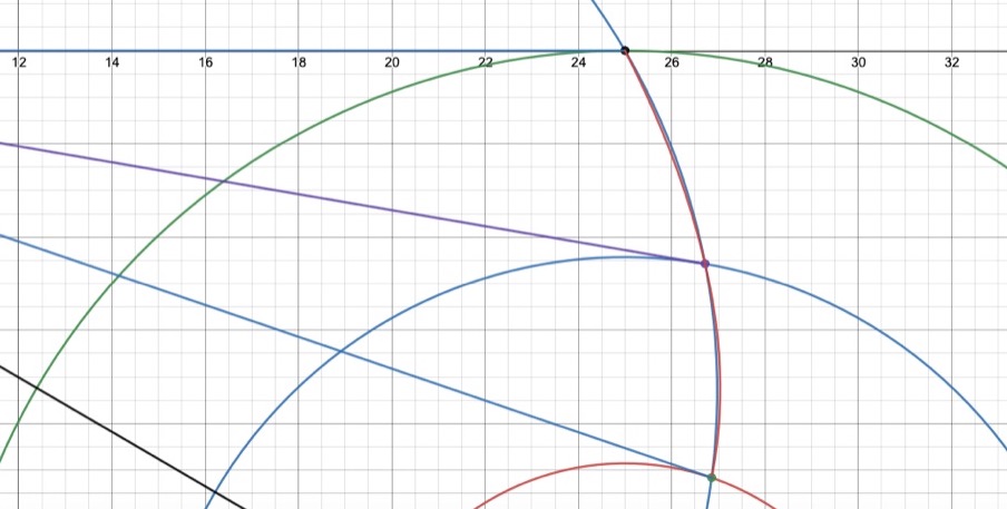

957263d1622805352-tangential-tracking-pivoting-tonearm-tonearm-6-2-jpeg
957264d1622805352-tangential-tracking-pivoting-tonearm-tonearm-6-3-jpeg
