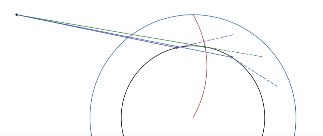

Hi lcsaszar.

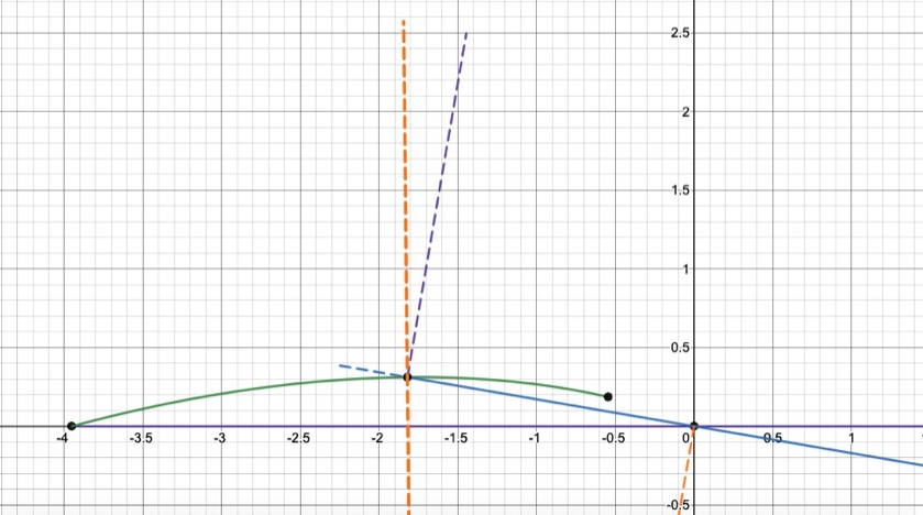

You made some good points so I spent a while investigating the grooved disc operation.
The tonearm cannot skate in the groove if all components function as intended. Of course there has to be clearance in a practical tonearm. I looked at the situation where a conical stylus rests in a locked circular groove, but is displaced an infinitesimal amount along the groove, either forward or backward of the Thales circle. Because the stylus shape is assumed conical, stylus friction coefficient will not change with horizontal rotation relative to the groove.
The friction drag is tangential to the groove and will have an outward component behind the Thales circle and an inward component in front of the Thales circle. Diagram 1 shows an exaggerated graphic with the tonearm at 3 different positions, green = tangential, blue = advanced, mauve = retarded. The angles are unrealistically large for clarity. In practice I would expect the distance between the three stylus positions to < 1 mm, possibly much less.

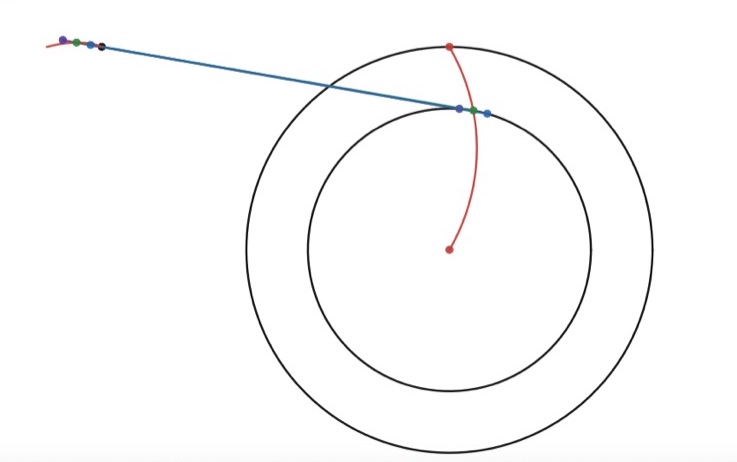

In Diagram 2, the view shows a more distant view, with the tonearm positions appearing co-linear, even with the excessive stylus displacements from tangential.

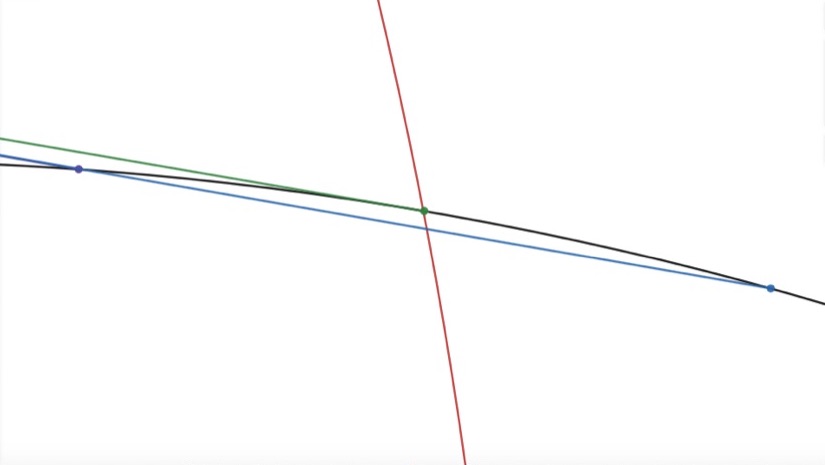

Diagram 3 shows an expanded view of the stylus end, and Diagram 4, an expanded view of the rear end.
Noteworthy is the incredibly close alignment of the rear end tonearm angle, even with the relatively massive stylus displacement from tangency. This is relevant because, with this geometry the rear reaction force vector shows minimal change due to stylus displacement. This means that the variation in the stylus drag angle to the tonearm will be the most significant change to tonearm tangential equilibrium.
The direction of the changed stylus drag force is consistent with the skating observations from the smooth acrylic disc.
It would be interesting to show a dynamic plot of the stylus position when starting from an off tangential position. On a smooth disc, the model does not show any overshoot, but I don’t have any result for the behaviour in a groove.
I am speculating that even though a tangential tracking tonearm may have non-zero sidethrust, the amount of sidethrust is very much less than that experienced by a fixed pivoted tonearm with overhang.

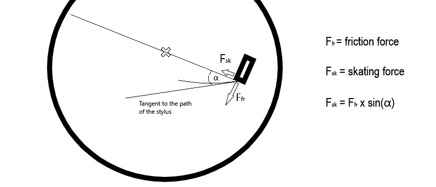

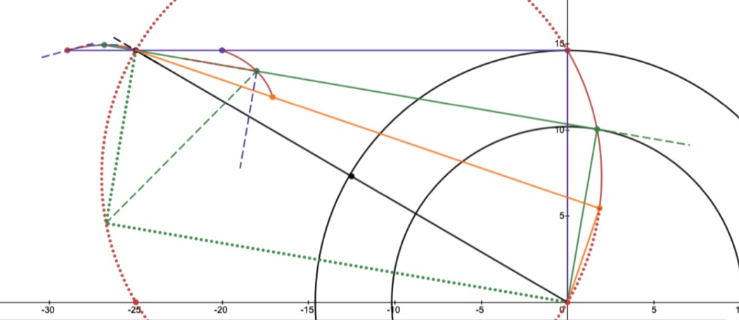

Here is a generalized equation for skating force, which is independent of the realization of the tonearm. Since the radius of the Thales circle is smaller than the effective length of a fixed pivoted tonearm, alpha is greater on every point and so is the skating force.
In the case of a linear tracking tonearm with zero overhand the cartridge is not quite tangential to the groove, or else for every turn the groove must be on top of the preceding one. But if a cartridge is truely tangential to the record groove and has no over- or under-hang, where does any vector of non-tangential force on the stylus/cartridge come from?
I will assume that by linear tracking you mean tangential tracking. I can only speak for the tonearm geometry suggested here. The stylus/groove tangential drag induces a reaction at the rear curve (cam, track, etc) which has a component orthogonal to the tonearm, that produces a skating torque.
Where does the orthogonal component of force come from? how can it be generated without a non-zero offset?The stylus/groove tangential drag induces a reaction at the rear curve (cam, track, etc) which has a component orthogonal to the tonearm, that produces a skating torque.
I discussed this in posts #147, #152, 2nd diagram.Where does the orthogonal component of force come from? how can it be generated without a non-zero offset?
Help me here - the skating force is generated by the action of the cam mechanism that adjusts the pivot position, and therefore acts from the pivot end of the tonearm?I discussed this in posts #147, #152, 2nd diagram.
From # 152 diagram 2 (see below). The stylus drag force is towards the right along the tonearm (solid blue line). The rear contact force reaction with a smooth cam (green curve) is always orthogonal to the cam (dashed orange line). This has a component along the tonearm towards the rear (dashed blue line) and a component orthogonal to the tonearm (dashed mauve line). This last component is what supplies a clockwise torque about the horizontal pivot (0,0) experienced as inward skating force at the stylus.Help me here - the skating force is generated by the action of the cam mechanism that adjusts the pivot position, and therefore acts from the pivot end of the tonearm?

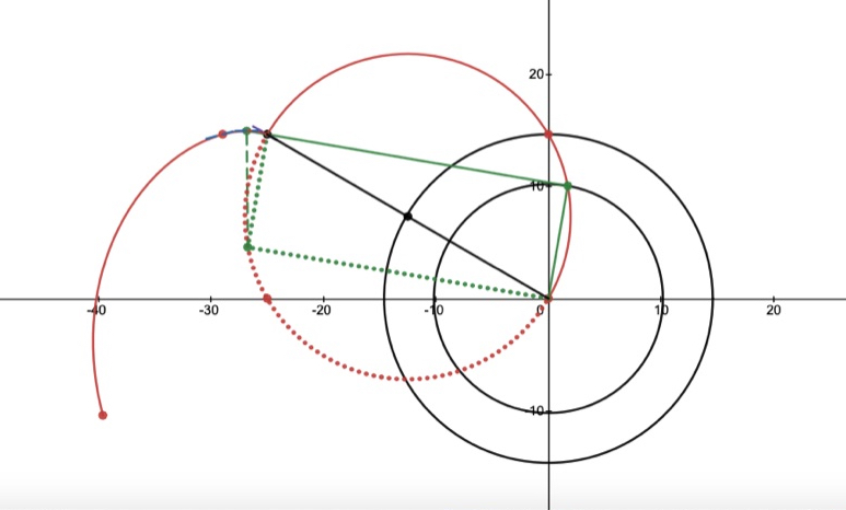

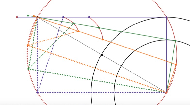

There is an interesting property of the proposed tangential tracking pivoting tonearm. In mathematics and physics, especially geometry and mechanics, there are principles that are bound together, which are called DUAL principles. Consequences that follow from applying one principle will inevitably enforce consequences from its dual principle. In geometry, the dual to the principle of TANGENCY, is ORTHOGONALITY. This is nicely illustrated when examining the tangency at the stylus end of the tonearm. There are consequences for orthogonality at the tonearm rear.
As I argued in #152, #195 , the skating force for tangential tracking is induced by a component of the rear reaction force. The tonearm rear reaction force is orthogonal to the rear path, for frictionless contact. The vector direction of this reaction is determined by the ”dual part” of the Thales circle (dotted red semicircle below).
For each stylus position on the Thales circle, the dual position diametrically opposite on the Thales circle, determines one end of the corresponding normal vector to the rear path. The other end is known on the rear path, corresponding to the stylus position.
in diagram 2, I have shown an expanded view of the tonearm rear, indicating the positions corresponding to outer groove, centre groove, spindle, the normal vector at the centre groove (green dashed), and three rear tangents at the outer, centre and spindle stylus positions.
I have shown the complete rear path for stylus on the Thales semi-circle, to emphasise that it is not a circle or ellipse.

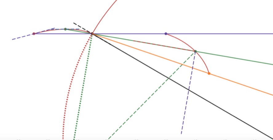

After considerations inspired from reading the other tangential tracking thread, I realised that the guide cam can be positioned in front of the horizontal sliding pivot with essentially no change to the operation. In fact, it has operational advantages.
1. The cam will occupy otherwise vacant real estate between the horizontal pivot and the platter, making for a more compact arrangement.
2. It will allow more space between the horizontal pivot and cam mechanism, to avoid physical interference.
3. It will declutter the rear of the tonearm which needs to accomodate a counterweight.
4. It allows more choice in the location of the cam along the tonearm. There may be an optimum position.
5. It will reduce the amplification effect of tolerance in the cam position at the stylus.
I have shown below, the geometric result of relocating the cam from the tonearm rear to a position 5 cm in front of the horizontal sliding pivot. That is, the cam is 20 cm from the stylus end of the 25 cm effective length tonearm. All of the essential geometric information is captured in the diagrams. I have left in place the positions for the rear positioned cam for comparison. The solid green line indicates the mid-groove tonearm position, with associated forward stylus/groove drag (dashed green), which induces an orthogonal force reaction at the cam (green dashed), which has a component along the tonearm (orange dashed) towards the rear, resisting the stylus/groove friction drag, and a component orthogonal to the tonearm (mauve dashed) creating inward skating torque. The duality principle (#196) relating the stylus tangency to the cam orthogonal reaction, is naturally preserved for all cam locations along the tonearm.
I emphasise that all of the graphics are based on exact calculation of the stylus and cam paths for tangential tracking. The accuracy is limited only by the precision of the graphical calculator software, which so far has had no problems coping.

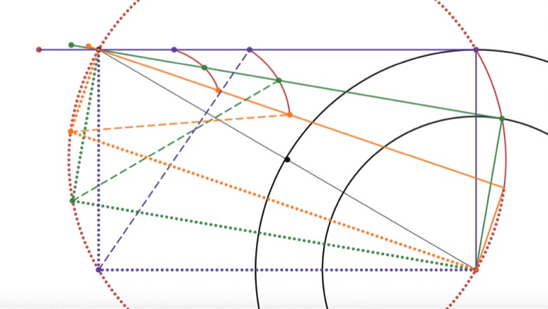

Having realised that the tangential stylus path can be enforced by a cam positioned anywhere along the tonearm, I have produced animations showing the cam path for any choice of location from the horizontal pivot right up to the stylus. Of course locations where the cam path overlaps with the platter, seem pointless, but I recall the Townsend Excalibur tonearm damping trough that extended over the LP area. The cam surface would do something similar. Not very appealing but not impossible!
Interestingly, the Thales circle is one of the cam paths (the only one that is a circle), which makes sense if the cartridge is forced to follow the Thales circle and the tonearm only provides horizontal rotation that aligns the cartridge tangentially to the groove. This could be thought of as a parallel tracker with a curved track actually on the Thales circle. I am not seriously promoting any of these scenarios but just pointing out they are not ruled out.
With regard to the question of where to position the cam along the tonearm, the geometry might indicate that the rearward tonearm reaction force component is greater the closer the cam is to the stylus, and the smaller the skating torque. I am not sure overall whether this is a good or bad thing.

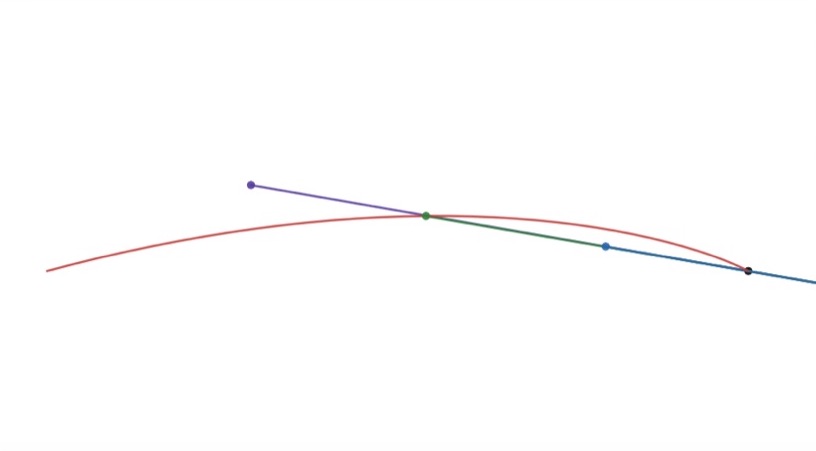

The skating force at the stylus remains the same in either case.
It might be interesting to see where this comes from. It is not obvious. The geometry helps to understand.The skating force at the stylus remains the same in either case.
In the first case, for a 25 cm tonearm with cam located 20 cm from the stylus, the paths are as shown in Diagram 1 for stylus on the Thales circle at outer, mid, inner grooves. The acute angle (beta) between the tonearm (solid line) and normal (dashed line) at the cam, is decreasing as the tonearm moves inwards. This means that the force component orthogonal to the tonearm that is responsible for skating torque, decreases towards the spindle. However the distance of the cam from the horizontal pivot, increases as the tonearm moves inwards.
The same situation arises if the cam be positioned closer to the stylus, say 15 cm distance, as in Diagram 2. The distance to the horizontal pivot is initially greater than in Diagram 1 and further increases, hence the inwards skating torque about the horizontal pivot, increases towards the inner groove. However, the angle beta is more acute the closer the cam is located to the stylus, which decreases the cam reaction skating force compared to Diagram 1 and hence skating torque.
In any event, the skating torque is independent of the cam position.
