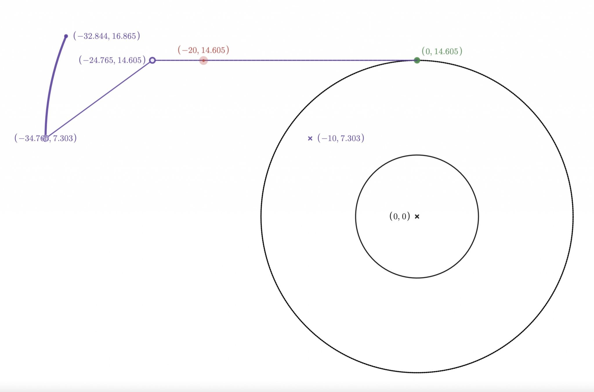

An animation showing the 25 cm tonearm motion (solid green line) with a cam at 20 cm. The dotted green line is the diameter of the Thales circle from the stylus to the dual point. The dashed green line is the normal vector at the cam.
Cam movie - YouTube
Cam movie - YouTube
My goal remains to discover whether perfect tangential tracking is achievable in the context of a passive pivoting tonearm mechanism. I have been refining the model based on geometric principles and elementary mechanics.
The itention is to allow no geometrical approximations in my modelling. The geometric accuracy will be purely determined by the precision of the numerical calculations. The inner recorded groove radius is only used in this model, as a stopping criterion for some calculations. There is no effect on the geometric alignment accuracy, and in principle the inner groove radius can be any value between zero and the standard outer groove radius. Similarly, provided it can reach to the innermost recorded groove, the physical length of the main beam will have no bearing on the geometric alignment. This can be illustrated by choosing a very short main beam as an example. This is not the case with approximate models, the accuracy usually dropping as the main beam length shortens and the inner groove radius decreases. The calculations based on this model do not appear to be more difficult than for approximate models.
Movie 1 shows the circular path for rear guide attachment and a short overall tonearm length. The rear guide circle can be a machined groove or rail followed by a rolling element which also supports a horizontal rotating bearing attached to the rear guide. A similar structure supports the main beam at the fixed location on the Thales circle. The guide and tonearm main beam are connected by a plain horizontal bearing.
The orange lines at the stylus end and rear guidance strut represent the stylus drag force vector and equal compensating anti-skating force vector (weight on a string). The geometry shows they generate equal and opposite torques about the Instantaneous Centre of Rotation (IC) of the tonearm main beam, which lies at the common intersection point on the Thales circle of the dashed lines.

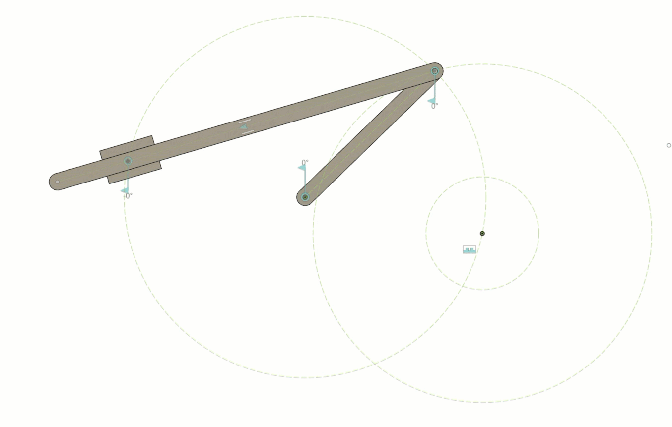

I think the arm can be implemented. Please see the gif I did base on your model. I did a small modification and moved the center of the Thales circle out of the surface of the LP. Otherwise, in my opinion, it will cause unnecessary complexity.
There are three things I dislike or have concerns about.
1. The arm wand is about 300 mm. It makes me uncomfortable. I can't give you the reasons but it is just my feeling.
2. I don't know how efficient the slider can be. If the slider is highly efficient, why do you want to make a PT arm? Isn't linear arm even better?
3. One of the pivots is just above the cartridge.
However, these are just my personal opinions. If you are committed, I think it is worth trying it out.
I think you have misread my animation. There is nothing attached to the red Thales circle apart from the fixed swivelling bearing just at the top left corner. Nothing but armtube overhangs the LP at any point. The physical components of the mechanism are shown in mauve, consisting of the circular guide track, rolling bearings, rear guide arm. I have uploaded a stripped back video below with only the Thales stylus path (red) retained.I did a small modification and moved the center of the Thales circle out of the surface of the LP. Otherwise, in my opinion, it will cause unnecessary complexity.

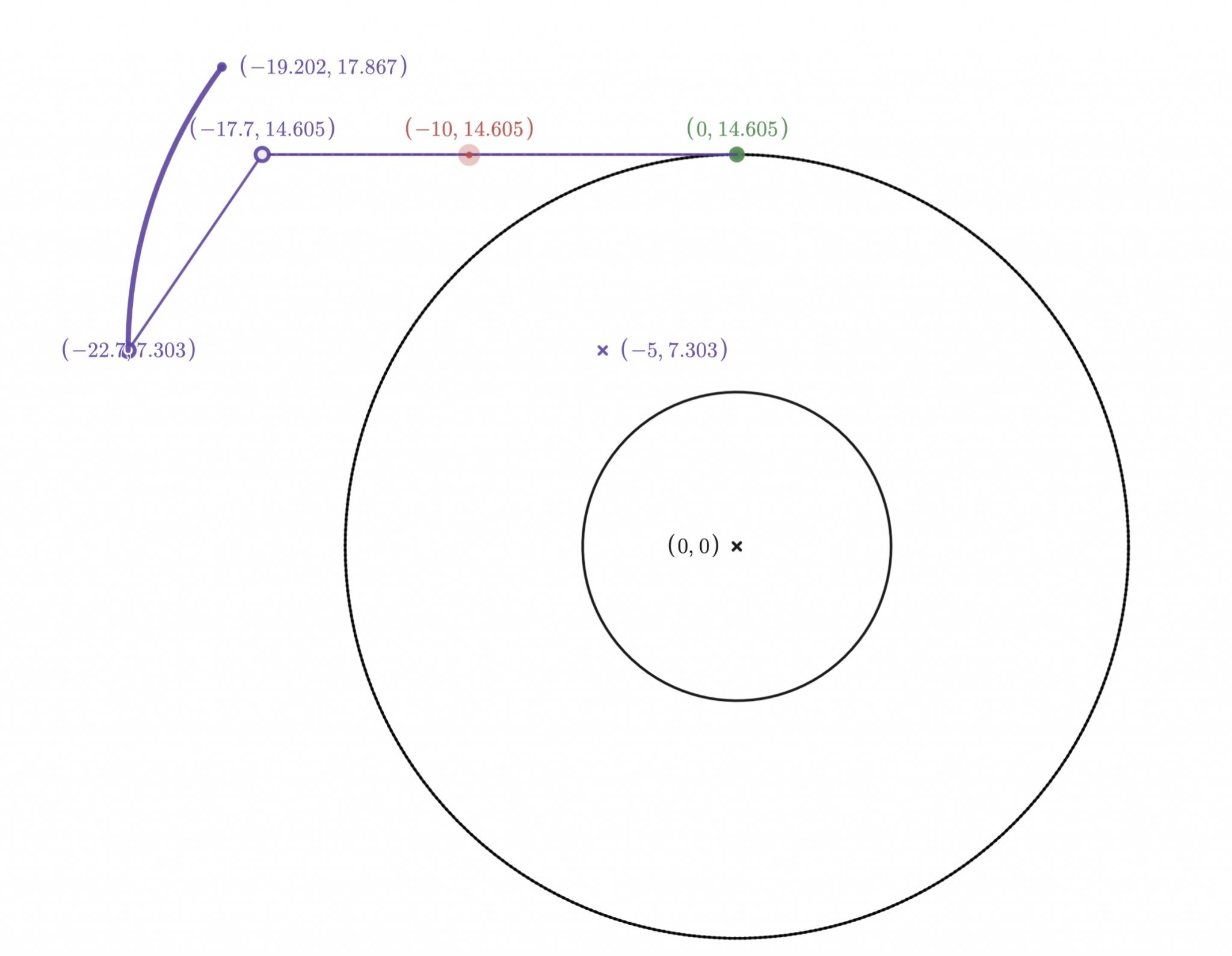

I have uploaded a version with a 50 mm shorter main beam. The main beam is 154.4mm. The guide arm is 1/2 this value. Nothing long by conventional standards.There are three things I dislike or have concerns about.
The main tonearm pivot is a rolling bearing, not sliding. Rolling friction is orders of magnitude less than sliding friction.2. I don't know how efficient the slider can be. If the slider is highly efficient, why do you want to make a PT arm? Isn't linear arm even better?
Misreading again. See my new animations.3. One of the pivots is just above the cartridge.
Yes, I am going ahead ... slowly.However, these are just my personal opinions. If you are committed, I think it is worth trying it out.
As it stands, the geometry makes the reaction forces straightforward to determine.
Same video as above with clutter removed.
Very short main beam
What you ended up with is similar to the THALES original model called the Original.
Not really. There is no pivoting headshell or ancillary tonearm beam.What you ended up with is similar to the THALES original model called the Original.

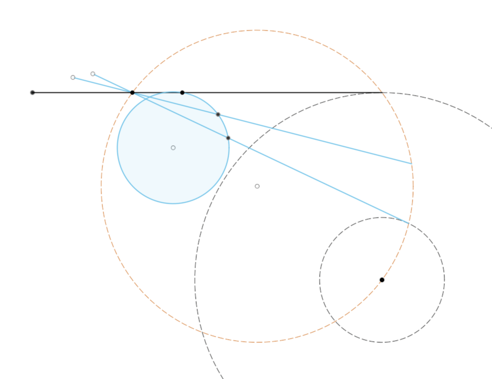

The issue is that for a stylus end that follows a Thales circle, any other point along the tonearm follows a non-circular path called a roulette. All attempts to approximate such paths by circular arcs lead to deviations from the Thales circle (non tangential positioning) at the stylus end.
A solution can be found by allowing the guide strut to follow an appropriate circular path, but it is not obvious and does require a precise description of motion of the attachment point (roulette). The guide mechanism could be attached at any point of the main beam which does not interfere with the LP, but the rear mount has an advantage regarding anti-skating considerations.

Here are my thoughts about your model(2nd one).
My concern about the slider is still valid. It doesn't matter if it is rolling or not, I haven't seen an effective mechanical horizontal bearing yet. In your model, you add a guide in the rear. If you can make a magnetic guide the same as Schroder LT's, it may work. However, it isn't easy to make for DIYers.
In fact, you may not need to make a slider. You may do something similar to THALES original model thanks to DD's comments.
In my opinion, a pivot bearing is a golden standard for all the bearings. This is why I insist to use pivot bearings for a PT arm. Other exotic bearings may not work as well as pivot bearings.
In any case, good luck with your build!

Hello Bon,My goal remains to discover whether perfect tangential tracking is achievable in the context of a passive pivoting tonearm mechanism. I have been refining the model based on geometric principles and elementary mechanics.

One way to check the tangency in a CAD simulation is to dynamically check the Pythagoras theorem for a right angle triangle in the Thales circle as the CAD program scrolls from outer groove radius to inner groove radius (or even the platter centre).Hi Ralf,
If the tangency checks out,
The triangle has vertices; platter centre, stylus, sliding pivot. This would be an independent check of my graphing software, where I would effectively only be checking the trig library functions. In any case, I get a difference in a^2+b^2-c^2 of the order 10^(-15). We can call it zero, I think.

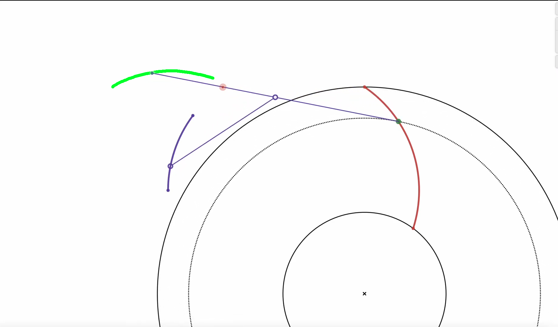

The tangential geometry alignment works when the guide strut attachment point is anywhere along the main beam, not only at the rear. The rear attachment is initially proposed to keep the horizontal bearing as far from the stylus as possible. There is then the potential for any induced bearing noise to be damped before it reaches the cartridge.
OTOH, moving the guide strut attachment to, say the main beam mid-point, results in a more compact tonearm.
Tangency at the stylus is unaffected.
The intriguing situation arises of leaving both guide arms in place. The result resembles the Birch style tonearms discussed in the other threads, but is more complex due to rolling pivots. Also a second guide adds nothing to the operation apart from increased friction and moving mass.
If a highly efficient rail guiding mechanism does exist, you may not need the additional link. Please see the green line.
