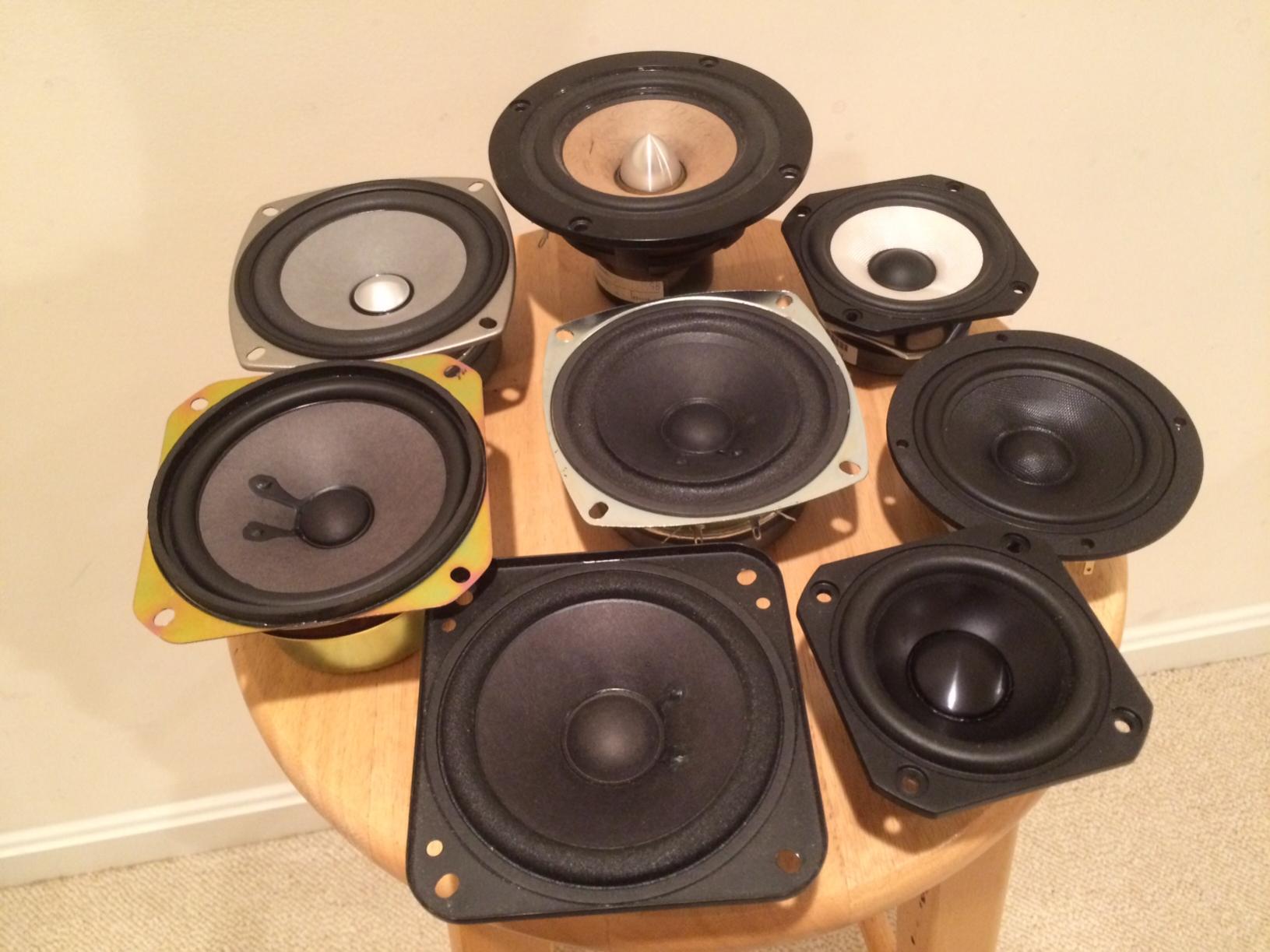

The drivers are stacking up, here is the current set of drivers with the addition of four more which arrived today from Godzilla. Thanks Godzilla! I will get them back to you once testing is completed.
The 4 that came today are:
1. Tang Band W4-1320SB (Nd magnet, paper cone, phase plug)
2. Radio Shack 40-1197 (FE103 copy)
3. NSB (no stinkin' badges)
4. 69 cent wonders
The drivers for round 2 that have arrived so far are pictured below, clockwise from top: W4-1320SB, TG9FD10-8, 10F/8424G00, Peerless 830986, 69 cent wonders, NSB, FF105WK.
472722d1426821124-subjective-blind-comparison-3in-5in-full-range-drivers-round-2-drivers-lineup-01.jpg
Not pictured but in transit: Visaton B80, Peerless black Kevlar "TG9", surprise entry.
That makes 11 total drivers for round 2... kind of a lot so we will do this in two rounds, each lasting a week. Or should we put all of them up and folks can do their own tournament at home or however they like to listen and judge for themselves?
