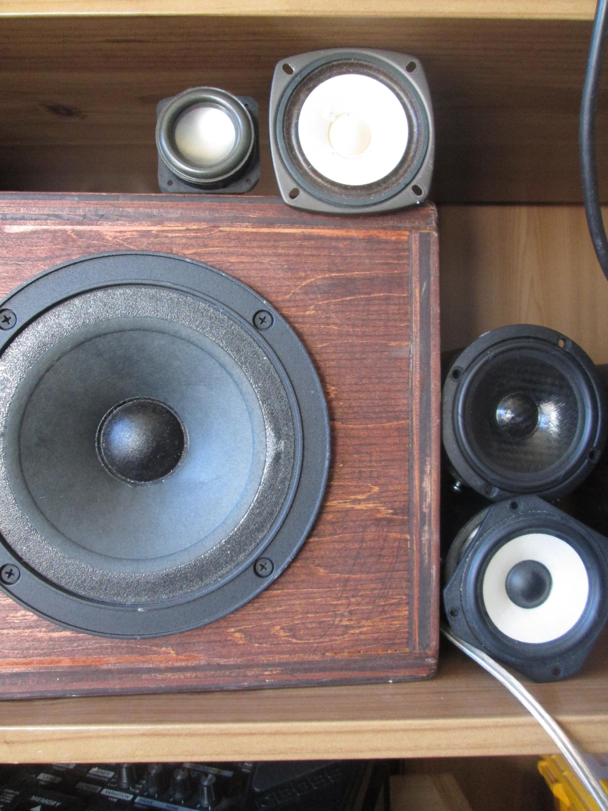

Godzilla's Un-Obtanium Drivers
For fun, I am posting the sound clips for the three drivers that Godzilla provided me that are no longer commercially available: the "No Stinkin' Badges" (NSB), the 69 Cent Wonders, and the Radio Shack 40-1197. You know that it is just these 3 drivers, but I will leave the identity of the clips "blind" so you can have some fun trying to discern the differences. I was actually quite impressed by how well some of these sounded considering one was under $1 in cost.
They will be labeled Z1, Z2, and Z3 (for GodZilla's drivers). The same 3 sound clips as before but this time the difference is that the recording was done at 96kHz and 24bits .wav file. This was then processed in Audacity to set the amplitude of the peak at -0.5dB and then rendered with 48kHz sampling mp3 at 320kbit/sec stream. Again, keep in mind that this is a stereo recording of the right channel playing in mono.
Change the .ASC extension to .MP3 in order to listen.
Have fun... 🙂
I will post the identities in a few days, let's say by 18:00GMT March 22, 2015.

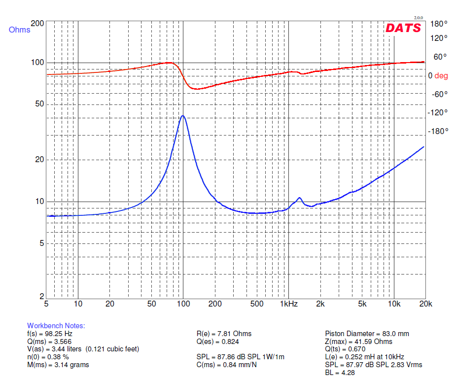

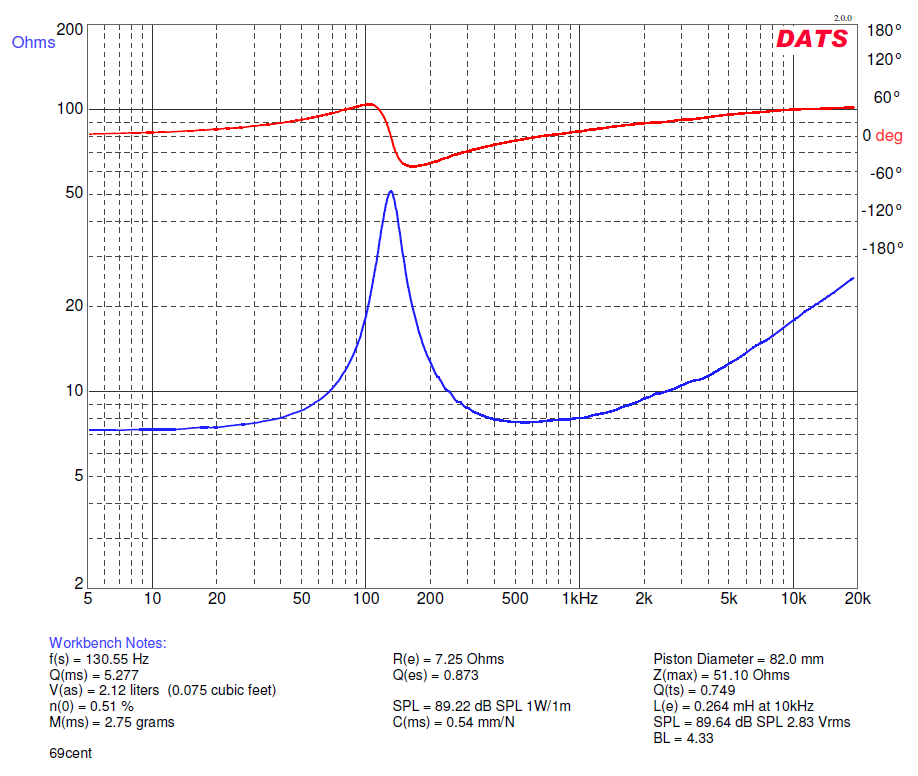

TS Params for Godxilla's Un-Obtainium
These measured nicely in DATS v2:
- Radio Shack 40-1197 (FE103 copy)
- 69 cent wonders
- NSB (no stinkin' badges)

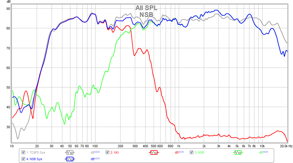

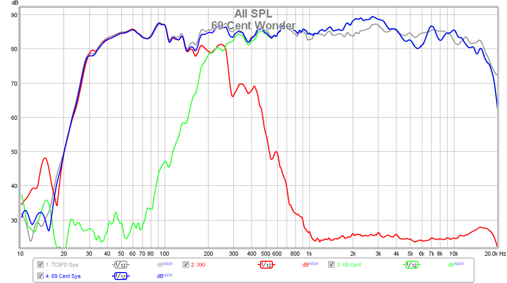

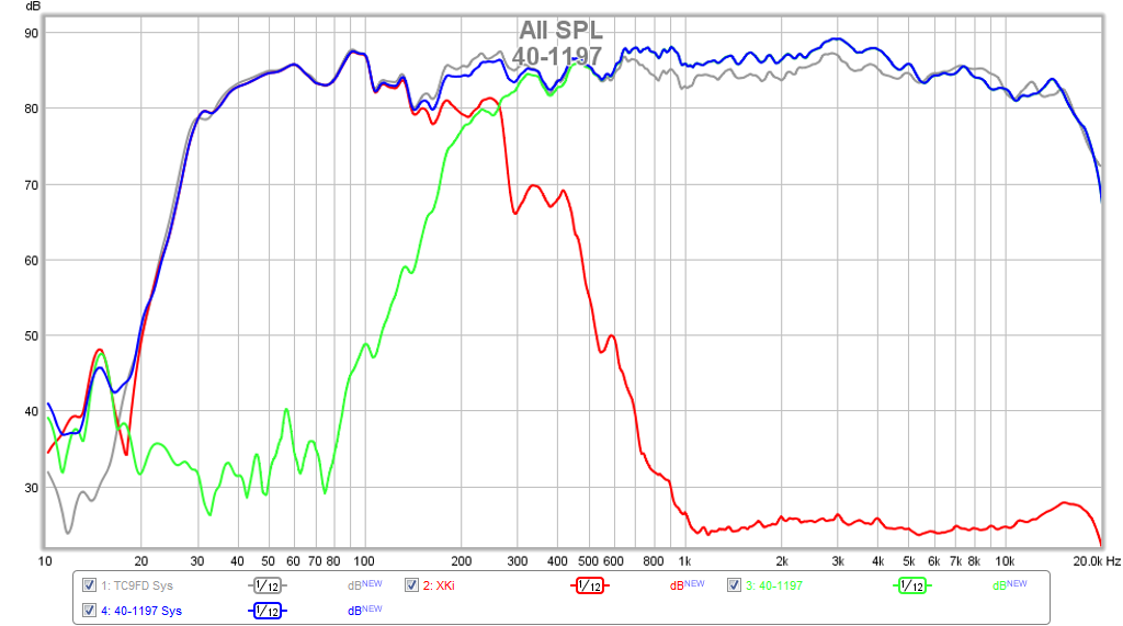

Here are the measured XO settings for the above drivers in the XKi FAST system used for the sound recordings. Note that mic is placed 0.5 m away in between driver and bass port so that effective angle to full range is about 10 deg off-axis:
40-1197 (this is quite impressive, and the bezel construction, basket shape, magnet size, inverted surround, paper cone materials , etc resemble another certain newer driver that was no where near as smooth):
69 Cent Wonder:
NSB:

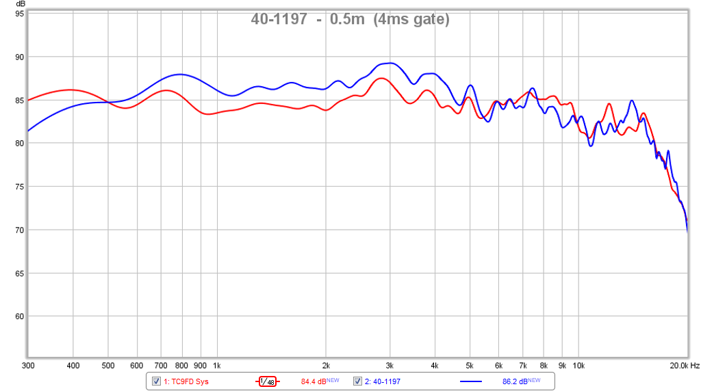

Radio Shack 40-1197 is a very nice driver
Is it true that this driver is still available for purchase? That price is pretty steep - bordering on maybe half the price of B80 or 10F territory. Certainly almost up there with FF105WK, but arguably smoother than the newer FF105WK! I have to give my hats off to Radio Shack for making, what I think, is a superior copy of an FE103. Not sure if FE103 would be free of zinger peaks that ring like crazy in the 7kHz to 10kHz range.
Response at 0.5m, gated 4ms:

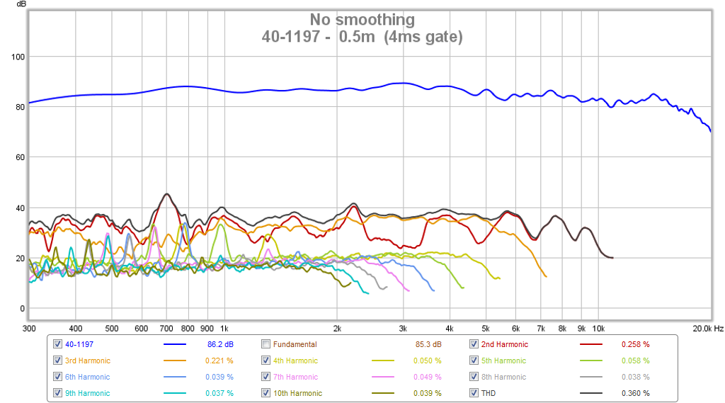

Harmonic Distortion at low drive level of 0.71 volts and 0.5m away:

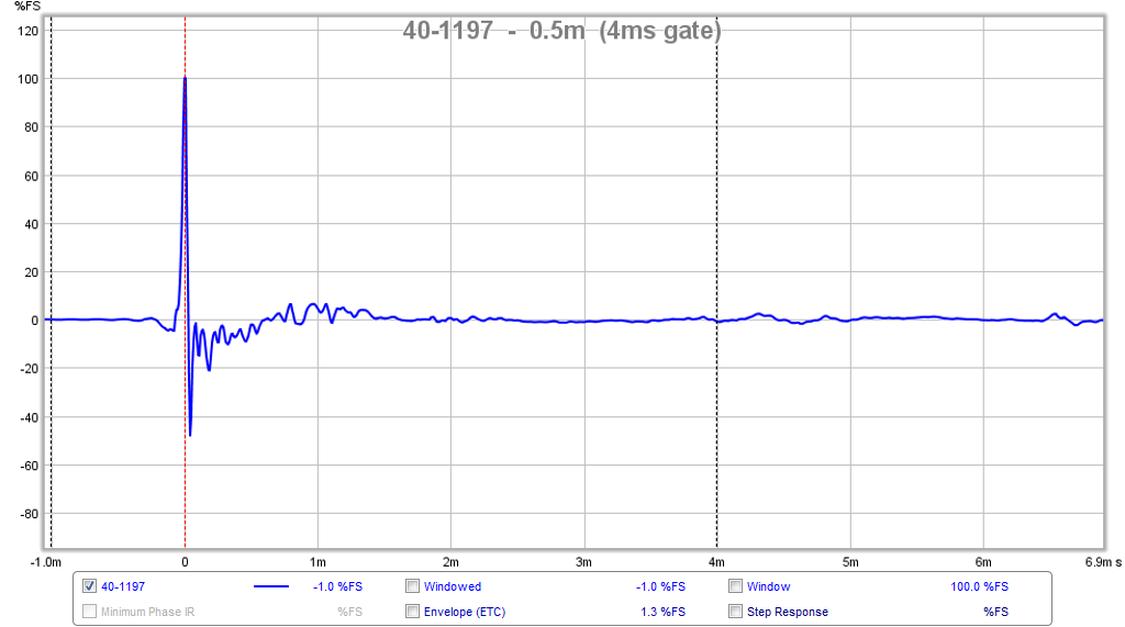

Outstanding Impulse Response:
