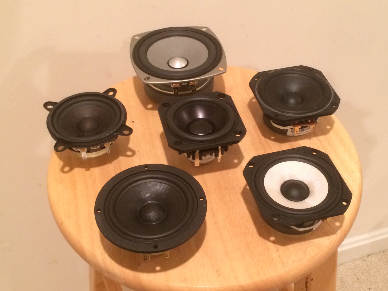

I have received word that members in India will be providing me a set of the Tymphany TYPY03W06O0111 3.5 inch Kevlar drivers for the next round of tests. There is going to be a good Tymphany 3.5 family showing here with TG9, 10F, TC9 also present.
I almost forgot, a member in Asia will be getting me these to test:

With the 10F and B80 as competition I think we are well beyond the CHR and into A7 territory. Sadly, no A7's have been offered for testing.

The number of drivers for round two is really starting to grow into an unmanageable size. Maybe have to split into 2 more rounds? The brain can't really do a multiple choice with more than 5 things at once. Maybe do just 4 per round and then have a final elimination round?

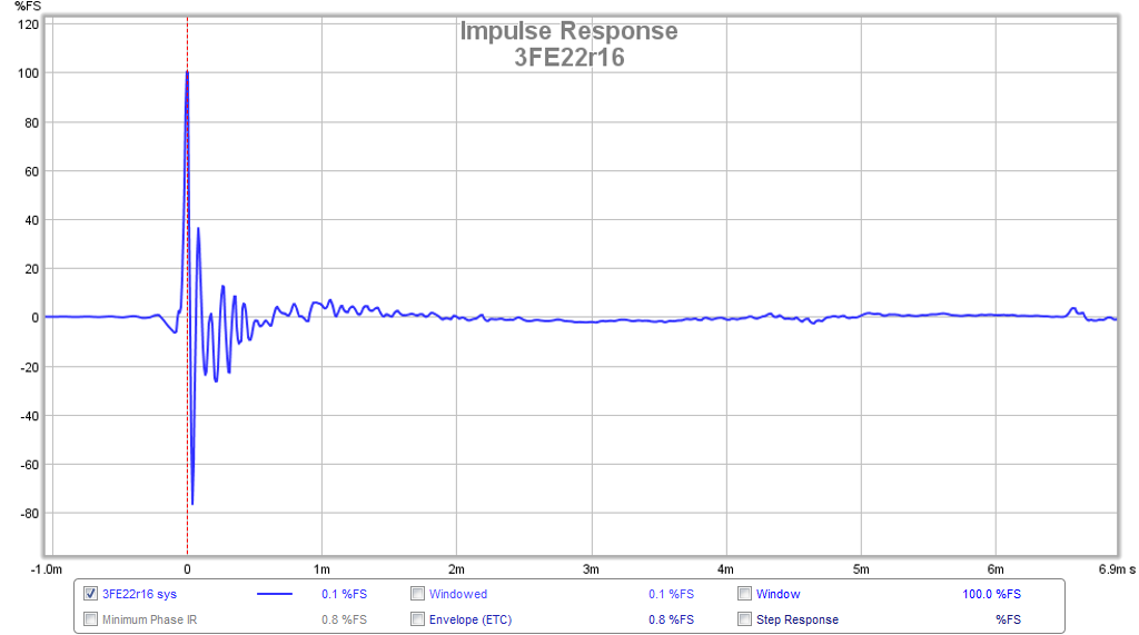

Regarding 3FE22r16 is inside top 2 from round one, in meantime is there possibility to make a recording again only this driver but with digital power amp verse your Yamaha analog amp. It's because irribeo points out r16 is not good spec for digital power amp. Know it raise workload and no critic if not done but could be interesting to explore.

You are asking for a recording with Yamaha class AB amp for the 3FE22r16 right?

Yes find interesting to analyze and rule out if digital power amp was calibrated/dimensioned to feed a 16 ohm load at its best 🙂.You are asking for a recording with Yamaha class AB amp for the 3FE22r16 right?
