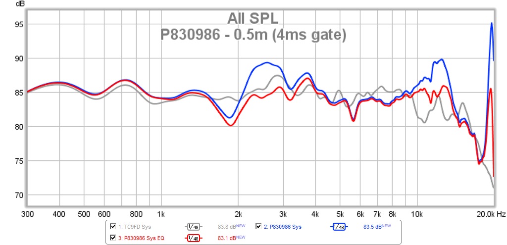

The amount of venting that the rear spider has is larger than any other driver I have seen. I just measured them on DATS and the TS parameters are basically spot on with published.
Here is an initial comparison with TC9FD with 4ms gate at 0.5m away (blue with BSC applied and red with EQ to reduce peaks)

Ive used the P830986 in quite a few applications, but it needs some xover contouring to sound nice, its smaller sibling P830983 is good for mid and tweeter duty as well, I am surprised these drivers haven't been mentioned earlier but I assumed they had been dismissed from measuring/listening because of some preconceived bias but now it seems it is because you didn't know about them.
