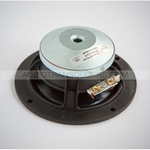

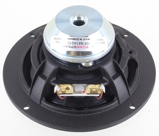

SS 10f question
I see on the madisound site, two different 10F units.
The 10F8414 for $65 and the 10F8424 at $95 (also the 4 ohm version10F4424)
They don't seem all that different on the specs unless I missed something.
Anybody know what the difference is, or has experience with either?

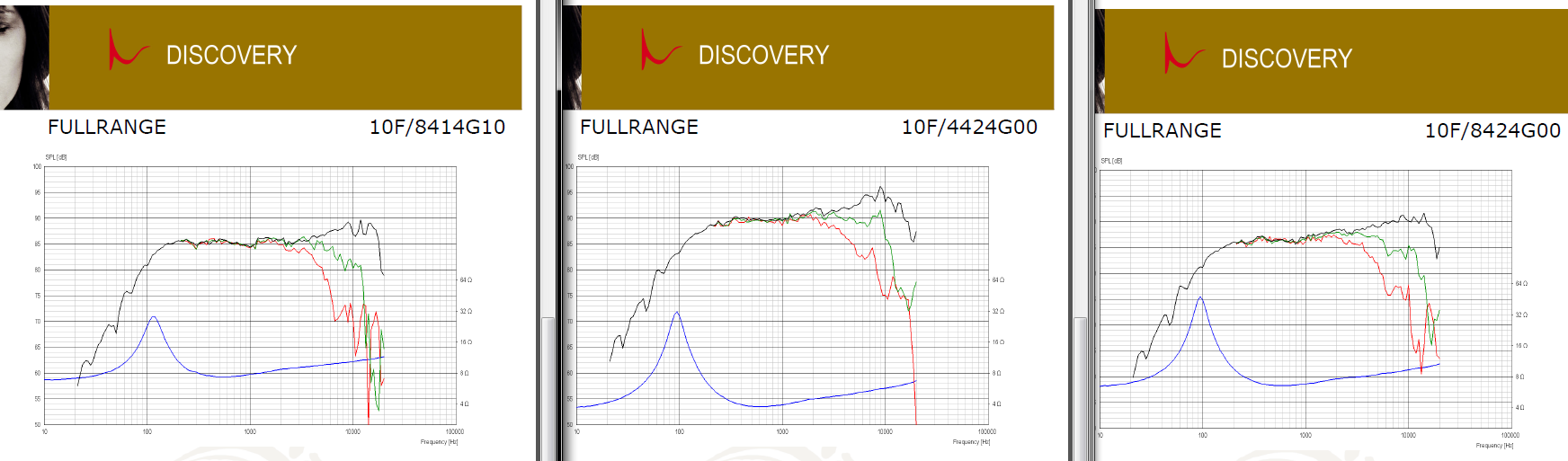

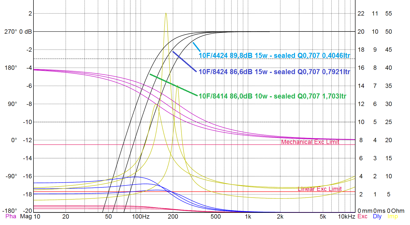

First picture simulation high pass function in sealed Q0,7 box T/S spec from datasheet and added info for sensitivity and max thermal power.
Second picture from manufacture measured real acoustic response.
Should give some overview, example wan't finesse in a FAST (relative low XO point) pick 8424 it's the smoothest one and has the middle score in bass extension of the three, want highest sensitivity in a 2 way at higher XO point (higher XO point than FAST) pick 4424 it's the weakest in bass extension, want a full ranger no bass helper pick 8414 it has lowest bass extension but loose some sensitivity and max power.

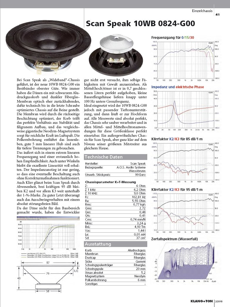

One thing I noticed in the distortion graphs of the 10F 8414: distortion seems to be about 35 dB down.
The 10F 8424 X measured did way better? Between 40 to 50 dB down trough the midrange?
my measurement was at 0.5m and -6dB down from 2.83v of 0.707v. I would go with measured HD from Klang and Ton, etc. I can also measure the HD at 1m and 2.83v at another time. It was just a tad better than TC9FD as I recall.
Is that -60dB HD at 85dB above 1kHz and about -50dB above 300Hz? Yes that is pretty impressive. I still haven't figured out what to use this driver for - maybe a DCR? As HiFi probably best in a FAST bookshelf with a high quality 6.5in to 8in woofer in a sealed box, XO at 400Hz.
