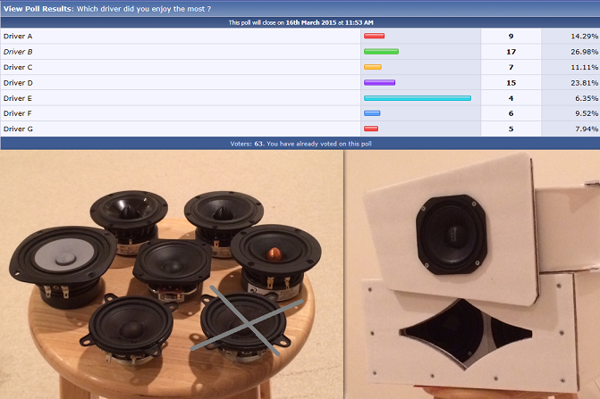

Find an error..

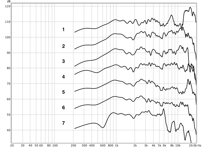

X was so kind to send me his data. Thanks X!
Here's the frequency response of all drivers at 0 degree. 1m mic distance, 3.8ms window.
Up to about 3kHz the response of all drivers is more or less the same except for two drivers. Above 6kHz curves start to look very different. Can we hear what the graphs show? Just for fun assign each curve to the sound files.
attachment.php
X, if you don't want me to use your data publically then please let me know and I have this post removed.
