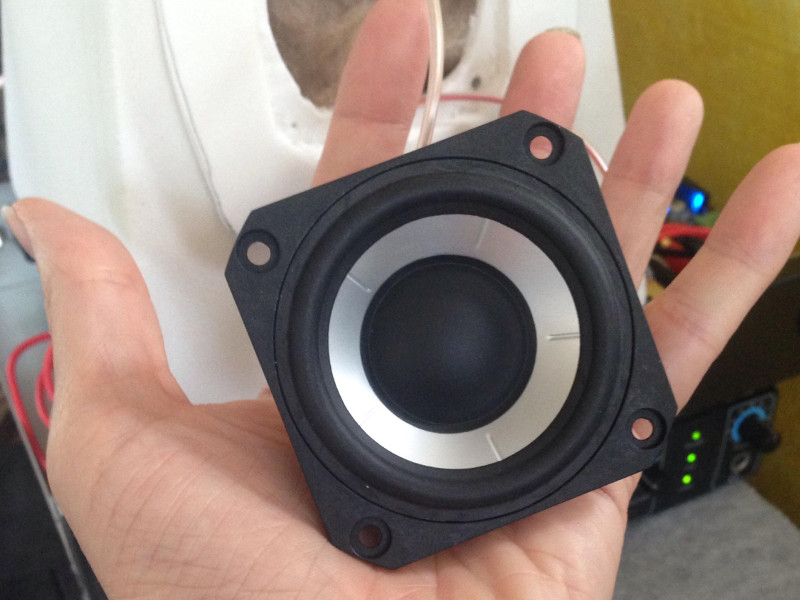

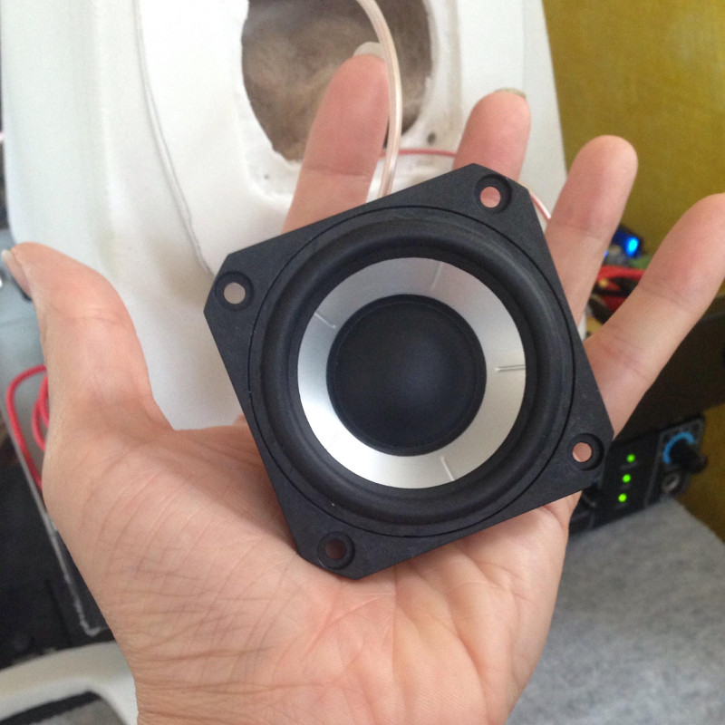

Decided to order the SB65WBAC25-4 after this listening test. It was my top pick (H), the measurements and specs are good and I have great experience with SBacoustics drivers in the past.
It arrived and I am very impressed!!
Tiny little thing, but it is definitely fullrange.
499269d1439946579-subjective-blind-comparison-2in-4in-drivers-round-3-sb65-hand-smaller2.jpg
It is actually quite dynamic and has a delicate detailed treble like a dome tweeter. Even though this is just first impressions, but I think I like it better than the fe83en and ff105wk that I currently have (still waiting for EuropeAudio to ship my 10f/8424 grrr).
The SB65 really has a beautiful clarity and purity to them, but also have a surprising dynamic punch in the midbass. Almost sounds like a 3" or 4" driver but with a dome tweeter like clarity.

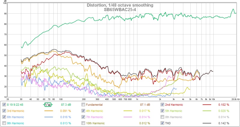

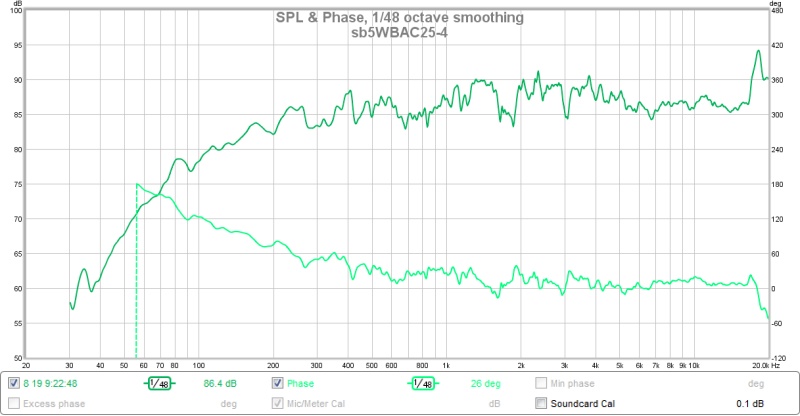

And mine actually measures even flatter than the one XRK shows here!
I made measurements here at 90db at 0.5m, which I think is higher than XRK's tests. At this level the drivers are quite loud. I am not sure how to measure the voltage (AC across the speaker terminals?). Maybe the voltage ranged from 1.3-1.8volts during the sweep. My measurements are fullrange and yes I did put 30hz into that little driver (poor thing), but the xmax on this thing is amazing (5.3mm p-p) for such a tiny driver.

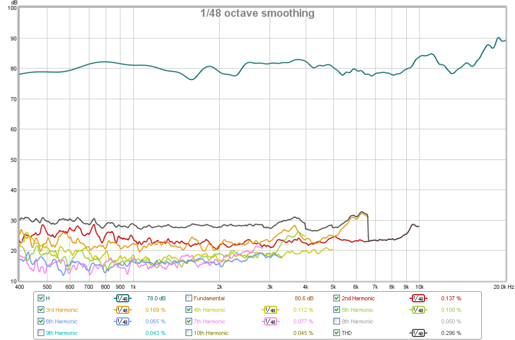

compared to XRK's measurement (with the 350hz XO to RS225)which I believe are at a lower output level than my measurements
498299d1439432985-subjective-blind-comparison-2in-4in-drivers-round-3-round3-driver-h-hd.png

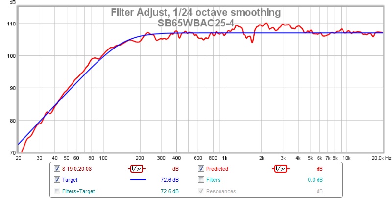

here is a measurement at 12cm when it first arrived, and fitting it to a target curve with a bass rolloff of 12db/oct at 145hz.
This is super flat with most of these bumps at 2-3db (no eq of course, just the raw driver in a sealed box)

Nice Jeshi. Your sample really does measure flatter than mine. It seems you don't have the small bump that I have at 10kHz. They do sound really nice and I am looking for the next speaker to put them into. Your sealed EVA foam seams to be doing the trick with this one. You described it the same way I did: sounds like a mid range with a built in dome tweeter.
Can you plot yours with the IR window set to 0.5ms before and 4ms after zero time? Then plot it at 1/48th octave smoothing using same scale as mine. We both measured at 0.5m so it should be similar - although you have some rounded edges on your foam box which is also a trapezoid.

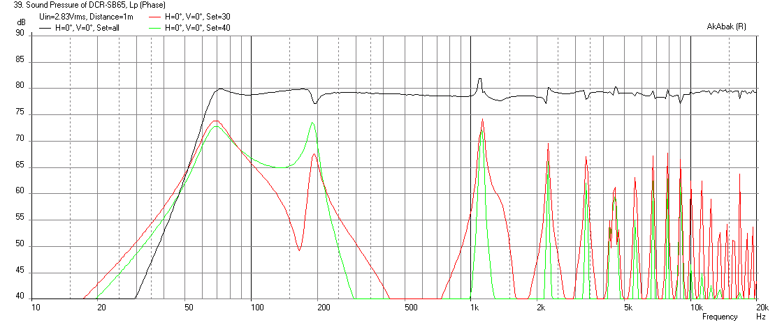

Now that we have shown that this driver has some followers maybe it can breathe life into my thread that went no-where when I first describe these guys as potential drivers for full range projects:
http://www.diyaudio.com/forums/full-range/273211-sb-acoustics-sb65wbac25-4-what-do.html
I think it would make a neat little DCR running full range to squeeze some bass out of the little guy.

Looking at the raw distortion, the sb65 looks like it would be most happy either crossed over at 400+hz or maybe in line array to increases the sound pressure level but keep the distortion low enough.
I would love to try them in a 3x line array, but 3 of them are the price as a 10f so it might not be so advantageous. But maybe even a 2x array might be enough to give good spl with low distortion.
