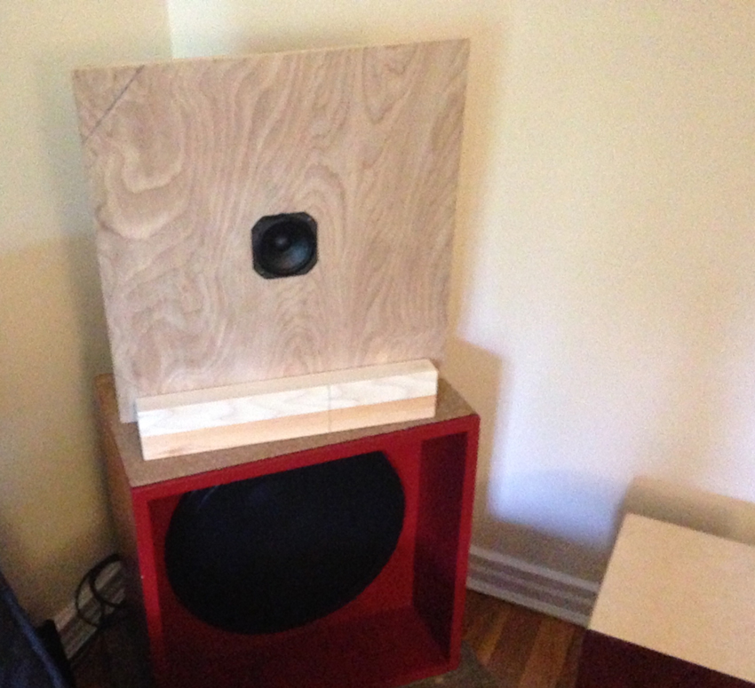

Spent much of the day listening to the Vifa on OB on top of H-frame with Alpha 15. It’s a superb setup. I am coming off about a month of listening to the Tangband 1808 on top of the same H-frame. These are both very enjoyable systems with different personalities. The Tangband is brighter and more forward. At first listen the Vifa sounds dull in comparison. But once my ears adjust the Vifa is a very balanced driver. It’s less lively sounding than the Tangband and less efficient so it needs a more powerful amp.
If you like a laid back presentation that’s relaxed and a bit rolled off at the top (I angle the Vifa’s about 5 degrees off the listening position, the Tangband’s about 30 degrees) then the Vifa is an excellent choice. I could listen to this speaker all day.
For home use I believe I could argue these systems (as well as similar ones) are among the best options for incredible sound.
If I ever get the courage, I will get around to building a 3way active system. Single 8" woofers, maybe something like the twin VC Visaton GF200, closed box using a single coil (Qts higher), midrange 300 Hz to maybe 5 k, tang band W3-1285SG , Then fountek neo3.5h ribbon.
