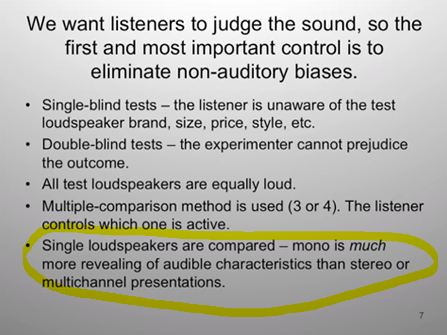

At post 282 http://www.diyaudio.com/forums/full...2in-4in-drivers-round-3-a-29.html#post4420712 Xaborus linked to a video see below captured picture.
Floyd Toole with pointing finger at video timeline 8:29 says "when you do these comparisons, you do them one at a time, in monophonic, one speaker, not stereo, not multichannel"
Suggest as said in a previous post that if stereo signal is routed to the mono speaker and sound clip recorded, that the reference track we can download have same stereo signal and if example only right channel is routed to mono speaker and sound clip recorded that the reference track we can download have same right channel mono signal. Further it would be nice if download able sound clips and reference tracks are stereo tracks but with a empty left channel. This will make sure when people make compare at speakers than no acoustic comp filtering is taking place between their left and right speakers bandwidth when playing a track with exactly same audio material for L/R, and listening this way will reflect one speaker recorded/one speaker played back scheme. Now if into headphones having only a track at right ear is weird or troublesome think its not a problem on ones system find a way to route right channel to L/R headphones out.

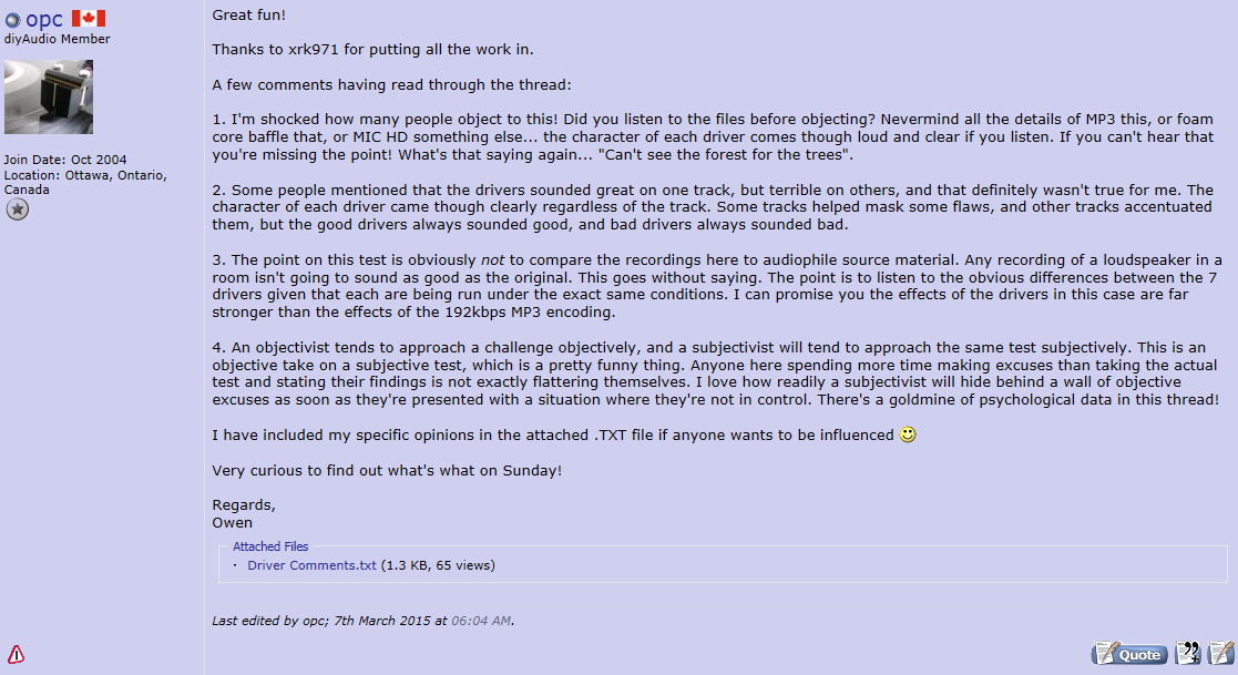

Other facts than complaints and a bottom line telling X hey my system is better than yours, remind me to point below onto OPC comment at round one http://www.diyaudio.com/forums/full...in-5in-full-range-drivers-25.html#post4249709.
attachment.php

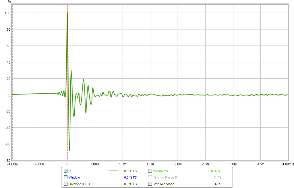

Also the fact that as reference monitor you choose playback the comparison tracks at a ringing speaker as the un treated A7.3 plot below shows could influence and make double the ringing. Okay yours is eN and can be EQ and or DSP'ed, but my experience from A10.2 is that the metal cone reacts to frq flattening when being EQ'ed and or DSP'ed but ringing scheme mostly continues.
498288d1439432788-subjective-blind-comparison-2in-4in-drivers-round-3-round3-driver-g-ir.png
Byrtt,
Yes, totally agree that A7.3 played back on A7.3 = ringing^2 (can't be good). Hence when listening to non A7.3 produced source, it will sound better. Headphones are best for listening to tracks and one should listen to some non ringing drivers (B80, SB65, etc).
Not played back on A7.3 but A7.3eN.
No headphones here. No regrets about that.
Still, it is all relative…
dave
