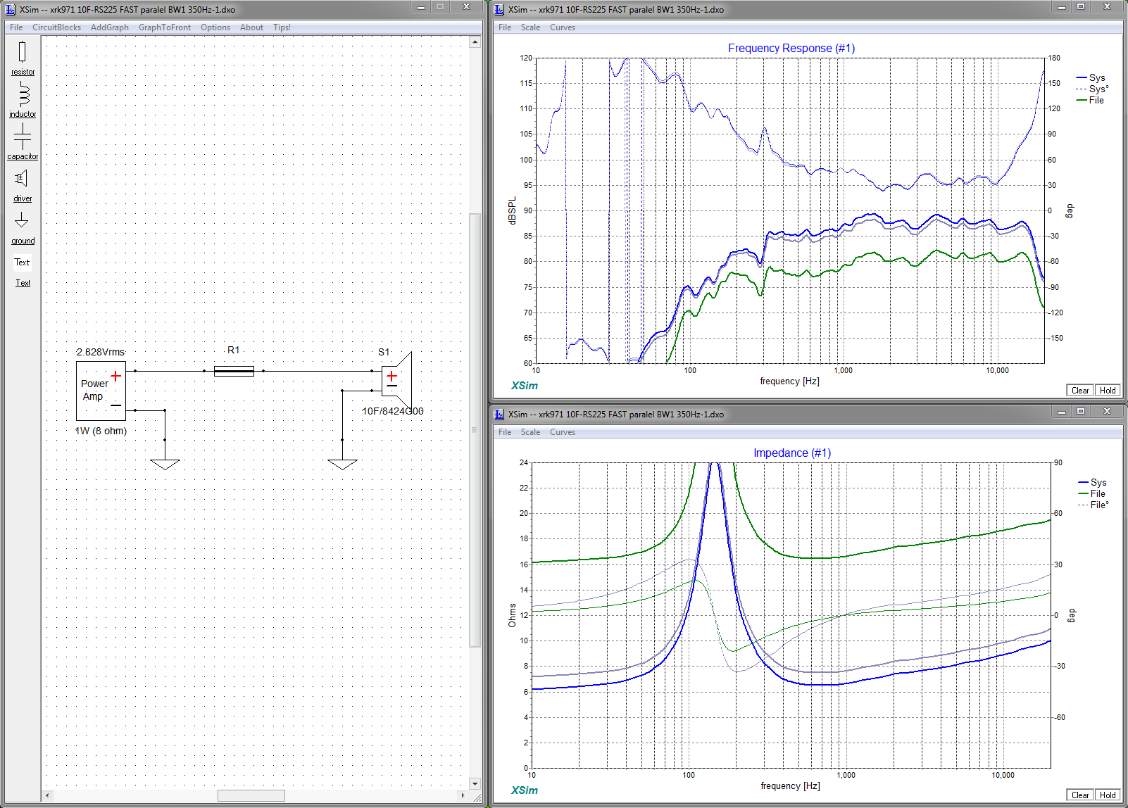

Thanks tip but think it moves too little dBs in uninteresting frq area with small cable changes and at same open discussion that one change dampening effect of amps solid short (low impedance) to stop electric motion at cone (anti oscillation brake).
Below is free XSim modeling with xrk971 real world data measurement for 10F/8424 in his Dagger box, blue is direct to amp grey is 1,0 ohm and green is 10 ohm series resistance placed at amp output.

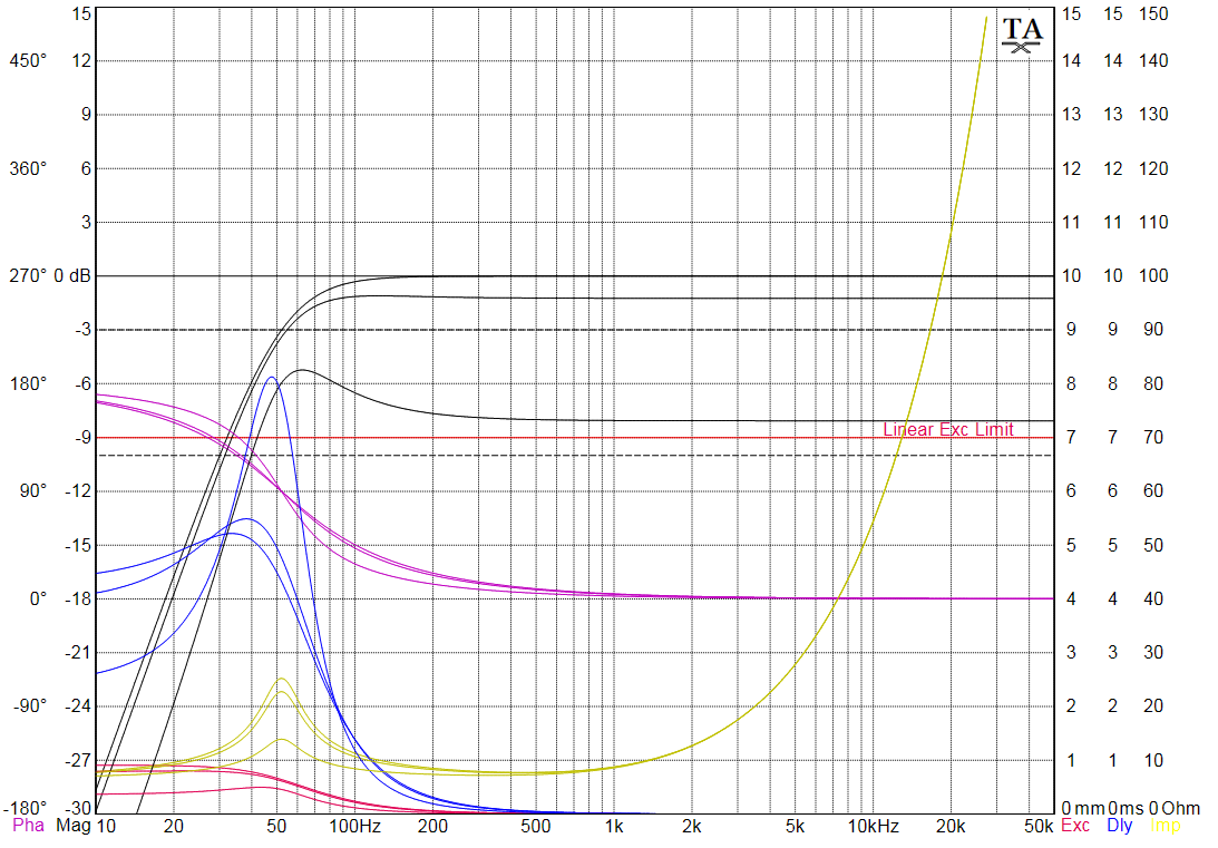

Second picture is WinspeakerZ modeling a RS225-8 woofer in sealed box at Q0,707, the two lower traces is adding a 1,0 ohm and 10 ohm series resistance.

Wow that's crazy, i didn't know software like that existed.
I was expecting much more change than there was for 10Ohms. I read online that the best rough "rule of thumb" was 1dB change per 1Ohm. I wonder how accurate the sim is. Cool sim though!

Can really recommend the free XSim software and not thank creator bwaslo enough for sharing that. Give yourself the learning time it takes to handle the program and the software can answer so many questions one can think about when dealing with R L or C values and what will happen. Import or export to other programs is possibility too. A simple exercise is in a new session (without any components and drivers at all) place one capacitor across the amp output then set it a given value including ESR value too and on the fly in the impedance window one have its real plot. It seems as accurate as real world, at least is my experience when checking the circuits outcome afterwards by microphone or DATS measurements .
Link to XSim at DIYA http://www.diyaudio.com/forums/multi-way/259865-xsim-free-crossover-designer.html.
WinspeakerZ is not free, its a 39,95$ program from www.trueaudio.com.
